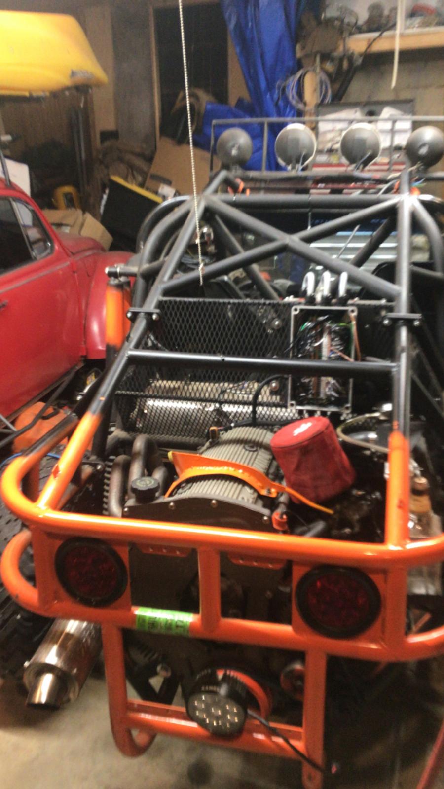

Ive examined your rig before. It's apparent you have had a lot more time to test things out. Half the year here It's NOT buggy weather.
I have pondered the bypass system before but I never did much about it. On a quad4 those hoses go to the heater core. They come out of the pump housing and another position about a foot away. It's convenient because I was able to just span the two spigots with a 3/4" hose. I ended up making an inline temp gage holder out of a piece of aluminum tubing that I put in that line. I actually probably made things worse with that straight shot. It's possible I could add a tranny cooler or five in that line.
I want to make angular body panels eventually. Maybe I'll design a way to get air back to a wing. That'll probably happen sooner than later now.
I just wish I had the time I had when I started this rig like 13 years ago. Anyways, enuf ranting.
How are those silicone hoses the tuner guys use? Something like that might be what I'm looking for where a hose has to move sometimes?
You gave me a good idea to fab aluminum tubes where the hoses are straight and weld fins around them. Heatsink pipes.

So one of the issues I'm contemplating right now is the cooling system on my woodsbuggy. It has one of those 14"x16" squarish ricer coolers that you can get cheap off of ebay all day long. Initially, I was told by someone who uses the Quad4 engines in legend racing that he used that cooler and it did fine in an open engine design. Well it doesn't. Not at all. As a matter of fact I believe it was the reason my first engine popped a hose at the dunes.
There really is no room where it is (on the right side of the engine) to put a bigger radiator. I don't want to put one on the back of the cabin area because 'hot coolant'. I also don't care for it on the back frame 'roof' over the engine. I don't feel like that would be an efficient spot. Getting hoses into it and also a filler at the right angle would be a lot of work. I'd basically have to reweld the entire radiator.
So I've researched a wing design, where you get a Jeep Commander radiator which is long and short and build it into a wing on the back of the car and use fans to pull air through it.
Some even go so far as to make the wing hinged so as to have better access to the engine. I don't want to obscure the top of the engine with a radiator. I kinda like the looks of the top of my engine. So I'm thinking of a wing off the back that can either be swung up or off to a side.
My question is how would you run coolant lines so they were secure yet flexible enough to be bent. Some type of accordion type hose would be nice as it would hold it's shape. I have a hose like that underneath the engine that I got from a hydraulic supplier but it's super tough to bend.
Just looking for ideas.
crappy blurry pic for inspiration:
