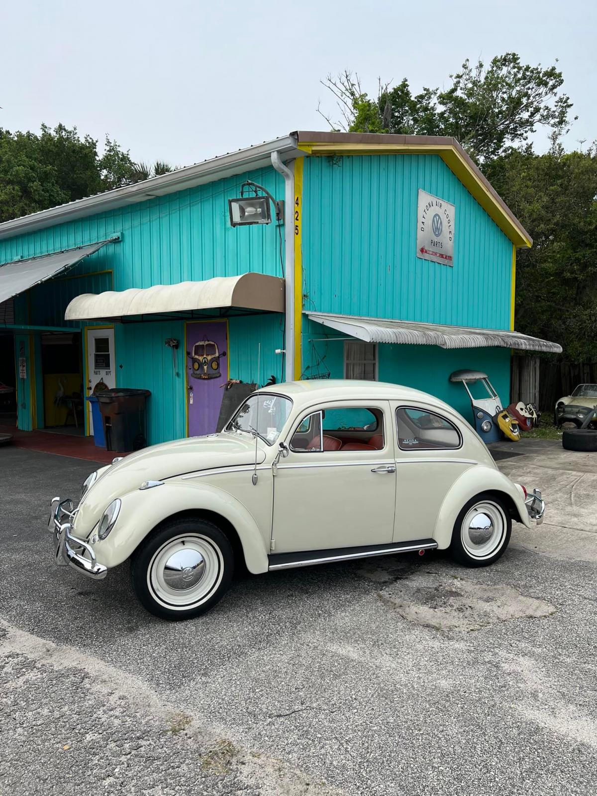

PostPosted: Mon Nov 21, 2022 3:27 am    Post subject: Re: Powdercoat match for L-87 Pearl White Perlweiss ? Reply with quote
Wow it looks great and makes me like my L87 that much more. The wheels look great too.
