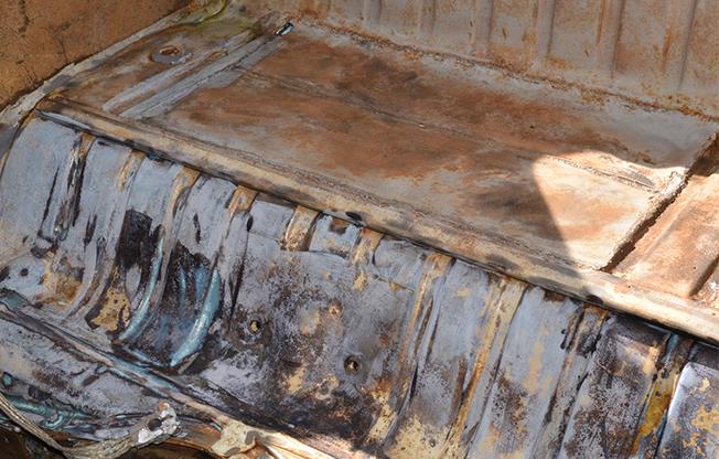

I just purchased another '66. It's in really good shape except for 2 areas. The battery box and the rear luggage shelf.
I received a new repair panel for the battery box with the deal, but need to source a repair panel for the luggage shelf. From what I can tell it will cost me close to $400 for a new panel and to make matters worse I will need to cut it as I only need to replace the floor section and about 2inches of the bulkhead.
So... My question is does anyone sell a cheaper repair panel or a smaller repair panel?
Thanks,
Ron

You can check with http://www.restorationpanels.com/, i know from other threads here that he has custom made panels on occasion when workload has been slightly lower, but dont expect cheap though. But from what i have seen the quality seems worth it!

I would try to get one cut from a donor car. Should be much cheaper this way. Post a wtb ad, search local junkyards, ask around at swap meets or your local VW club, etc.

I'll see of I can locate one local and cut it out. Thanks for the help!

Note ; the 66 package shelf DOES NOT have the hole and indention on the right end for cables ; that is 67 up ...
One source was selling this incorrect piece to 66 iowners , it will fit but is NOT correct........
Twisted Evil cover it with carpet , nobody will know but US Twisted Evil

I was wondering about that hole as it is not present on either of mine. Thanks for that tidbit of info Grandpa Pete.

I have two 67s with rusted luggage shelves. Neither has the hole that is present on the replacement piece. Is this really 67 and up?
Also, what are the bolts for on the replacement piece? Nether of mine have these either. Are they to hold the engine sound absorber in place of the metal tangs?

I may be mistaken, but I believe the hole is the pass through for the wiring for the fuel injection ECU -- so '75 and up would be more likely. I do know my '72 did not have a hole there.

Just fill the hole in the new panel and remove what doesn't belong. It's not like it will ever be seen, besides unless it's welded in by a pro and ground smooth front and back folks will know it's a replacement panel.
Or, you could do what I ended up doing and have a panel cut out of a donor car. Only cost me $50...

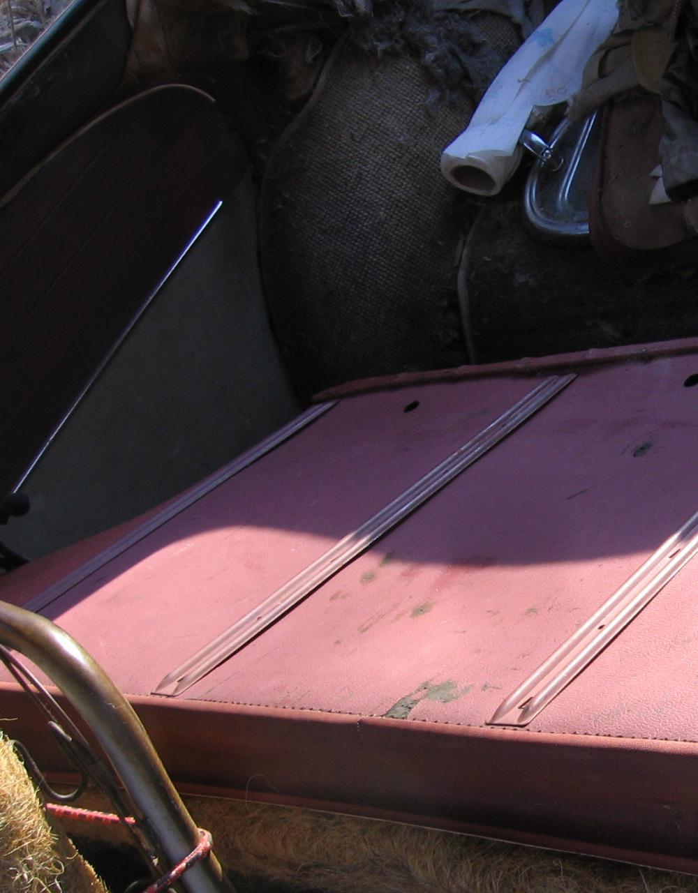

I have a 58 Beetle in the shop, my question is I have 4 metal bars I assume are for the back of the rear backrest, the old rear seat cover doesn't have any holes in the flat cardboard to locate them to this panel. could it be a different later year seat? when did the metal luggage protector strips appear in the beetle years?

might not be doing yourself any favours by tagging your trim query onto a body panel thread....however
I think the card with rear luggage rails ended in july 59 and the 1960 model was without them, here are photos of original '59 and '60 rear seat backs
