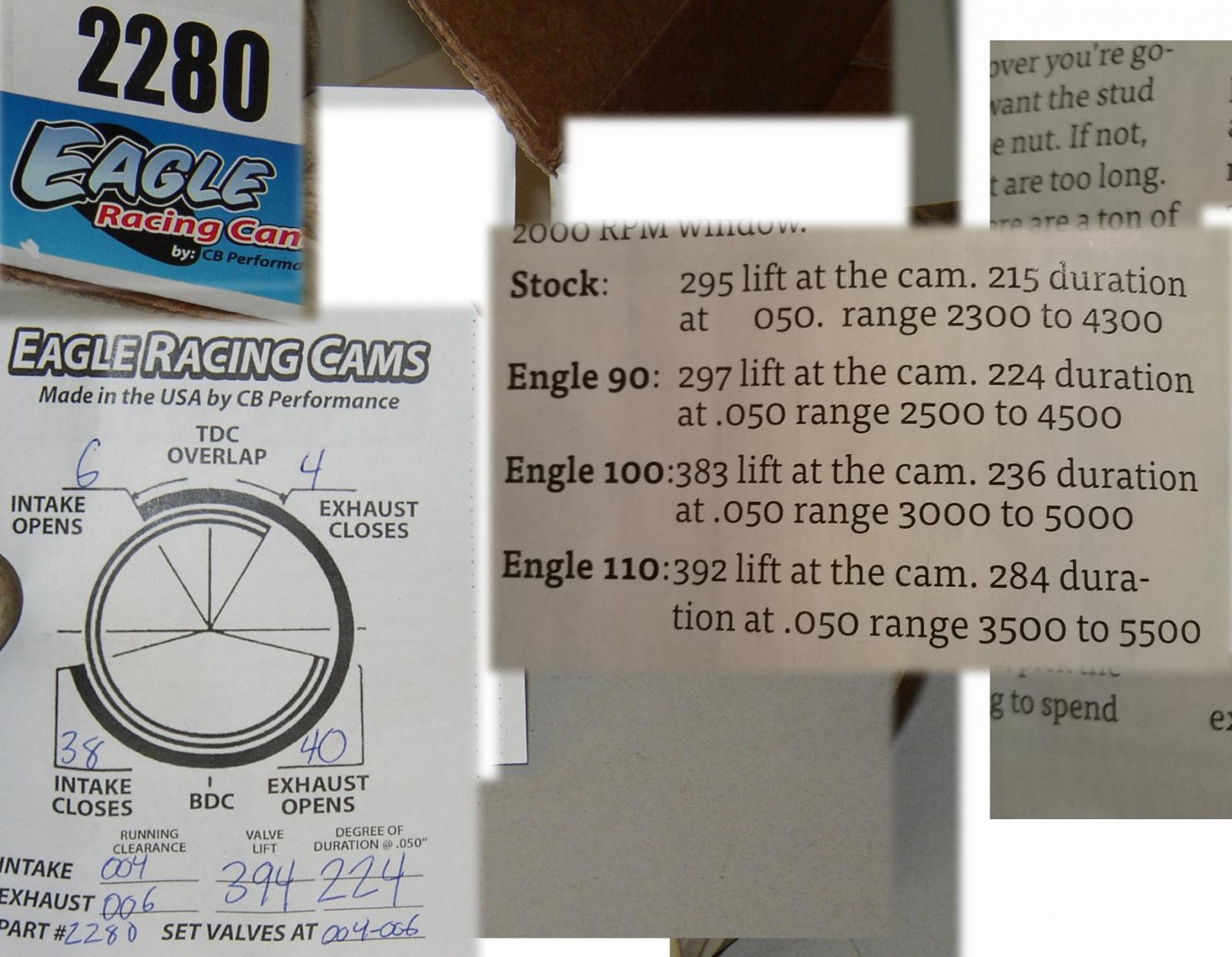

PostPosted: Sun Feb 12, 2023 12:15 pm    Post subject: Re: Cam recommendations Reply with quote
you can get what used to be called an RV cam, It has plenty of torque on the low end like stock and will raise the top RPM just a tad. Engle W90 is only 265 degrees total duration so it will not hurt the low end, and it will give a little pickup. They name it as the Cheater Cam. Will work well to 5000 RPM without sacrificing the low end. Make sure you know if you need a dished or flat cam for the oil pump.

PostPosted: Sun Feb 12, 2023 1:24 pm    Post subject: Re: Cam recommendations Reply with quote
No, the "cheater cam" and the W90 are two different cams.

PostPosted: Sun Feb 12, 2023 1:58 pm    Post subject: Re: Cam recommendations Reply with quote
My vote is for the CB 2280 "cheater" cam, only a little more duration and a lot more lift. Great low and mid range cam, idles like stock but pulls much better down low.

After using several of the 2280s, I wouldn't build an engine with a stock cam anymore, even a bone stock engine. In your usage you need to decide how much of your driving will be done on "slow mountain roads". There is no camshaft that gives great power at all RPM ranges- low/mid/high, you need to decide where you want the power the most. If you want the engine to be happy down low use the 2280. If you're looking for more spirited mid or upper-mid rpm use on the street, go with the 100 or 110 but expect a trade-off down low. I honestly wouldn't use an Engle 90 cam in anything if the 2280 was available (it was on backorder for a year during covid).
I currently have 4 PN2280 cams in my engines from 1600 to 2180cc. I've bolted that cam into stock engines without any changes at all and had great success over many miles. (I'm in my 60's and don't wind any engine over 4500-5000rpm) Look at the specs I posted above- a "cheater" is the nickname for a cam that increases lift and not duration. This increases power without the soggy bottom end associated with a higher duration cam.
Asking what cam to use on this forum brings out a lot of opinions, these are my experiences with that exact cam. I had a 2180cc/W110 in my Ghia and loved it but it was not a bottom end torquer, it came on like gangbusters in the midrange. I put that engine in one of my busses but swapped the 2280 cam into it first. The 2280 is a really mild cam for a big 2180cc engine but it works really well in a bus. Your application (Baja/slow dirt roads) is similar- you'll want bottom end torque and lots of it. You may want to lighten up your stiff springs if you're not looking for high RPM use, most of mine are running stock springs.
If you have a few bucks to spare I suggest a counterweighted crank in any engine also, it makes the engine noticeably smoother and revs better. They come as 8 dowel, have the machine shop drill/match your flywheel to it.
I'm sure others will chime in with conflicting opinions, good luck with whatever you choose.

PostPosted: Mon Feb 13, 2023 1:57 pm    Post subject: Re: Cam recommendations Reply with quote
CB 2232 is very similiar to W 100. Has 236 duration at .050

PostPosted: Mon Feb 13, 2023 2:14 pm    Post subject: Re: Cam recommendations Reply with quote
It might come down to availability. I literally just called CB because they still have a disclaimer on their site that it might take a while to get a 2280. The helpful dude on the other end of the phone said,
"The 2280 is in stock."
"The 2232 is backordered."
So the Engle W100 and the Eagle 2280 are available.
I prefer the 2280.
The 2280 will work with single "hi rev" springs and aluminum pushrods. Be aware that extra weight in the valvetrain (steel pushrods) requires extra spring pressure (dual springs) to adequately control it.
So: I would go with the 2280, "hi rev" single springs and aluminum pushrods. Heavy duty rocker assemblies won't hurt anything.

PostPosted: Fri Feb 17, 2023 12:37 am    Post subject: Re: Cam recommendations Reply with quote
W90 then. You aren't looking for outrageous RPM, you are looking for a little more than stock, but a smooth performer.

PostPosted: Fri Feb 17, 2023 9:35 am    Post subject: Re: Cam recommendations Reply with quote
For the super mild "cheater cams", I would run the CB2280 long before the w90.
The 2280 has .070" more lift, far better grind quality, it will actually match the cam card, CB has them in stock now, and best of all, you can use the really good cb1512 $32 lifters instead of the expensive, heavy, and thick head Engle lifters. All wins.

Thanks for all the advice guys. It’s nice reading you opinions without the drama that often occurs on a touchy subject like camshafts.
Roy @ Mofoco recommends the Engle w100.
Mike @ CB recommends the 2280.
Mike stated that since the compression ratio is stock, a grind with a shorter duration will result in a smoother idle a better low to mid range. They won’t have the higher revs most people want but will have that practical useable power down low for an application like this.
Madmike:
Mofoco heads have no step in them.
I feel like I now have the information I need and have a good understanding of what I need for my application.
I’ve compiled a list of camshafts that would work for a stock comp ratio. If anyone is interested I’ll post it.
