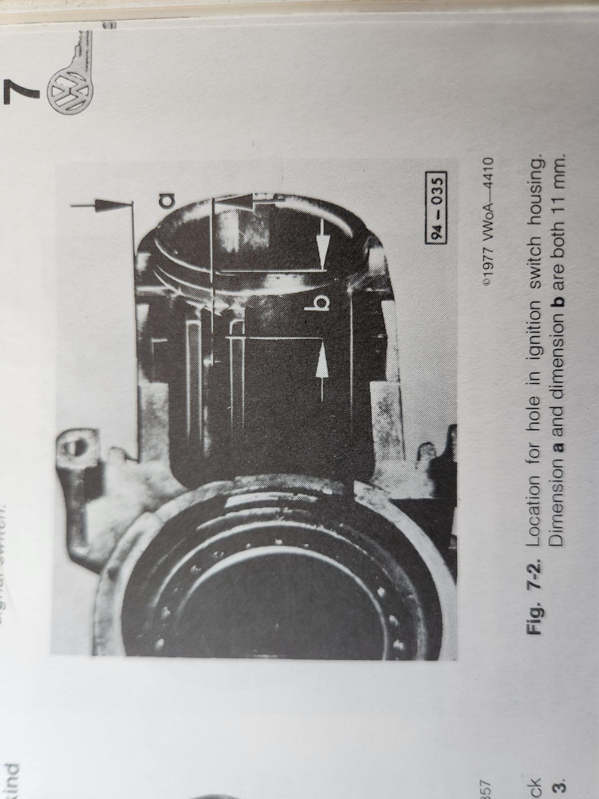

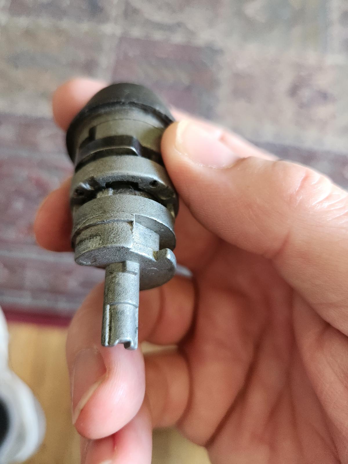

The little screw holds the electric portion of the switch in place, it does not retain the key cylinflder. The barrel cylinder is held in place with an elbow spring(see pic)
In you 2nd pic, the "valley" on the right side of that opening, where the triangular wedge normally sits, you will need to drill a small hole that you can push a drill bit end or allen key through to depress the spring.

Usually there is a hole in the side you can push in so the spring will let go. It's a real pain to remove when you lose your keys because the locking mechanism keeps you from being able to get it out. I had to take apart the whole steering column to get one removed once for my father.
