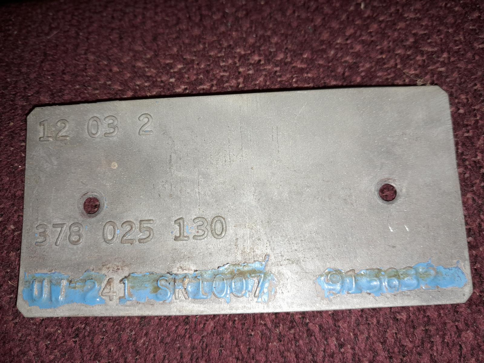

Hello, been searching online for quite some time to figure out what paint code I have.
The VW M Plate states it's a "sk1007."
I cannot dig that up anywhere. It is a 62 VW Micro Bus Deluxe.

PostPosted: Sun Aug 27, 2023 12:55 pm    Post subject: Re: 1962 VW Bus paint code Reply with quote
How about some pics of bus and m plate ?

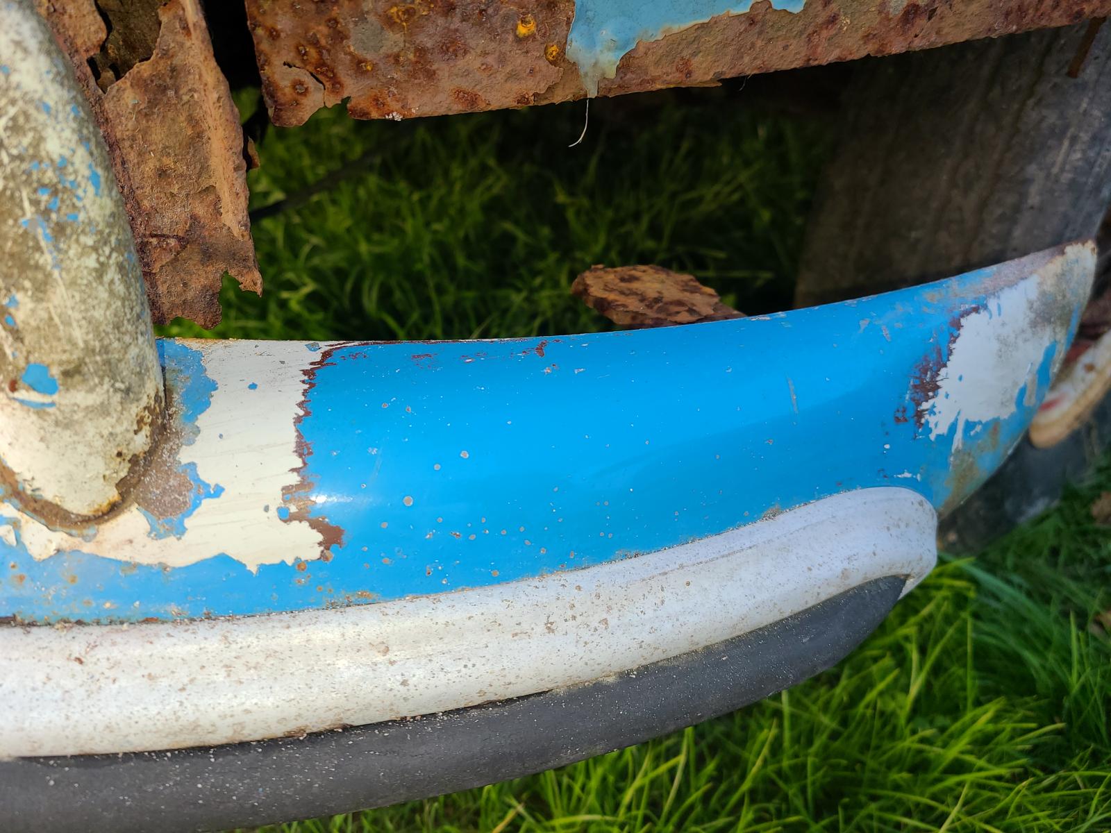

He sent me 2 pics to post here, Here they are:
I'm not sure the bottom is Dove Blue?
It looks lighter to me than Dove Blue but that could be photo or the way the color appears on my computer.

PostPosted: Tue Aug 29, 2023 6:14 am    Post subject: Re: 1962 VW Bus paint code Reply with quote
The top color looks closer to Dove Blue to me in those pics. Maybe Sea Blue lower and Dove Blue upper. Sea Blue was available on Ghias during that time frame. What a cool bus, you need to get your painter to color match those two blues and repaint it in the original colors. I love special order paint buses.

PostPosted: Tue Aug 29, 2023 7:50 am    Post subject: Re: 1962 VW Bus paint code Reply with quote
I’d agree about the sea blue on the bottom but that’s way too light for Dove Blue on top looks more like a 1962 Ghia color L398 Pacific Blue.

PostPosted: Tue Aug 29, 2023 8:45 am    Post subject: Re: 1962 VW Bus paint code Reply with quote
I would like to see the two colors where they meet at the bottom of the beltline. That will give a good contrast/comparison between them.

PostPosted: Wed Aug 30, 2023 9:13 am    Post subject: Re: 1962 VW Bus paint code Reply with quote
Here are some more photos of color on the bus

PostPosted: Wed Aug 30, 2023 9:17 am    Post subject: Re: 1962 VW Bus paint code Reply with quote
Here is the darker blue in a more natural light
