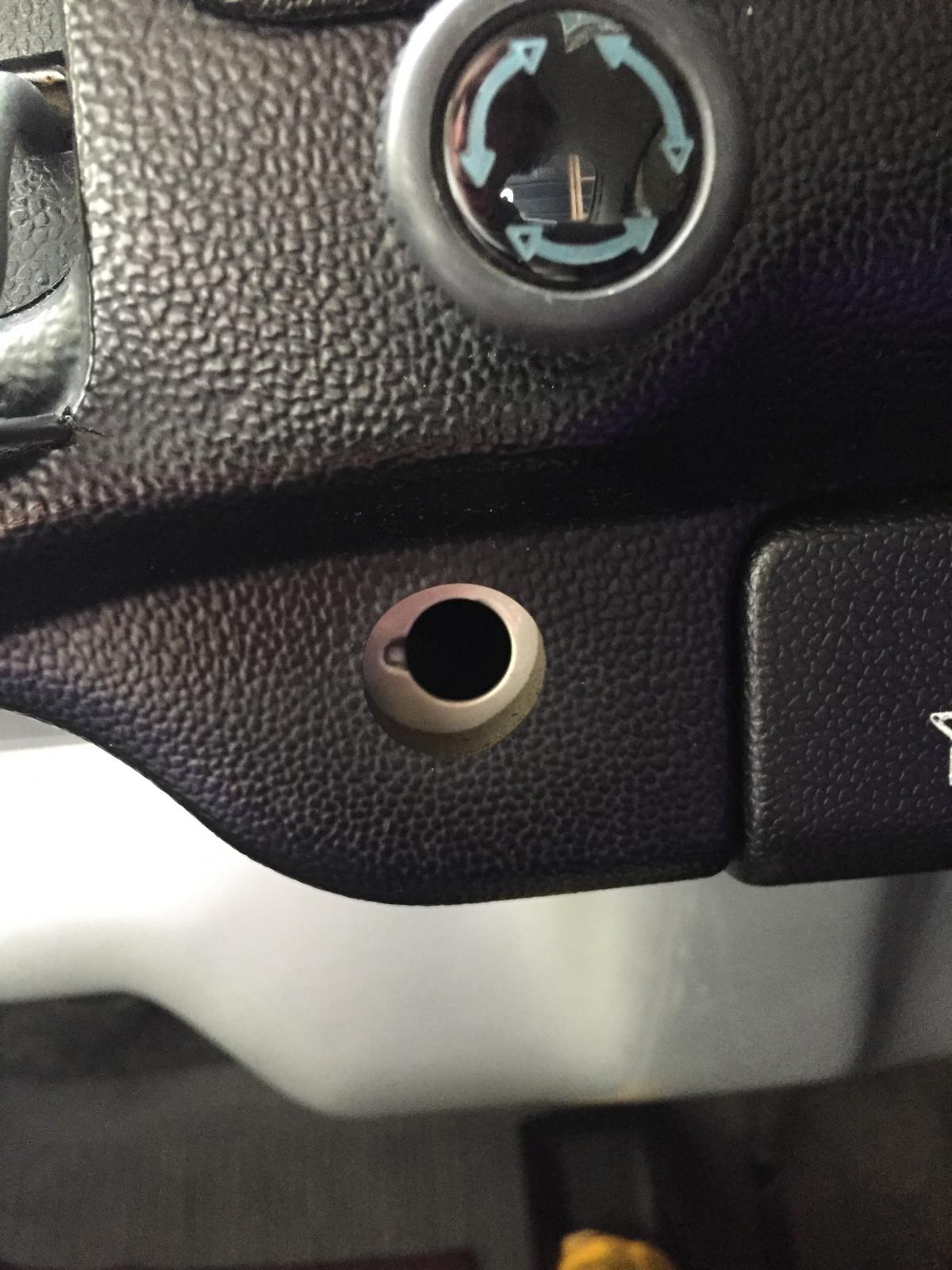

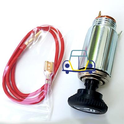

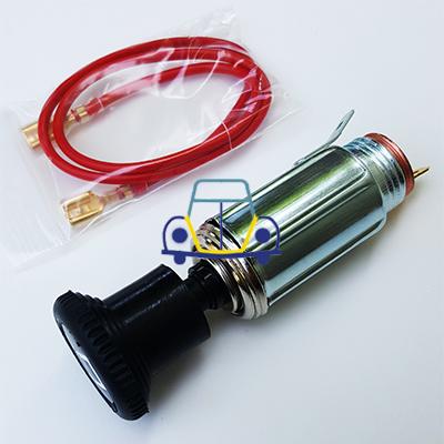

I have a spare hole cut in my padded dash and noticed there is a precut hole in the metal dash behind it. The padded dash hole measures around 22mm and the metal hole around 14mm although that one is difficult to measure.
Will a cigarette lighter fit here?

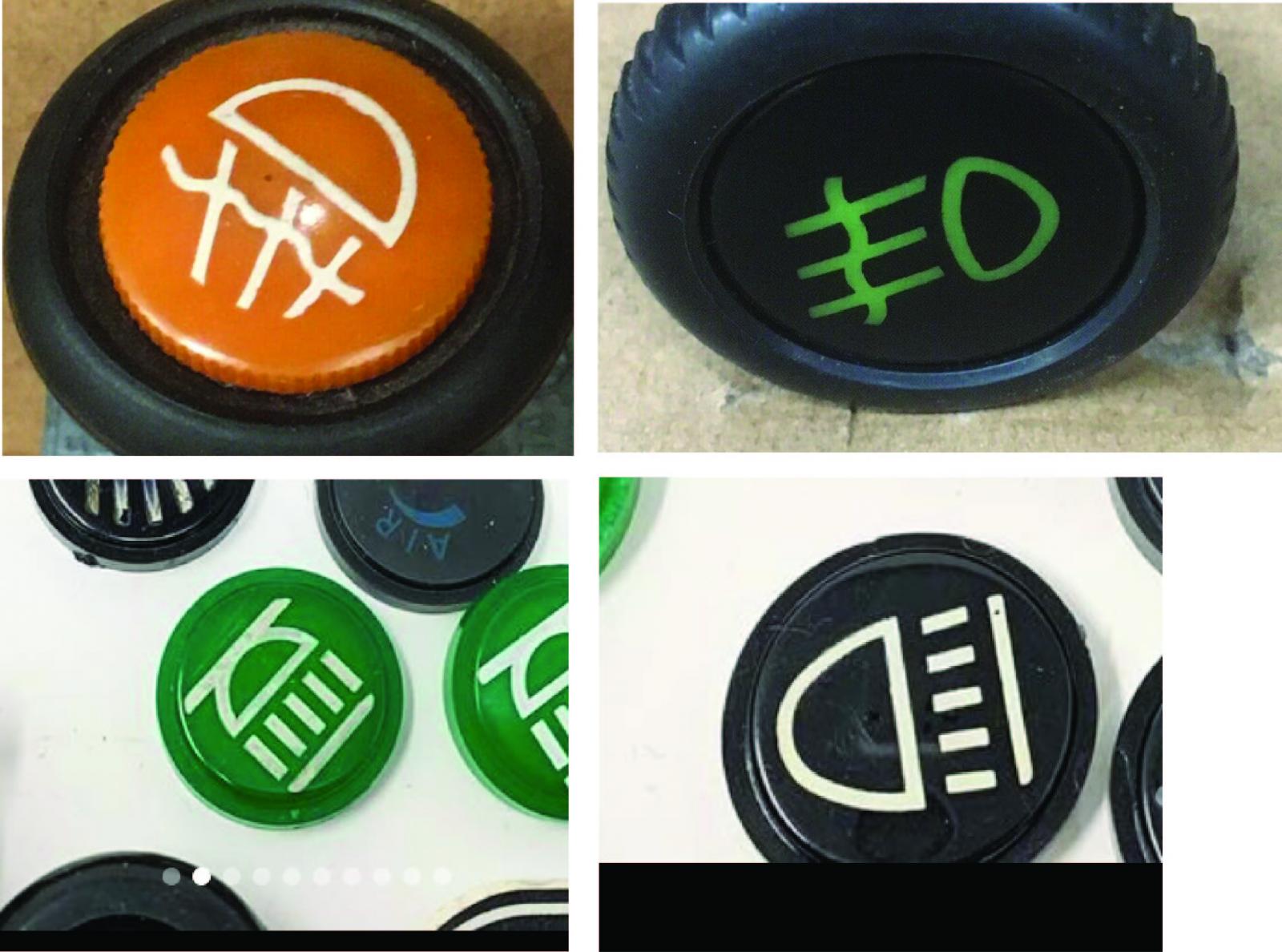

I noticed there is a high rise and low rise knob available. Which is best for a beetle with padded dash? I've been told the low rise is for the beetle and the high rise for a bus although i've seen a couple photographs on here showing dealer originals with what looks like the high rise one with a metal sleeve to protect the padded dash
high rise:
low rise:
@pogel lighter

Obviously you will need to cut a bigger hole for the lighter socket to fit. Do you want a lighter socket or just fill the hole? Does your car have any signs that a aux heater was installed. I think that hole was originally used for a aux heater switch (eberspächer).

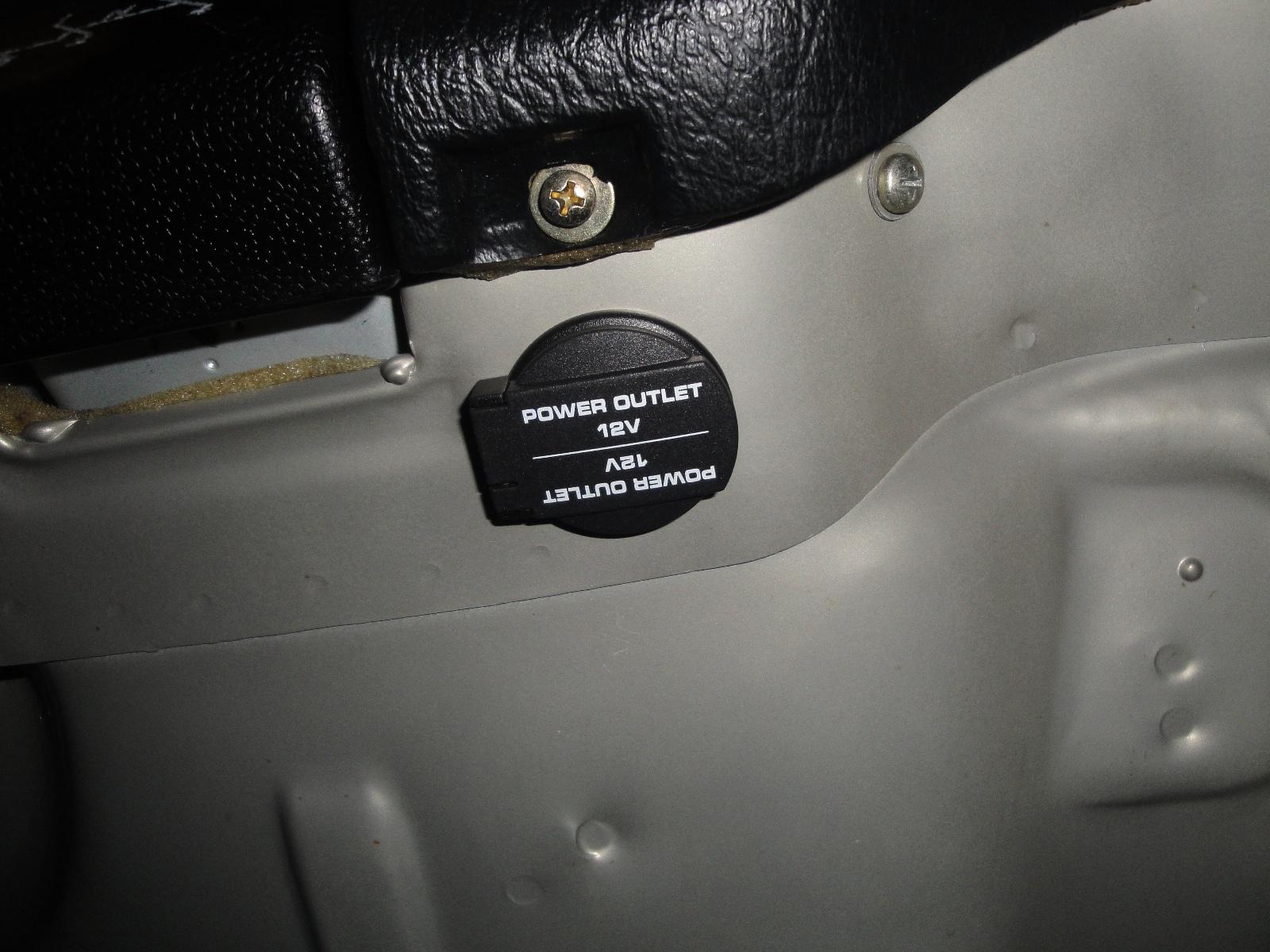

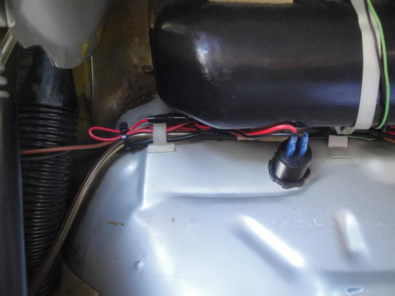

I installed mine (actually a power plug) under the dash, out of sight:

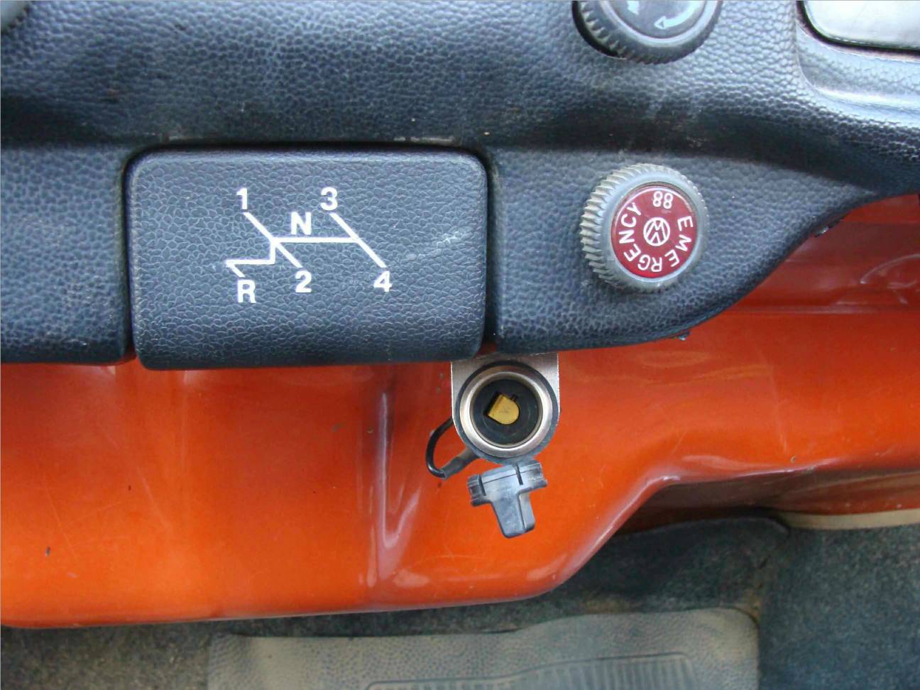

PostPosted: Wed Mar 15, 2023 8:53 am    Post subject: Re: Cigarette Lighter (for padded dash) Reply with quote

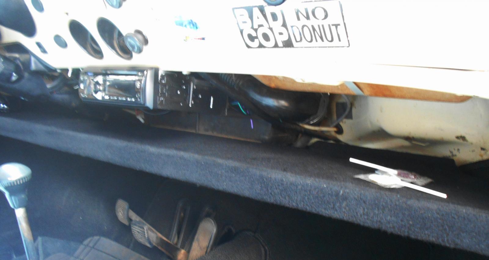

Under dash on my 1971 Super
What did you both use to cut a hole/make a hold bigger in the metal dash/ what is recommended to use?

hopkin Premium Member
Joined: June 25, 2012
Posts: 2539
Location: Ottawa, Ontario
hopkin is offline
PostPosted: Tue Mar 21, 2023 7:07 pm    Post subject: Re: Cigarette Lighter (for padded dash) Reply with quote
jonat wrote:
It's the first time i've heard of an auxillery heater in a beetle. What would show it had been installed?
The auxiliary heater is a gas heater, there are threads on the subject. Both of my old '71 Supers had them, they were common here in colder climates.
Like Jinx I used one of the dome shaped bits. I guess the bit was large enough as I didn't have to use my dremel to make the hole larger.
The power plug and door are Porsche PN's 95565210700 for the socket and 99765210300 for the 'door' portion. They should be easy to find. I installed mine on a switched circuit (fuse 10) so the key must be on. Later I installed a dual USB port on the same circuit, so I don't really use the power port anymore.

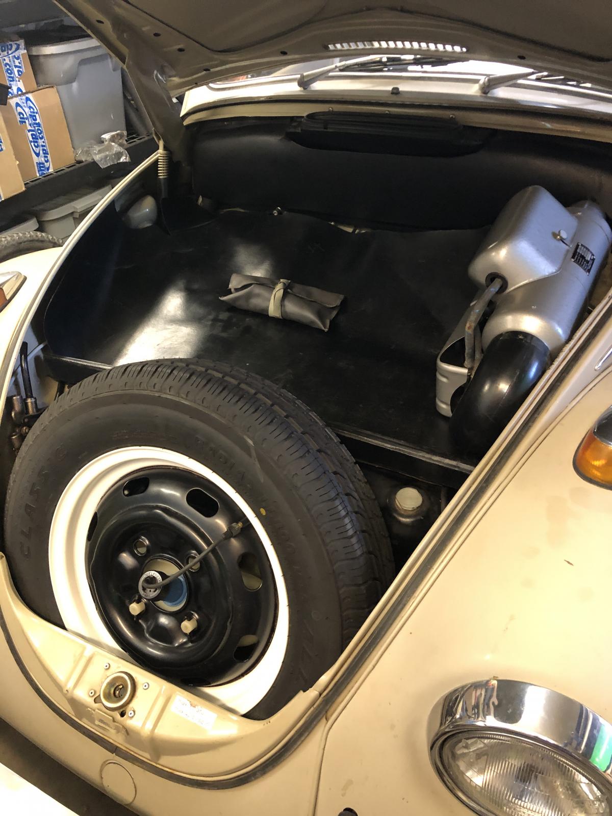

Here's the gas heater in my 1969 Canadian Beetle. It is turned on and off by a knob under the dash underneath the speaker. The heat is pretty much instant and blows right on your legs. Some other versions were installed above the transmission and connected between the heat exchangers and heater channels. Separate fuel supply lines connected to the fuel tank.

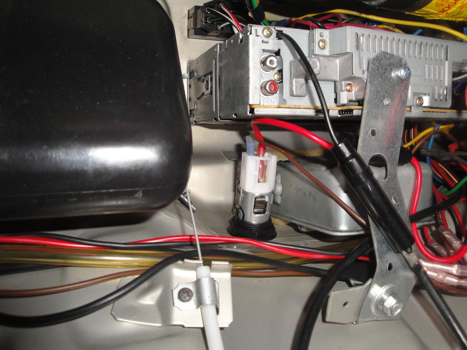

Installed a Power Supply (Cig lighter style) under the dash. Be nice to have the ability to charge a phone.

the dash hole would have to be enlarged foer the lighter accessory. It looks to be 14mm, which would only fit something like a swittch such as headlight, warning lamp, fog etc. I wonder if having a cigarette lighter placed elsewhere other than the dash might work better.

The fog switch suggestion is also good. I've noticed there are a few different ones. Is Orange for rear and green for front? I've seen quite a few different cap designs and it seems they were shared with Porsche too even if they had VW stamps on the unit.
