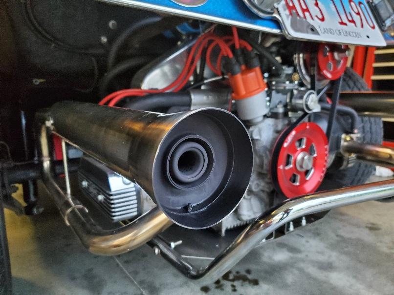

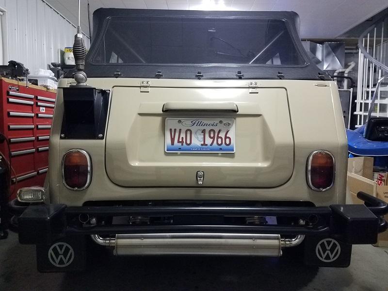

I tried the baffles made for my dual cannons on my buggy and wasn't impressed, so I welded stainless steel beetle pea shooters in them. It works surprisingly well, is cheap and fits the character of the car.
I tried Empi's tri-mil copy and it was terrible loud. By far the quietest thing exhaust out of several I've had is the vintage speed unit. It's expensive but it's really nice.
https://store.vintagespeed.com.tw/SS143-VW-THING-Exhaust-System-p546809292
It looks like they have made improvements since I bought mine, but wow the price is up.
