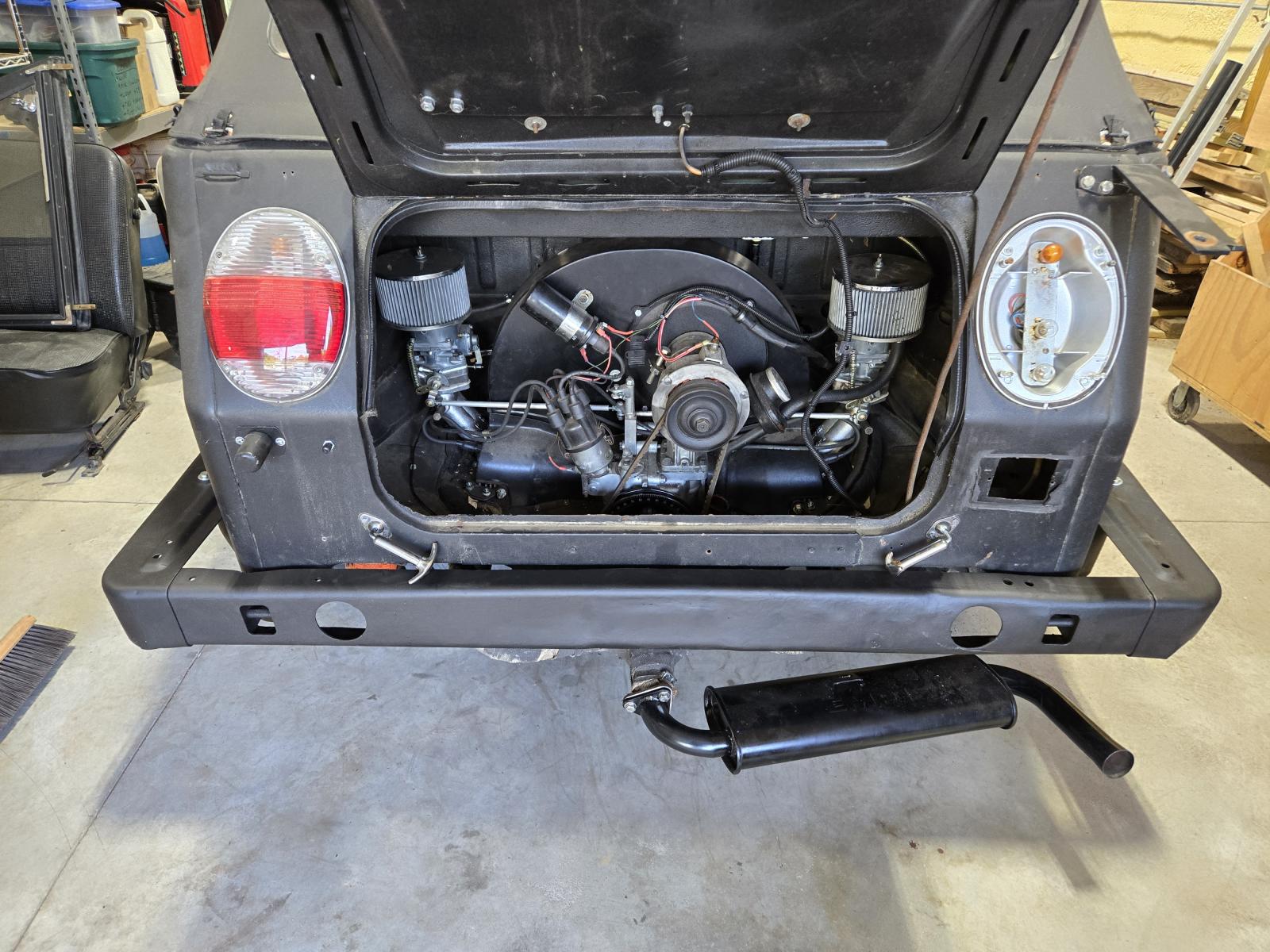

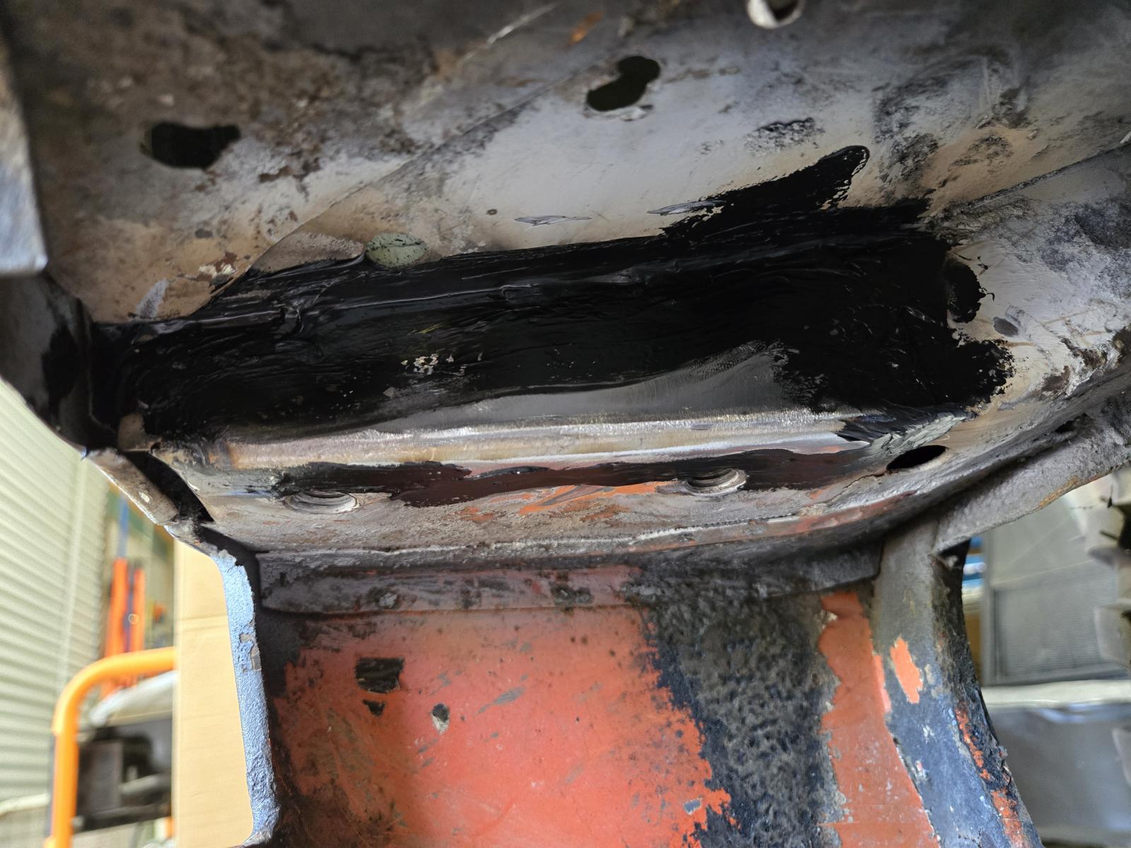

Good enough for me.
Once the seam sealer is dry I will shoot some black on it and be able to hang the bumper.

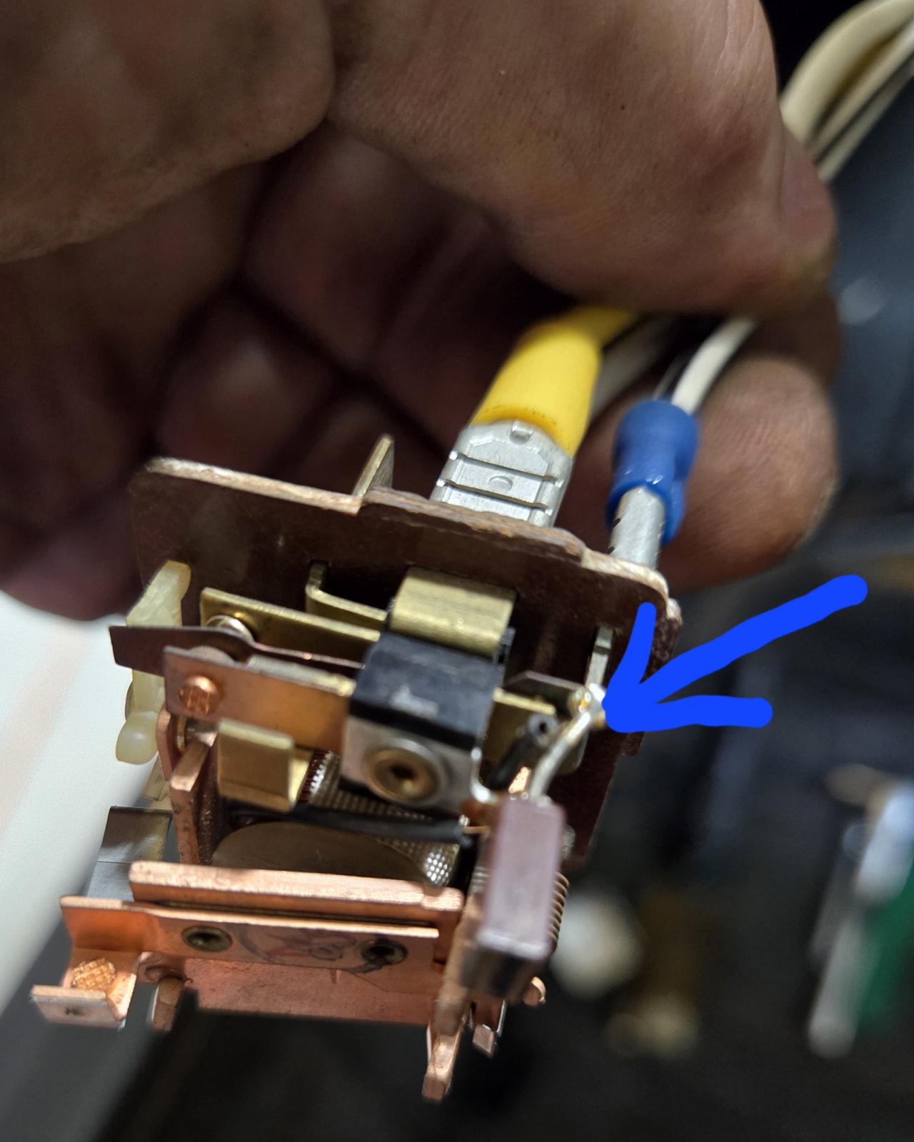

I figured I would look into my highbeam issue.
I tested the relay with a direct ground and got butcus.so I took it apart an discovered I could manually switch to highbeams. A clean ground to the S terminal does nothing.
I posted pics if the inards in ha highbeam thread.

On closer inspectionof my headlight relay I discovered a single broken wire. I had to dawn a set of 1.50s and 1.00s on top of on another to make it out. Lol.
I was able to carefully solder it and, tahdah! Highbeams are working!

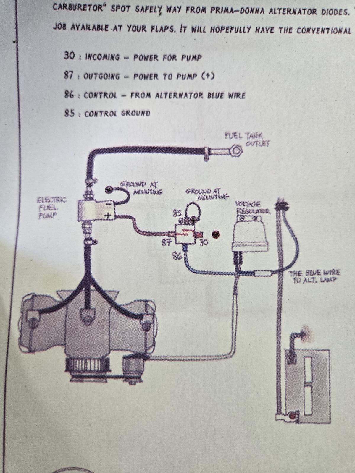

I was also able to finally get my fuel pump relay working right. There are so many different descriptions of how to do it here I tried a bunch of them and none did what I wanted. I finally found Colin Kellogg's diagram on his site and it was the ticket.
I hope he does not mind but I thought I would repost it here. I added a switch to a power source at 87 in the event I need a prime. I know thisnis not so popular but it seems to be working just fine.
His diagram and explanation made far more sense to me than a few others.

Darn it. The BN-4 fan is hitting the edge of the driver's side shroud when it runs. Makes a racket. Confused
And among all the construction I seem to have lost the headlight switch knob. Crying or Very sad
But the bumper is back on the rear and I fashioned a hangar for the muffler. I need to go buy a threaded hook though to complete it. Pics of that when done.

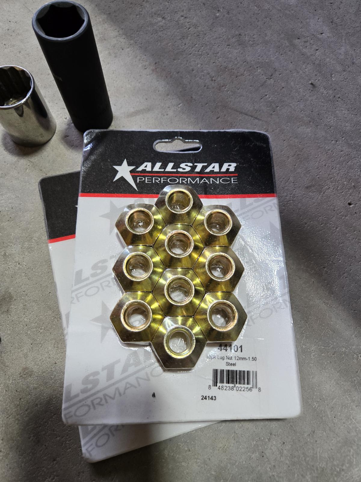

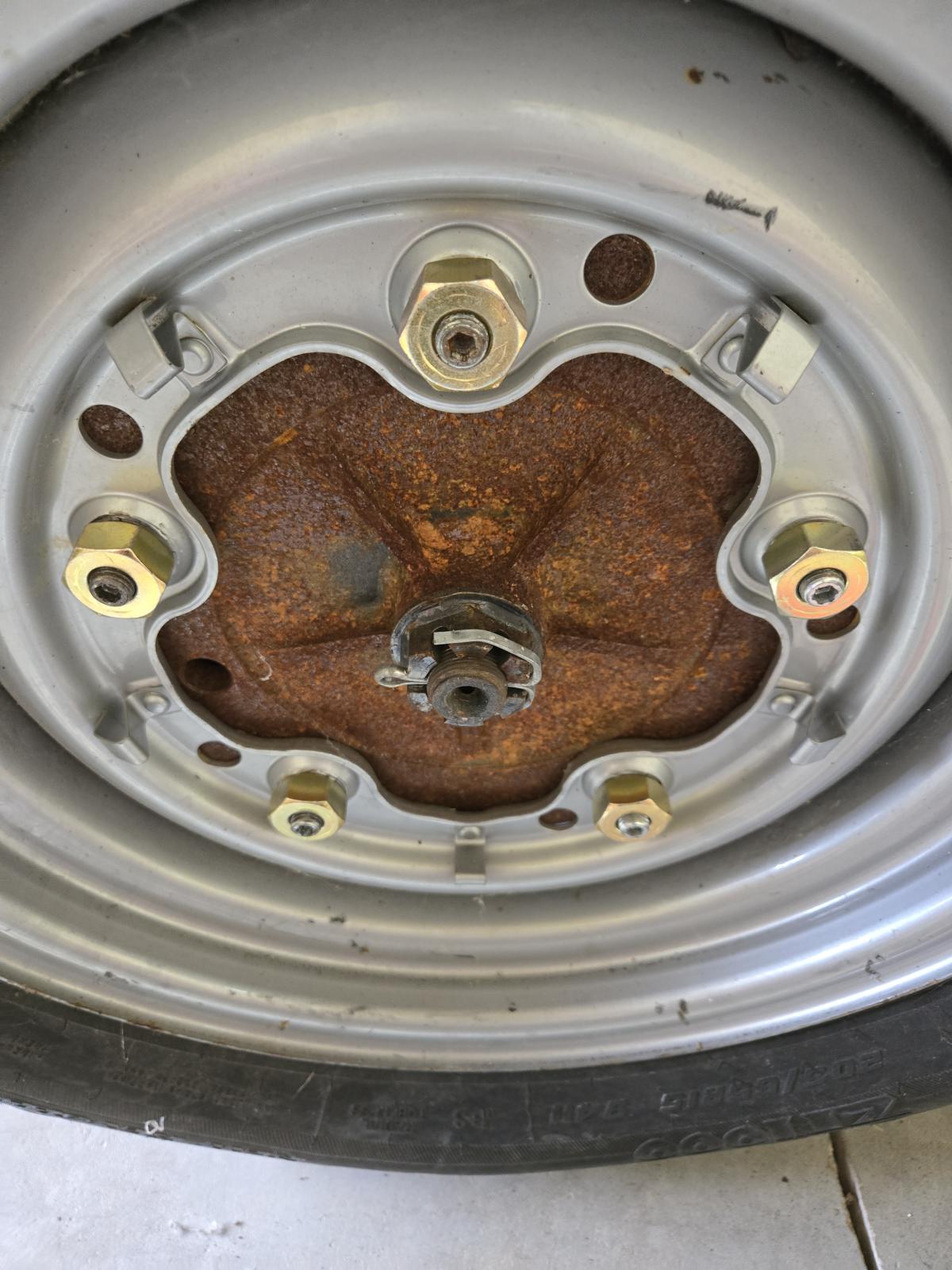

But I did install the new 1" lug nutsfrom Summit. So much better.

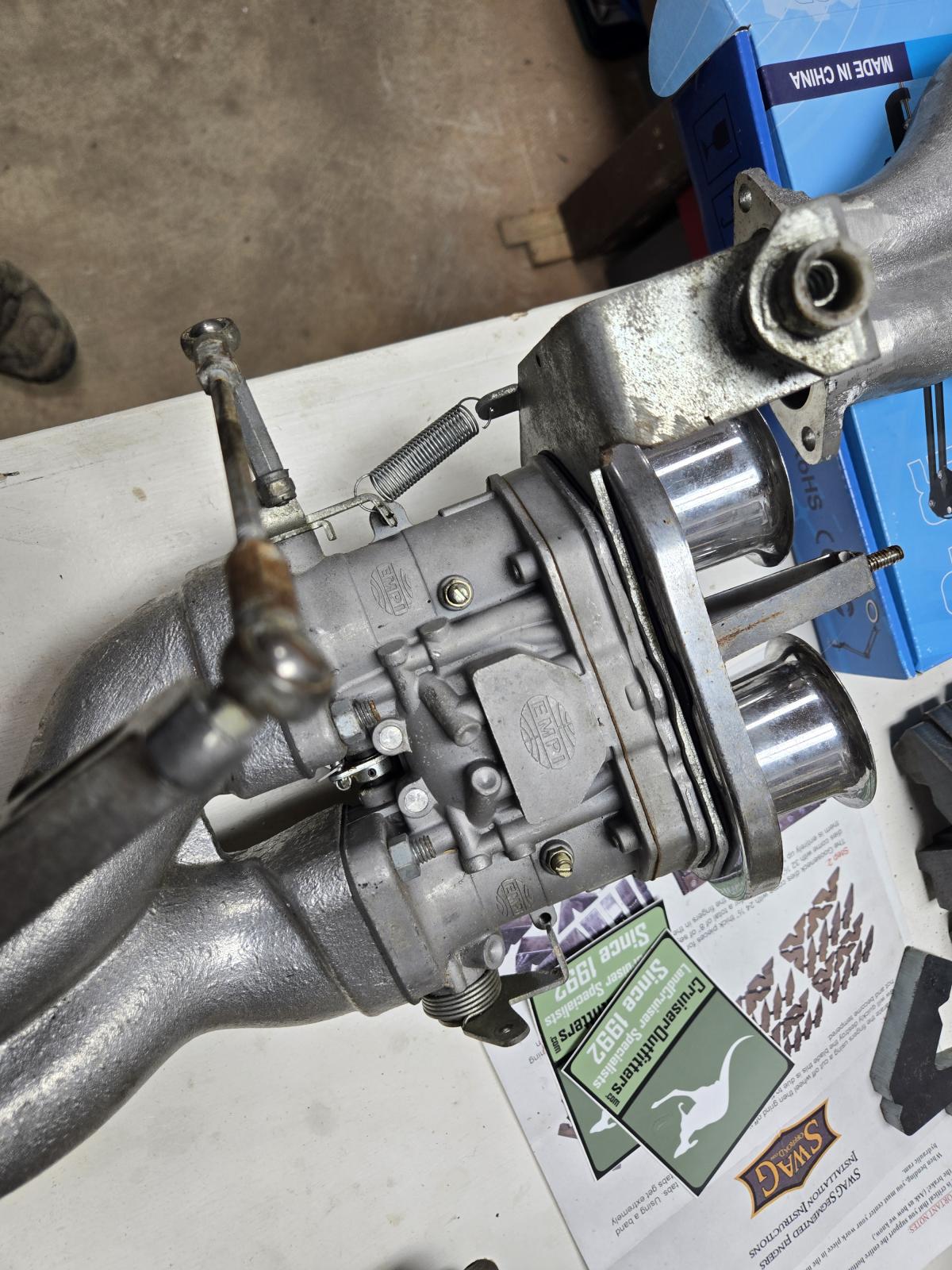

Carbs are the death of me.
I have always ended up buying new ones. Rebuilds always fail - even on little Honda C90s and I have had about 4 of them.
I swapped the carbs PS to DS and the one that was giving me trouble is goving me the exact same trouble. Flaming up, backfiring up the carb. I used a refresh kit and replaced the accelerator pump, main gasket, cleaned the screen and put in a new needle and seat. Same. Backfires up the stack.
I disassembled and reassembled the dizzy and now I seem to be getting the static timing where I need it at 7.5 BTCD. Tells me the dizzy is likely buggered too. Who knows, maybe I was doing something wrong. After all, I haven't static timed a vehicle in probably 12 years. I would gladly admit it if I did and got it going.
Anyway. Kadron 40 backfiring up the intake. I even tried to lean it all the way out and unscrew the accelerator pump nut all the way. Shoupd I go thenother way with it all? The other one is acting fine.
I know I have a f#@ked carb but why and how?
- 1973 Thing, some LandCruisers and an old Ambulance

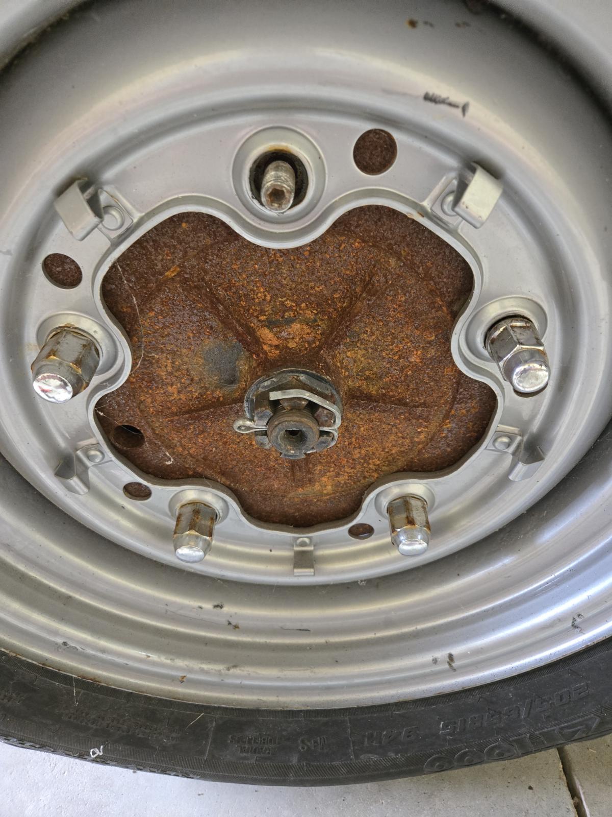

It's hard to tell from the photos but are these wheel nuts a cone seat or ball seat? (they appear to be cone seat type)
VW stock wheels use ball seat wheel nuts. Cone seat will 'sort of' work but be careful.
SL
Heiferman
Joined: February 28, 2024
Posts: 210
Location: Georgia, USA
Heiferman is offline
PostPosted: Wed Sep 25, 2024 8:13 am    Post subject: Re: North GA 1973 Veteran's Addition Reply with quote
germansupplyscott wrote:
Those are not stock wheels.
Edit: I went back and looked. The spare had 45° but close examination appear that someone may have modded them. The rest are ball as you pointed out. Evil or Very Mad I ordered another set. I guess I will use these on my Toyota. Thanks for the reminder and to make me check.

Finally got it running. I pulled the angry carb apart again and replaced the two lower gaskets as well as both manifold gaskets on the passenger side. Pulled the jets as well as the fuel inlet and cleaned all that. Also redirected the accelerator pump jet by moving it some and pulling it a good ³/8 inch up. Bingo. It seems to really like advanced timing. I was well past 32° and around 38°. Anything less and it backfires out the passenger carb. I assume it is the hot cam it.
I also think my cheapo fuel pump blew out the Holley fuel regulator. I had it set below 2 psi and when I was bringing the idle up the needle jumped to 7, was super bouncy and pretty much stayed there. The pump I have is rated 4 to 9 psi and I guess that was too much for the little Holley to handle. I went ahead and ordered a smaller pump and a new diaphram for the regulator. Probably should get two.
But at least it ran.

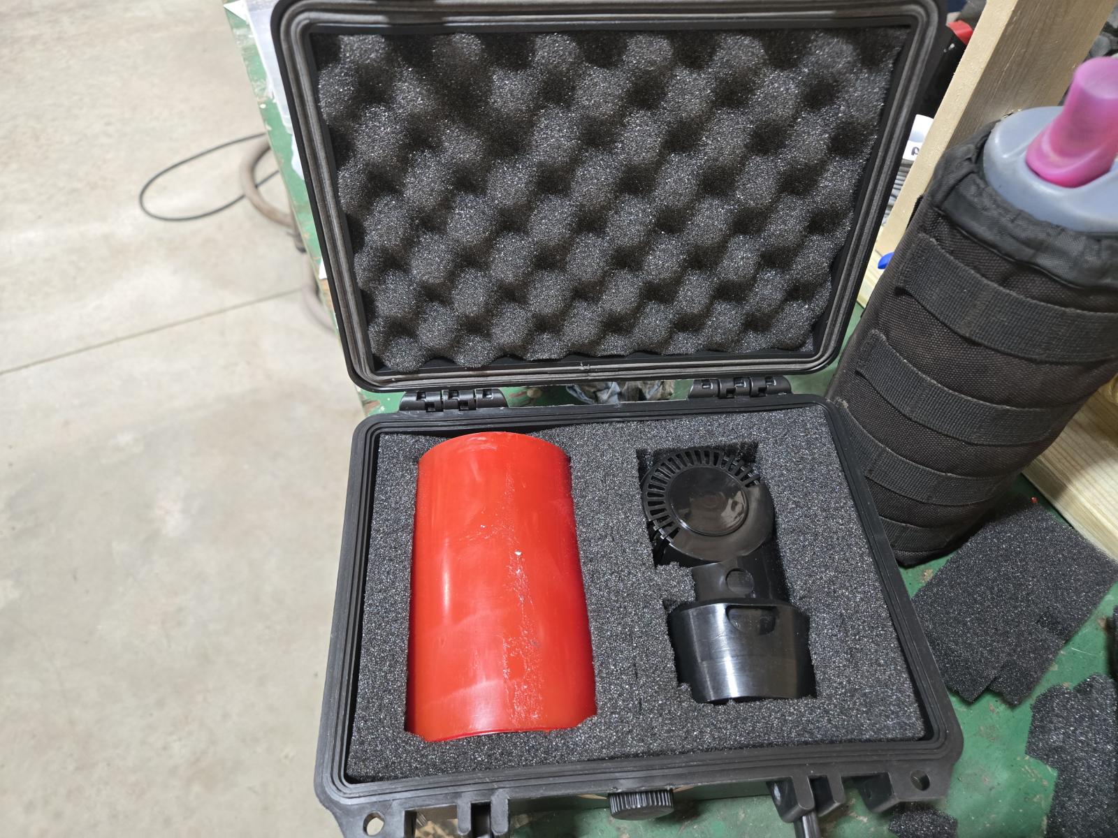

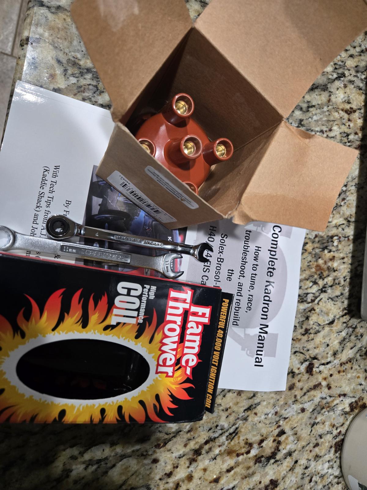

Got some goodies today.
The book has a whole section about distributors that would have been very helpful.in this endeavor. I.may be dumping my 009 for and svda.

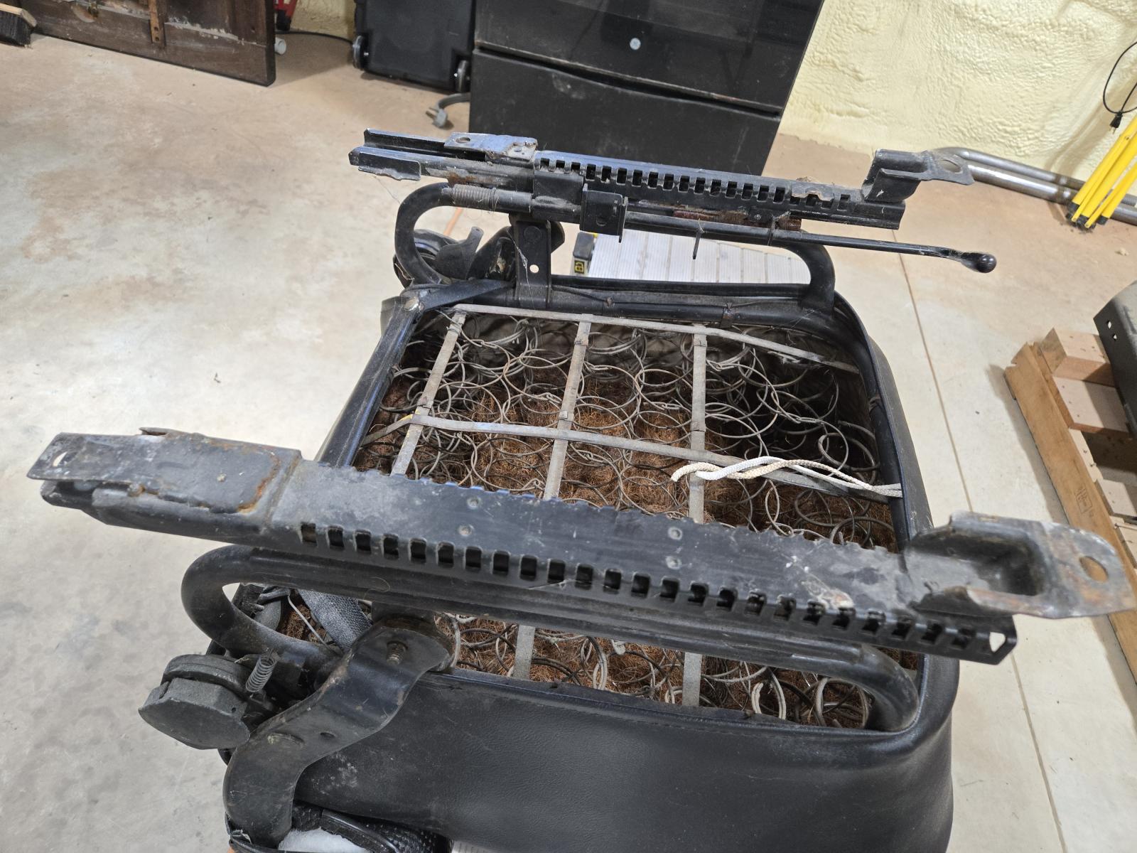

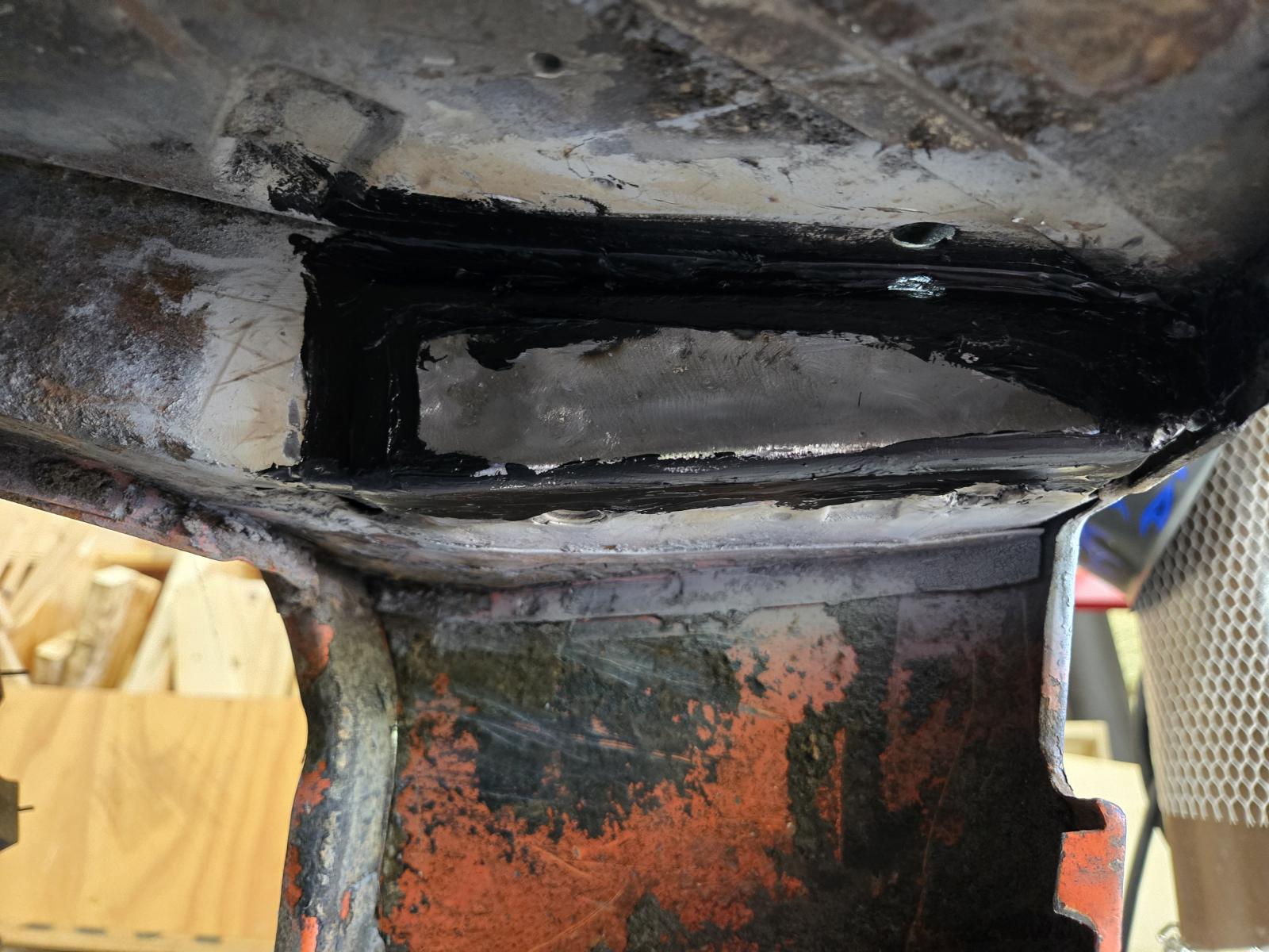

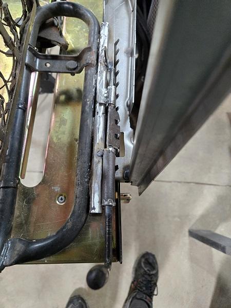

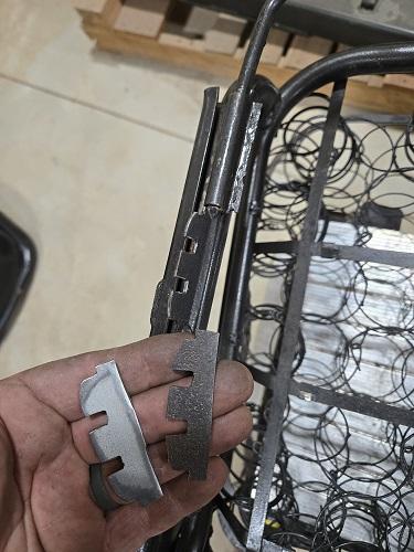

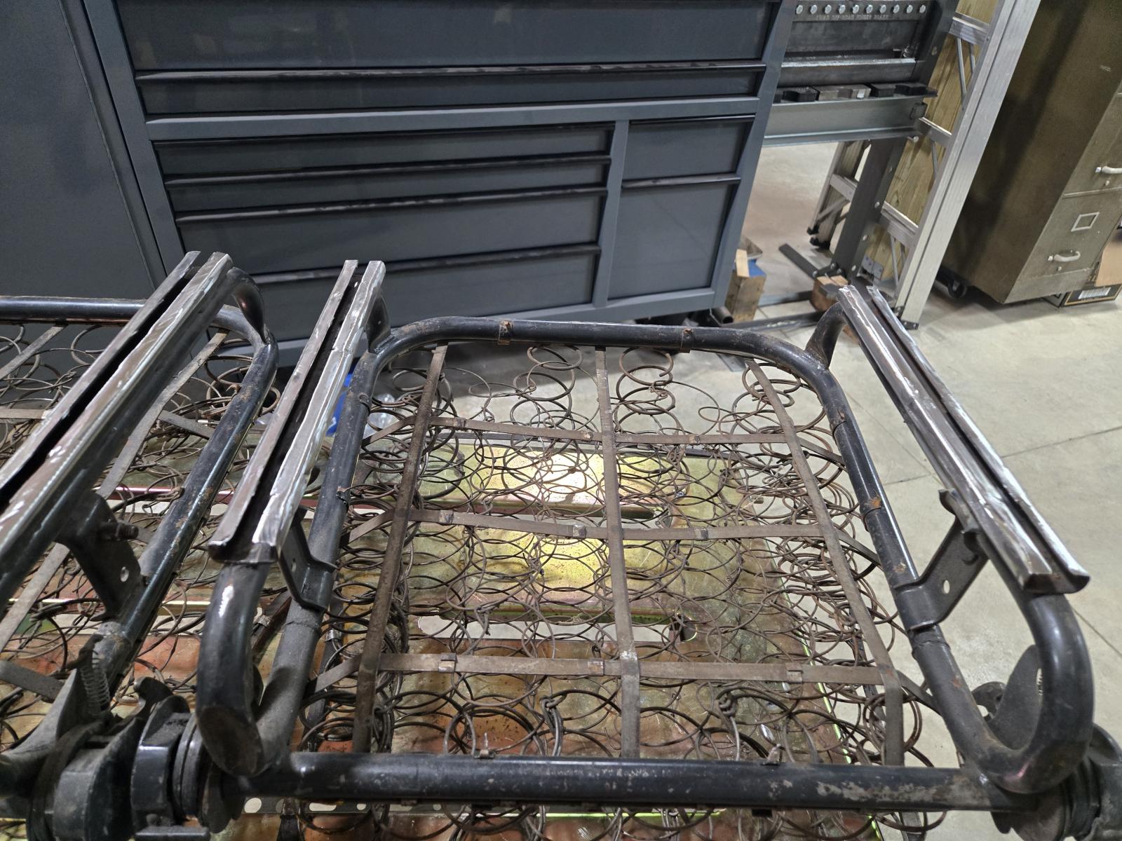

Worked most of the day on removing the bodged rails that were welded to the bottom of the front seats then repaired the channels.
What they were:
I cut all that crap out and repaired the channels with bits of steel from what was removed. Lots of cutting, fitting and grinding to get the patch pieces in. I failed to take pics when the sliders were removed.
Pretty gross. 50 years of sweaty ass.
They had been recovered once and now have covers on them.
Now:

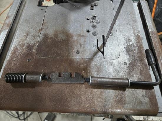

Next is to figure out fabbing the slide release/lock. I have a plan.

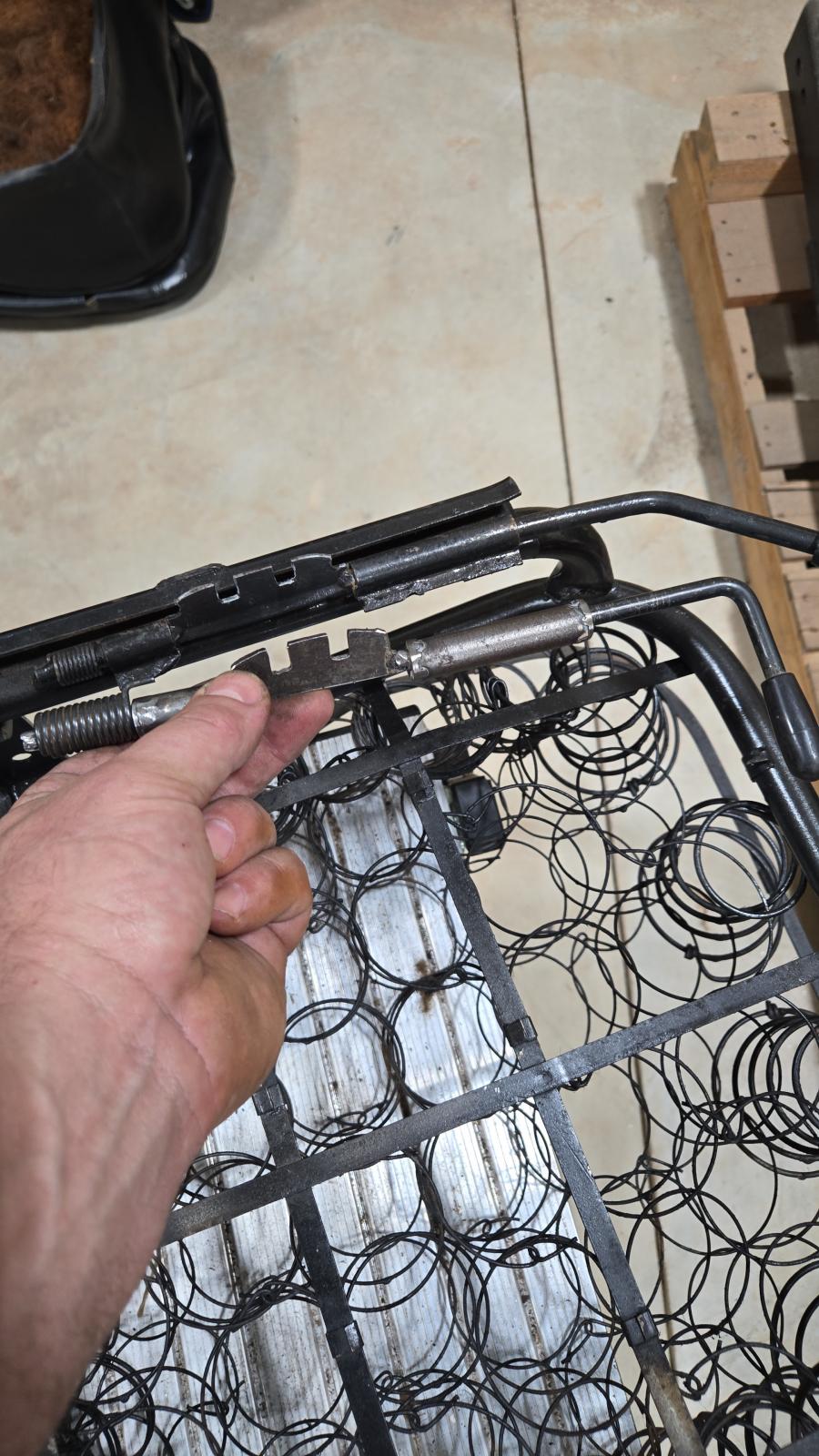

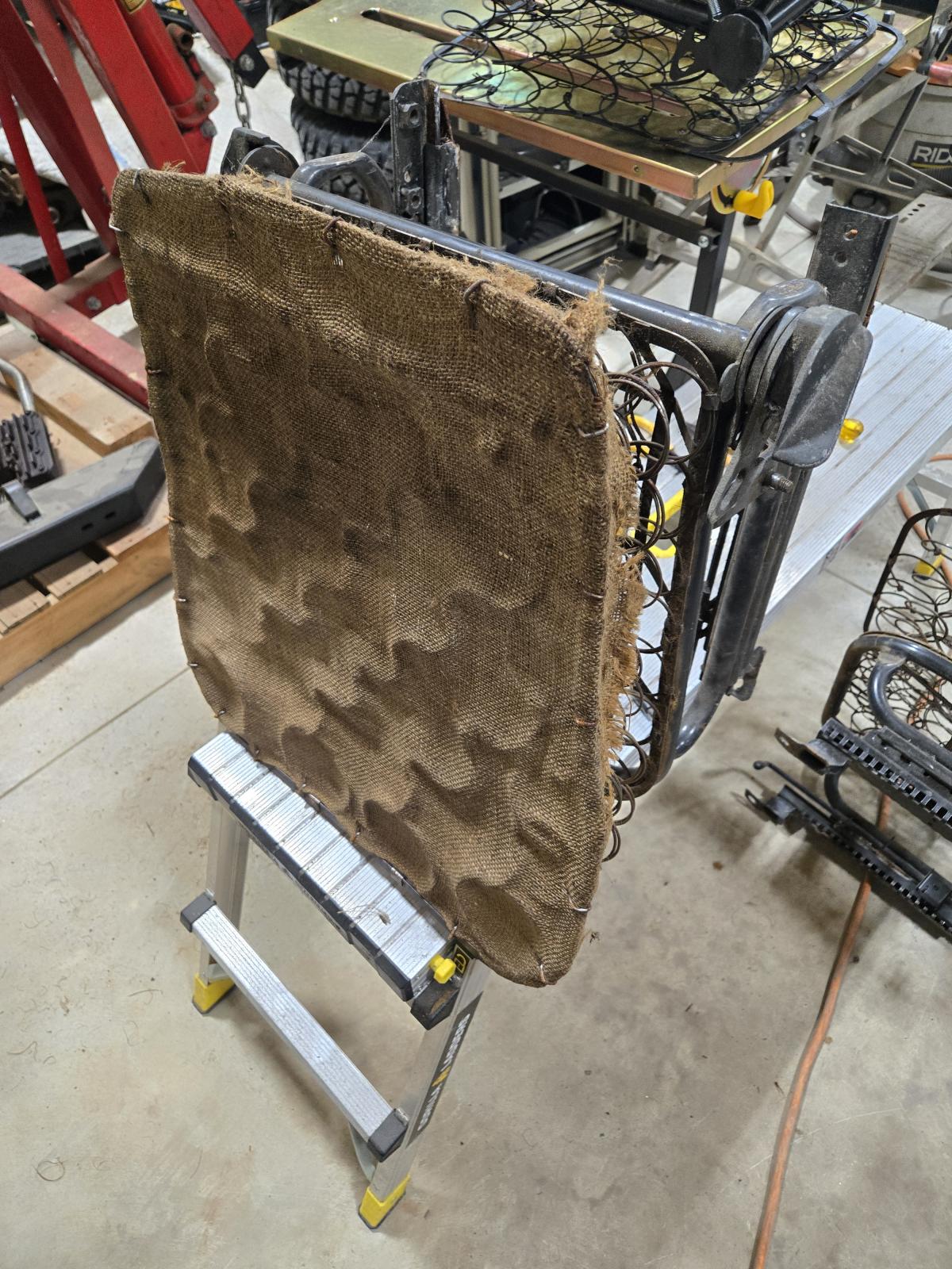

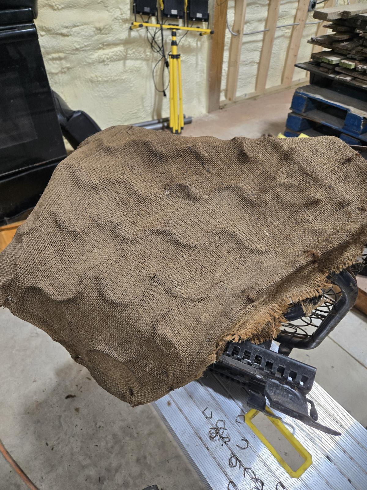

I worked on the seat bottoms some more. I am having trouble finding a torsion spring that will do for me. The one I have is a bit to big in diameter. McMaster Carr does not even have what I want.

New aftermarket hub caps on the way
