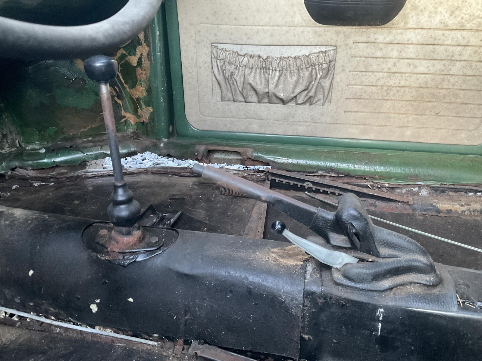

I recently started my beetle journey over a month ago, bought a 1971 super beetle that stuck behind another car in an older mans garage stated to be garage kept, i inspected the car, saw the usual rust problems, floor pan, rear quarter panels, heater channels, i sadly wasnt able to see the front underside due to the way it was positioned in the garage and i was surprised with the whole front end from the spare tire trough below completely rotted out. i was prepared for a floor pan job and heater channel work. but now theres not much for the floor pan to be welded too... now after pricing out parts i am up to 4k... would il be wiser to just purchase a VW in better condition. and enjoy the restoration process a little more and part this 71 out?
i am a beginner welder/automotive techie, i was a heli mechanic in the army so im not completely inept. not even sure what im looking at here with this extent of rot.

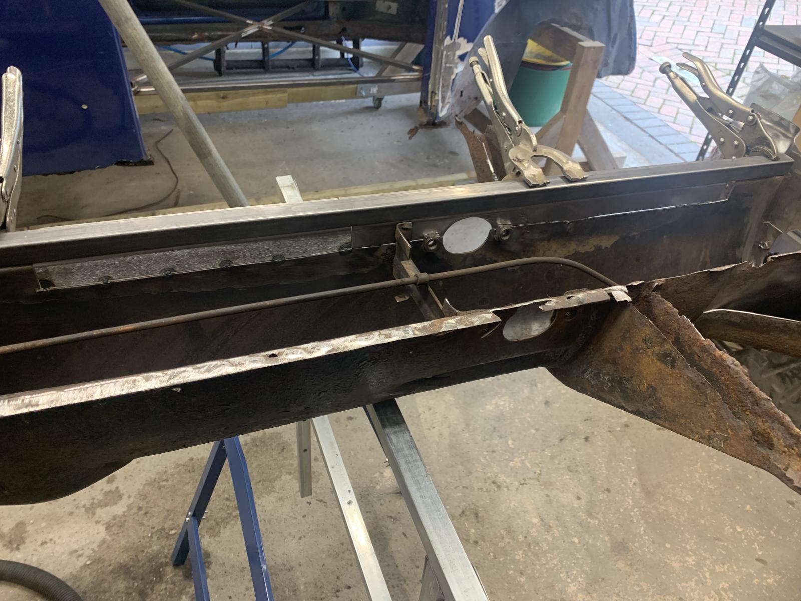

The 67 I am restoring is in a similar state. Beetles don’t weather well in the UK and the identity of the car is tidied to the chassis so I am battling it as we speak.
It looks like you will need to replace the tunnel flange that the floor sits on as well as the floors a possibly the heater channels, it will just spiral from there. The thing is there always more rot than you think and before you know it you will be into a full rebuild.
It might be worth looking at a donor pan if they are available in good confdition where you live.

Are the flat edge along the tunnel that the Floorplans weld to rusted off?
That's the only area that creates and concern for it being do able.
The rest of the areas are common to rust out, just usually not to such an extent.
The passanger side, completley all along the edge... driver side is rotted about 12 inches at the very front of the car. this exactly was my main concern. watched some great videos and read some good threads on floor pan replacements and that lip is quite very importnant, haha.

Tunnel lip is easy but its about a deep as you will ever go into restoring a beetle!

Sadly, it's probably just good as a parts car. Based on what I see and your description, I'm betting that the crossmember that mounts the lower suspension is rotted out, and even if it isnt, where it bolts to the front lower body surely is. I've don't that repair for someone once, and I will not ever do it again.

As above, the bottom 6 inches of the car was rotten so was the frame. The floors just fell off with some weight on them and the framehead was rotten on the bottom. You will need to strip EVERYTHING and remove the bottom tunnel plate. Unfortunately if you want a beetle you can drive in the next few years might as well buy a better one as this rot doesn’t have a quick fix!
