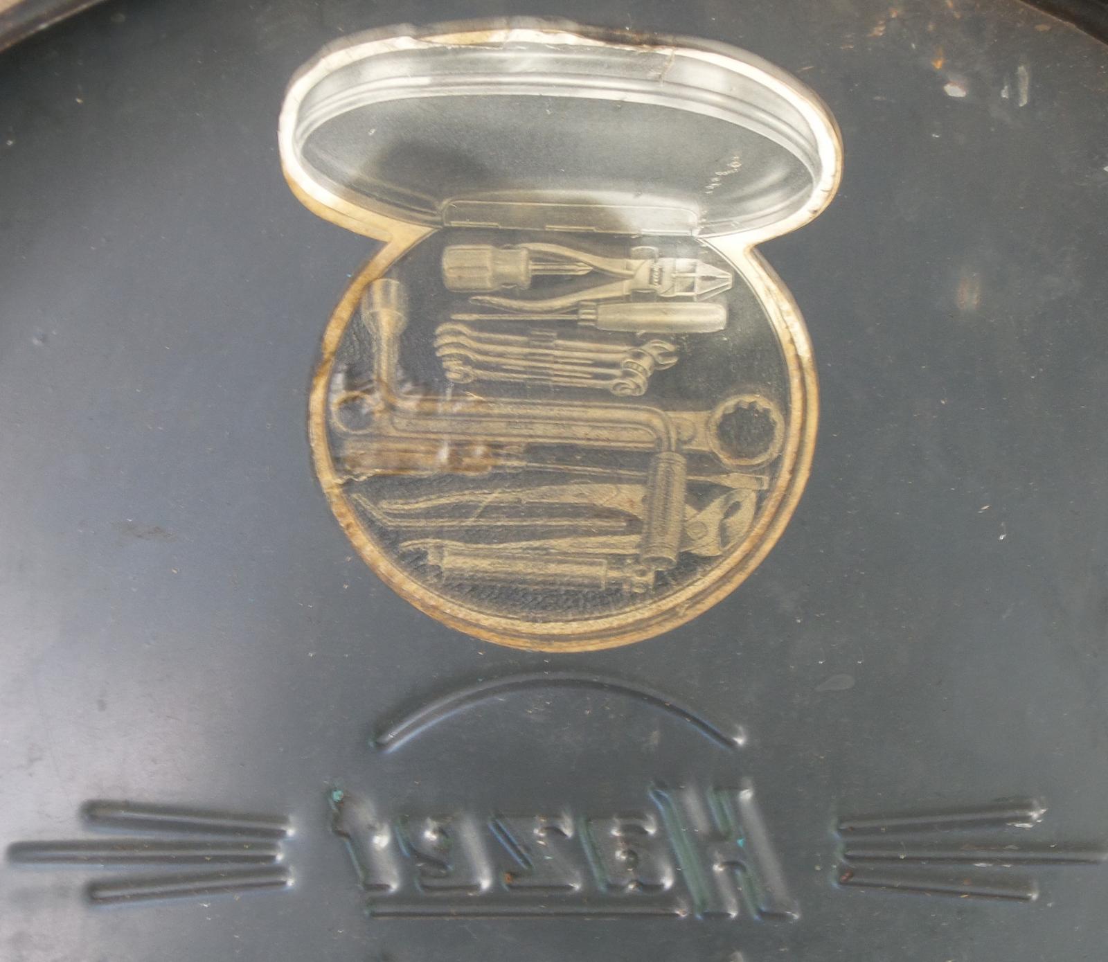

Hazet catalog/brochure images:
style 1:
style 2:
style 3:
style 4:
style 5:
style 6:

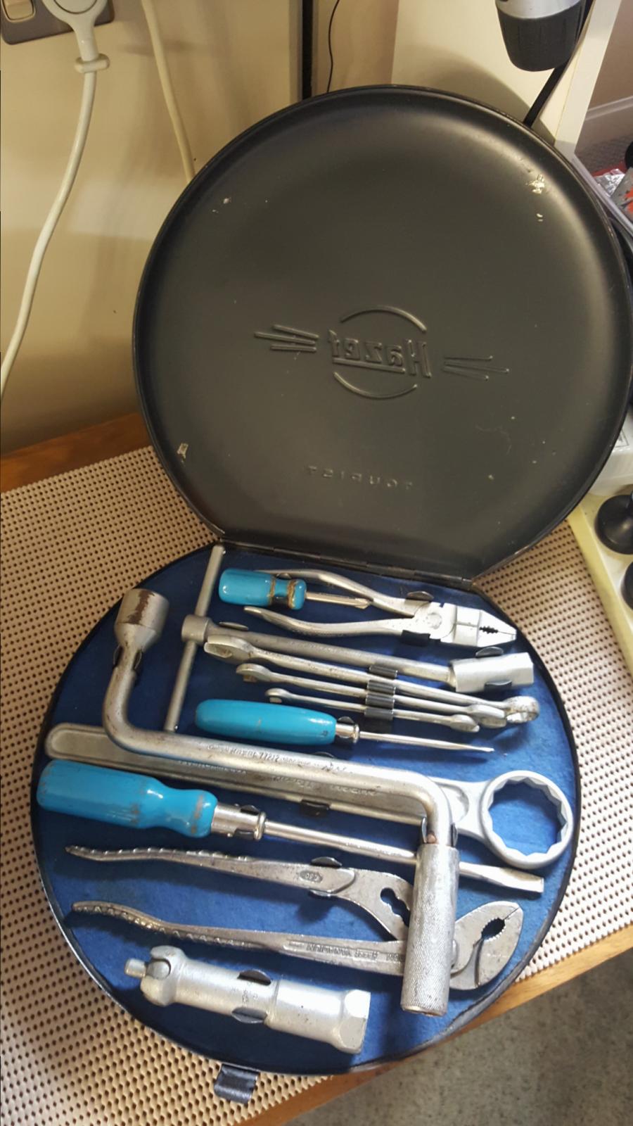

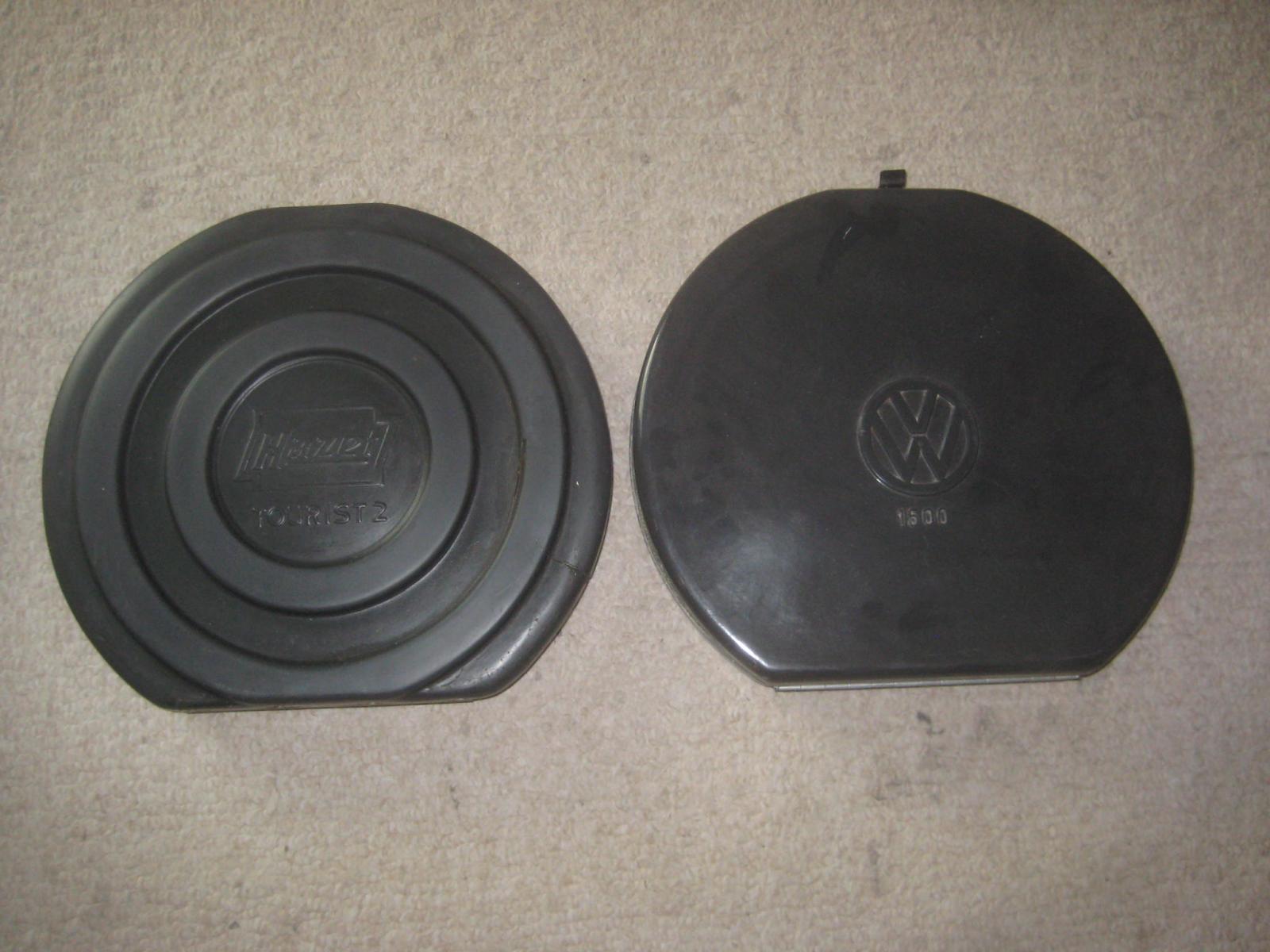

I want to include everything that is known about these kits. here are some simple facts which I believe to be true:

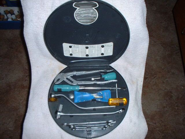

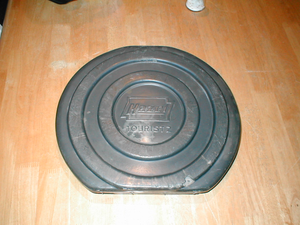

The kits with VW stamped on them were sold through VW dealers
The kits with Hazet tourist stamped on them were sold through the aftermarket, or could have been sold through dealers.
Both style lids were produced concurrently through the production run.
VW box:
Hazet Tourist box:

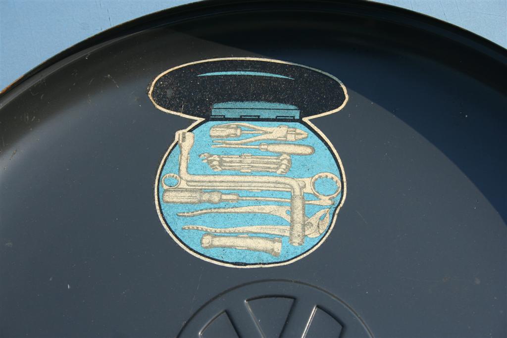

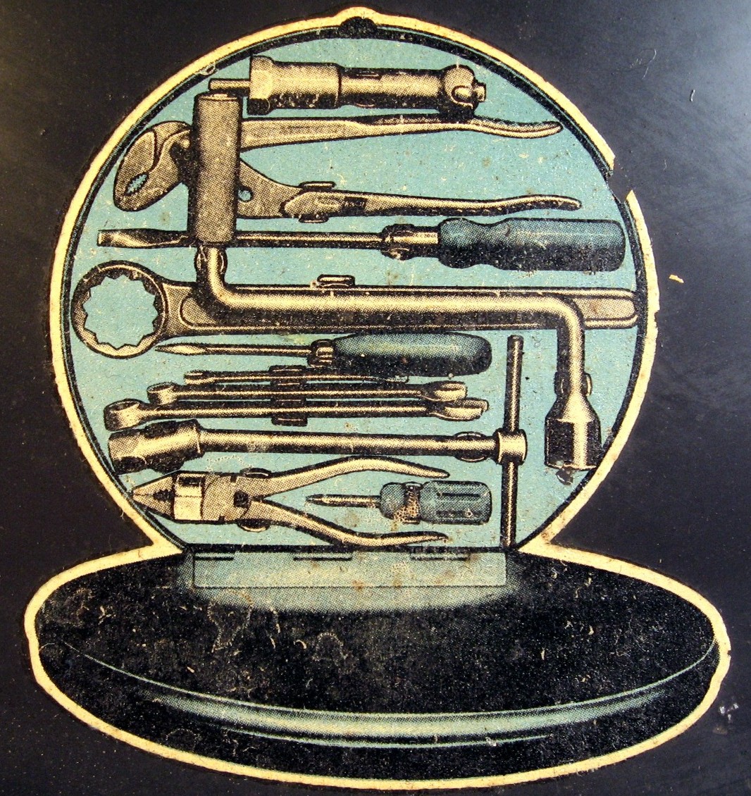

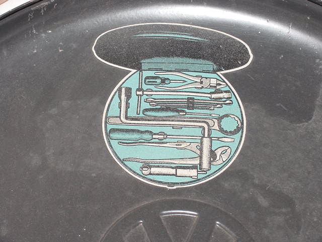

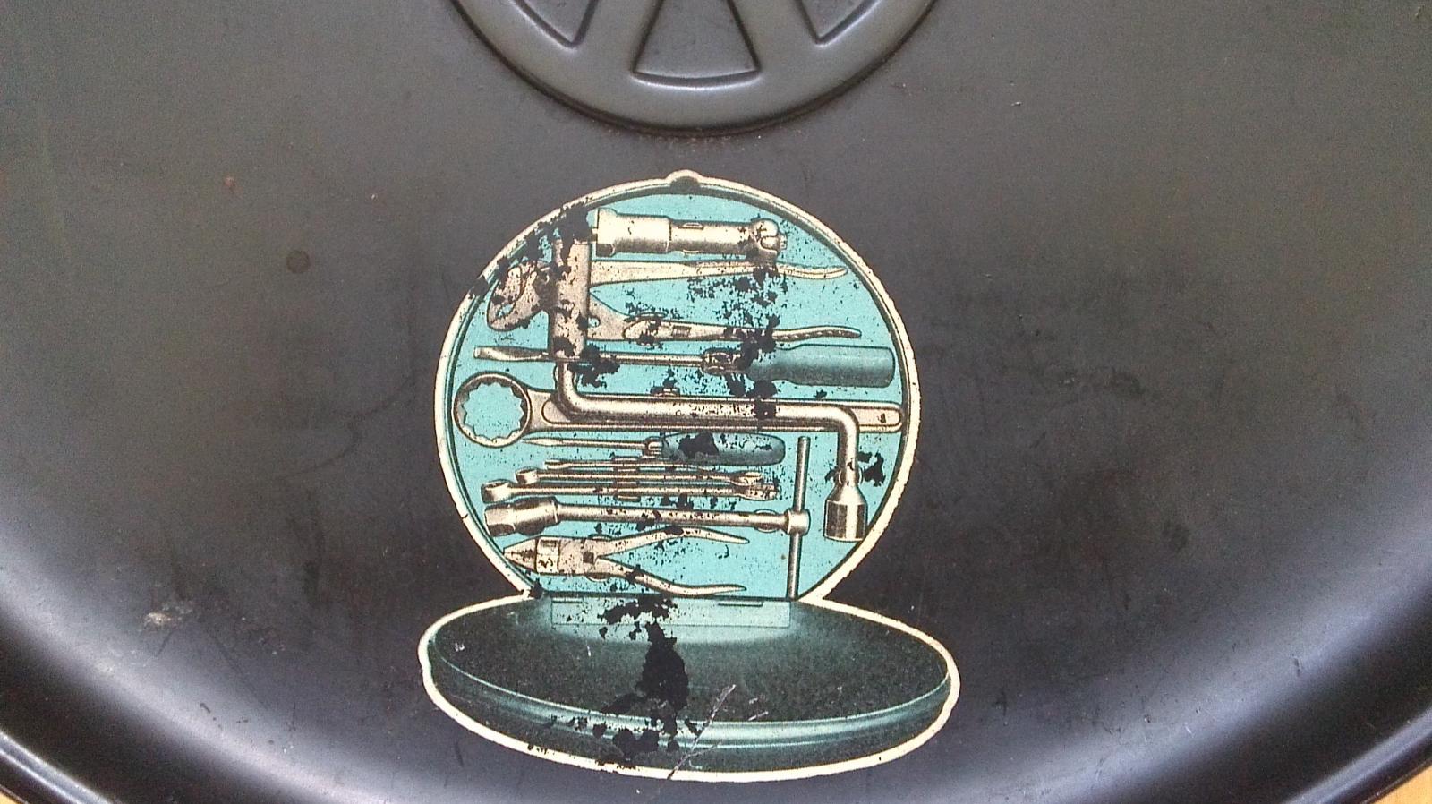

The decal in the lid may not match the tools inside the kit.
early kits have felt under the tools.
later kits have flocking on the tool side of the inside of the kit.
some kits have neither felt or flocking

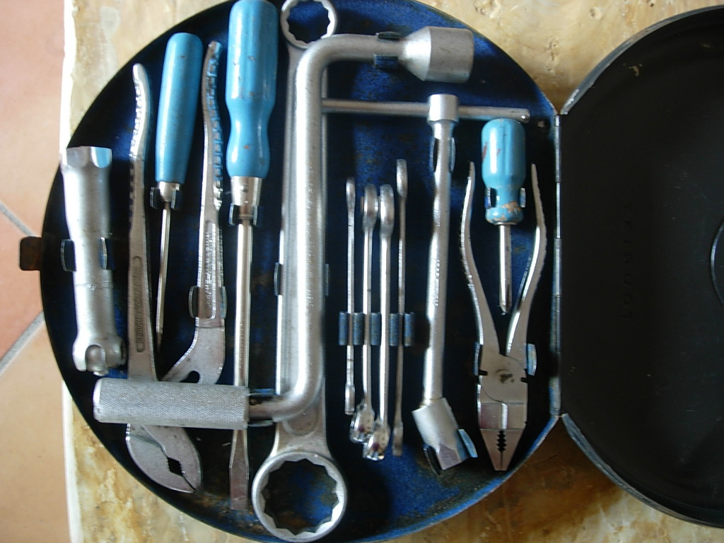

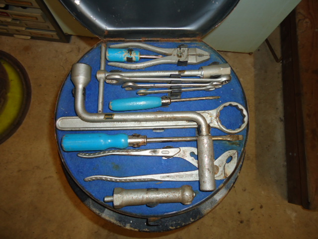

PostPosted: Sat Apr 08, 2017 6:30 pm    Post subject: Re: Hazet spare tire tool kit versions Reply with quote

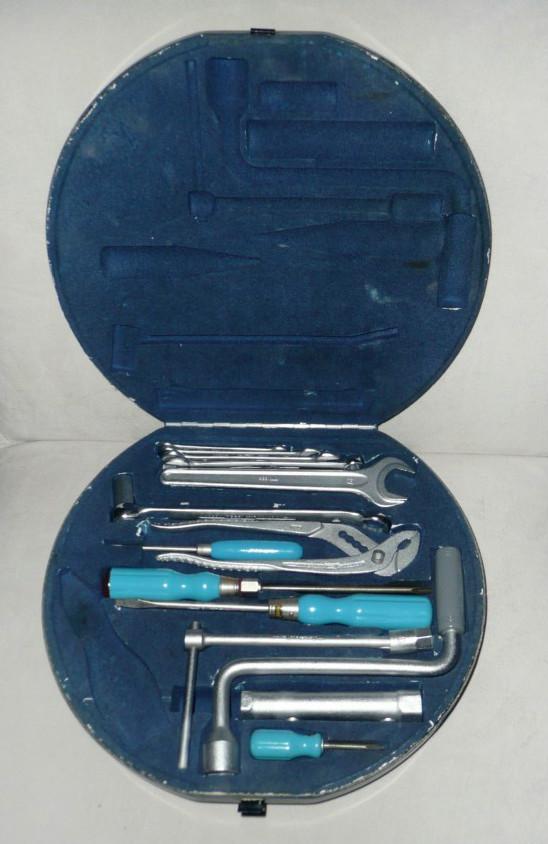

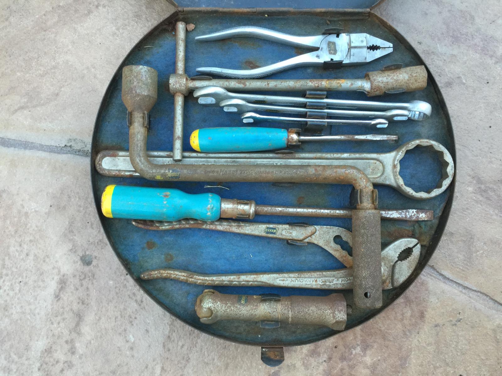

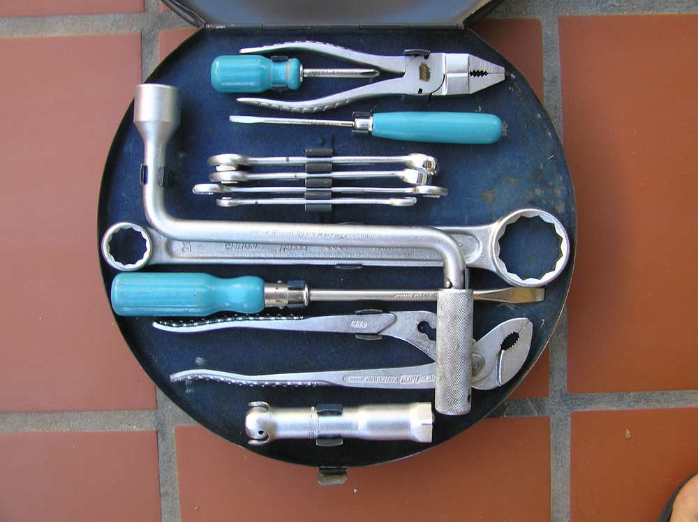

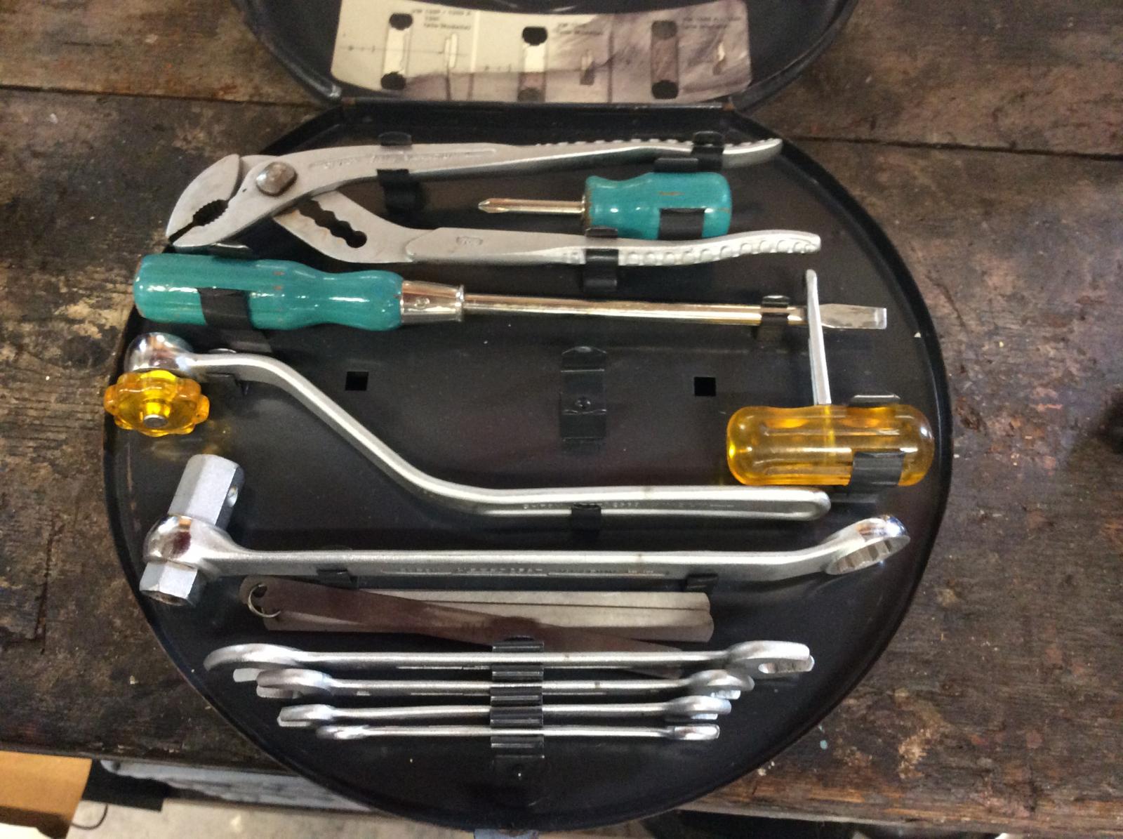

V1.1
"16 inch" kit
full circle ring on back
felt lined
11 tools:
1850 small pliers
527 14mm T handle wrench
600 14mm wrench
600 10mm wrench
450 7x9mm wrench
813 flathead screwdriver
772 lug wrench
561 36mm wrench
811 flathead screwdriver
760 slipjoint pliers
764 sparkplug wrench
Note:
full circle ring
no phillips screwdriver
yellow ends on screwdriver handles
Wanted:

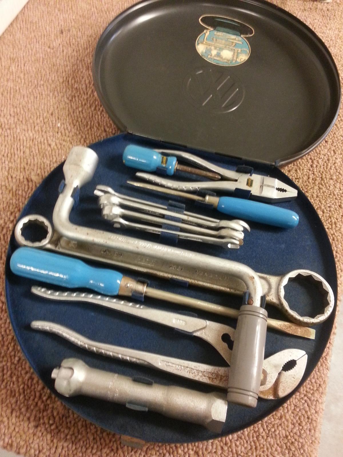

PostPosted: Sat Apr 08, 2017 6:32 pm    Post subject: Re: Hazet spare tire tool kit versions Reply with quote

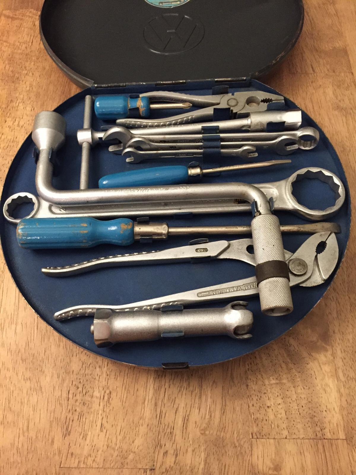

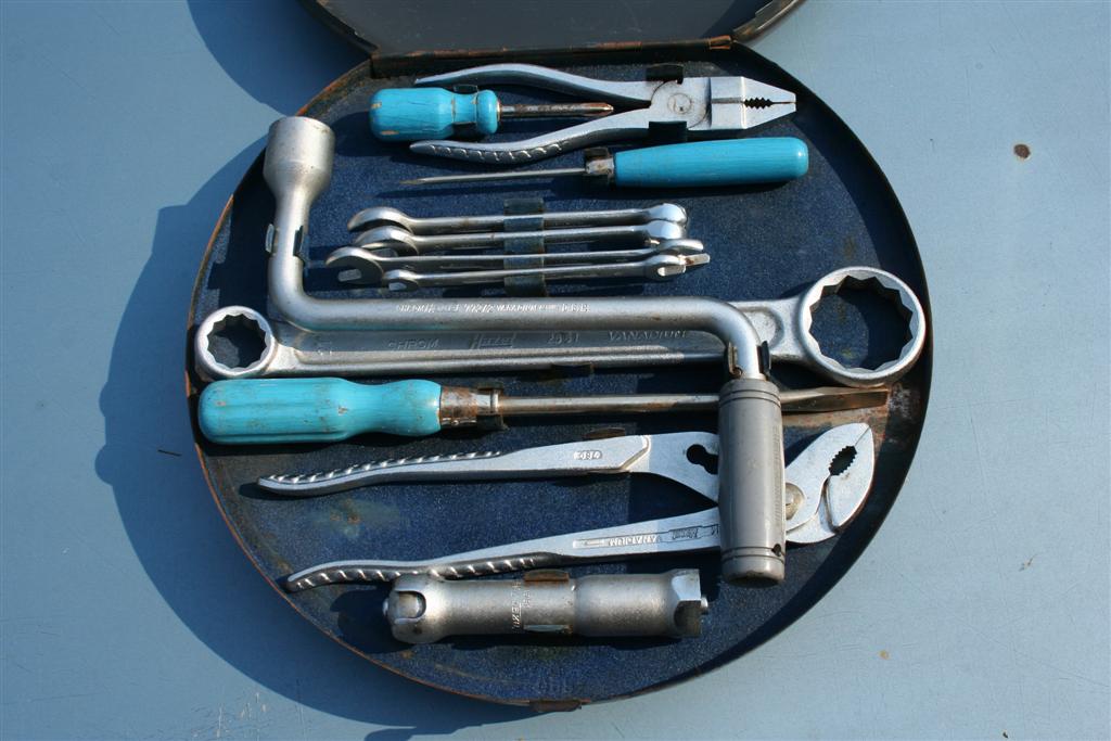

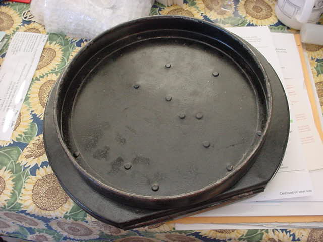

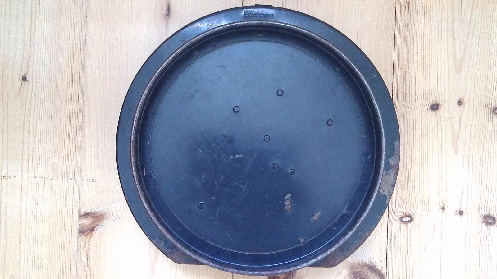

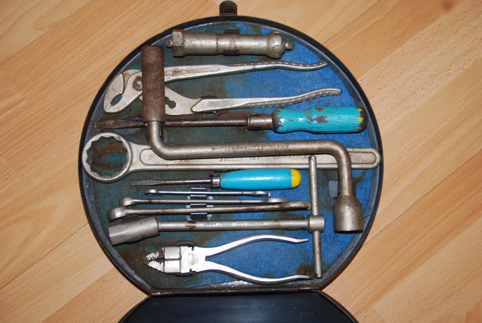

V1.3
semi-circle ring on back
felt lined
12 tools:
1850 small pliers
813 phillips screwdriver
2527 14mm T handle wrench
600 14mm wrench
450 10x12mm wrench
450 7x8mm wrench
772 lug wrench
2561 36mm wrench
Note:
early variations have a felt liner under the tools
later variations have flocking on the tool side of the inside of the box
early variations have a 36mm 561 wrench
mid variations have a 36x21 561 wrench
later variations have a 36x21 2561 wrench
flocked
Wanted:

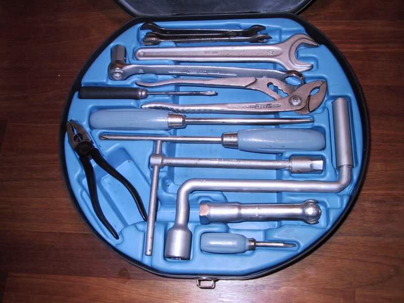

PostPosted: Sat Apr 08, 2017 6:33 pm    Post subject: Re: Hazet spare tire tool kit versions Reply with quote

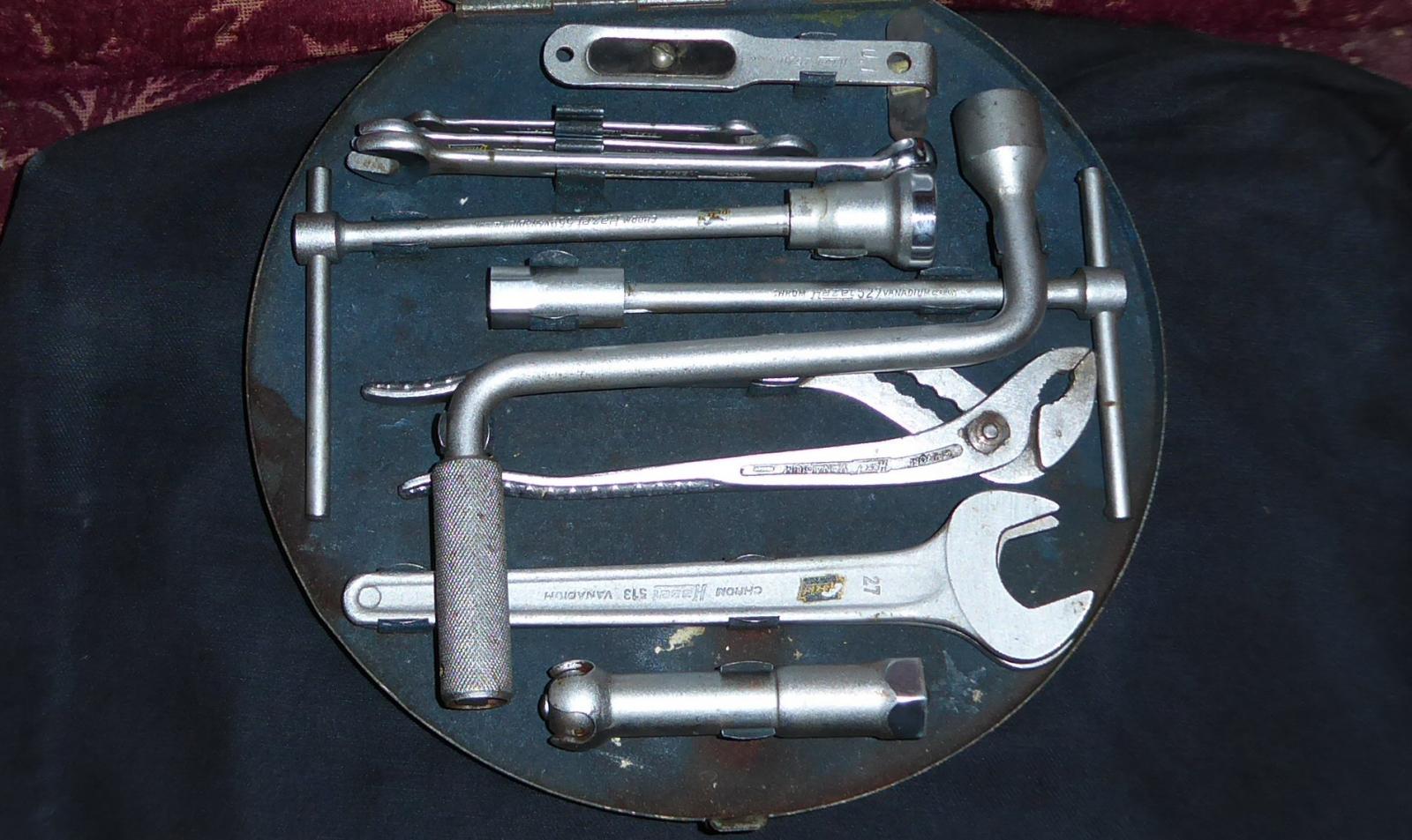

V1.4
13 tools:
1850 small pliers
605 14mm wrench
605 13mm wrench
450 10x12mm wrench
450 7x8mm wrench
772 lug wrench
2561 36mm wrench
FRK wrote:
'60 (One Year Only) Spare Tire Round Tool Kit
Wanted:

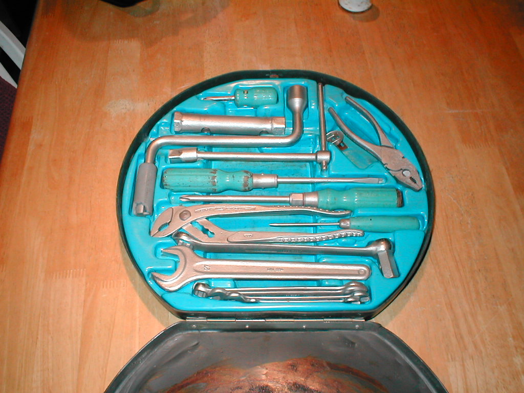

PostPosted: Sat Apr 08, 2017 6:34 pm    Post subject: Re: Hazet spare tire tool kit versions Reply with quote

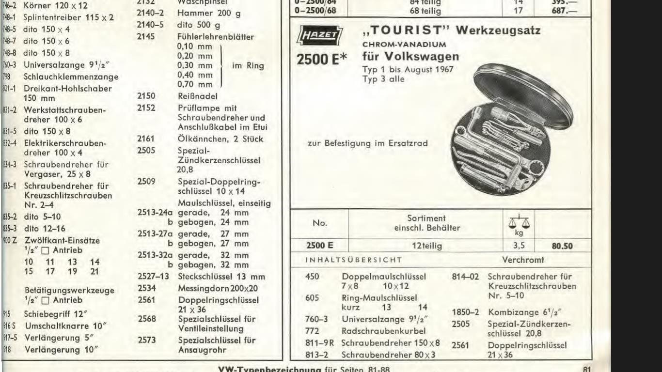

V1.5
12 tools:
1850 small pliers
605 14mm wrench
605 13mm wrench
450 10x12mm wrench
450 7x8mm wrench
772 lug wrench
2561 36mm wrench
Note:
earlier variations have metal handle 772 lug wrench
later variations have plastic handle 772 lug wrench
Wanted:

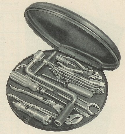

PostPosted: Sun Apr 09, 2017 4:25 pm    Post subject: Re: Hazet spare tire tool kit versions Reply with quote

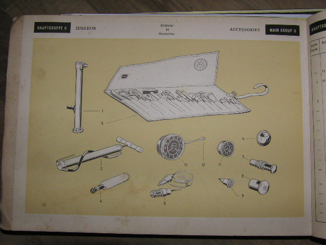

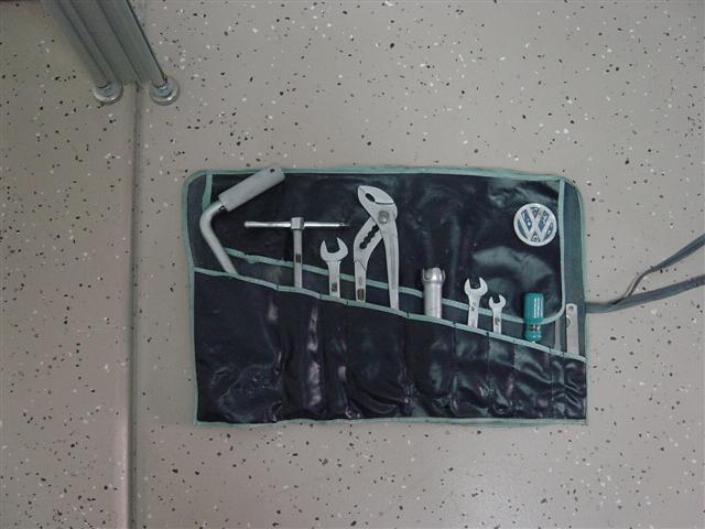

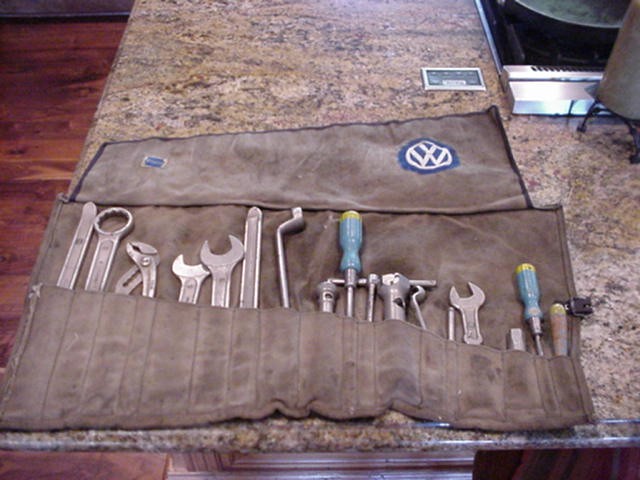

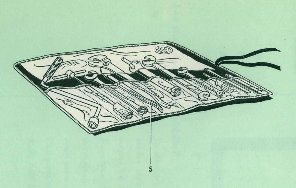

v2.1
fabric tool roll
many many tools
September 1950 parts list image:
discussion:
https://www.thesamba.com/vw/forum/viewtopic.php?p=2594974
Wanted:

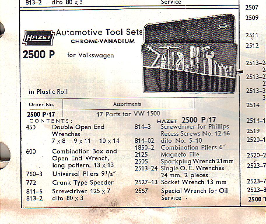

PostPosted: Sun Apr 09, 2017 4:30 pm    Post subject: Re: Hazet spare tire tool kit versions Reply with quote
V2.2
second version of the tool roll
image from 1958 parts list:
discussion:
https://www.thesamba.com/vw/forum/viewtopic.php?p=5773391
Wanted:

PostPosted: Sun Apr 09, 2017 4:42 pm    Post subject: Re: Hazet spare tire tool kit versions Reply with quote
V2.3
later tool roll
Wanted:

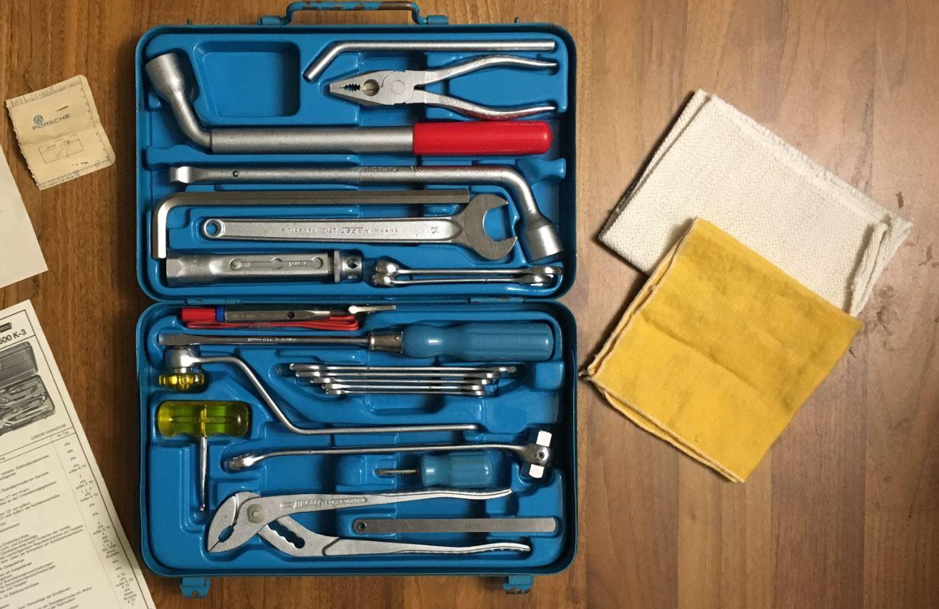

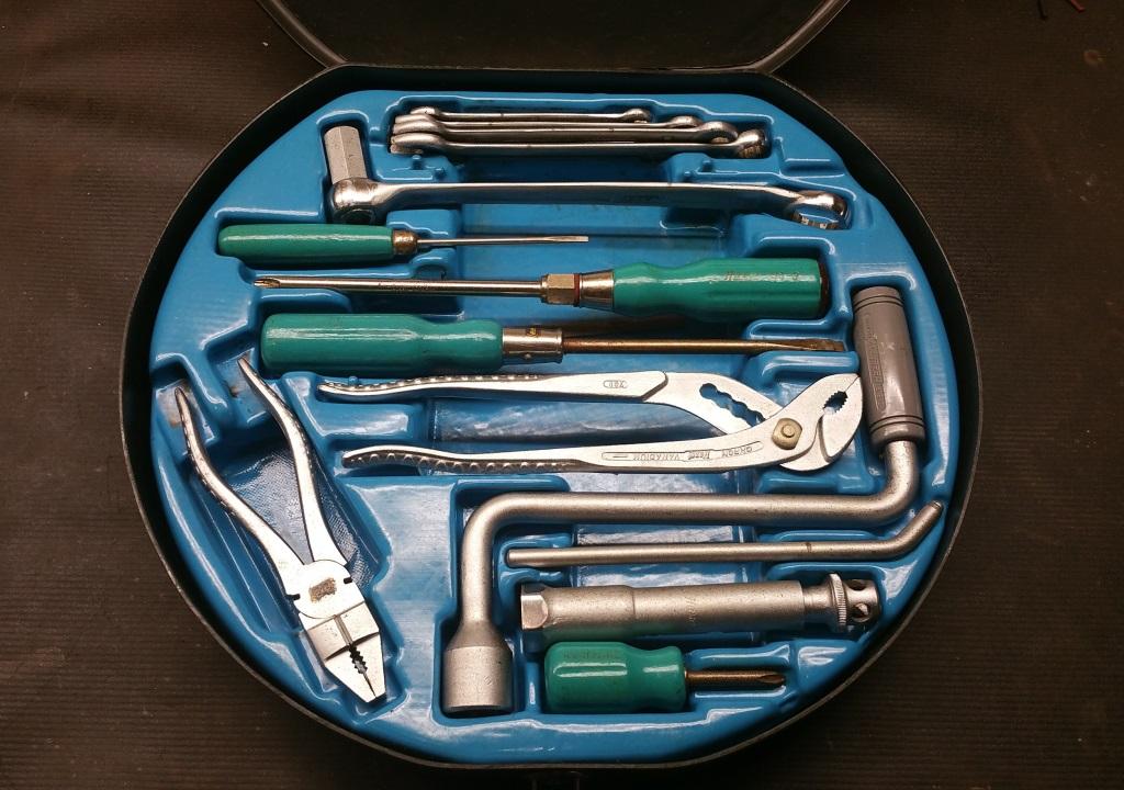

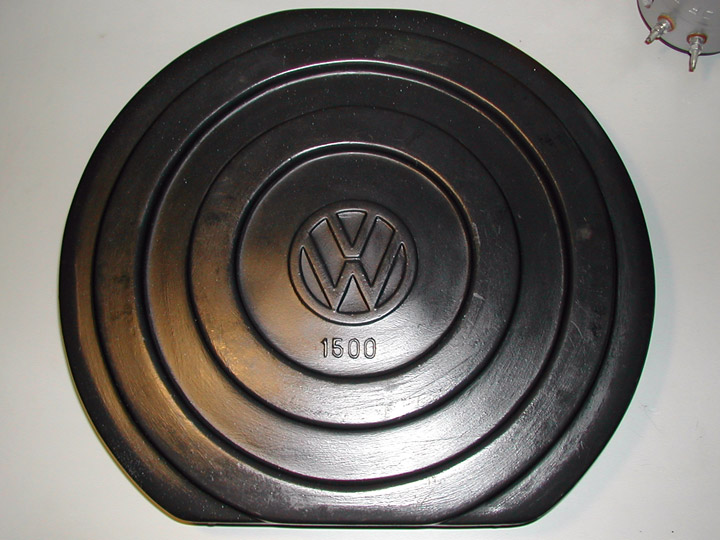

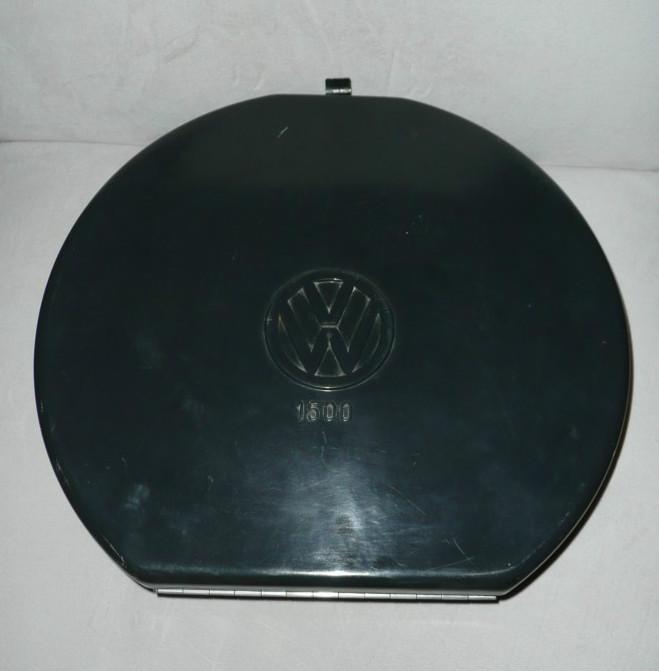

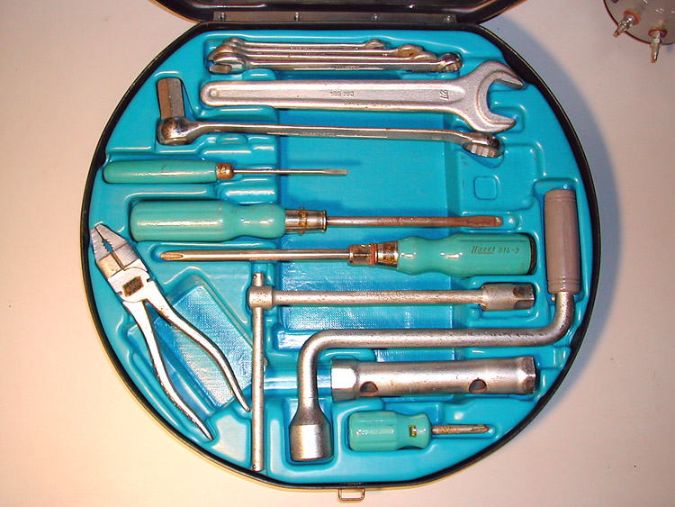

PostPosted: Sun Apr 09, 2017 4:59 pm    Post subject: Re: Hazet spare tire tool kit versions Reply with quote
Style 4 is the kit for the 1500 (type 3 models)
These boxes are made out of plastic.
middle -- late -- early
Wanted:
Lind
Joined: November 06, 2000
Posts: 10159
Location: idaho
Lind is offline

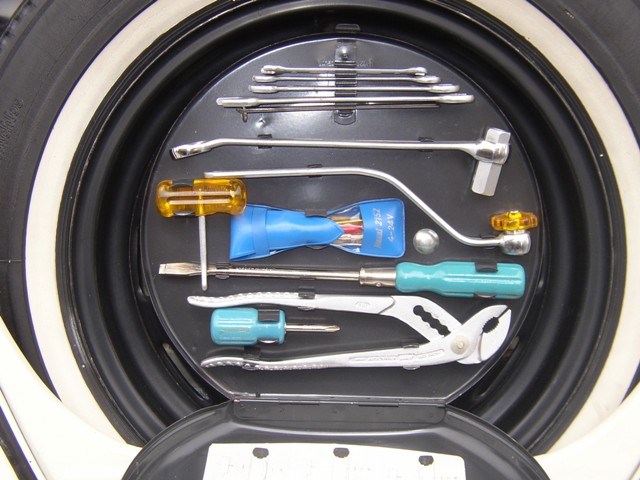

PostPosted: Sun Apr 09, 2017 5:04 pm    Post subject: Re: Hazet spare tire tool kit versions Reply with quote
V4.1
1500 kit
flocked
plastic box
(the one of the left)
Wanted:
Lind
Posts: 10159
Location: idaho
Lind is offline

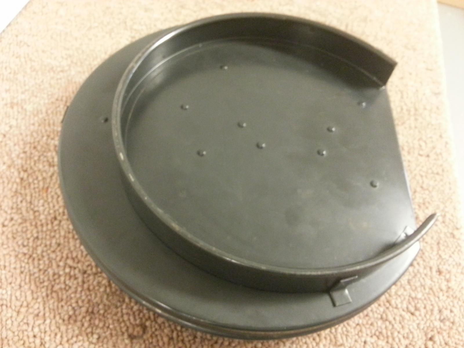

PostPosted: Sun Apr 09, 2017 5:06 pm    Post subject: Re: Hazet spare tire tool kit versions Reply with quote
V4.2
1500 kit
plastic tray
plastic box
Wanted:
Lind
Posts: 10159
Location: idaho
Lind is offline
PostPosted: Sun Apr 09, 2017 5:07 pm    Post subject: Re: Hazet spare tire tool kit versions Reply with quote
V4.3
1500 kit
plastic tray
plastic box
no 27 wrenches
Wanted:

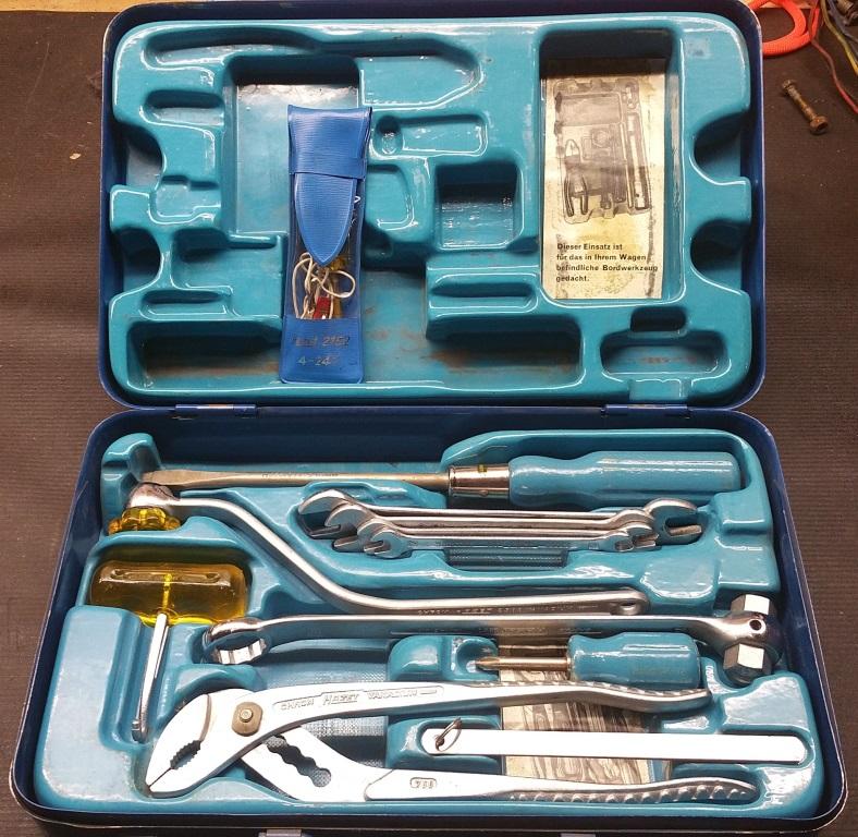

V6.1
rectangular box
this kit came with one empty tray that was meant to be filled with tools from the stock tool roll that came with the car from the factory.
