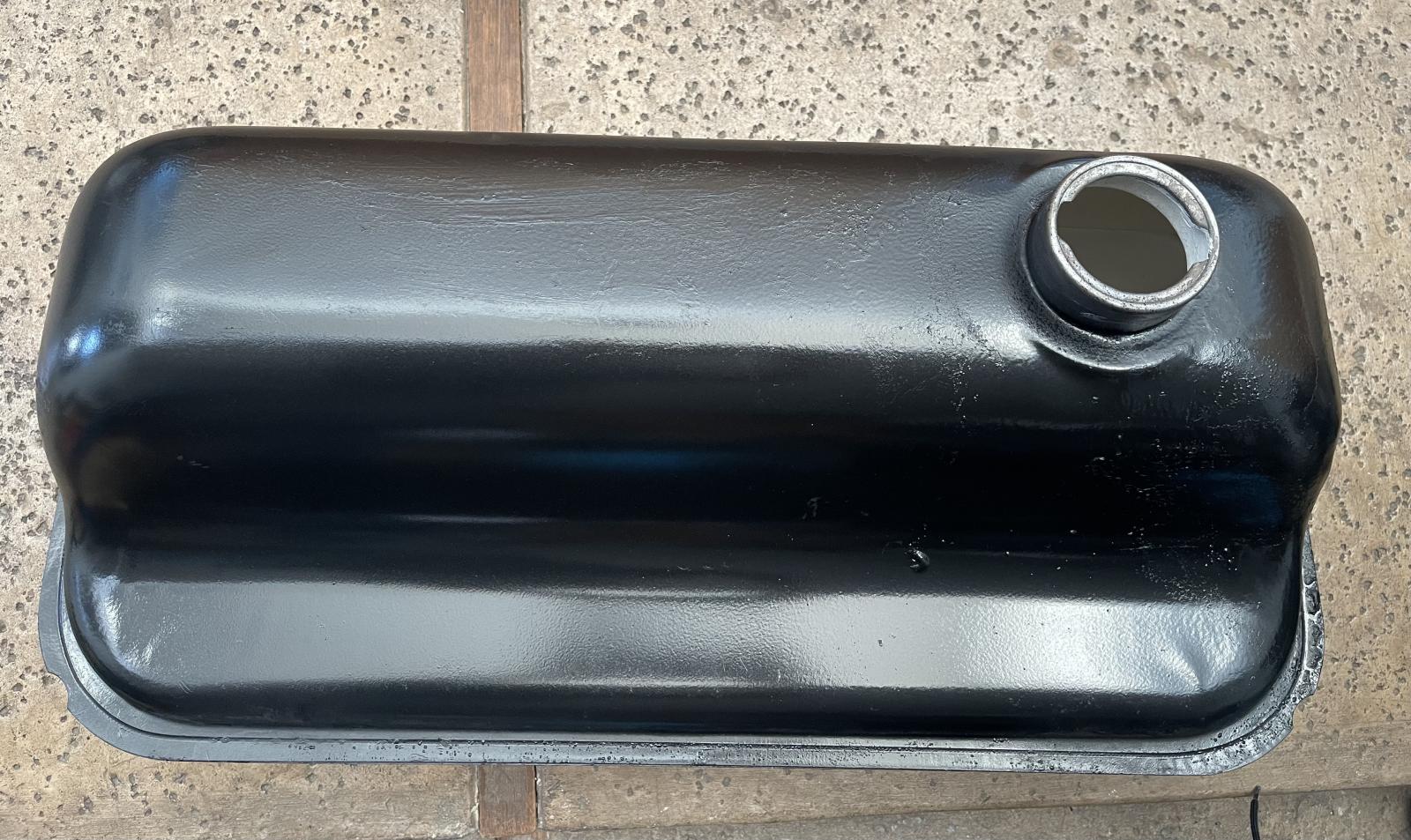

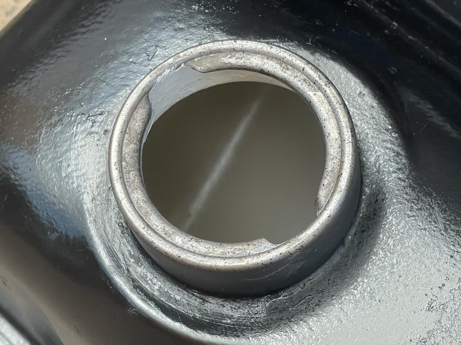

Thanks again for all the great info and recommendations y'all! The car had it's first major expenditure, had the original high top gas tank boiled and coated (not the el-cheapo red stuff!) as they don't make this shape anymore it seems. Found a couple of alternatives (and they were much less expensive) but decided to stick with the plan of keeping it as original as possible. The tank as I understand it should be a gray/blue color for originality, its currently black so I will address that issue soon.
I still need to source a new gas cap gasket and the fuel fitting/filter at the bottom of the tank and also do a clean and check on the original in car gas line as well as clean/rebuild both the fuel pump and carb, oil change and air filter service before we try for main engine start.
