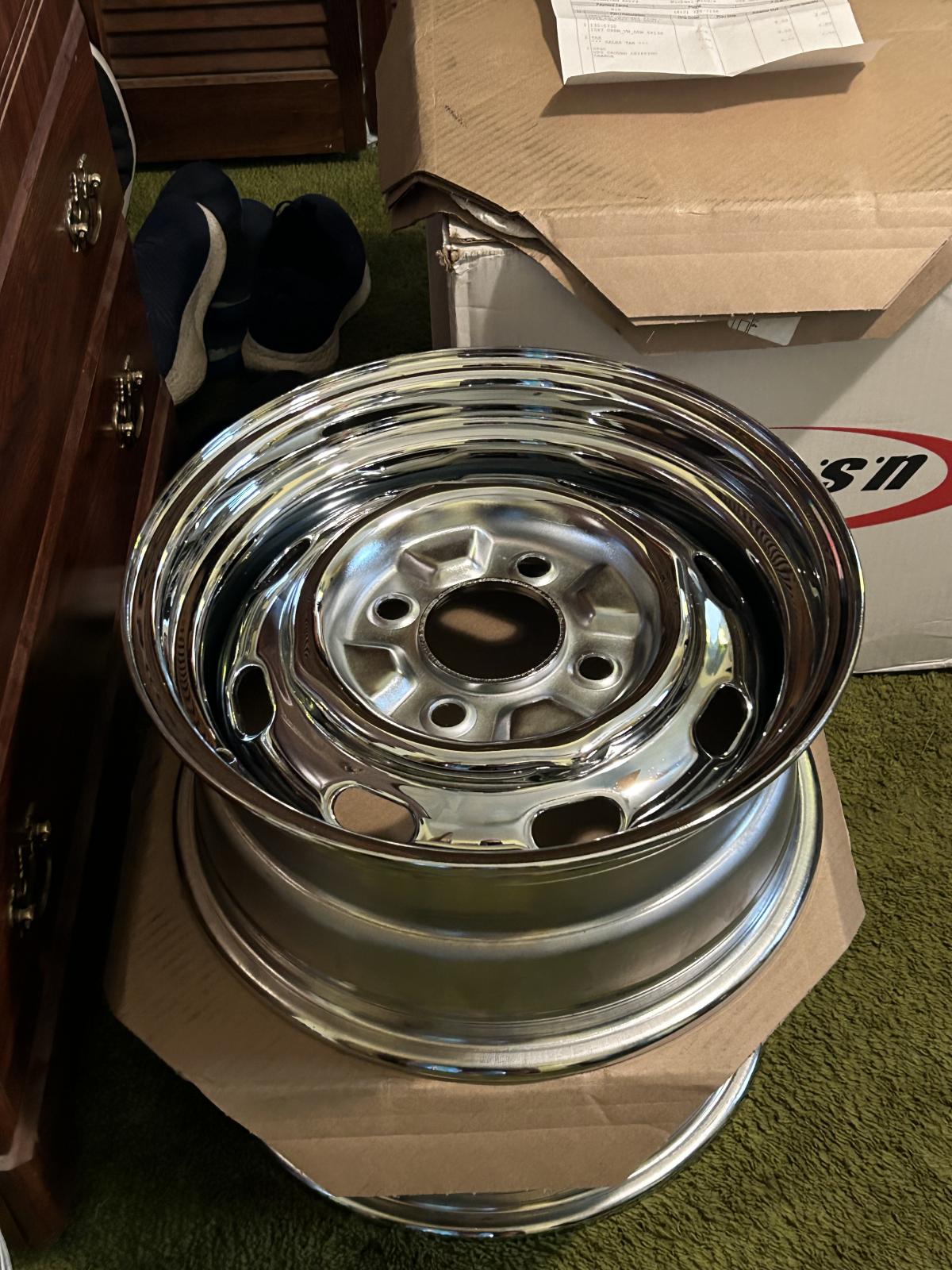

Raceace24
Joined: November 15, 2013
Posts: 208
Location: PA.
Raceace24 is offline
PostPosted: Tue Jul 30, 2024 4:33 pm    Post subject: Re: US Wheel 15x7 and 15x8 Reply with quote
NJ John wrote:
I would think maybe a 225/60 or 235/60, max. But, I can wait to see how they fit. Do you have stock fenders? And did you order them directly from US wheel?
I’m running stock fenders and my 5.5” wheels have a lot of room.
Got the wheels recently and found two issues: 1) two hammer marks on the outer front edge of the wheel. They are sending me a replacement as we speak. 2) the center of the wheel (which would be under the hubcap in most cases) is a rough, non-polished chrome finish and I didn’t run hubcaps on the 5.5s that are in the car now… Evil or Very Mad
Guess I’m either going to have to live with the finish difference or put a set of black satin moons on them.. Rolling Eyes

NJ John
Joined: September 21, 2007
Posts: 2863
Location: HdG, MD & NJ
NJ John is online now
PostPosted: Tue Jul 30, 2024 8:38 pm    Post subject: Re: US Wheel 15x7 and 15x8 Reply with quote
The center doesn’t look that bad. I don’t run hub caps either.

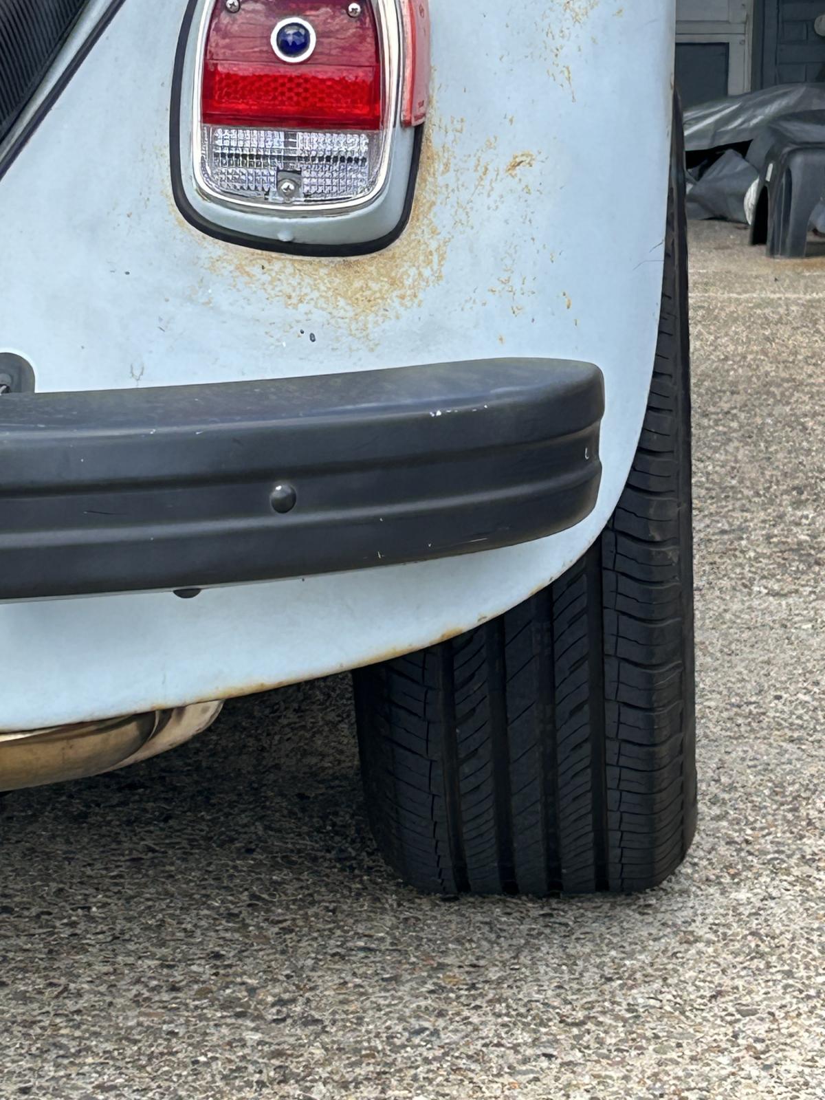

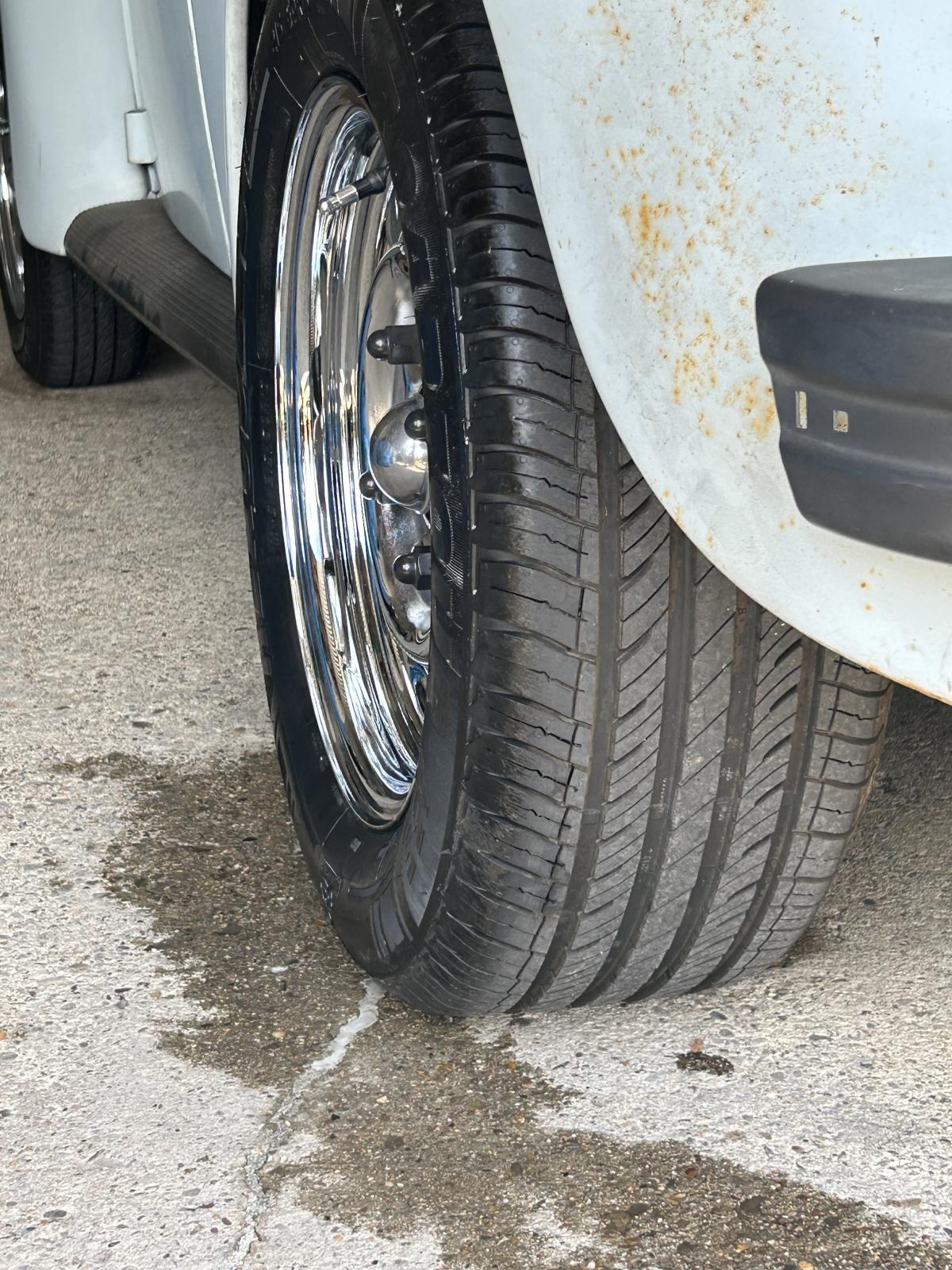

PostPosted: Sat Aug 10, 2024 3:47 pm    Post subject: Re: US Wheel 15x7 and 15x8 Reply with quote
I don’t know what they weight but frankly, they aren’t they much heavier than the 5.5s I’ve had in the car prior.
I got the 215/60-15s mounted and put them on my car.
They fit exactly the way I wished they would - snug up to the edge of the wheel well, but not rubbing !
They are perfect ! 👍🏼

NJ John
Posts: 2863
PostPosted: Sat Aug 10, 2024 10:09 pm    Post subject: Re: US Wheel 15x7 and 15x8 Reply with quote
Looks really good. That offset should be on all VW wheels. I just may copy the rim and tire size.

Raceace24
Posts: 208
Location: PA.
PostPosted: Sun Aug 11, 2024 6:04 am    Post subject: Re: US Wheel 15x7 and 15x8 Reply with quote
I agree. The tires are pretty wide and most of it is inside the wheel well.
The look from the rear is perfect and I’m pretty sure this will increase my rear grip dramatically.
No clearance issues either - not too close to the spring arm and my rear disc brake setup has lots of room!
They honestly look like they were alway meant to be there!
