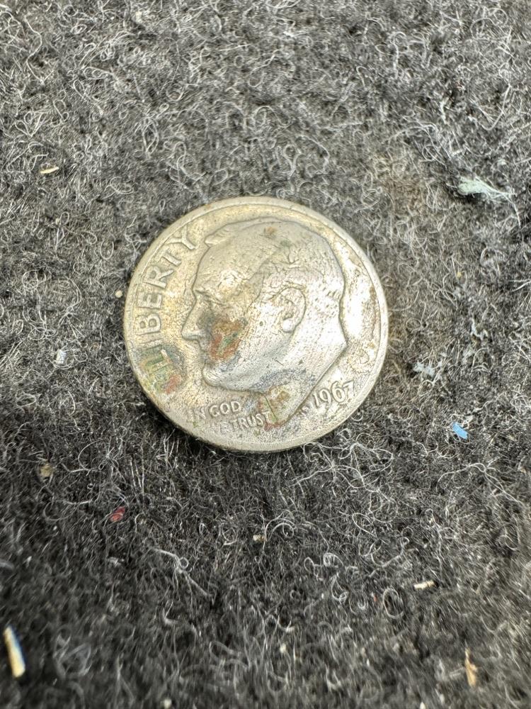

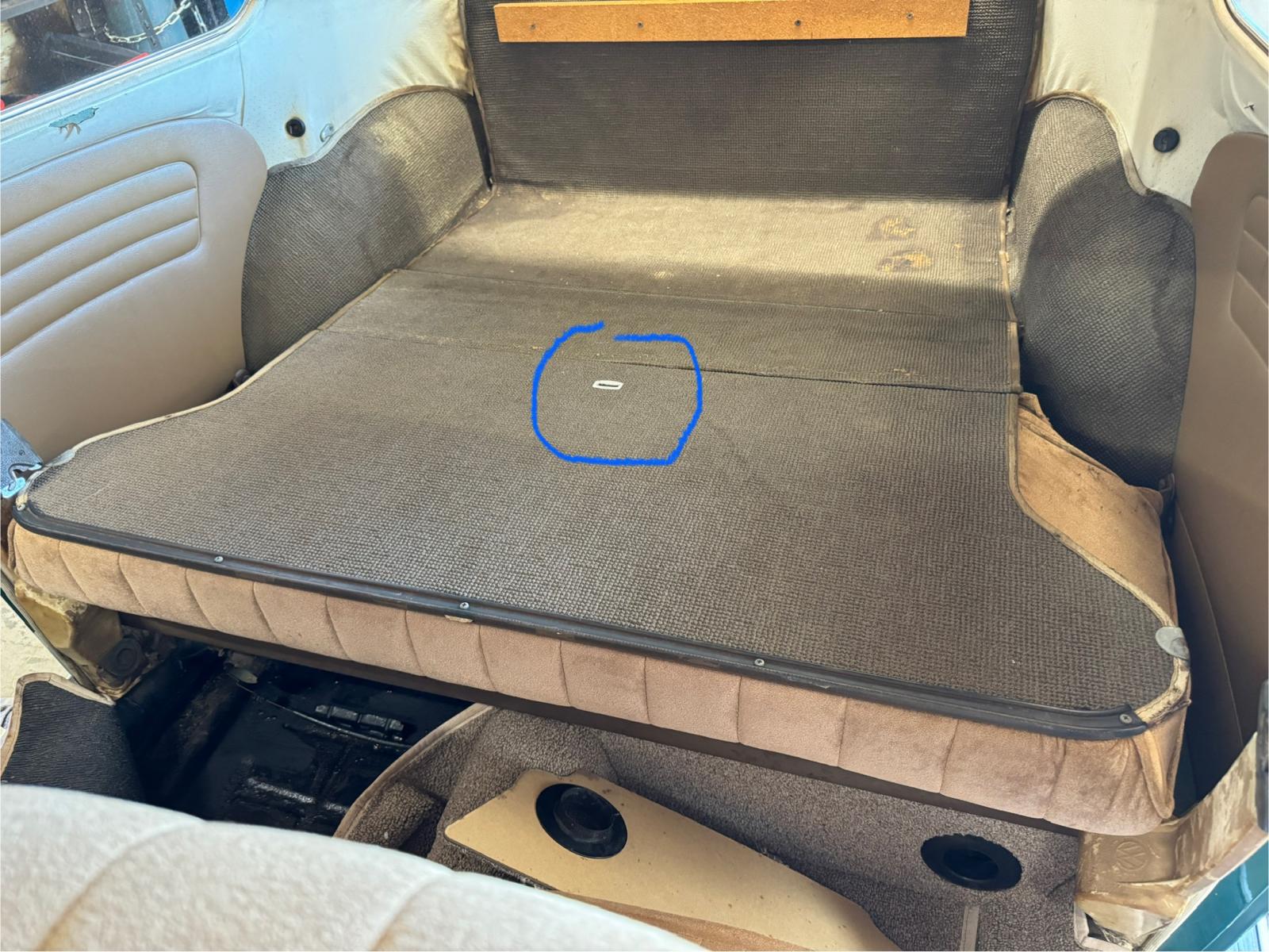

Here is a picture of the original carpet in the luggage area. You can see the replacement carpet on the floor and the matching kick panels.
The second picture is of a 1967 dime I found tucked in a seam of the original carpet. It probably isn't a coincidence, but I have no idea how it got there. Pretty neat though.

Does anyone know what is this and what it was used for? A tie down of some kind?
Current hobby vehicles:
1967 Beetle
1998 Jaguar XJR, restored myself, in near-immaculate condition
OldSchoolVW's Premium Member
Joined: July 03, 2020
Posts: 1217
Location: San Diego
OldSchoolVW's is offline
PostPosted: Wed Sep 18, 2024 1:08 pm    Post subject: Re: Carpet kit question Reply with quote
Rear seat hold down strap attaches there.
