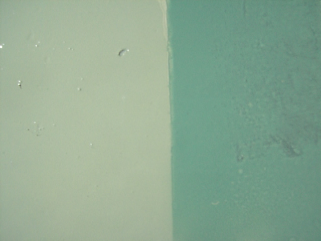

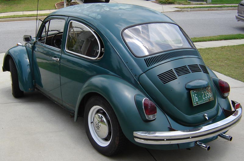

Krylon Jade green vs. L380 Turkis
pretty damn close!! Its a little bit lighter than the og turkis but good enough.

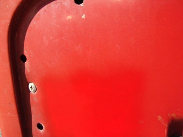

Krylon Cherry red vs. L456 Ruby red
Close but not as deep as true L456 ruby red, it is a little more bright red than the ruby.Its reported that Rustoleum Regal Red is a closer match.

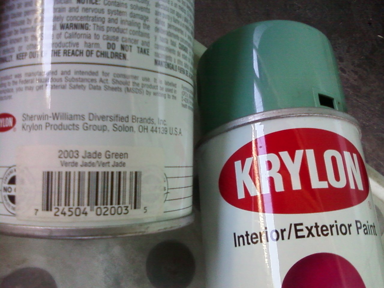

Here is another one.

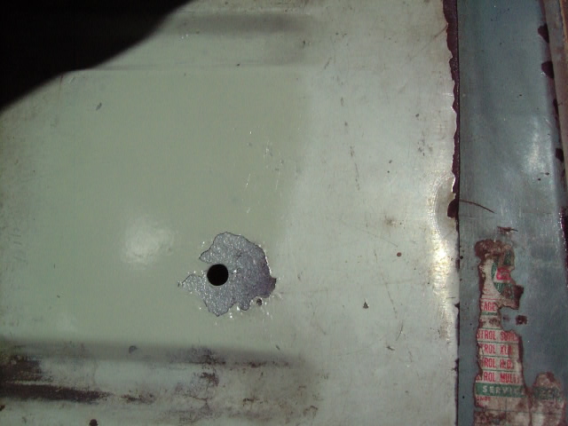

Krylon Honeydew Ambrosia vs. L289 Blue White
VERY CLOSE. Pic is bad due to lighting but on the left side almost under the seat frame where the og paint gets no sun exposure the krylon blends in perfectly!

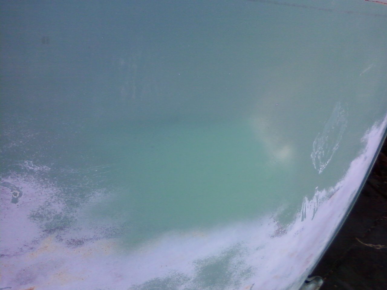

here is a picture of both Krylon honeydew and jade green (blue white/turkis) on the bus

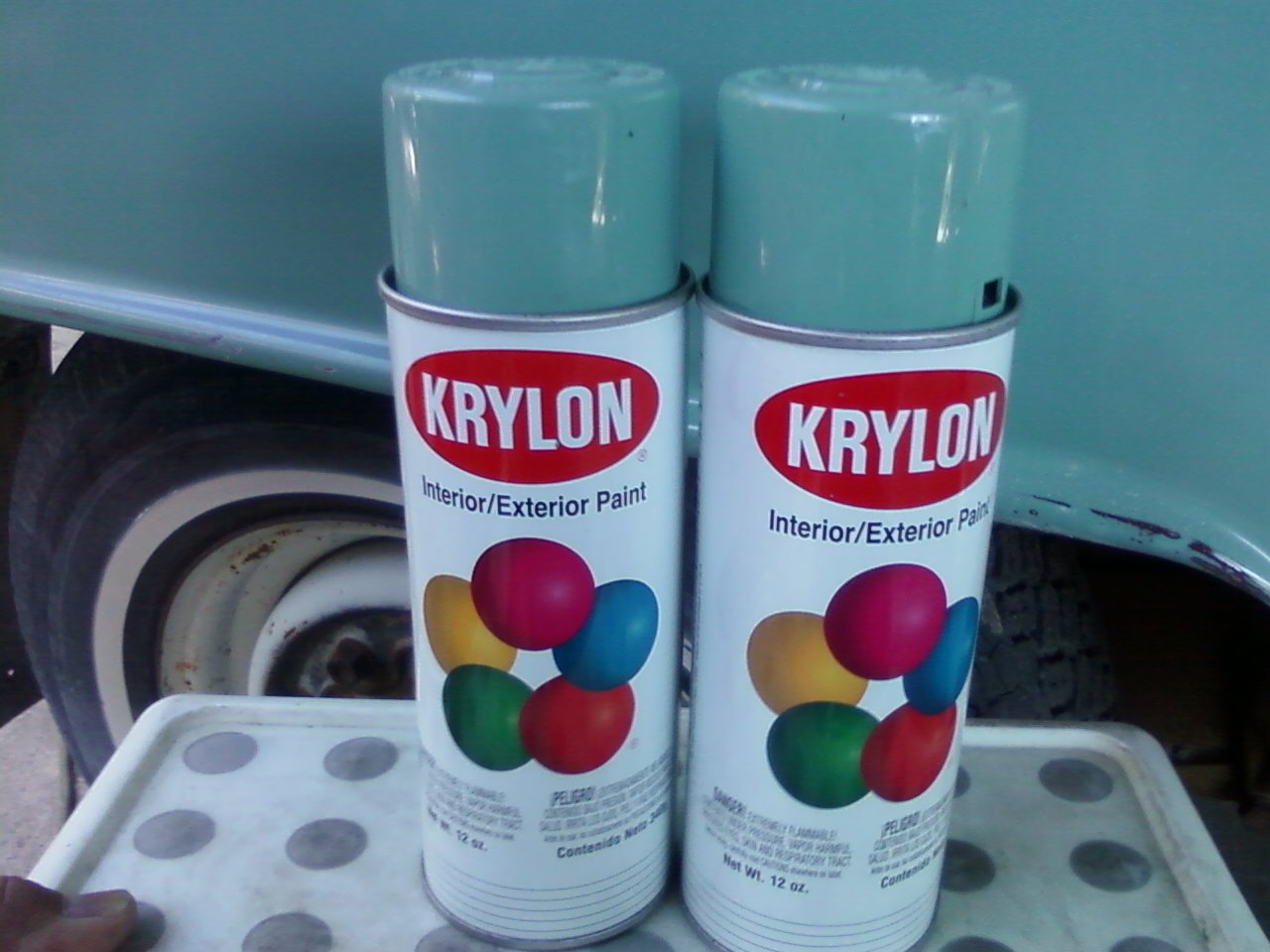

PostPosted: Wed Aug 18, 2010 4:13 pm    Post subject: Reply with quote
another pic of satin jade and honeydew krylon
the jade I found at walmart and the honeydew at true value hardware

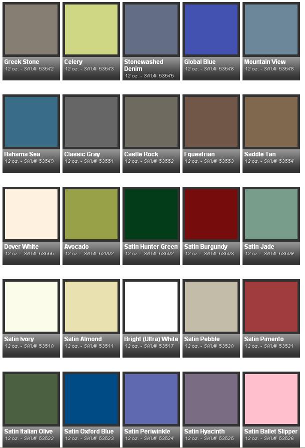

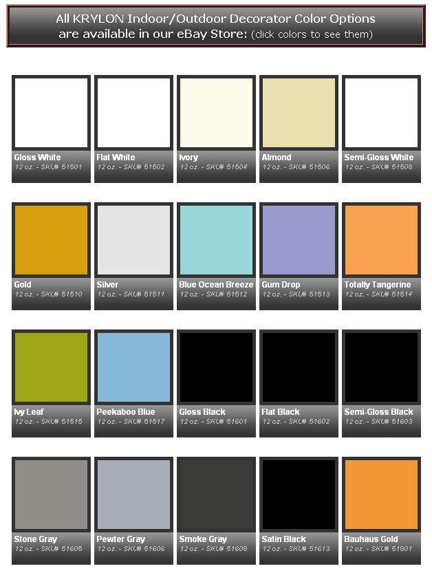

http://cgi.ebay.com/New-KRYLON-52411-PUMPKIN-ORANG...2c5712a365
Using the ebay link for reference maybe Pumpkin Orange would be the closest when compared to Brilliant Orange ......This colors does kind looks like Hugger Orange to me - late 60's GM OEM color...
The link also has a chart that shows Krylon colors that some look close to VW OEM colors...Using this chart could help to get close to the color that is desired..

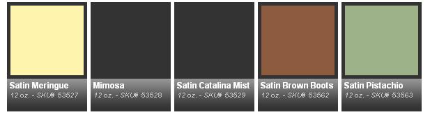

PostPosted: Mon Sep 06, 2010 9:50 am    Post subject: Reply with quote
Since these are not actual swatches of paint the match is questionable but here are some possible matches
Hosta leaf = velvet green
Regal blue = Sea blue 1
Satin oxford blue = Sea blue 2
Bahama sea = gulf blue
Castle rock = anthracite
Mountain vew = fjord blue
