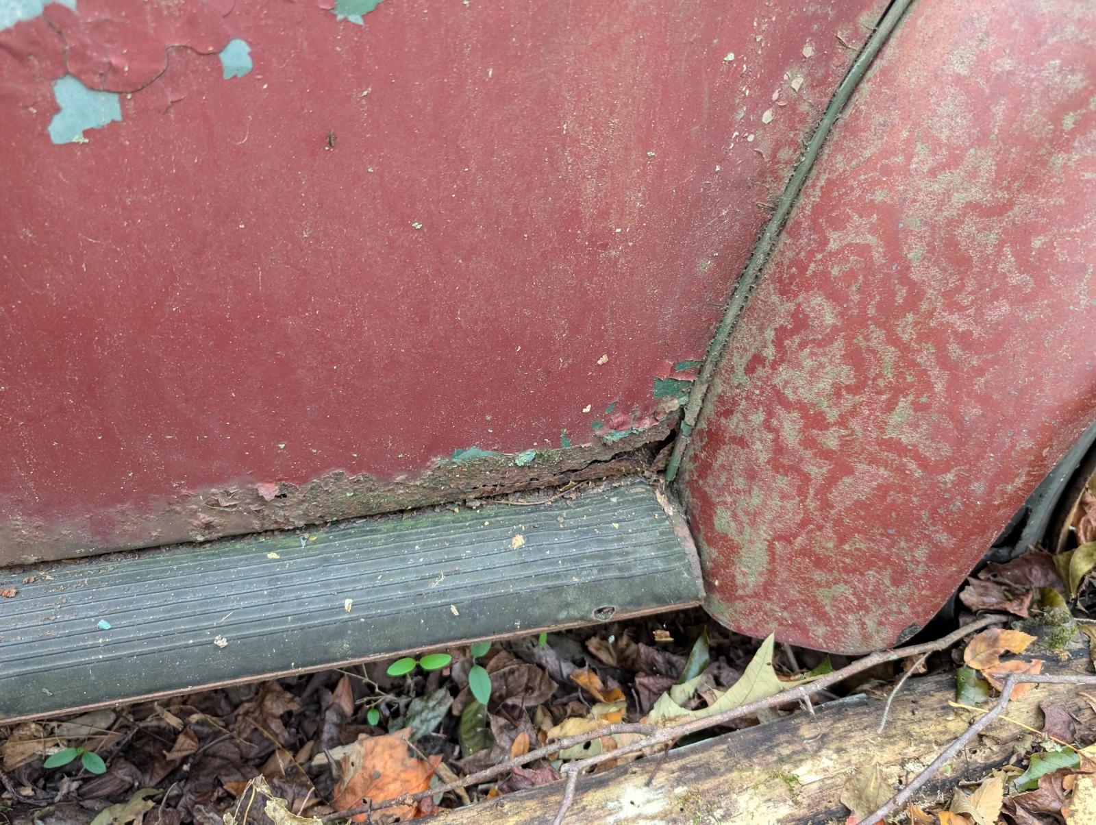

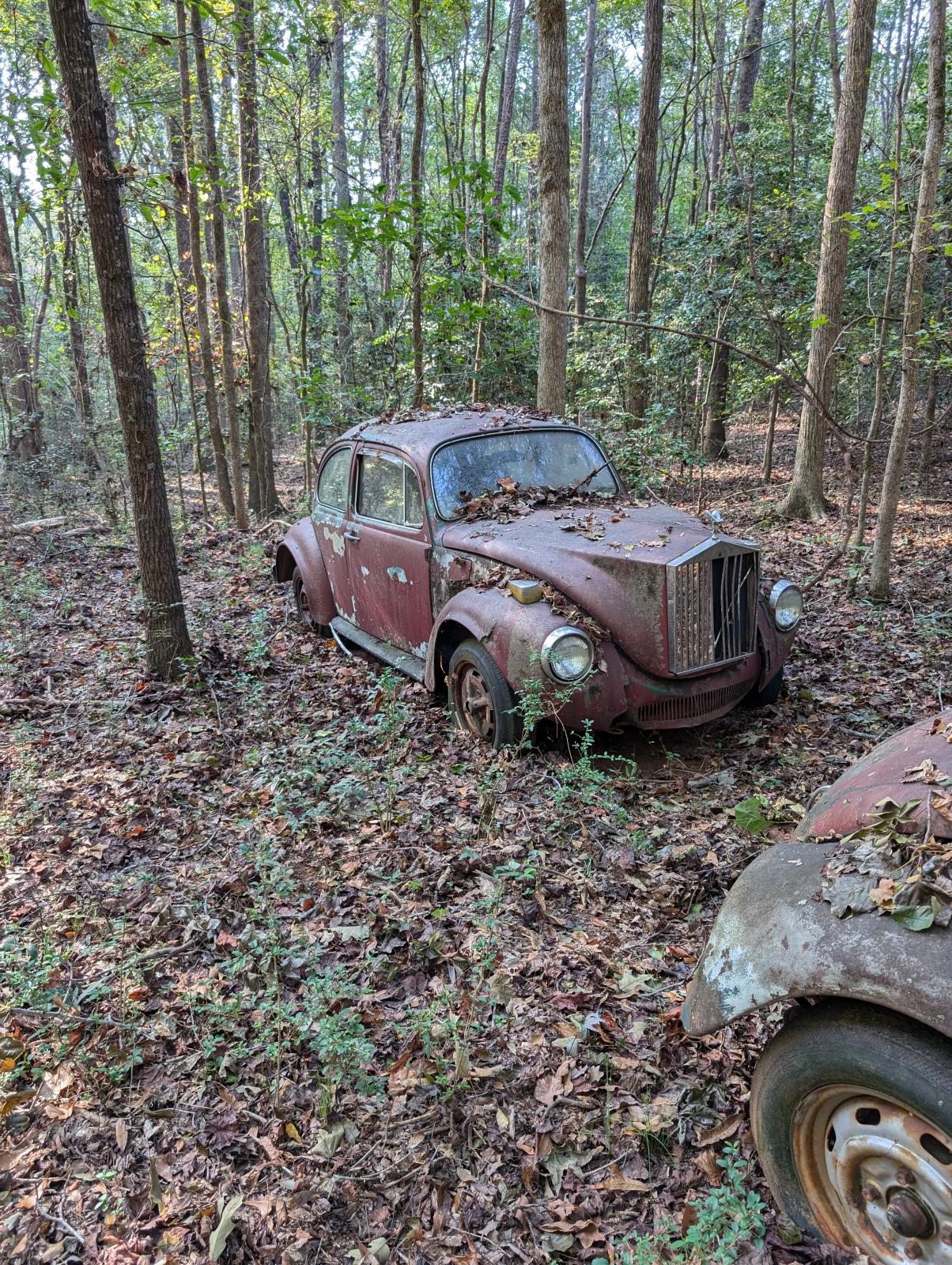

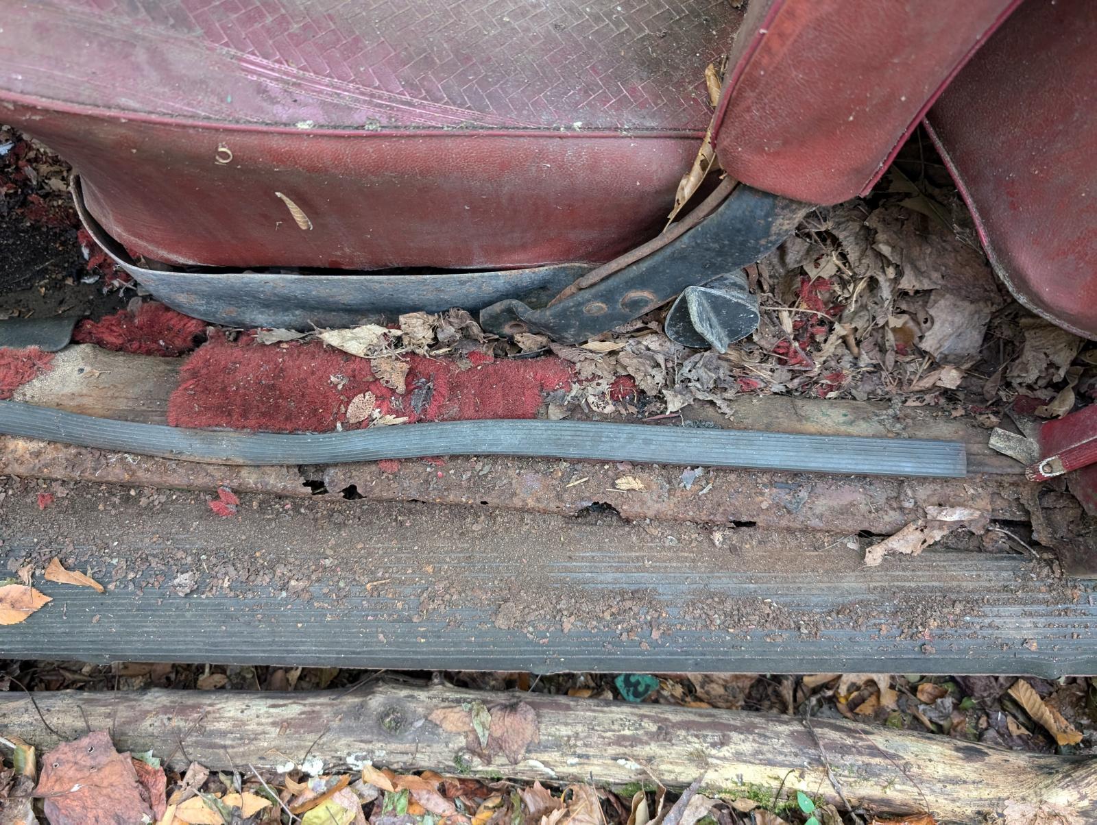

Hi,
I'm looking at purchasing a mid 70s bug that has some rust and I'm wondering how bad it is - from someone who knows these cars. It has a rolls Royce fiberglass kit but the drivers channel does have some rust and I am worried I am overestimating the "ease" of fixing it.
Thanks for looking and for any advice,
J

The question is, is there enough metal to weld the new panels to?
It looks like the rust goes up the body.
If you get it for free, give it a try. If you have to buy the car... run away.

I was/am aware the heater channels and pans can be issues. I'm also aware that on the sides of the rear window are bad spots to have rust too but you definitely point out a concern. The B pillar rot as well as in front of the rear wheel fender, into the lower body - haven't seen many rot there (at least of the photos I've seen online)

I'm north of Charloot. I have parted out cars with better bodies. You could part that out for probably $100, maybe $150 if someone really wants the fiberglass fenders and hood. You would be money ahead to get a complete car that isn't rusted out. I do metal work and engine building but I wouldn't even drag that thing out into my field for storage.
