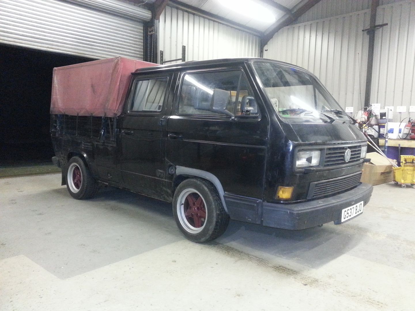

I'm currently driving a Tristar 2WD daily and a question within my blog thread has prompted a question...
With a T3 (Vanagon) Doka and Sinka, what does everyone think would be the most aerodynamic?
Without a Canopy?
With a Tonneau Cover?
With a Cab height Canopy?
I've tried to add another poll option for the extra height canopy but it won't let me.
I've always thought that the Crew Cab/Single Cab performed less well without a canopy as the tailgate acts as a windbreak but I've no proof of this.
Anyone got any hard and fast info on this?
Cheers
MG

I've been monitoring my MPG and have been driving with and without the canopy.
I never drive over 60mph for longer than 30 seconds or so as it's revving the nads off the engine and it'll only do that going downhill Laughing
General top speed is 55-60mph.
A 160 mile journey with the canopy on gave 35.6mpg and the same journey without the canopy gave 35.5mpg. The van was loaded in the same way and the weather was similar although this is hardly scientific.
I've been driving around without the canopy on over last two weeks to try to stop it being blown around so much as we've had fairly gusty winds. This has certainly made a difference but again, mpg is hardly changed.
My daily drive to work is 25 miles cross country, overtaking, speeds from 25-55mph is giving me around 33mpg and the canopy isn't making that much difference.
I'll be doing the same 160 mile journey again tomorrow and will have the canopy on for practical reasons on keeping stuff dry.

I missed this thread back in the day, but for the archive I voted in the tonneau cover category.
Had a Syncro Tristar that the PO had installed a tonneau cover that just snapped onto the gates and had a slotted piece behind cab to hold tight.
I added some support rods across the bed to keep water from pooling on the cover and increase it's tautness.
There was a noticeable difference with the cover vs without in both noise and buffeting. Also was nice to keep stuff dry.
