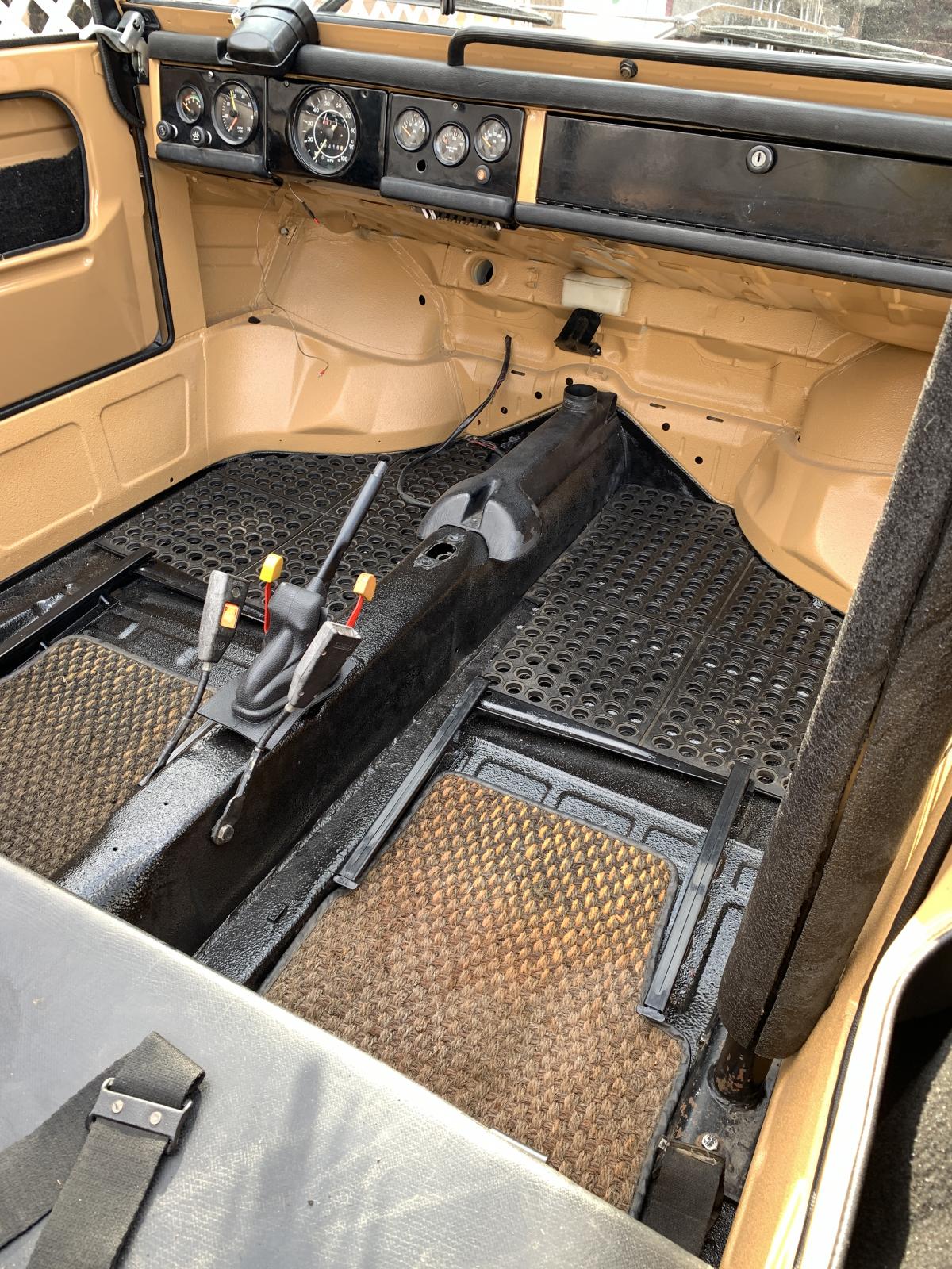

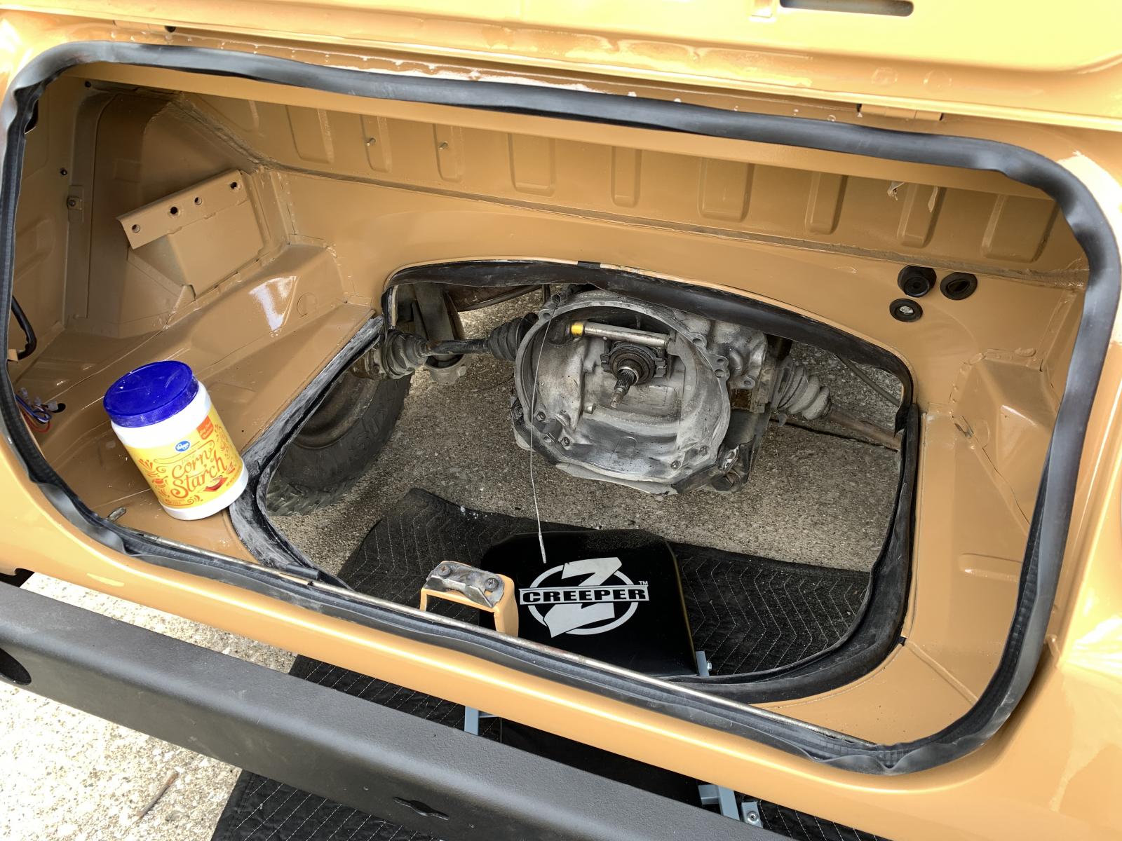

I used Raptor liner in the tub and trunk. It was tinted same as the outside body color. Very happy with it.
I elected to NOT use the Raptor liner in the engine bay as I thought it may it more difficult to clean oil and grease from the texture.
No Raptor in the engine bay

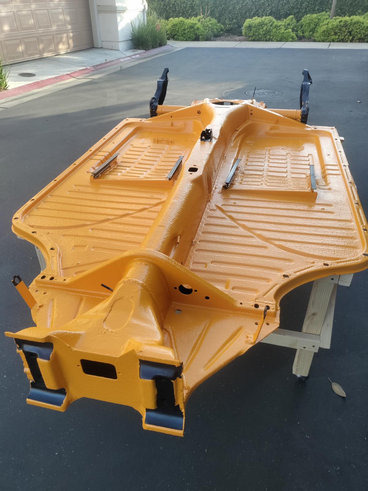

I used Monstaliner on the pan. It took one gallon on the top and one gallon on the bottom.
That looks great! Was it sprayed on using an air compressor or is that available in aerosol cans? Or rolled on?
My paint and body guy did it. I'm sure it was sprayed. The Raptor Liner kit comes with a spray gun.

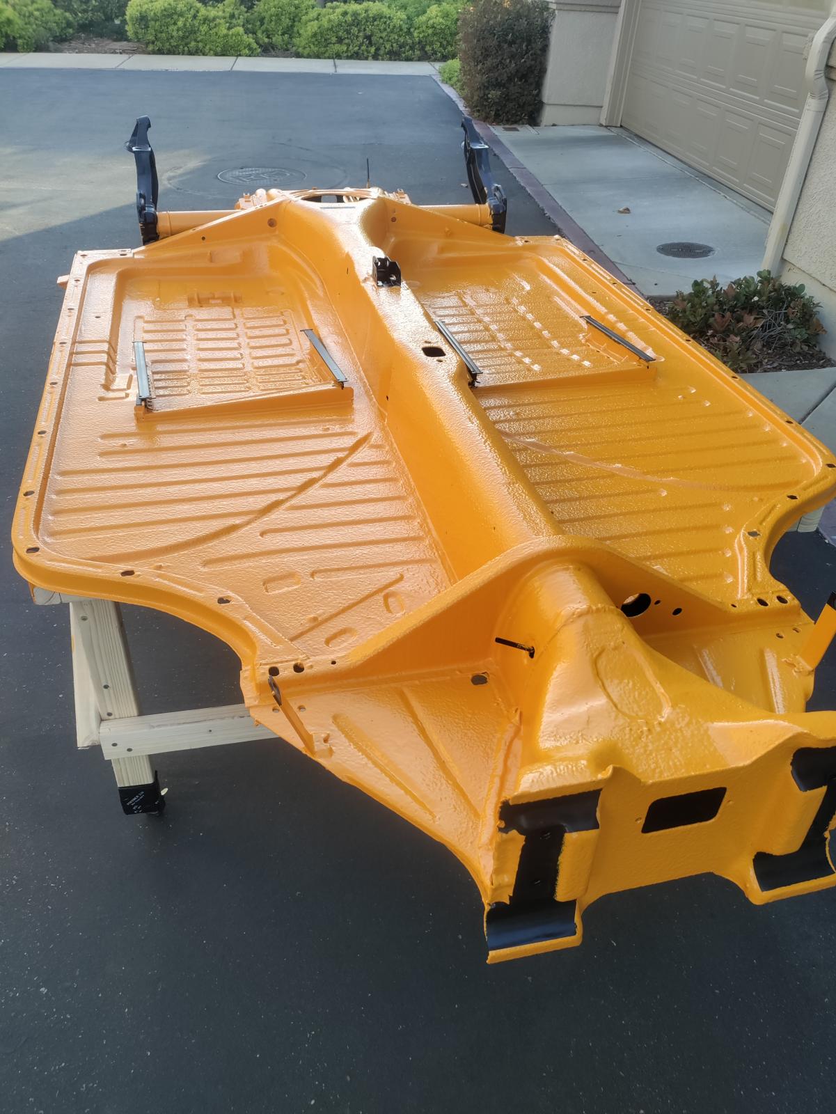

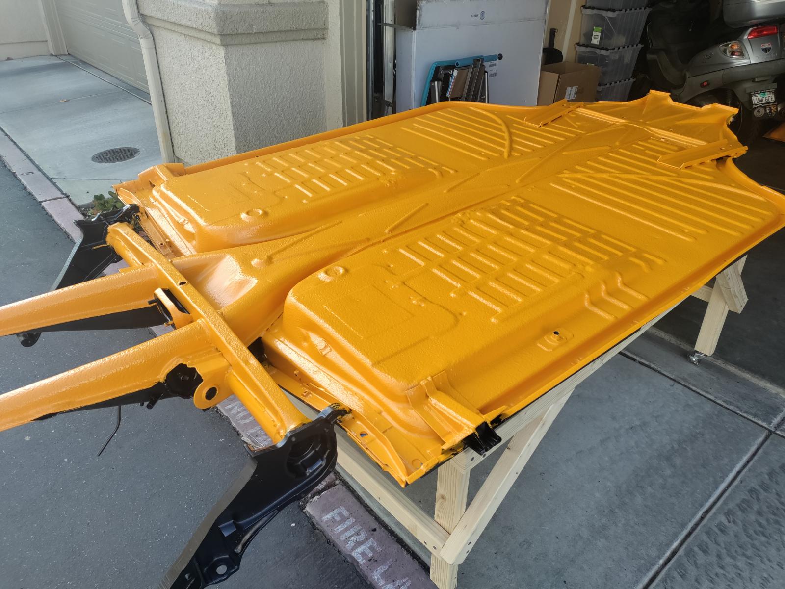

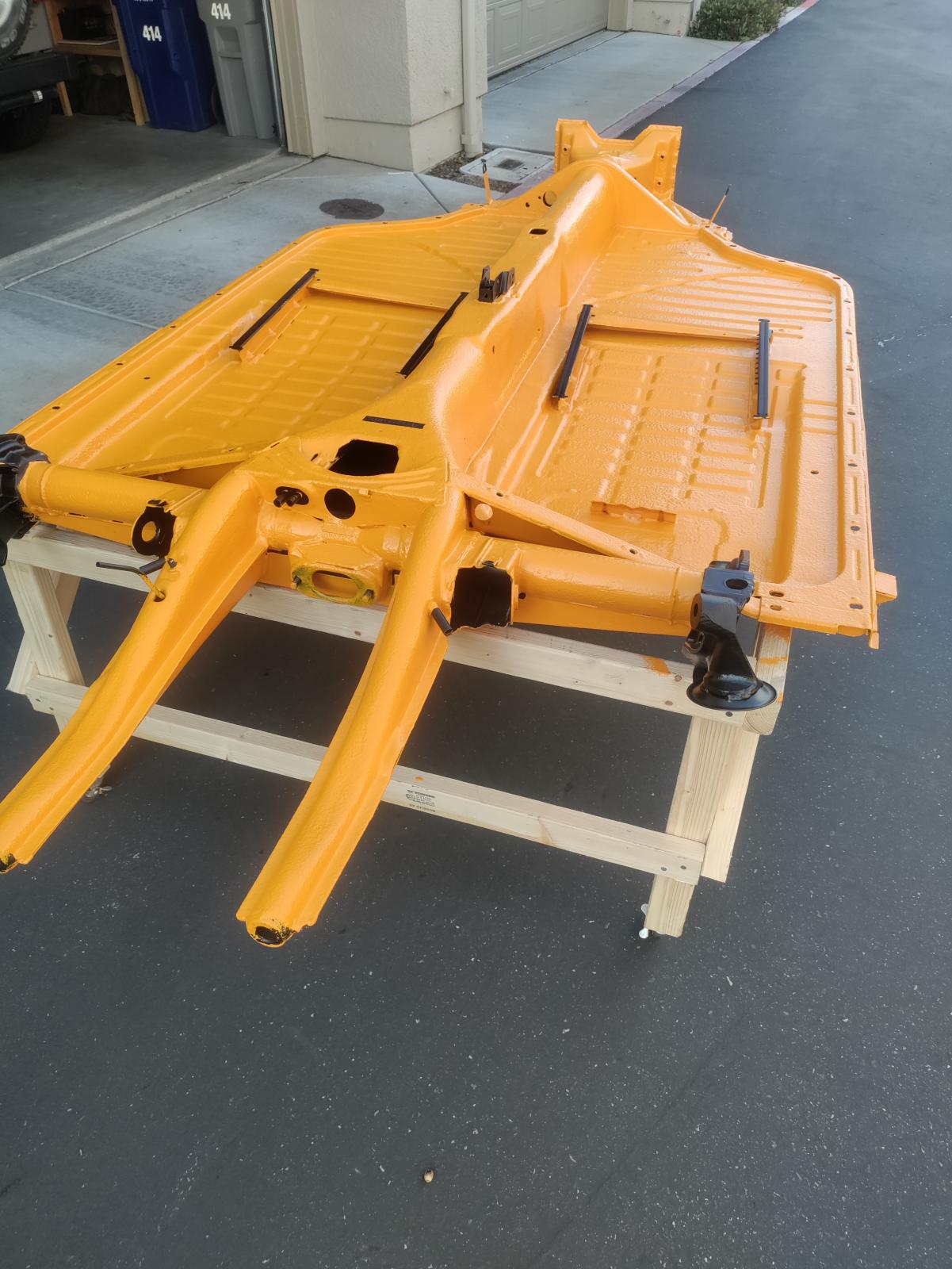

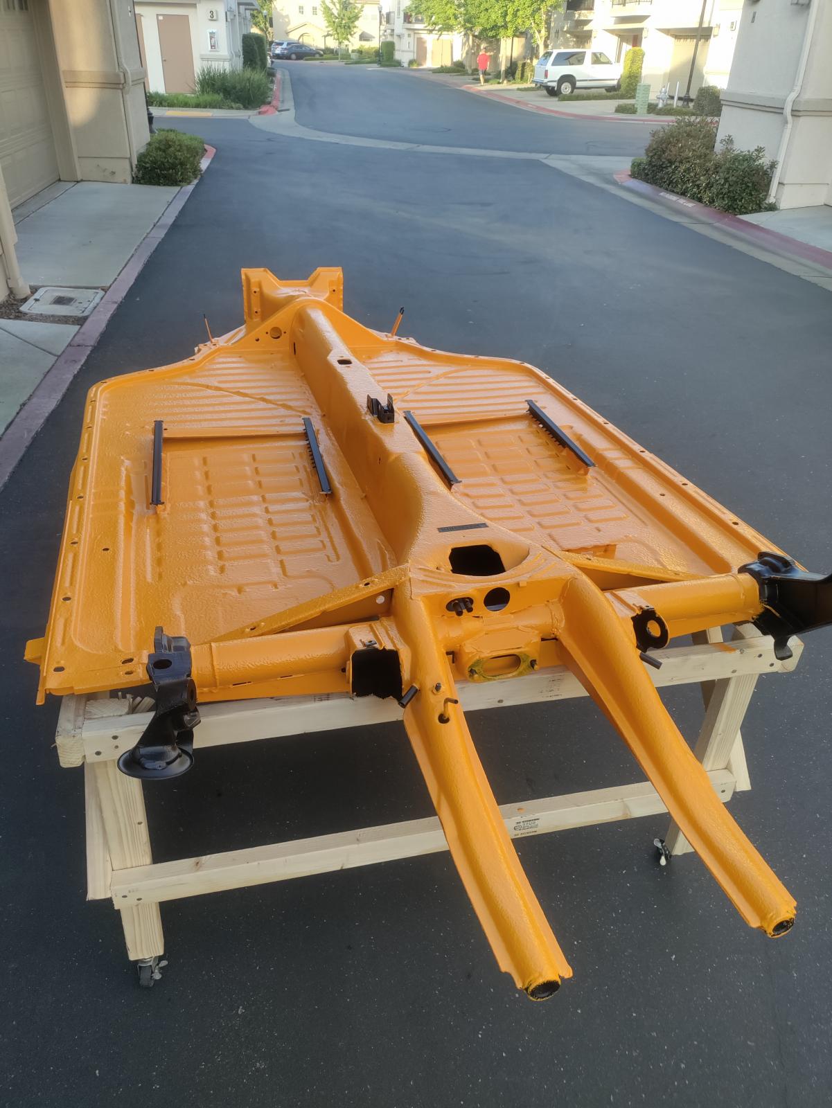

I did the raptor liner on my floor pans after powder coating and my wheel wells too. You can roll it on, but spraying will give much better results. Use the gun from the kit. It can be done outdoors if you prefer - the gun is very controllable and it’s fast - I think I did the pans which used about 3 bottles of the raptor liner in less than 30 minutes. Cleanup was easy and I have used the gun several times since.
