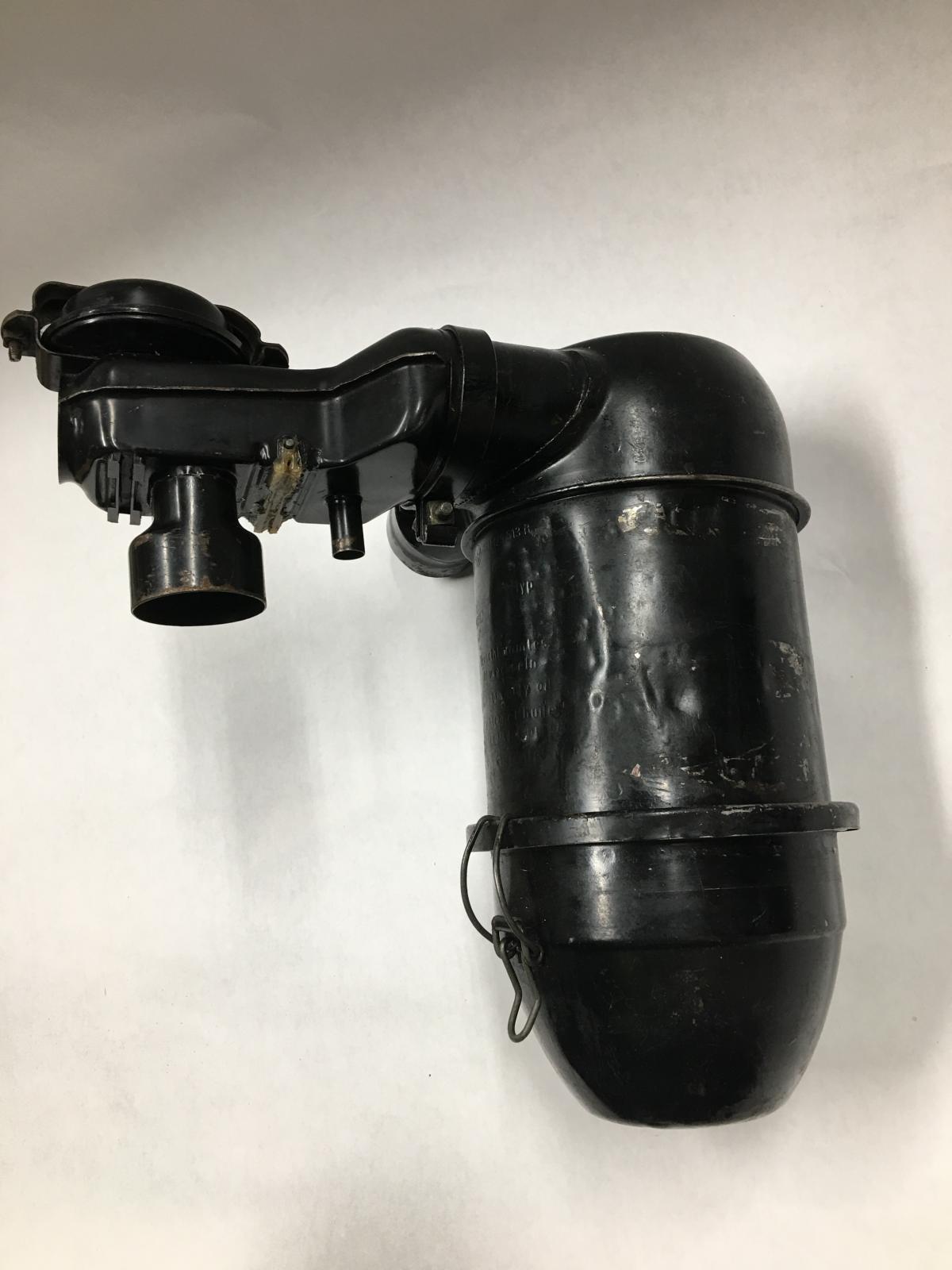

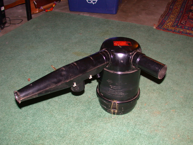

Let us begin with part number 181 129 613, which is the first air cleaner supplied by the factory. If you are wondering about the tape on the outlet and warm air inlet of the subsequent pictures (and also the shiny plating on various bits), this particular piece is New Old Stock and is dated January of 1970 (I didn’t photograph the box, unfortunately). What is notable about this air cleaner (at least from the American perspective) is the warm air inlet thermostat, which features a spring loaded wax thermostat instead of the later vacuum operated valve that Americans are probably more familiar with. The wax thermostat is described as opening the preheat flap at 27.5°C. It is unclear to me as a non-native German speaker if that is the temperature at which the flap starts to open or should be fully open. There is a different wax thermostat that was introduced around January of 1971 that begins to open at 45°C, which “improves the driving behavior of the vehicle”. The higher temperature thermostat is listed as a replacement part in a technical bulletin dated April of 1971 and can be retrofitted to earlier vehicles. Other items of note is a small diameter straight down oil breather pipe and no connection pipe for fuel vapor recovery (American emissions equipment for folks in the rest of the world that might not know what I am talking about). This air cleaner was used until engine H 1 277 428 (late January / early February 1971) or AG 0 003 000 (31st of July 1971). In other words, this is until the end of the 1971 model year. The reason for the two different end dates depending on the engine is because in the early part of the 1971 model year the H series 1500 single port engines continued to be produced for military vehicles while the AG series 1600 dual port low compression engines were installed in civilian vehicles. After February of 1971 both military and civilian vehicles got AG series engines.
An overview shot:

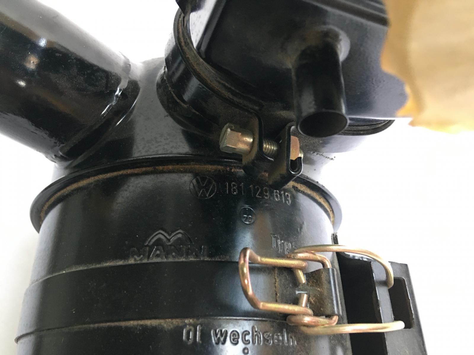

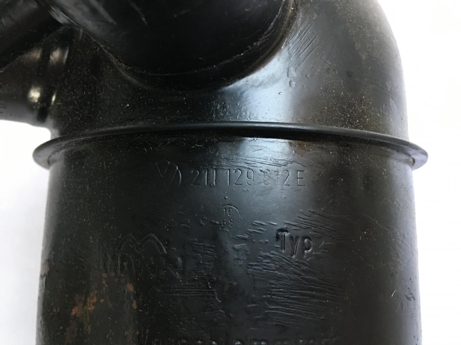

Note the part number and date code:

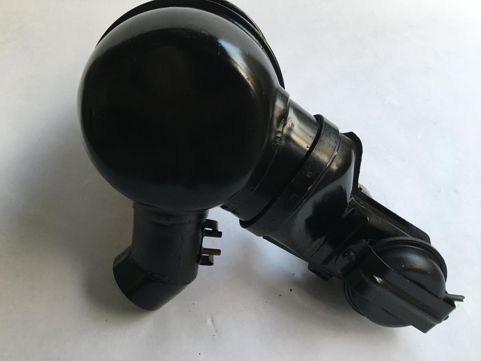

The wax type thermostat is visible on the side of the air inlet:
The small size of the oil breather fitting is easy to discern here:

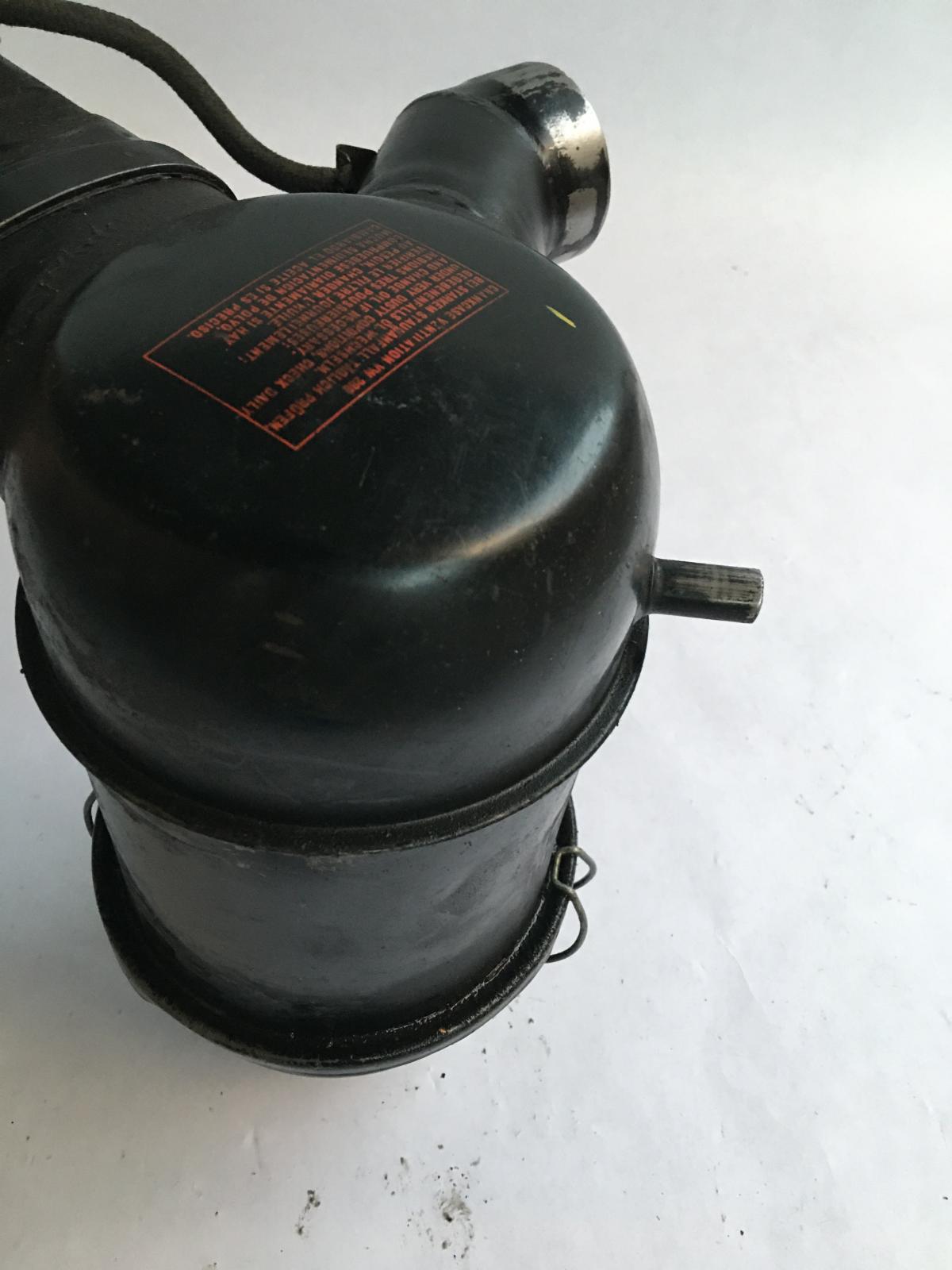

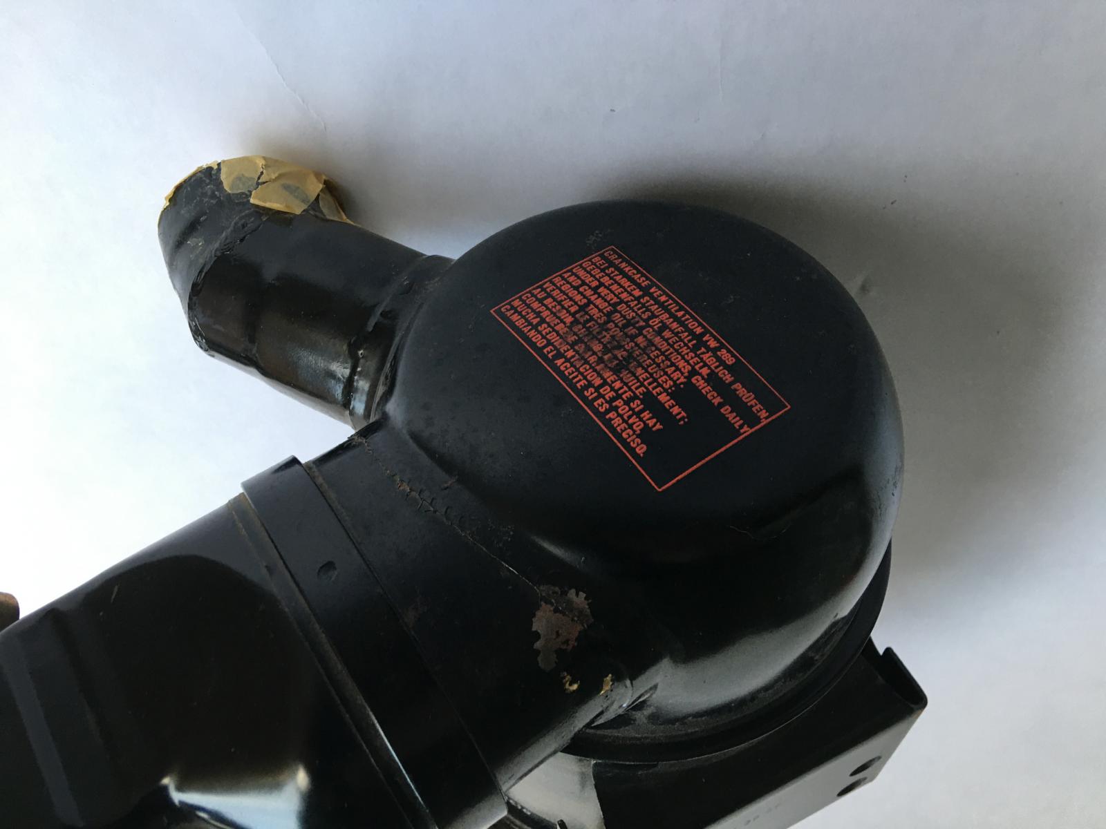

A close up of the service information on the top:
No fitting for the vapor recovery that the US got:

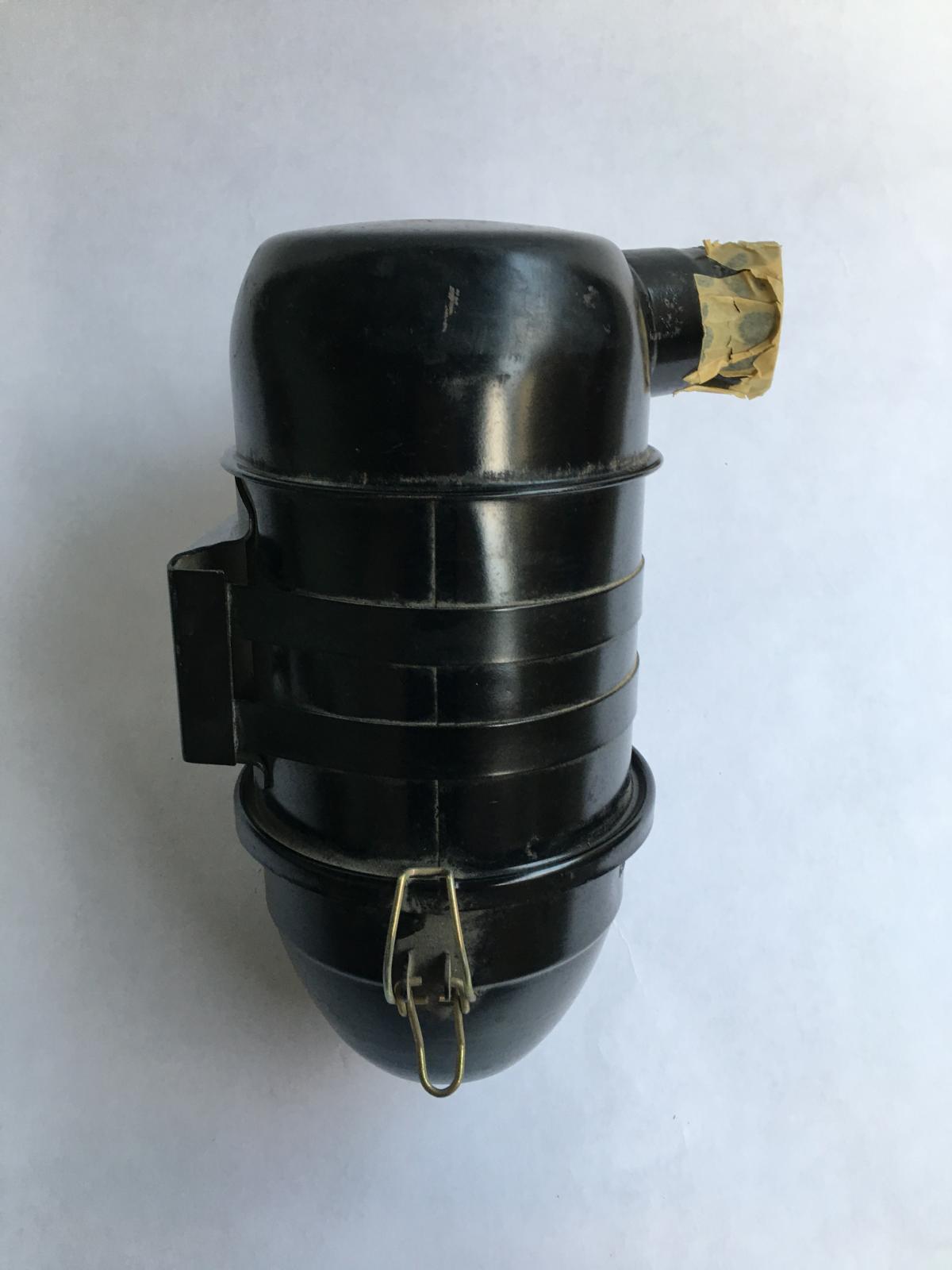

181 129 613 D

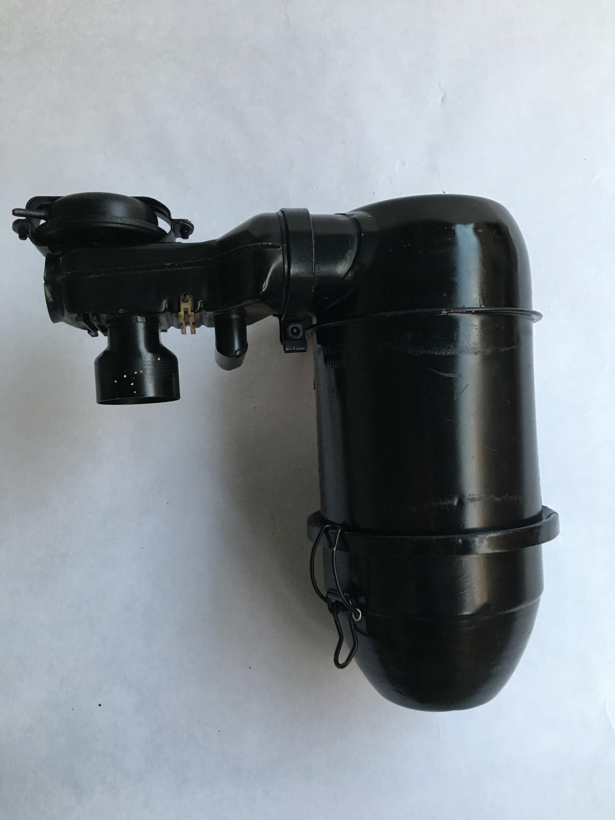

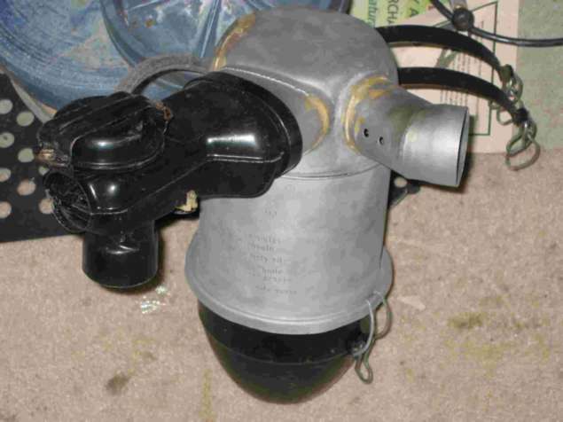

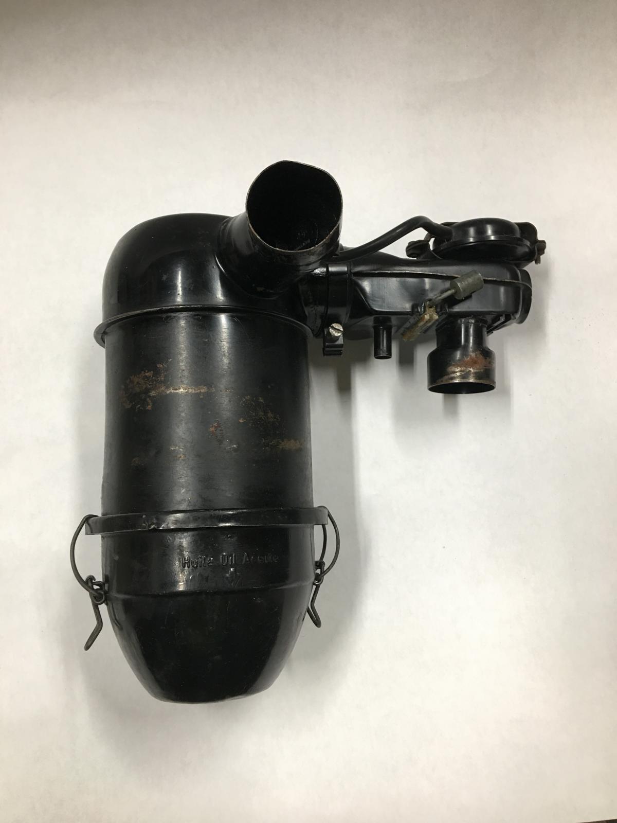

The next air cleaner pictured is 181 129 613 D, which is off my personal 1973. Hence the dents and scratches. It is dated May of 73 (like every other part on the vehicle that has a date). This air cleaner features the vacuum operated preheat/warm air flap that was introduced in the 1972 model year. This air cleaner still features a straight down oil breather pipe, but it has gotten larger and the air cleaner now has a fitting on the front (facing the front of the vehicle) that connects it to the vapor recovery emissions system, which is a US requirement to handle fuel vapors from the gas tank via an activated charcoal canister. I apologize that I didn’t get more pictures of it. I took it off my rig briefly for the photos and it still was full of oil so I was trying not to tip it too much. My 1978 microfiche indicates it is for engines AG 0 010 158 +, AL 0 000 001 +, AM 0 000 001 +, and AF 0 034 770+. That roughly correlates with the 1973 model year. Interestingly, it is not mentioned as being specific for US emissions, which has me wondering if the same air cleaner was used with the rest of the world and if those have the vapor recovery fitting or not.
An overview:
Close up of the part number and date code (not very visible unfortunately):

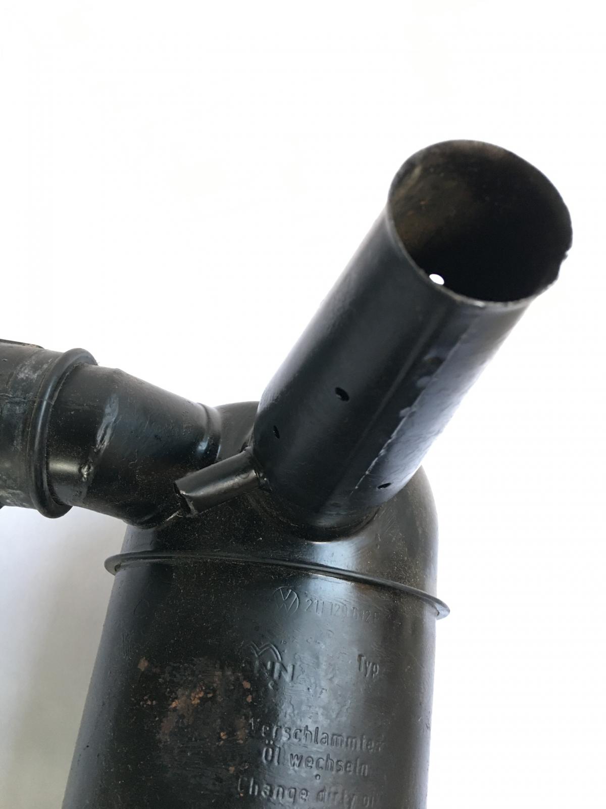

Close up of the larger oil breather pipe:
The vapor recovery fitting:

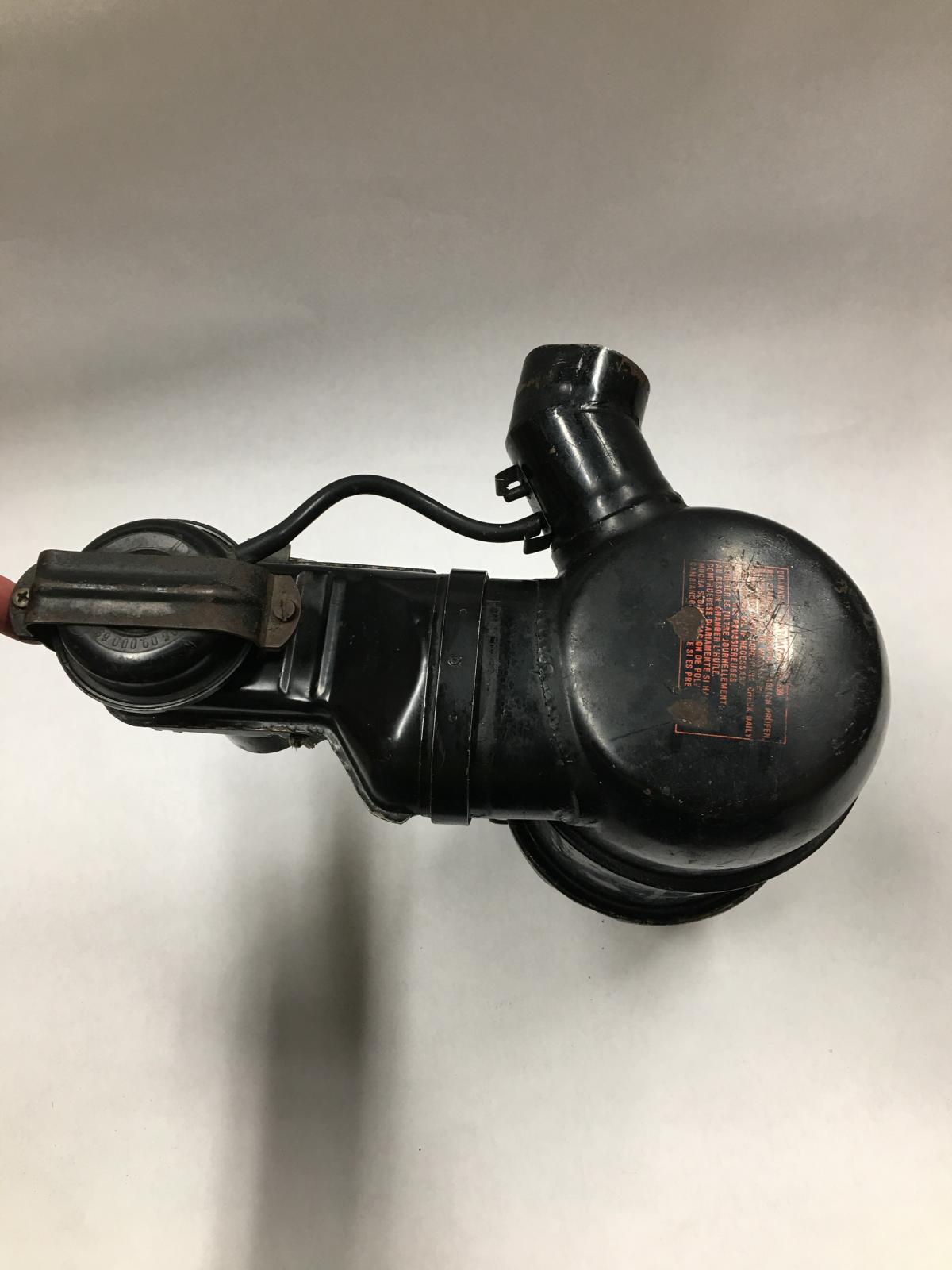

A top down view featuring the same service information seen earlier:

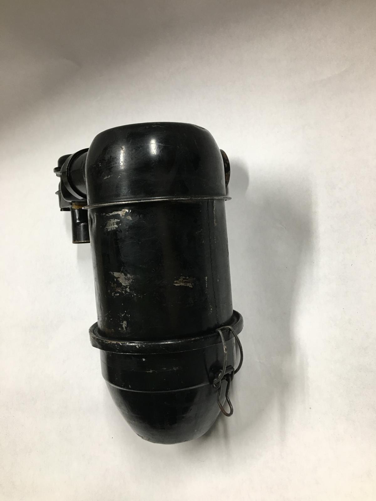

An overview shot:

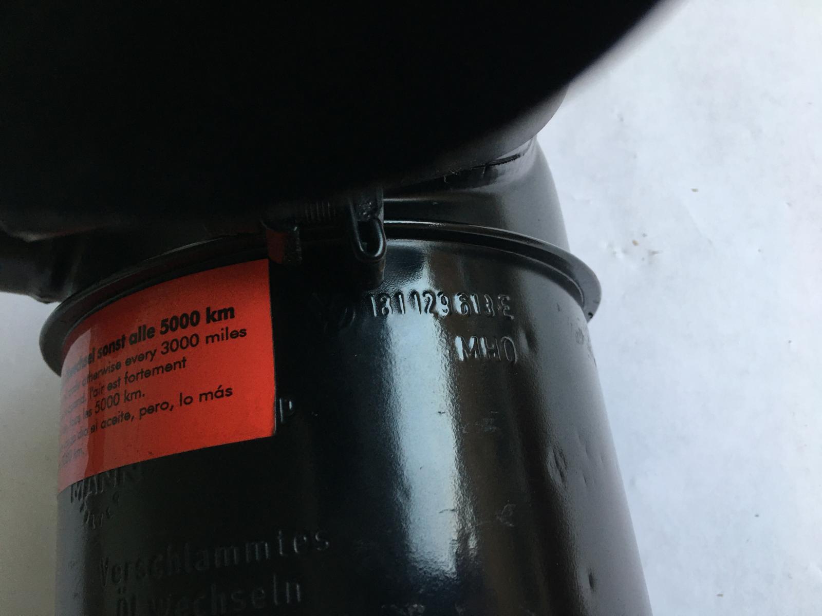

Close up of the part number (date code covered by the service decal):

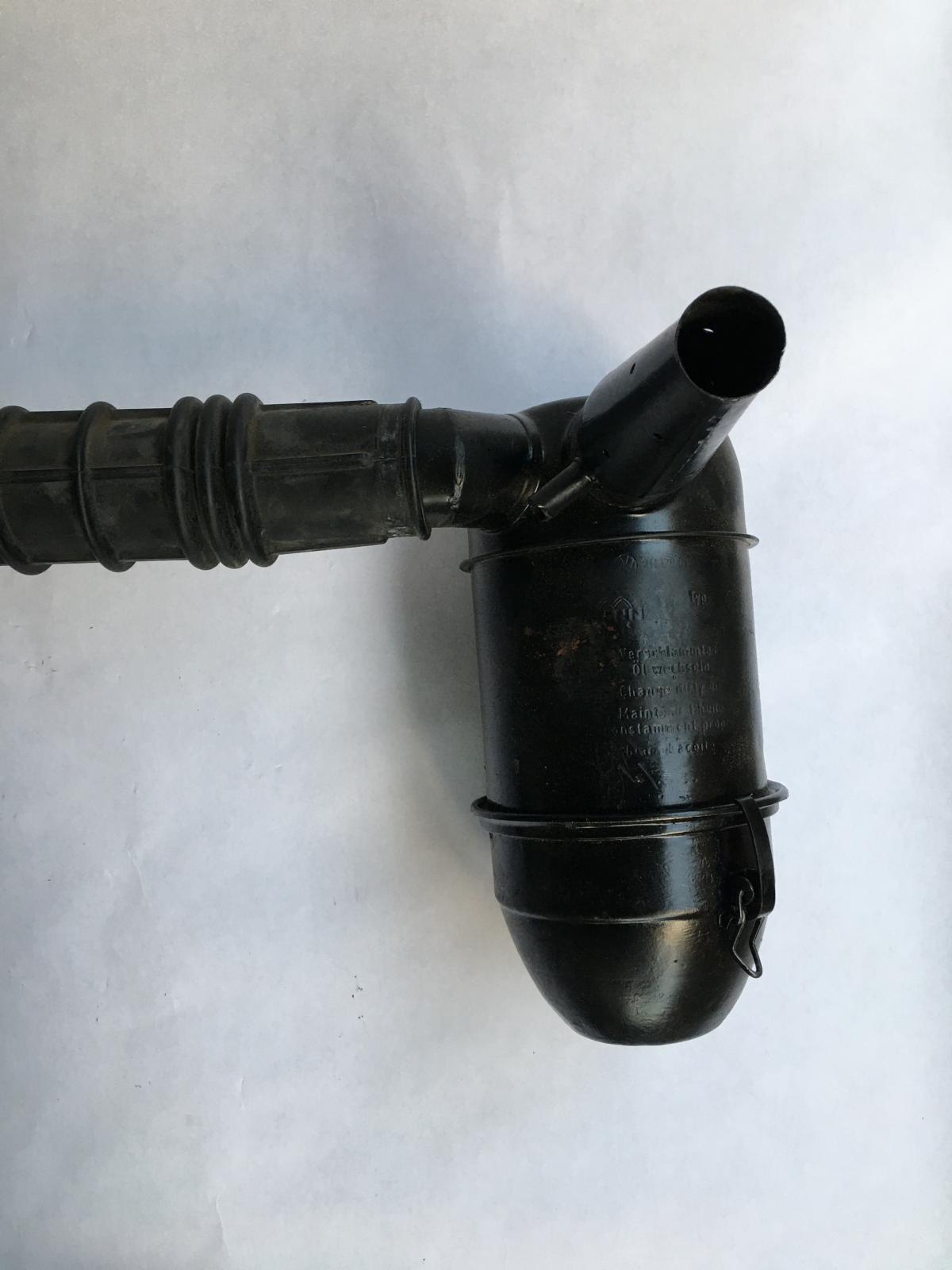

Angled oil breather fitting close up:
Side view:

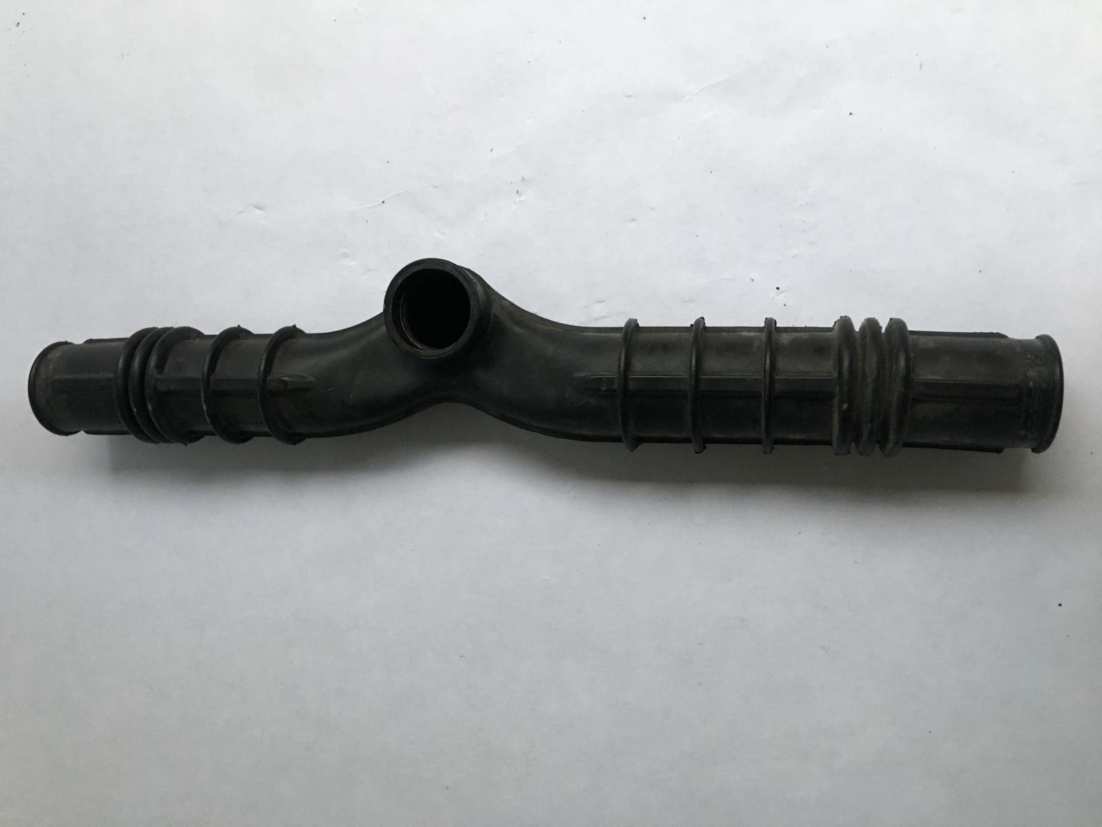

Overview of the angled oil breather hose mentioned:
Oil breather hose part number close up:

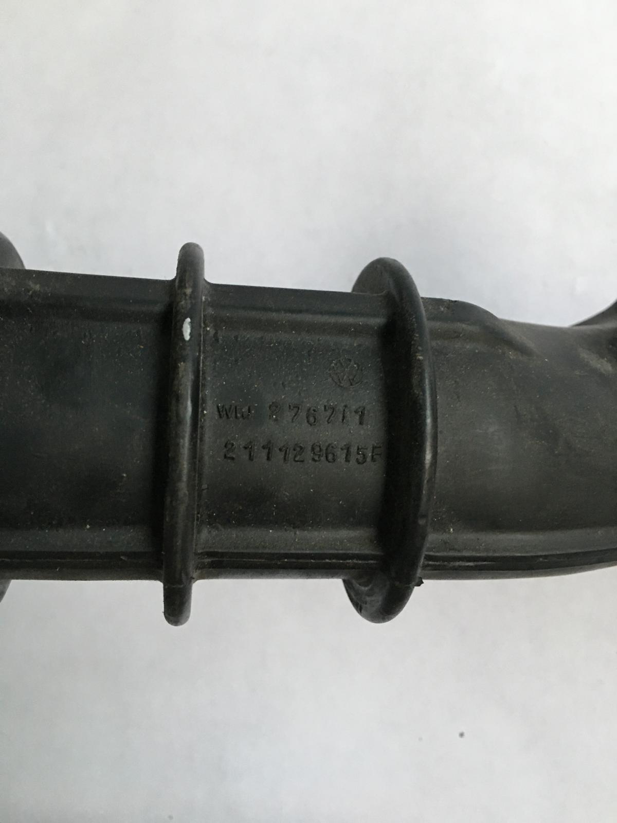

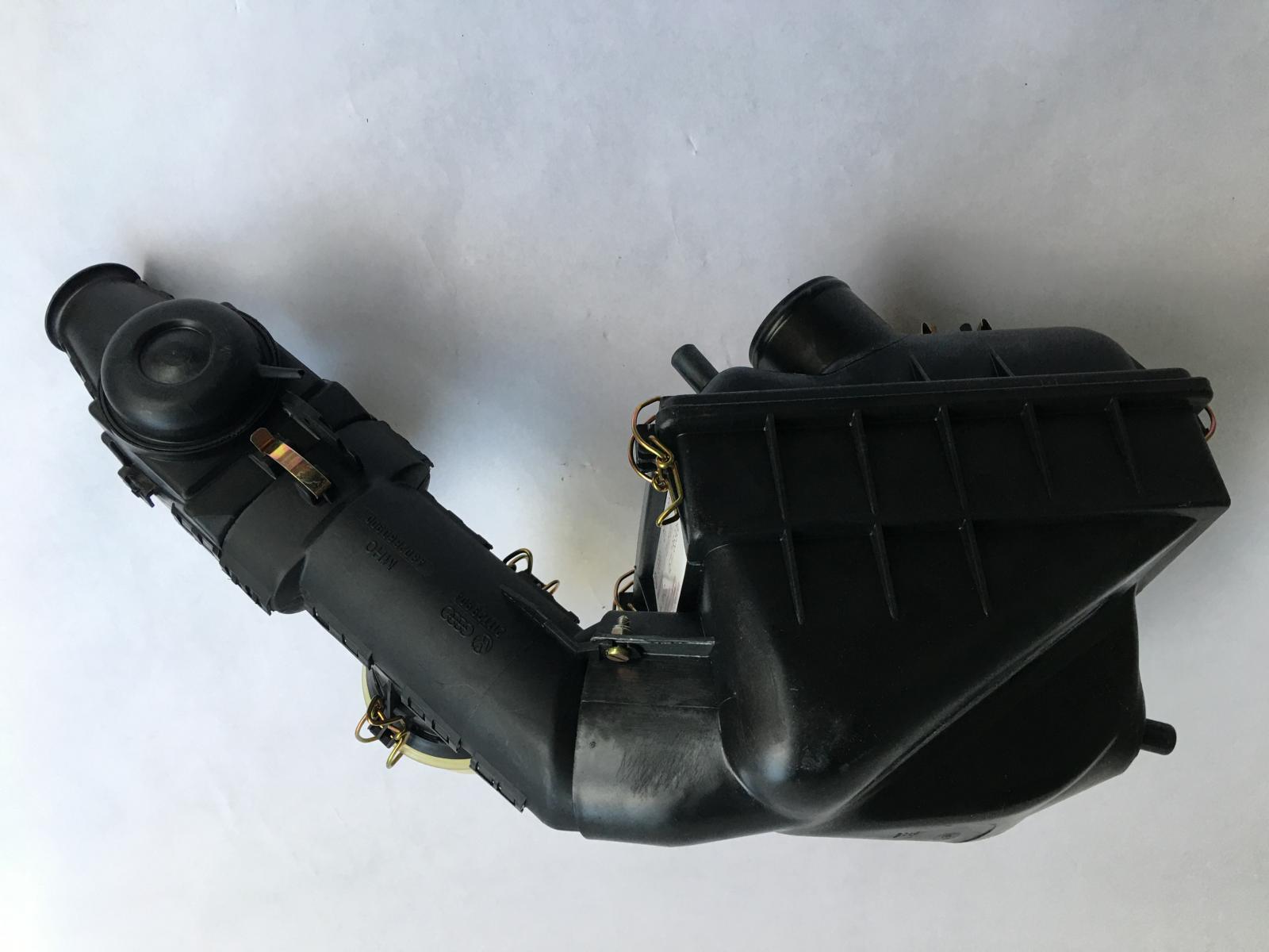

Paper Air Filter
In August of 1974 (the 1975 model year), a paper type air filter became available. The description of servicing the filter in the bulletin implies a different mounting arrangement in the engine compartment from the oil baths, but I don’t know specific details besides a quick release clamp holding the bottom. I have not seen any good pictures of the mount without air cleaner nor have I ever seen the air cleaner on a vehicle in person. Interestingly, the paper filter didn’t show up in owner’s manuals of that year, at least not the Spanish version that I have. Nor does it appear in the January 1976 German language manual. It does appear in the 1979 and 1980 model year manuals (both English and German). Also of interest is its absence from parts microfiches, which makes identifying the correct filter difficult. This NOS example (part number 211 129 607 K) is my best guess based on photographic evidence (primarily those later owner’s manuals). It is different from most type 2 paper filters in that it has a dust collection bowl before the filter element. I don’t know how effective the dust collecting bowl is, but it is an interesting feature. Before I move on, the factory did state that the carburetor idle jet for paper filters changed to 60 (otherwise sized 55 for the oil bath equipped vehicles since November of 1971).
Close up of the part number sticker:
Showing the various fittings:
Top down view:
Side view showing the dust bowl:

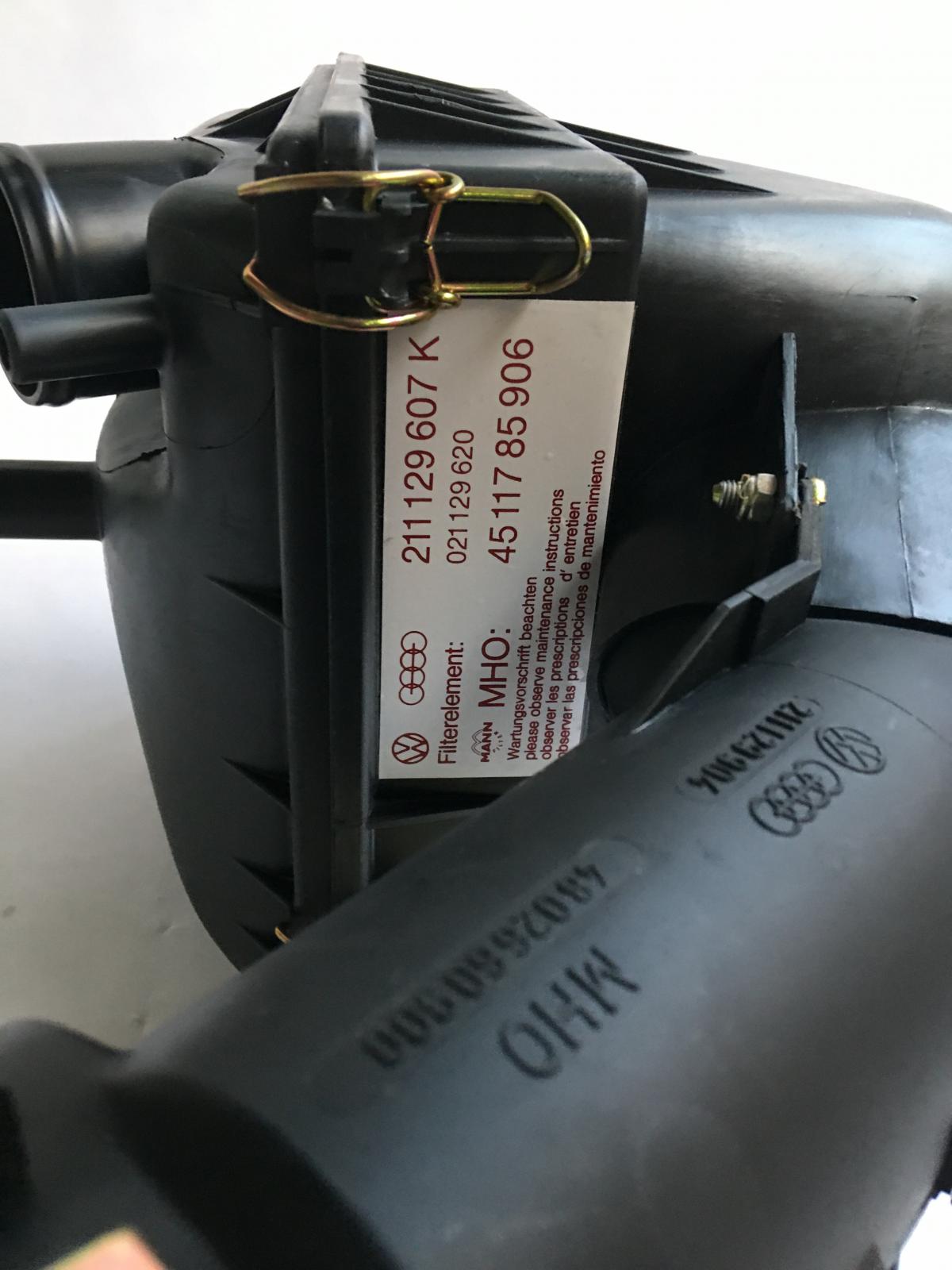

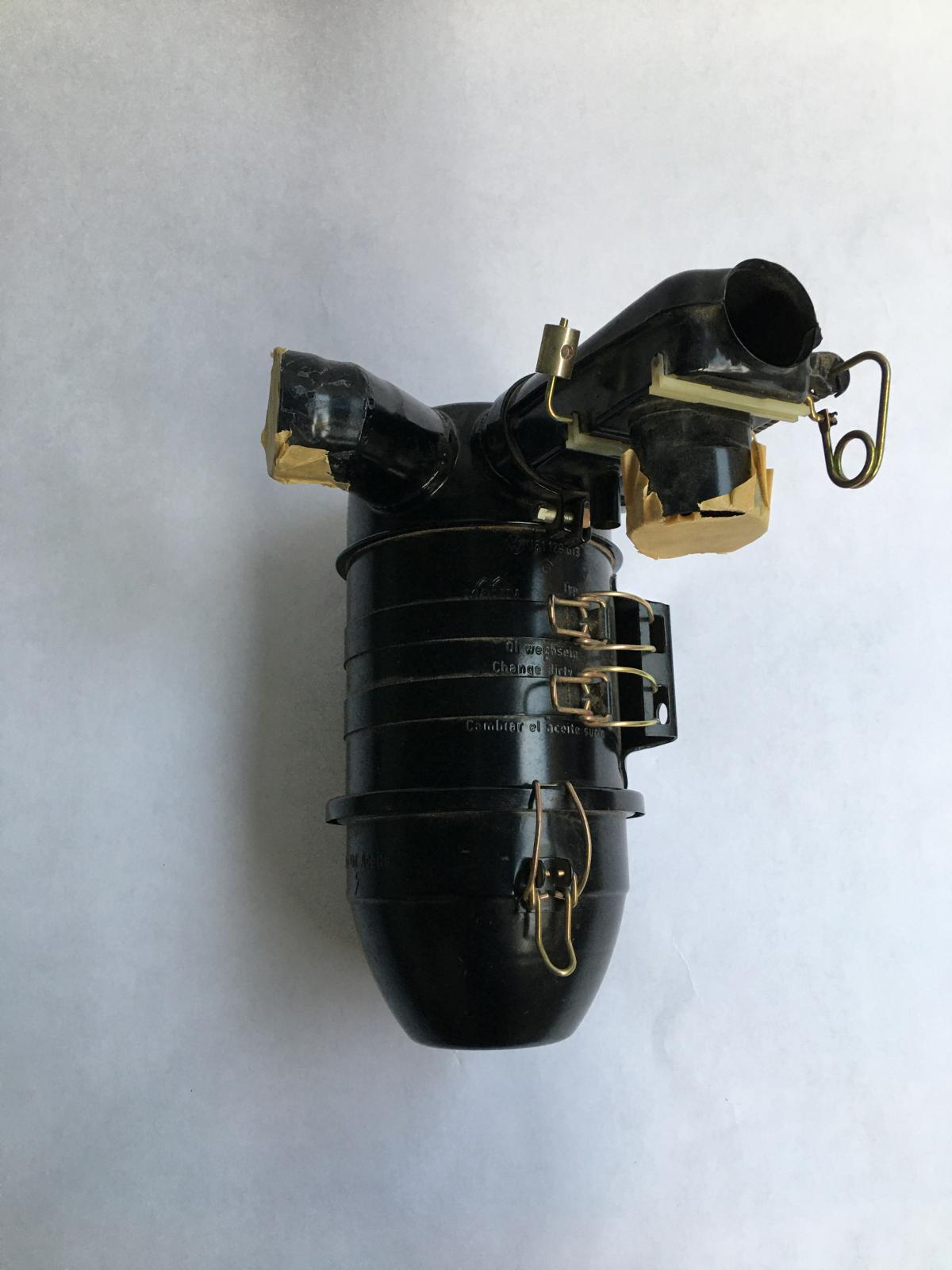

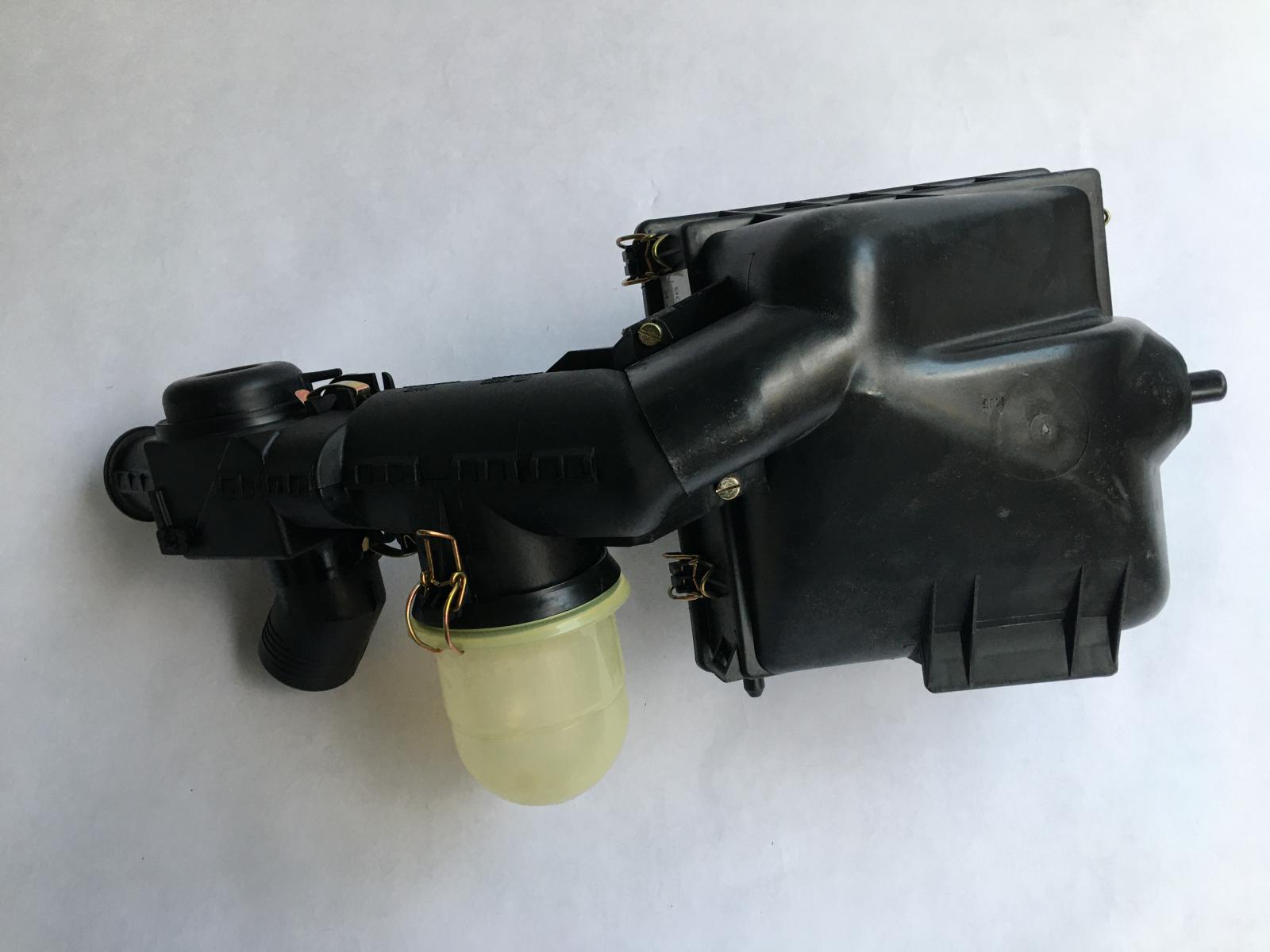

Dual Air Cleaners

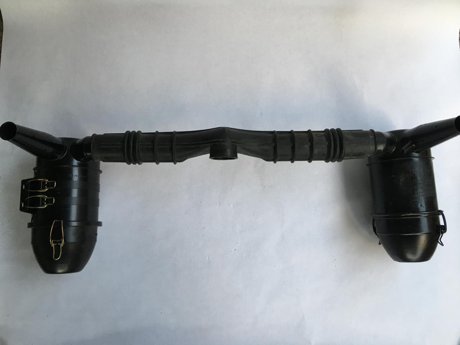

Lastly, and probably of most interest to folks is the dual air cleaner system. As far as I have seen documentation for, the dual air cleaner system was first mentioned as an option (M 153) for the 181 in a technical bulletin dated June of 1971 specifically for “dusty countries”. The filters themselves carry the part numbers 211 129 611E and 211 129 612E. In the picture, the driver side example is NOS and the passenger is used. Of note, both air cleaners lack preheating unlike all the previous 181 air cleaners discussed. Presumably dusty countries are also hot, at least in the minds of VW, and didn’t require preheating. Based on the wax thermostat temperatures, I wonder if VW assumed an ambient temperature in dusty countries of at least 27.5°C. I would love to know which countries VW considered to be “dusty”. Interestingly, vehicles built before the introduction of the dual air cleaner option appear to have been anticipating it. While the mounting bracket for the driver side air cleaner is not present on those early vehicles, the lower panel on the driver side of the engine compartment has clearance for the oil bowl that could eventually go there. It doesn’t appear to be related, but at the same time as dual air cleaners were introduced (and in the same bulletin), the 31 PICT 3 carburetor for civilian models was changed from part number 181 129 027 A to 181 129 027 C. The jetting appears unchanged. The distributor paired with the civilian carburetor changed from 113 905 205 AJ to 113 905 205 AL at the same time so the carburetor change is likely related to changing from Dual Vacuum Dual Advance (DVDA) distributors to Single Vacuum Dual Advance (SVDA) distributors. The military (M 63) carburetor 181 129 027 B and distributor 181 905 205 remained unchanged at that time. Only a few months later in November of 1971, the civilian “C” carburetor would get revised jetting and the military carburetor would change to 181 129 027 D also with the same revised jetting. Nothing is mentioned about the dual air cleaners in the carburetor revision so the carburetor changes are likely unrelated in my mind.

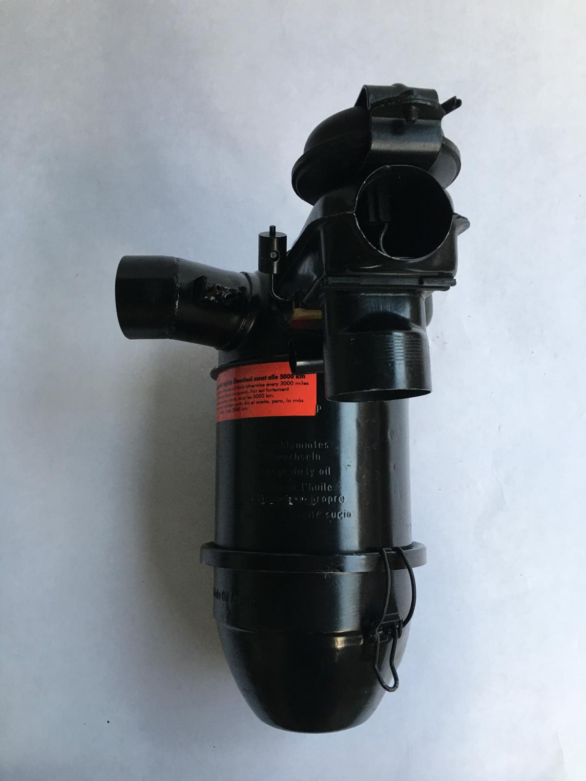

Overview:
Showing the pieces separately:
Driver side air cleaner (NOS):
Close up of driver side part number:

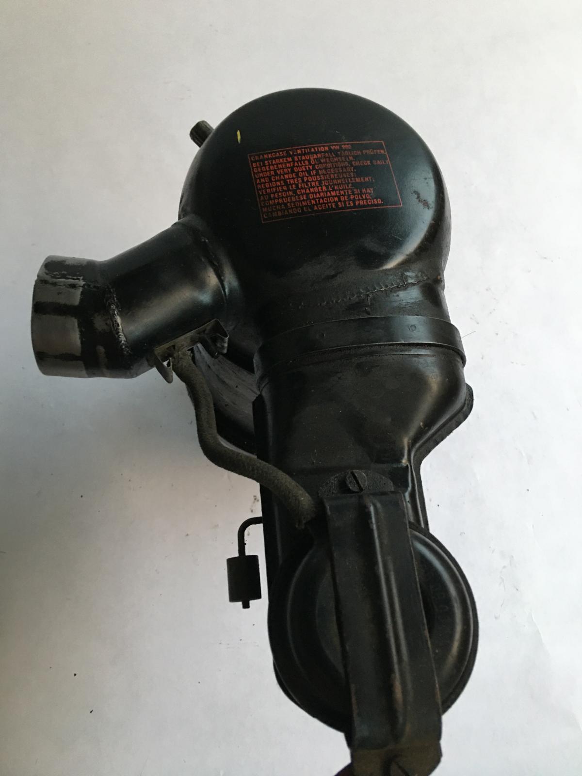

Passenger side air cleaner (used):
Close up of passenger side part number

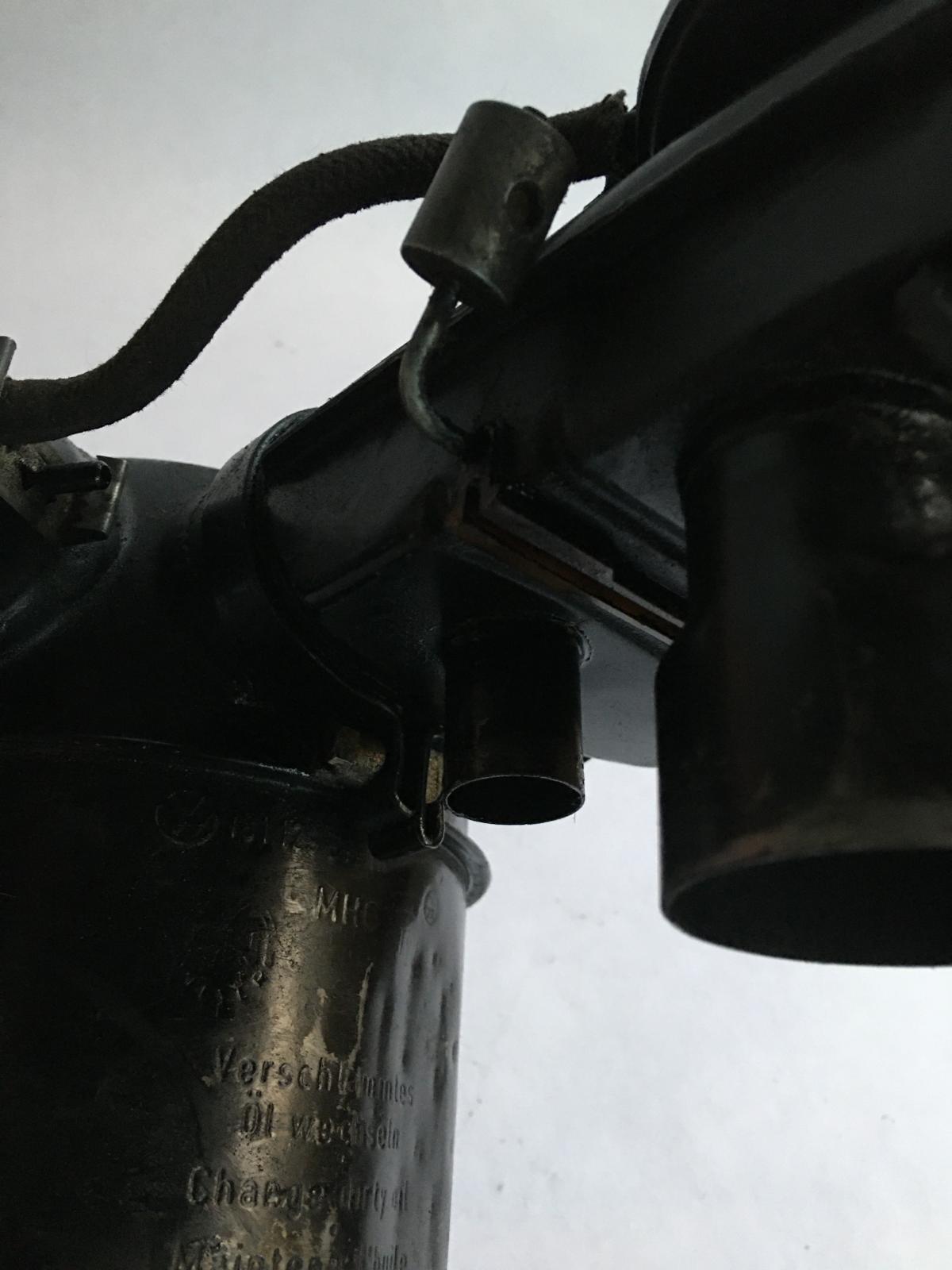

Close up of the passenger air inlet showing oil breather and preheating:
Underside of the dual air cleaner elbow:
Close up of the dual air cleaner elbow part number:

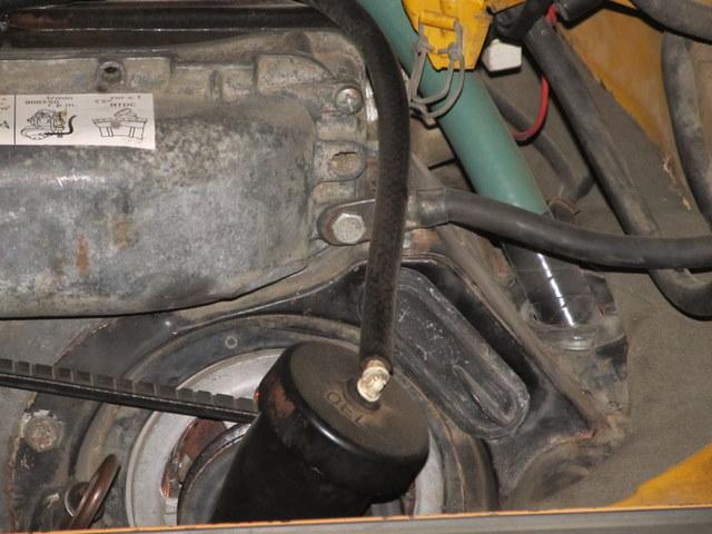

Are there any sites where we could find the stock left airfilter that is missing on the car we have?
Click to view image
1952 Citroen TA 11BL
Wildthings
Joined: March 13, 2005
Posts: 51760
Wildthings is offline
PostPosted: Fri Oct 04, 2024 4:39 am    Post subject: Re: Factory Air Cleaners Reply with quote
This is a filter for an industrial engine that cold be made to work.
It's a bit larger than the T181 filter.
