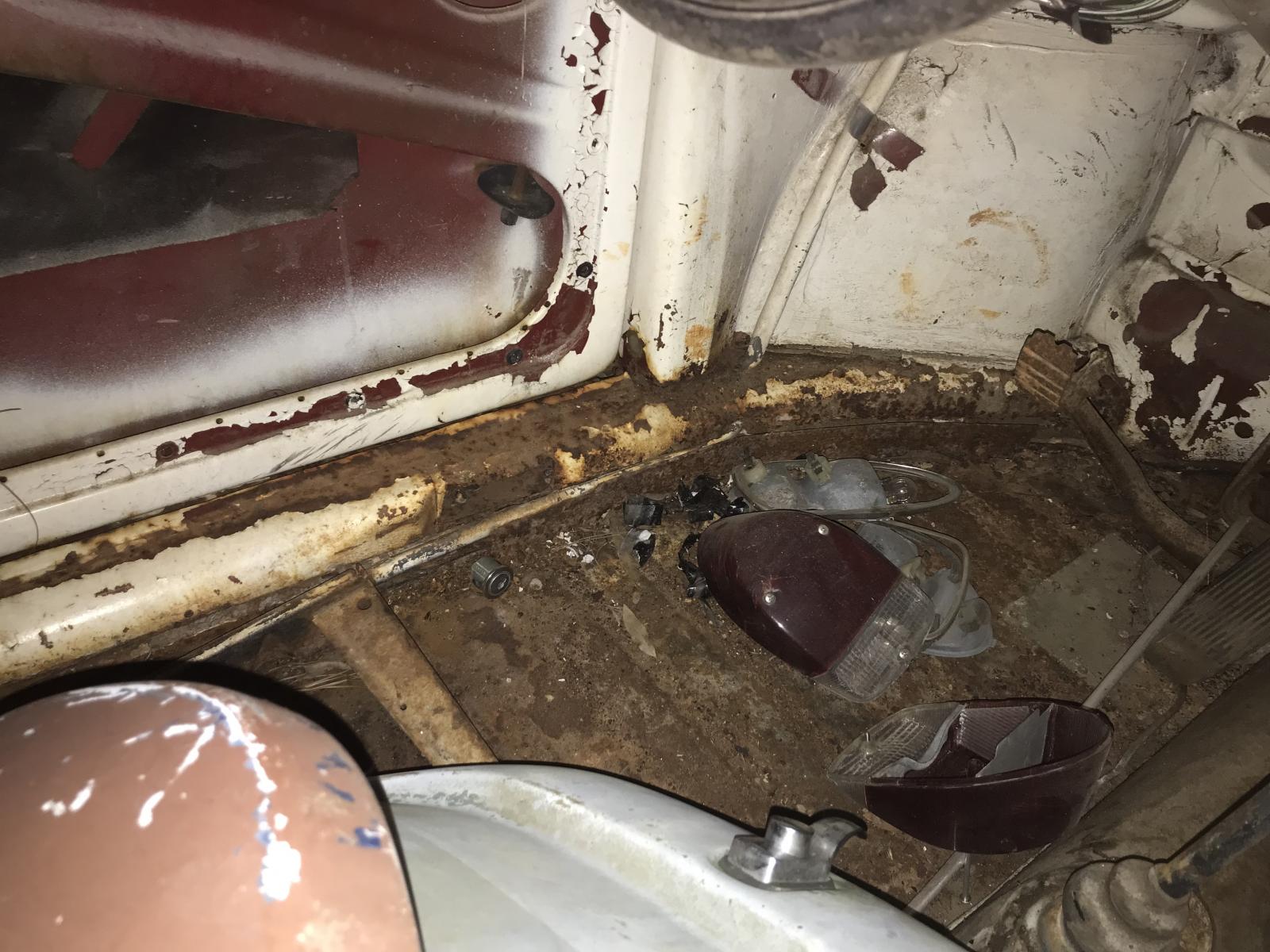

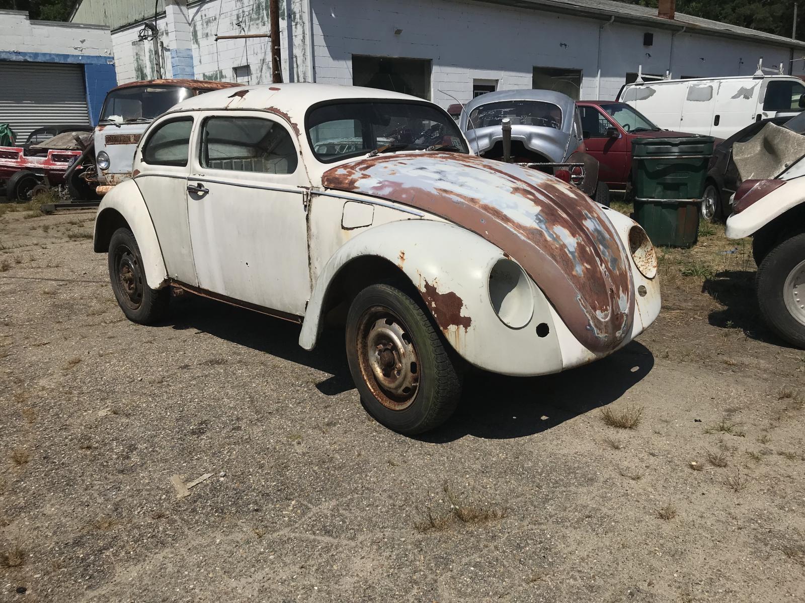

I just got this 1970 chopped bug. It has a 1996 inspection sticker, so I assume it’s been sitting outside for about that long. It’s solid in all 4 wheel wells. Driver’s heater channel is the worse of the two. I know ill be doing at least pans. It was red, now it’s white. I talked to a blast company, he uses glass and it’s $160 an hour. I’m just scared of bringing home Swiss cheese. It’s probably just going to be a flat or satin black lowered cruiser, not a show car.

In reference to the Swiss cheese comment, are you worried about damage caused by the glass beads or what you will find underneath?
You don't show pictures of the outer body. These areas are the ones most sensitive to warping etc. As far as underneath and in non visible areas, you want some aggressive media blast to get rid of undercoating or really rusty areas. These areas are far less likely to be affected by aggressive media blasting. Glass beads are far less aggressive than say aluminium oxide or garnet.
It depends on your time frame. If you have the time I would remove paint on the outer body in sections and immediately epoxy just that section. Your removal process could be to sand back to bare metal or to use paint stripper followed by correct neutralisation then epoxy. As I have found rust spots under filler that has been applied to the bare metal previously, all filler needs to be removed to ensure you have no problems down the track.
If you don't have the time, then you have to use a media blaster. Given the issue about possible warping you should get a recommendation from a couple of people who use a specific media blaster. It's easy to do media blasting. I have done it. But if you get a cowboy to do it, you might end up regretting that decision and taking far longer to repair than if you took your time to do it yourself and remover the paint manually.

My concern isn’t warping. This guy is a one man shop and claims to not warp metal. Just pin holes or bigger. As I mentioned the roof is chopped, but the bondo cracked and water did get under it. I may end up refilling the center with another roof.
