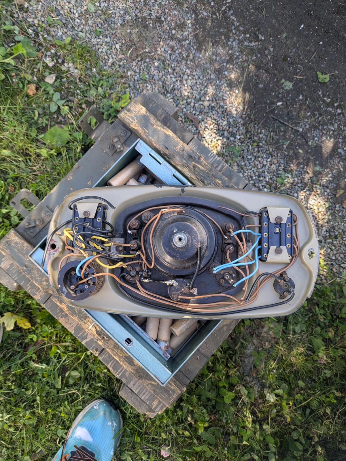

Need help to find out which car this fits to and a prize to sell it fore

Looks like a Kübelwagen dash, but I can't tell you which year.

kubelwagen instrument panel used up to body number 25000 in early 1943.
but is it genuine? the panel pressing looks very clean for 80 year old steel...

Pretty sure its originale my late father in law had several kubel, schwimvagen and other cars back in 1970-2000

It seems authentic but the absence of the Steckdose combined with the offset position of the Anlasser button are strange.
