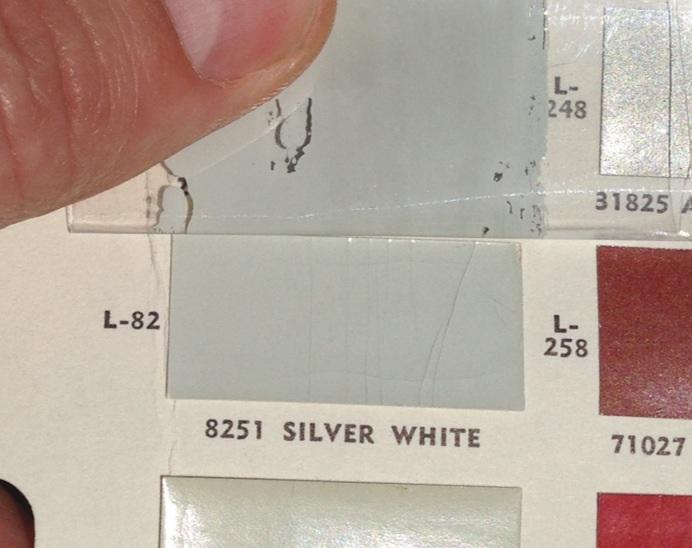

The PPG # is 8251 according to info on this site, maybe they can cross-match?

Well, I found it in Spies Heckler, single stage enamel...$84 a quart!
But that's good quality paint.
I'll try a local PPG dealer on that old Ditler/ppg number too.

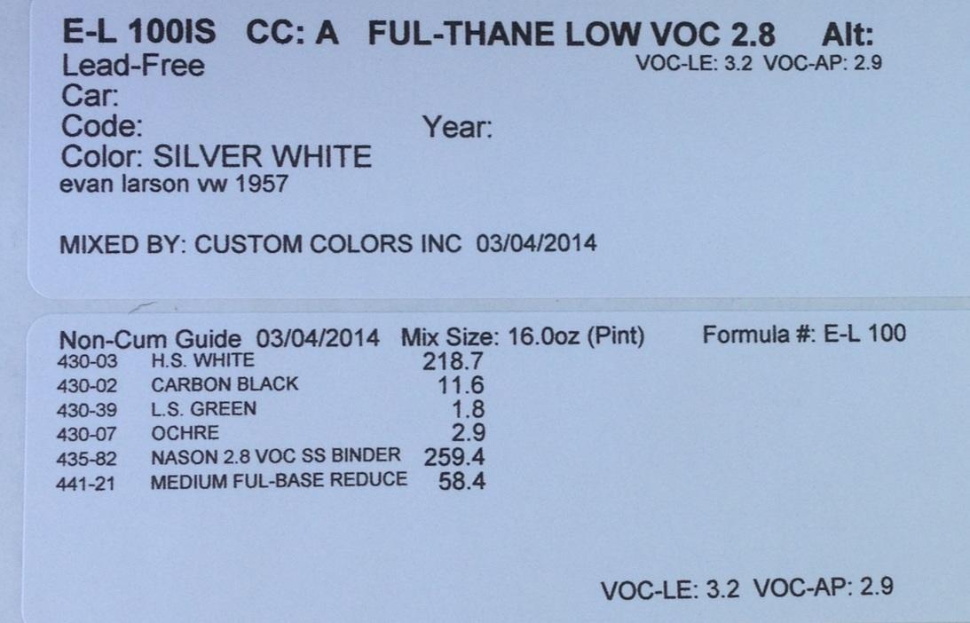

PostPosted: Fri Mar 07, 2014 4:38 pm    Post subject: Reply with quote
I'm sure original poster has sorted their paint by now, but just to carry info forward...
DuPont Nason single stage mix I just had done.
Cheers,
E

I'll be trying this shortly with my local paint supplier. I had them mix up some PPG paint code 8251 to paint my rims and they came out with a tan/yellow tint to them. Not happy and now i have to repaint all five rims......

PostPosted: Fri Jun 21, 2019 2:32 pm    Post subject: Re: L82 Silver White Paint Mix Code? Reply with quote
will cut and paste make it easy for the paint shop ? I called while driving and the guy had no clue. And i have no clue why this does not add up to 473 Ml.
Mix Size 16 oz
430-03 H.S. White 218.7
430-02 Carbon Black 11.6
430-39 L.S. Green 1.8
430-07 Ochre 2.9
435-82 Nason 2.8 VOC ss Binder 259.4
441-21 Medium Ful-Base Reduce 58.4
easy e
Joined: May 28, 2008
Posts: 3939
easy e is offline
PostPosted: Fri Jun 21, 2019 3:05 pm    Post subject: Re: L82 Silver White Paint Mix Code? Reply with quote
I don’t know about the ml comment.
I’d click once on that mix image... it will open up in a new browser window.
Copy the text in the address field & send the image address to paint shop.
They’ll click on the link & the image will open in a web browser window.
