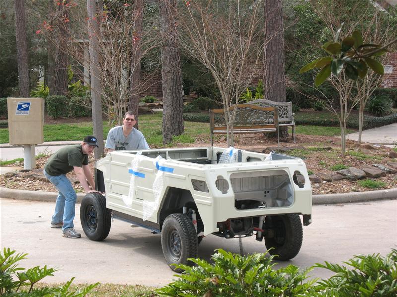

quick flash back when I dropped her off at the shop
View user's profile Send private message Send e-mail AIM Address Instagram Gallery Classifieds Feedback

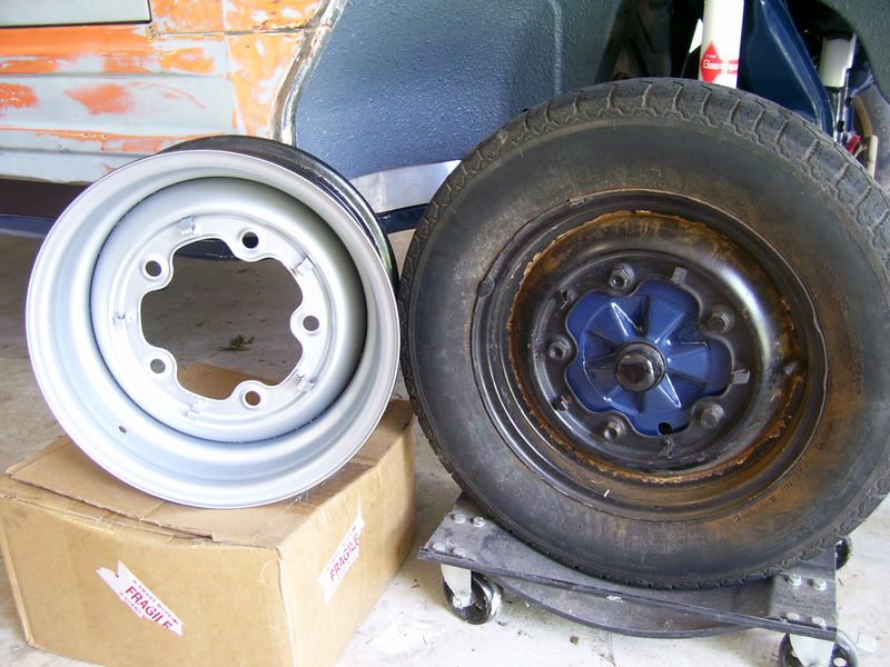

Wheels will be widened 15" beetles. I will be meeting with powdercoat shop this weekend. Another referral, hopefully price will be right and quick turn around.
15x6. second photo shows stock Thing wheel next to widened 15" beetle.
She will see larger offroad tires and stock hubcaps. May change in the future. I like the wide 5 smoothie look.

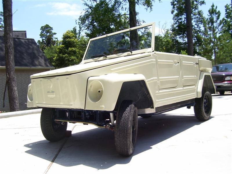

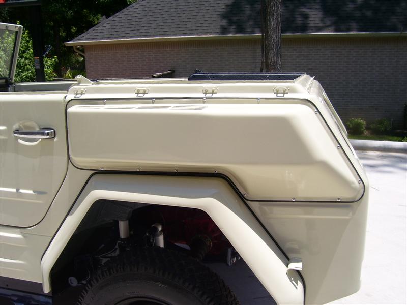

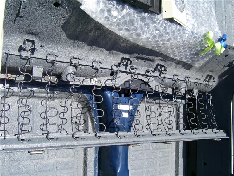

Been putting her together. pushed her out of the garage today to get some pics.
fenders installed, new windshield, seal, frame installed, ear muffs installed with new seals and aluminum rivets, nice color matched engine bay, started putting dash trim and handle back on, still need to modify steering due to lift. windshield wiper arms cleaned and fresh paint with new blades. cleaned wiper motor and replaced old grease inside.
ran into problems with old pedal assembly. could not get apart prior to rebuild. clutch pedal and brake pedal hang up. brake spring too weak. could not get pin out, rusted solid and maybe metal issue. replaced with new so will be swapping pedals over. found out new replacement had a wider spreader on clutch pedal. heated up metal and slightly bent her in. much better clearance now with body member by foot wall.
all but one door handles installed with cleaned up and freshly lubed latch/catches. keeping deck lid off for now until get to engine.
