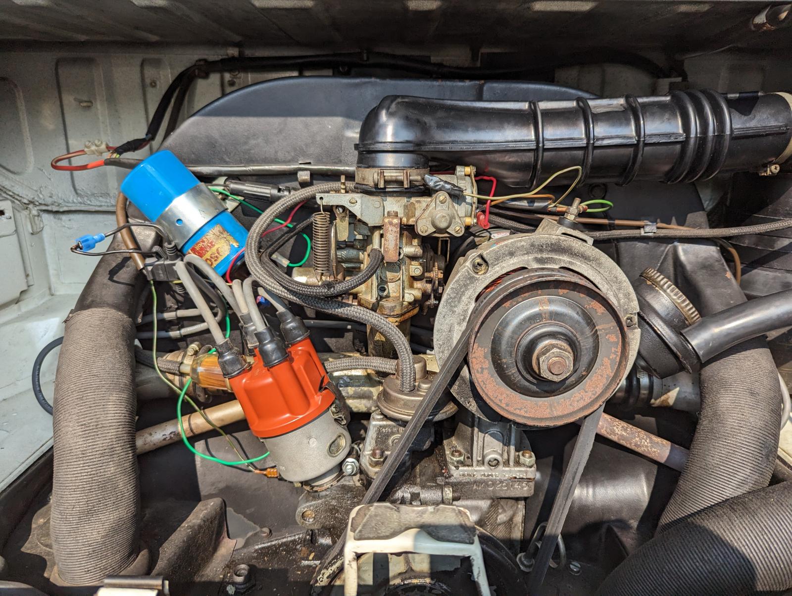

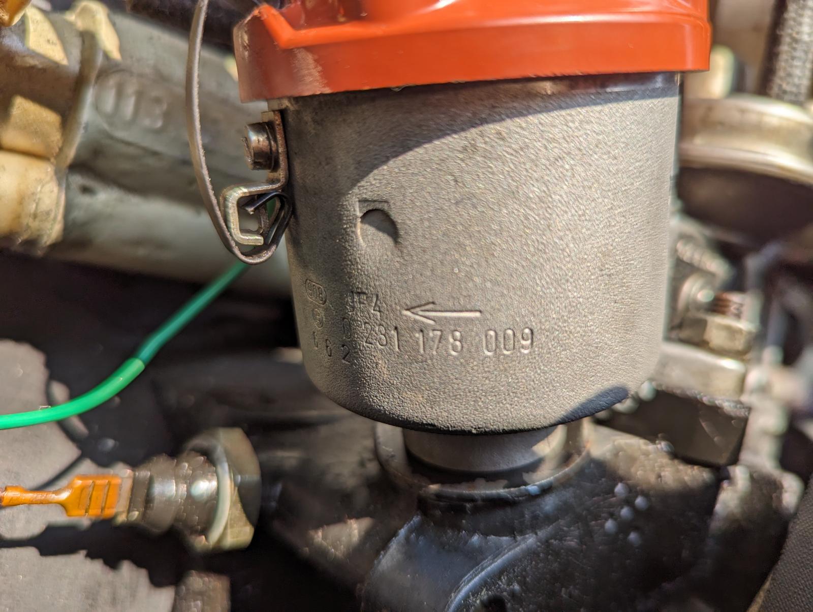

What distributor are you using?
Post a photo of your engine.

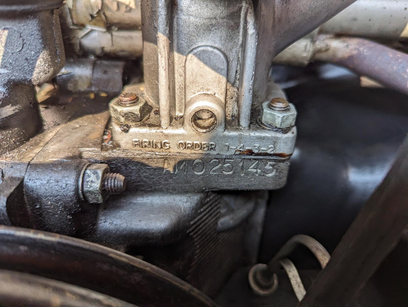

PostPosted: Sun Jun 18, 2023 2:07 pm    Post subject: Re: Timing Issue - will only start at ~5° ATDC Reply with quote
Distributor is a 009, Engine code AMO25145

Time the 009 at 7.5 or max advance 28 to 32 degrees.
Your engine will run better without the 009. Get a 113 905 205 AN (stock unless California model) or a 043 905 205 (034). That will get rid of the hesitation at low RPM.
