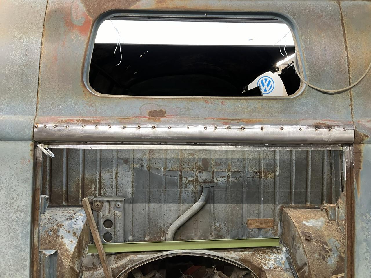

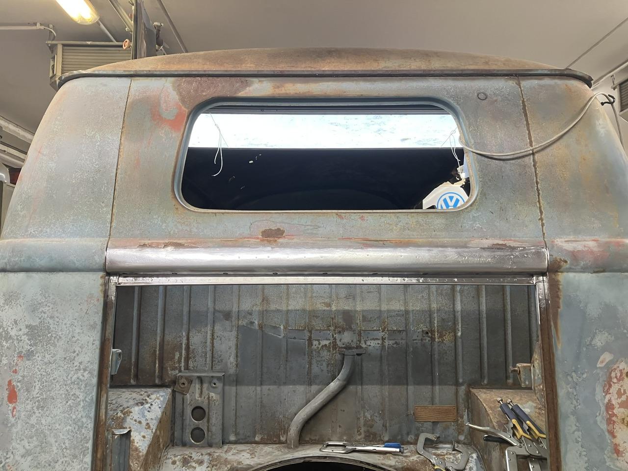

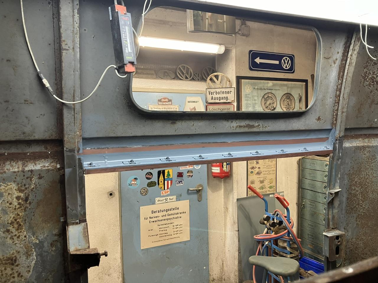

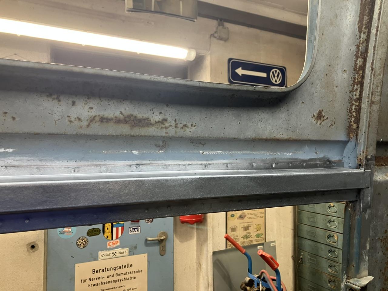

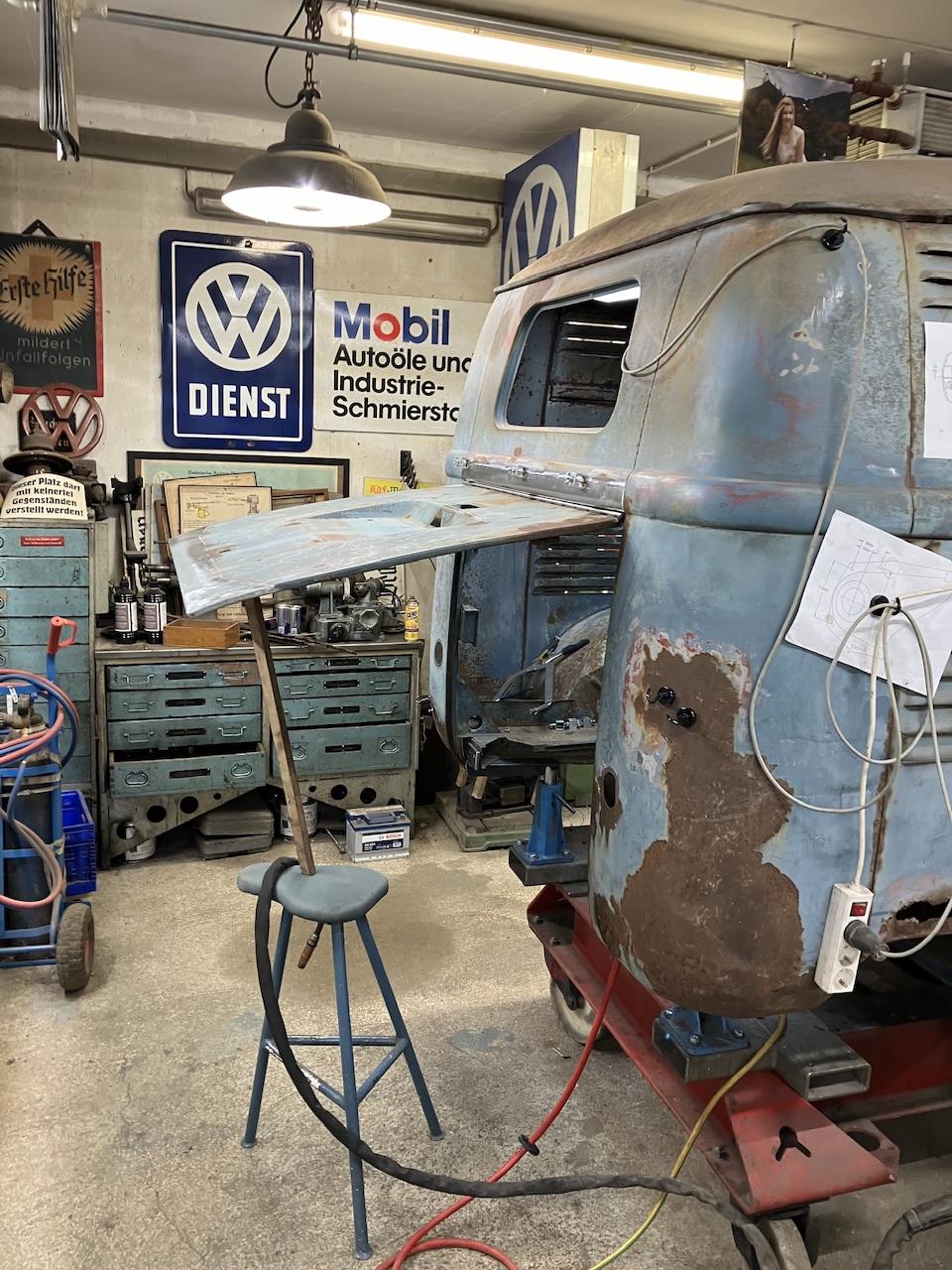

That panel about the hatch eats a day of work again:

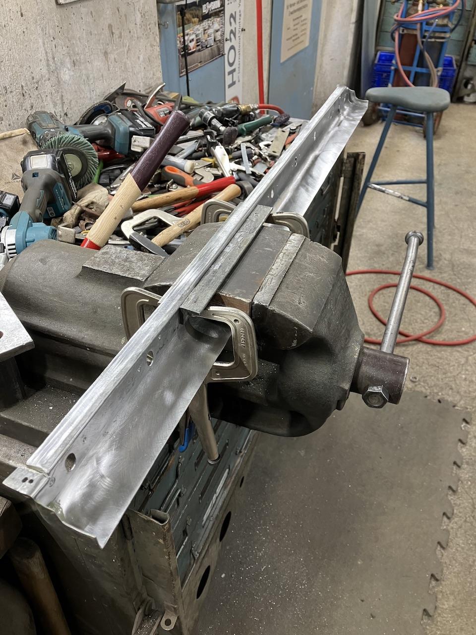

Rebent the seal channel:
Adjust the holes for the hatch srews:
Weld the cages for the nuts back in the new place:
Open, adjust, close, adjust, rebent, install, disassemble and so on for hours...
Some spots, and some beer after that!
-Christian

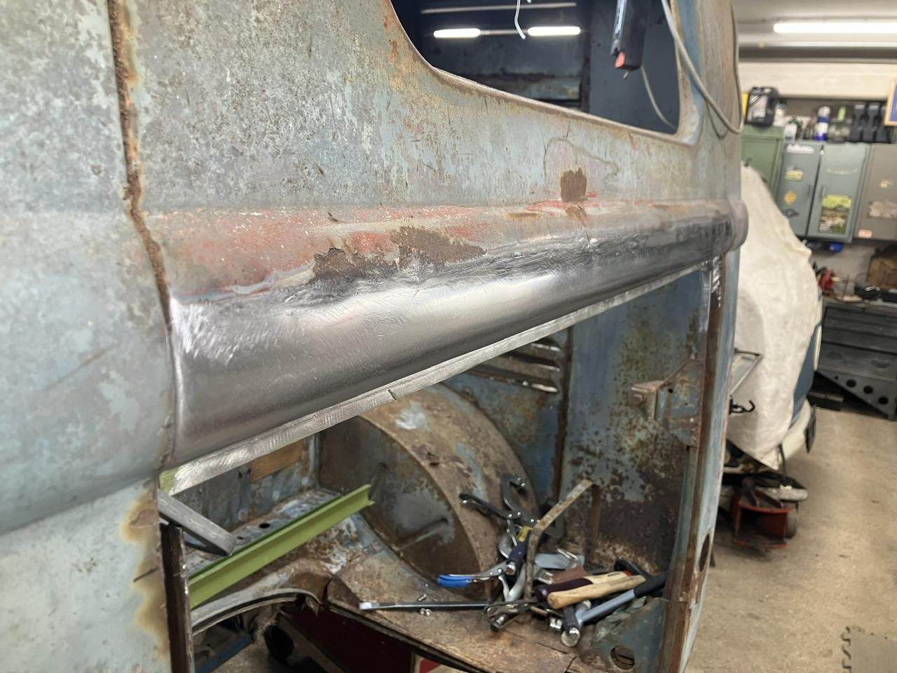

Welded the engine hinge panel and fitted the inner seal channel:

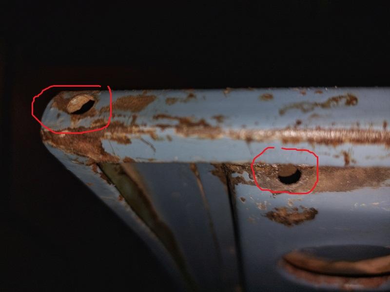

I hope you saved the trim strip which was between the hinge and body on the decklid. That is unobtanium, and is worth restoring or making your own. The repro stuff is WAY too thick and has too big a bead diameter.

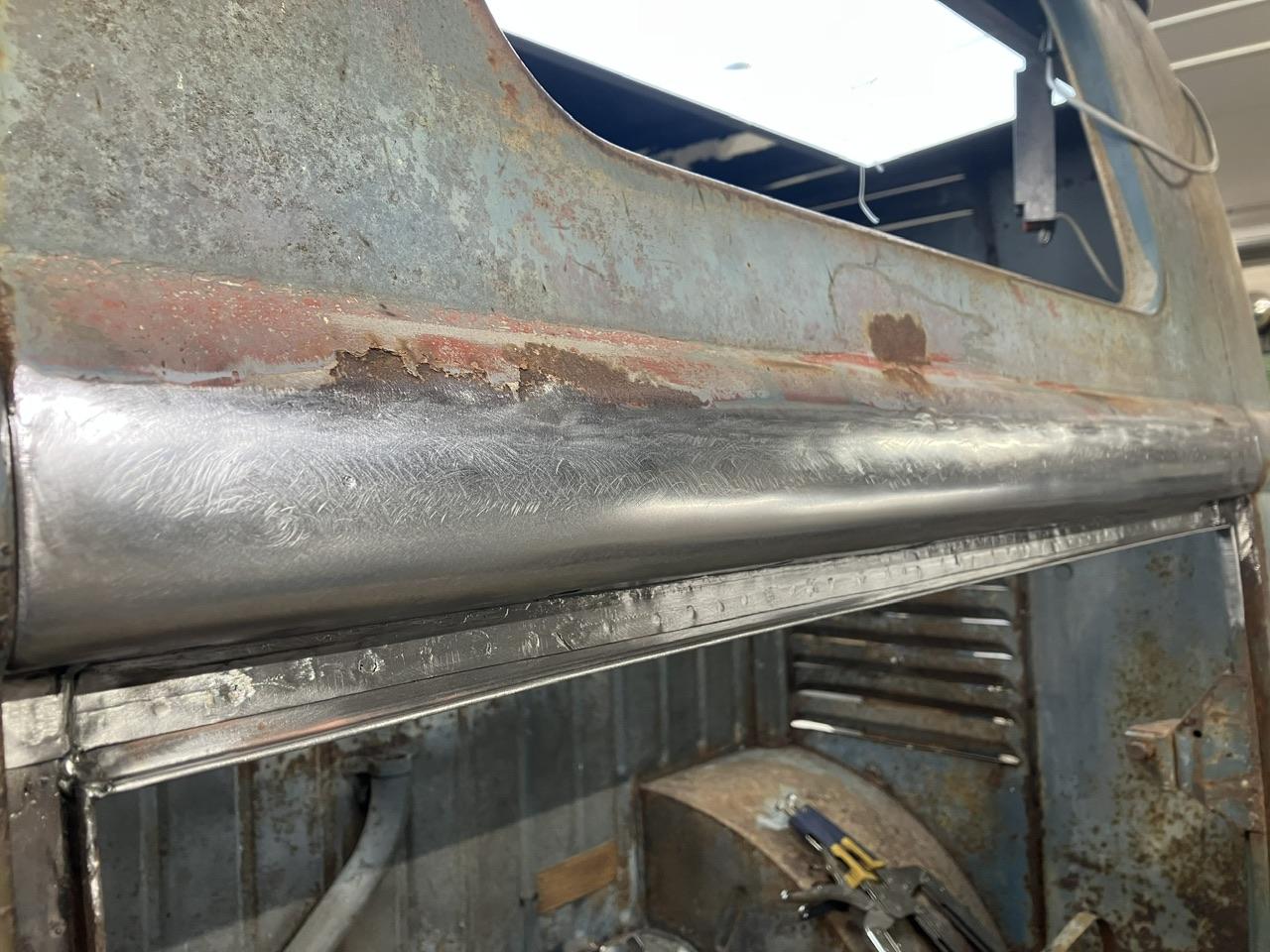

Spotwelded the rear seal channel in the right place:
The strip is gone to far away, maybe i can use it as a template, good idea!
I thinking about to buy one but when you say they are bad i try to male my own.
I also have a big problem with the horizontal fire wall above the engine, klassic fab doesn't have it anymore.

splitface wrote:
I have drain holes on lower and upper part of my engine lid but mine is 54 model
they look like original holes and only one hole on driver side of outer skin
NOT sure if this was on 52 , when it was changed - added
took pics of all 4 corners on my 54 lid for your reference
Nice detail on the drain holes
Would be nice to pinpoint the changeover month
