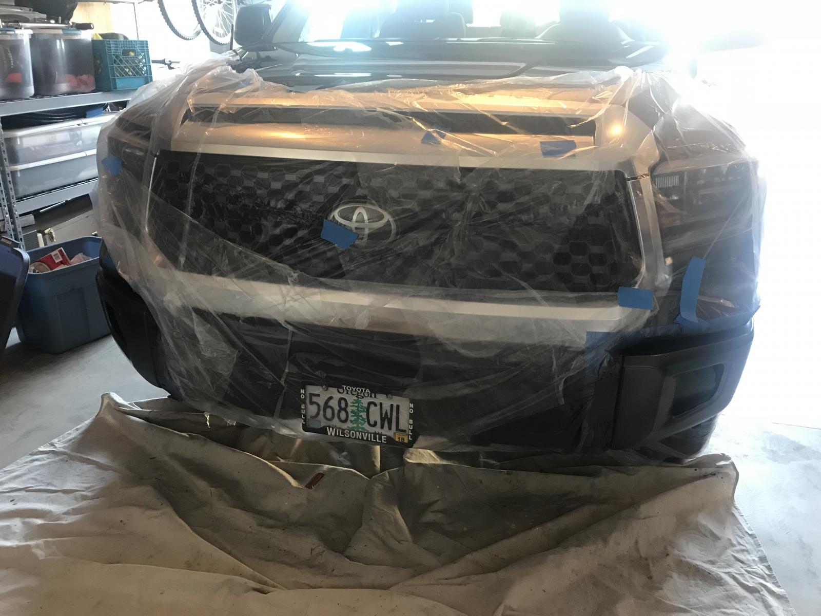

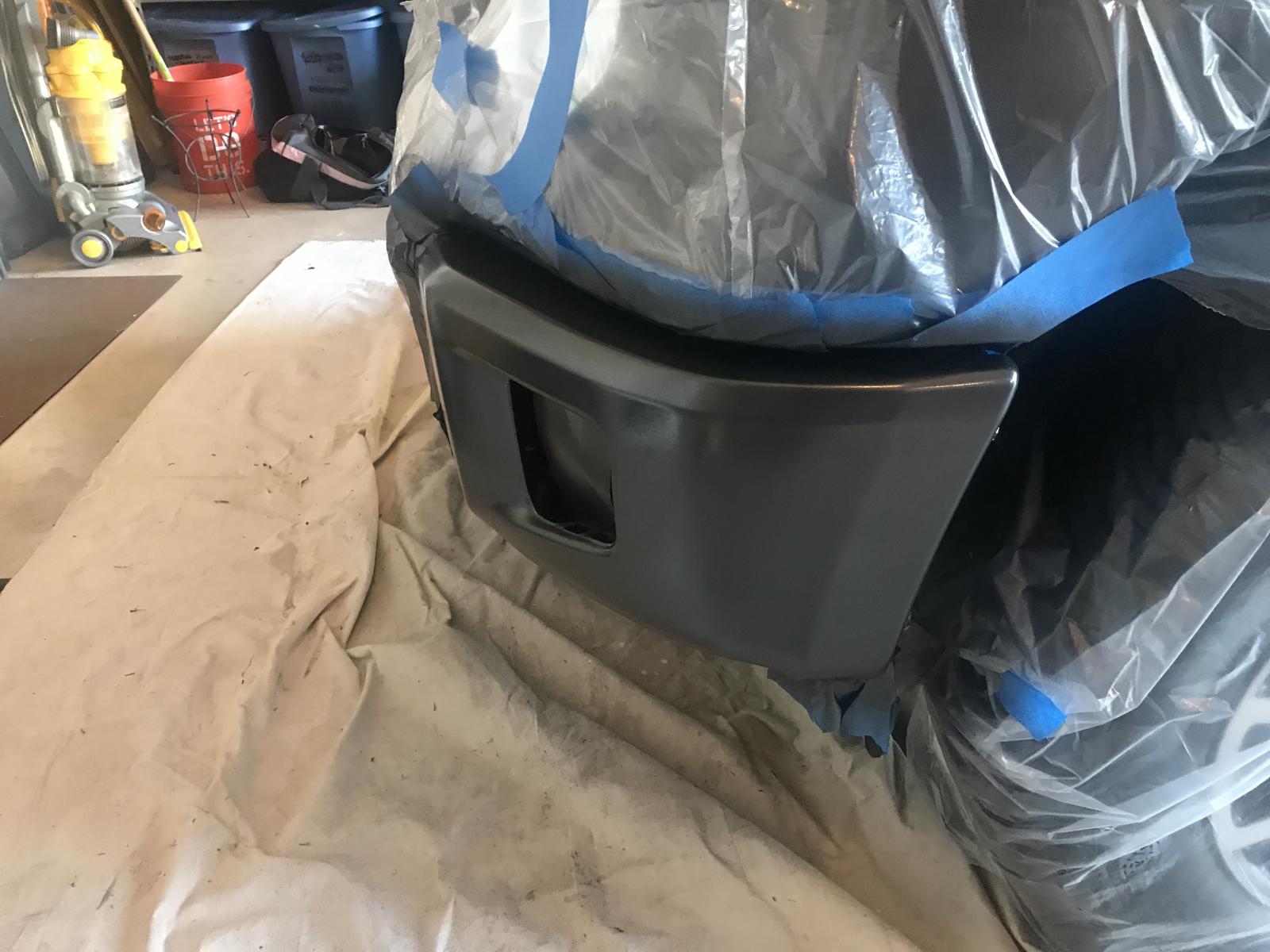

Have you considered plasti dip?
It’s available in more colors now, you can buy in spraybombs, it touches up nicely, its relatively inexpensive, you can buy PD’s gloss coat to add some shine, AND- it peels right off if you don’t like it.
I did the bumper ends on my Tundra, and i am pretty impressed with the stuff....

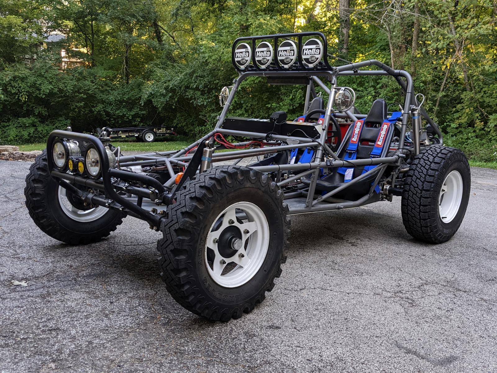

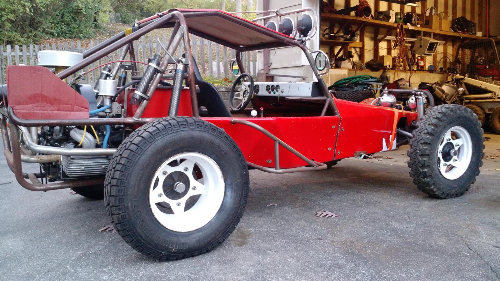

So 5+ years later I have actually started to do this. The car is 1000% better otherwise and now I'm fully stoked on getting this body looking fresh to really round out the package. Here is the car now: Very Happy
I also built a beautiful new engine for it which puts it comfortably in the 13s at the strip.

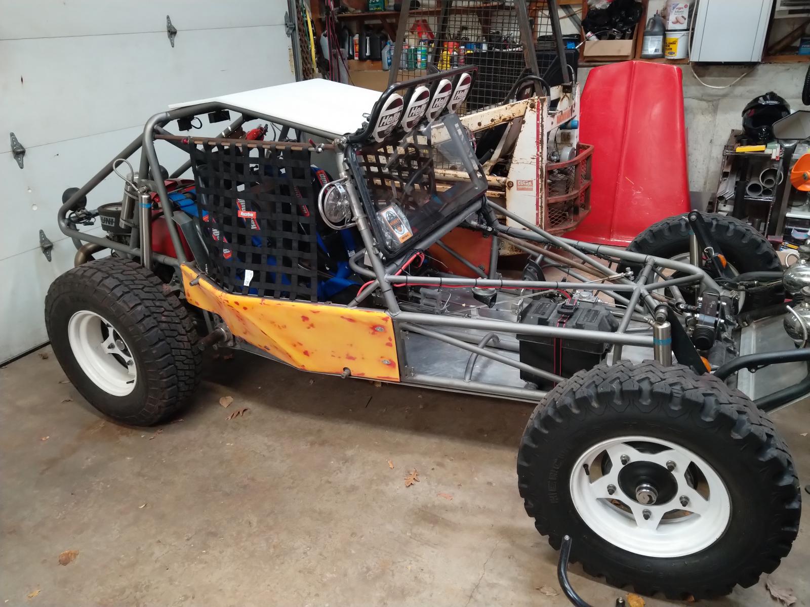

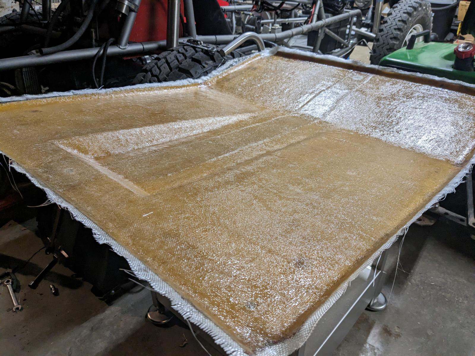

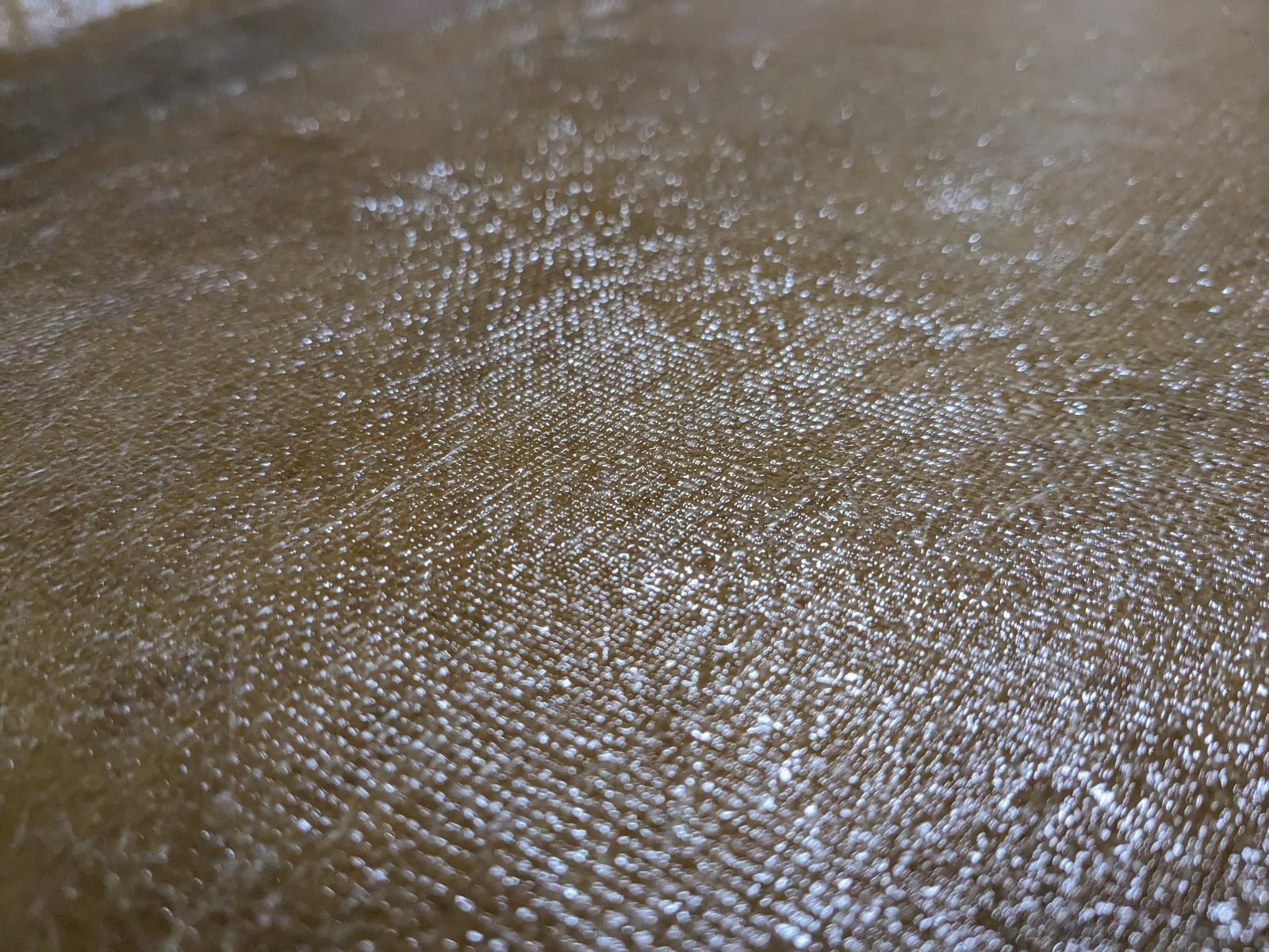

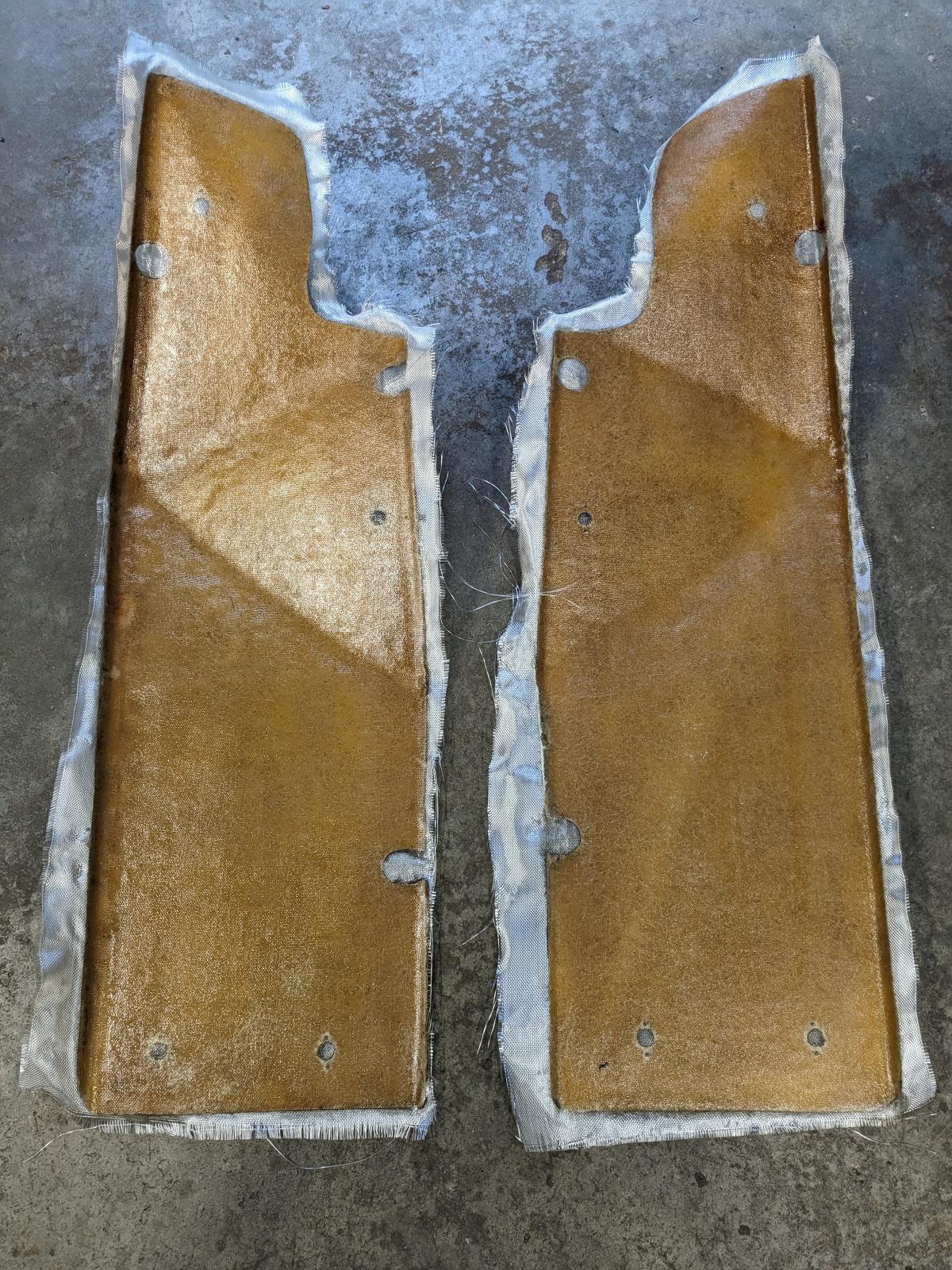

Before I started on the business side of the fiberglass panels, I cleaned, scuffed and laminated the backs of the somewhat thin panels to add rigidity and fix some minor structural issues, as well as reinforce the DZUS areas where some had some edge fraying/damage.

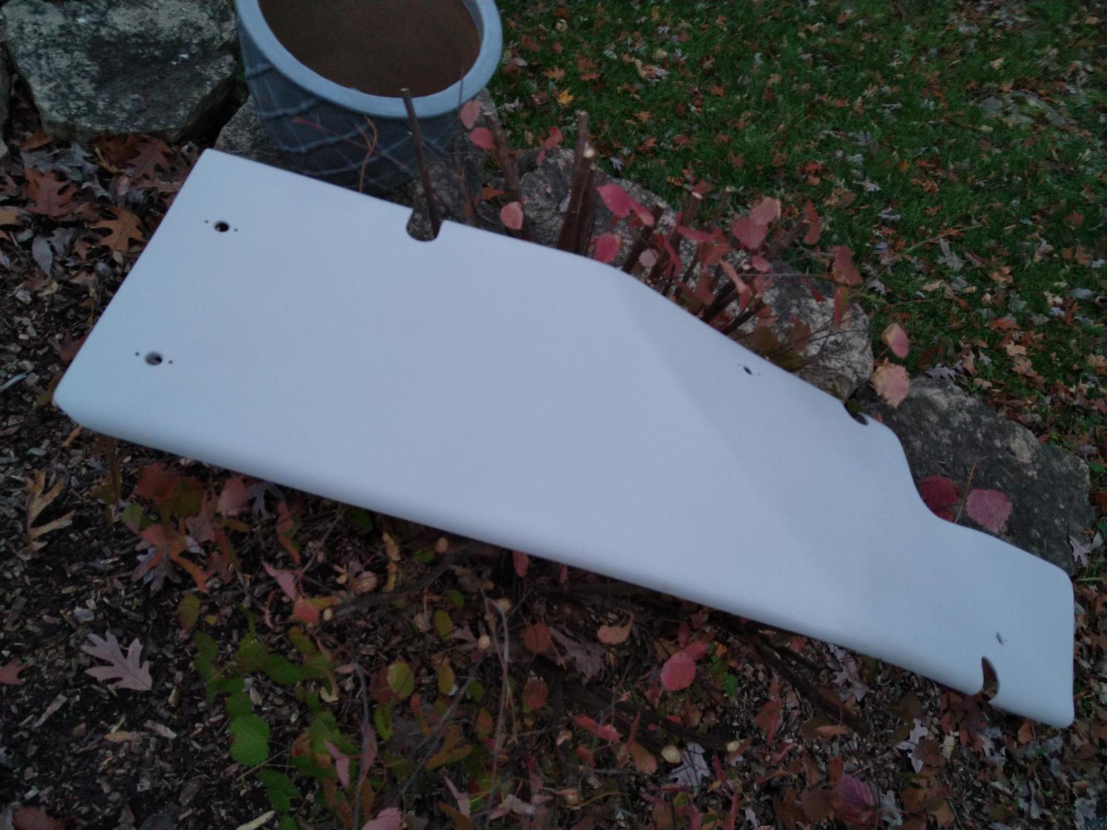

I decided to get a mini DA and a big 6" DA and start flattening out the panels and sanding through the everlasting gobstopper of paint to the gelcoat base. I found to use the big DA anywhere I can, to blend the smaller areas I had to use the 2" DA on into the flat surfaces. Then, block sanding at an angle with the biggest flexy sanding plate I could fit everywhere to bring out bodylines and square up all the surfaces. Then last, roll over the edges with a flexy sanding block to blend the curved panel edges in. I laid this SprayMax 2k Epoxy Primer thick enough that I think I can block it with something fine before paint. My finish was 120 grit on the gelcoat before the epoxy primer and it filled well. I just have some surfacing to do on the epoxy before real paint goes on.
With the blocking I did it really brought out some harder body lines which I really like. I'm a new school kid so I like sharp edges and abrupt features more than I like flowy roundy shapes.
