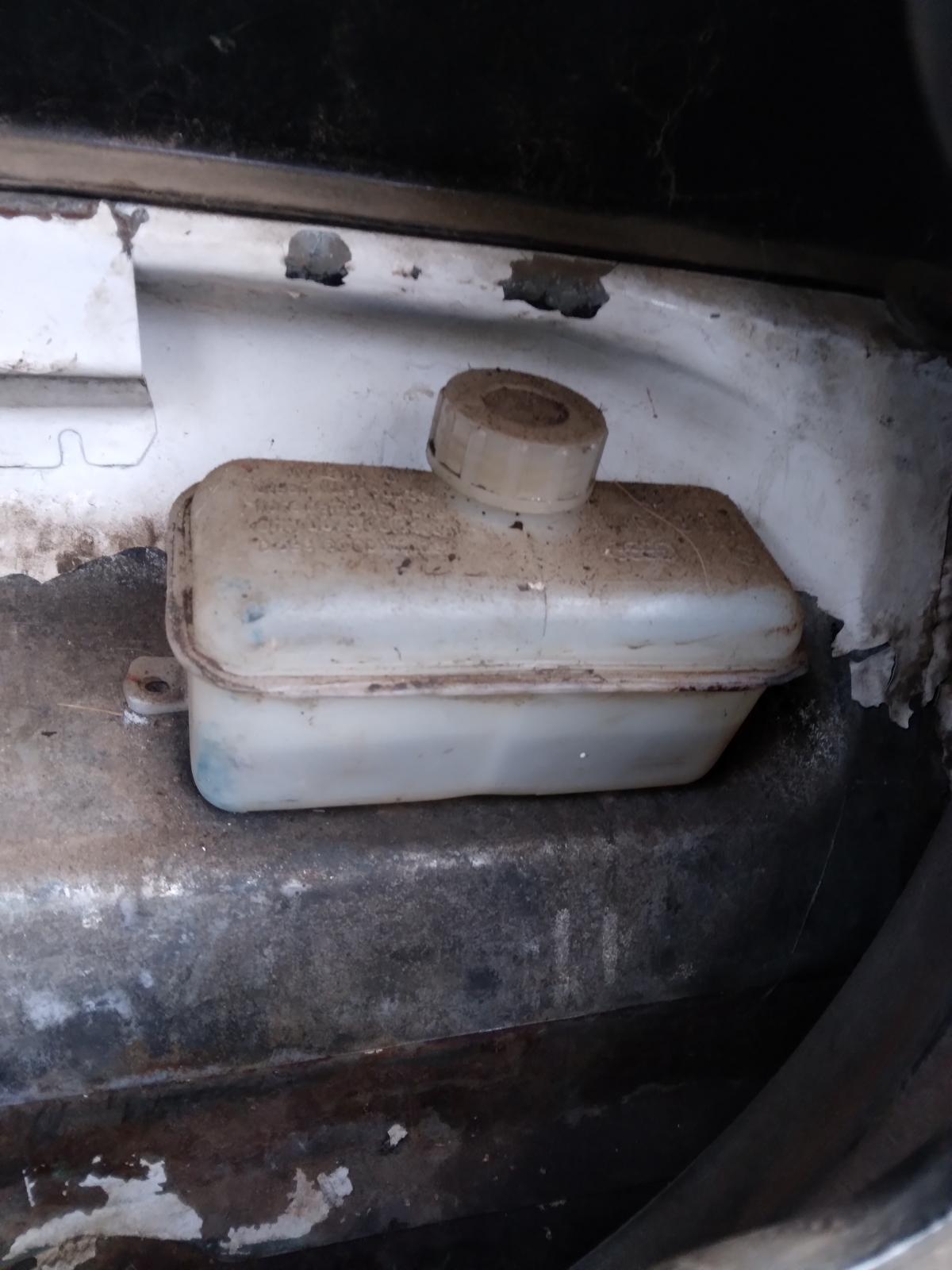

Your picture shows brake fluid in reservoir pretty low, would guess there's a hydraulic leak somewhere.

Yes my fluid is dark and low, which is unusual. 2 months before the accident I installed the fresh gears, and new rear wheel cylinders, disassembled cleanedand re assembled both front wheel cylinders, and flushed out the fluid. Hard to believe its already dark like that.
