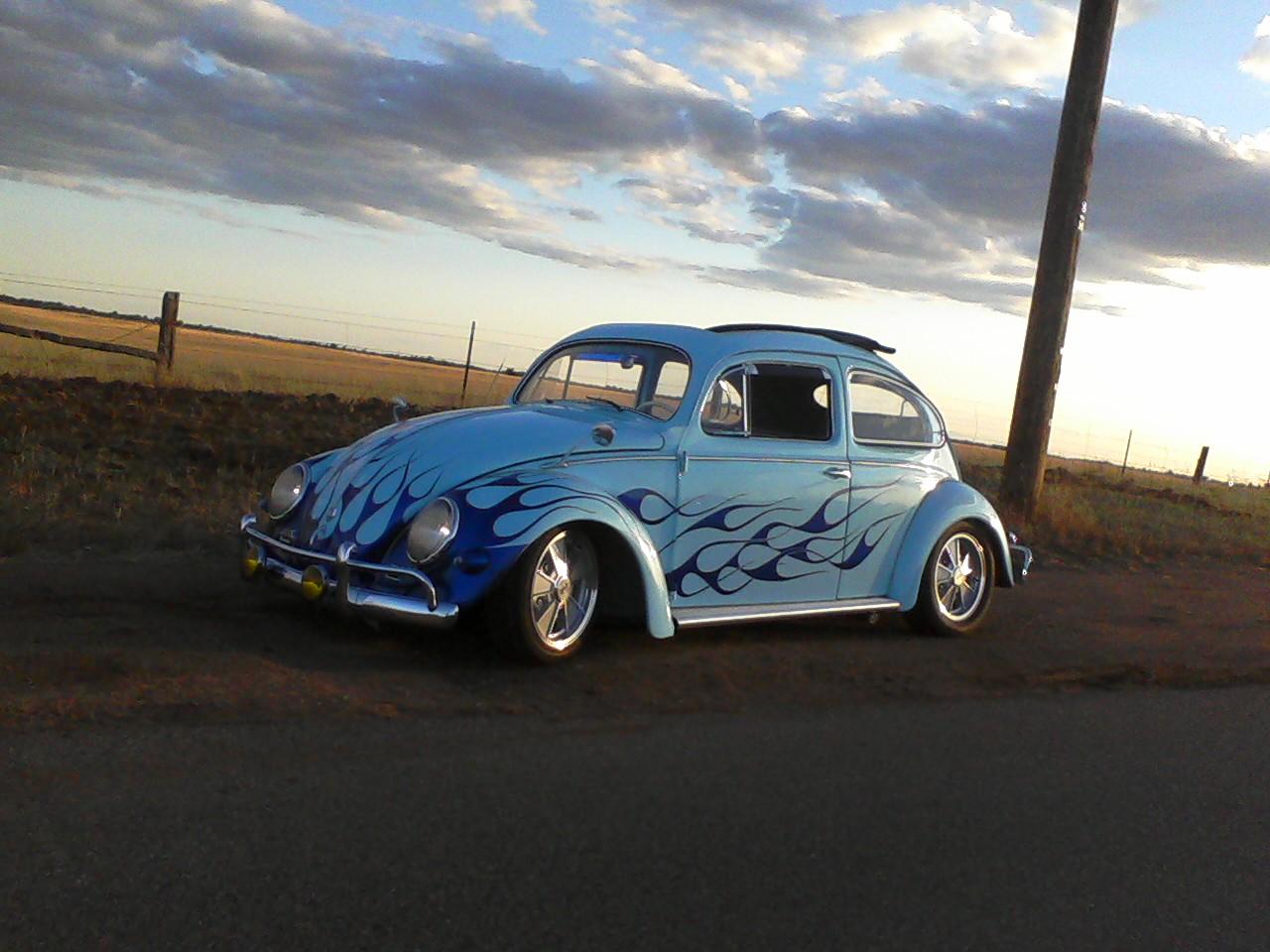

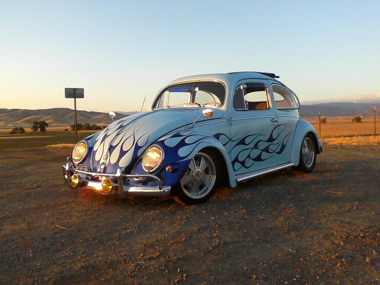

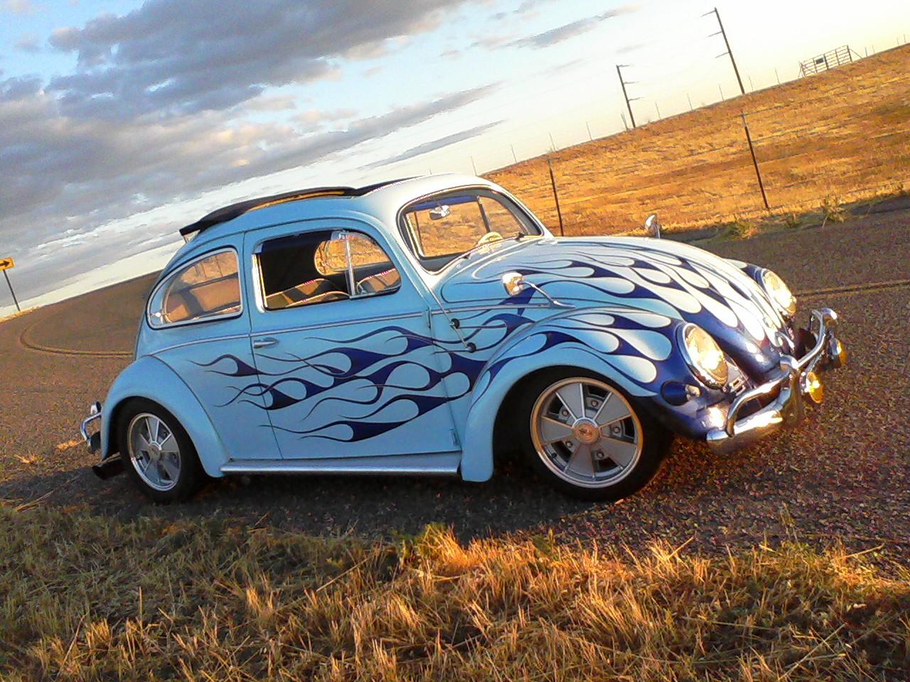

My Oval with Sprintstars and a narrow beam. Front fenders are stock width just have a big lip on the inside for aerodynamics.
Are you running disk brakes? Why do you need a narrowed beam with stock width wheels? I've lowered lots of cars 4-5" and run stock beams and wider tires that what you plan on.

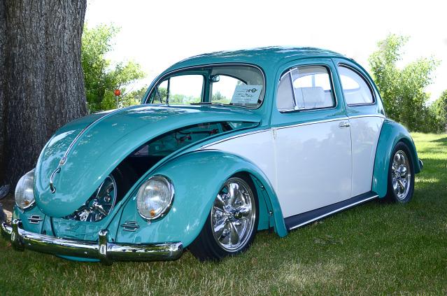

Mine has a 3" beam. https://www.thesamba.com/vw/gallery/pix/944594.jpg

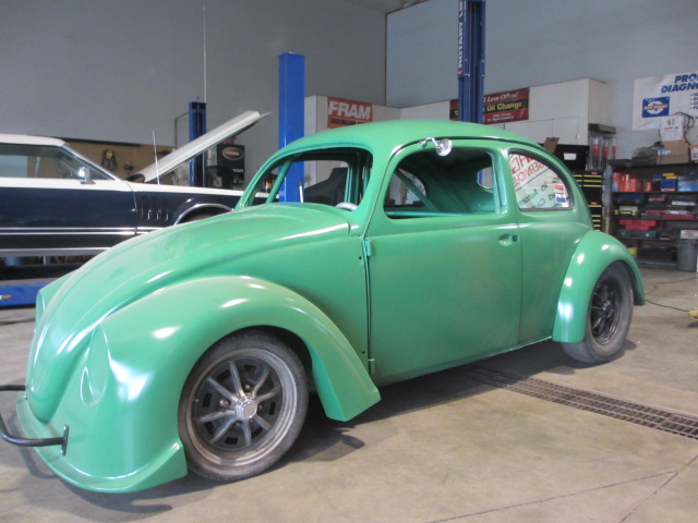

5" beam 17x7 front
rear 19x7

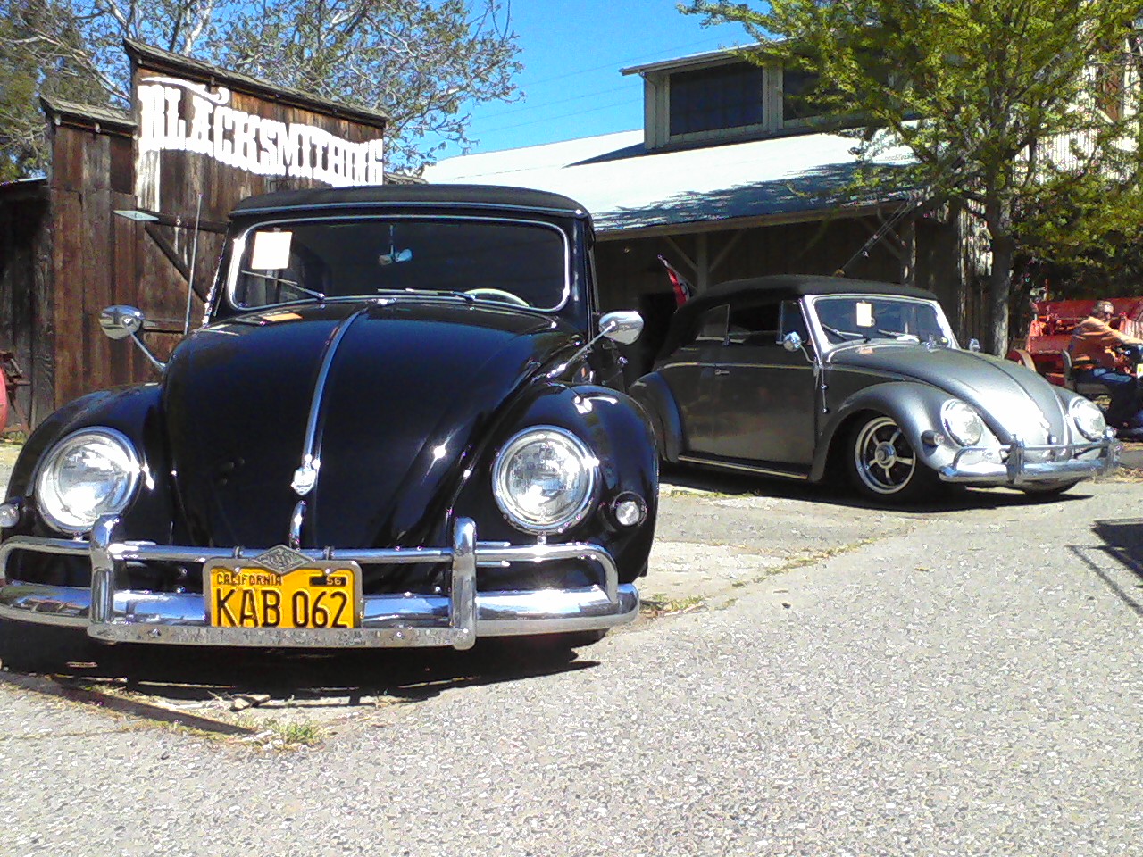

I'm running a 3 inch beam with offset shock towers on "Spanky 56" ragtop with BRM's and 145/65 continentals (smart car ) & 185/65 rear tires here..
I do have/ am running the "zero offset" disc brake kit from AC industries at all fours on the car and not drums.....
But it should look about the same ...
I like 'em "tucked' , But not looking and handling like a tricycle ... Laughing
3 to 4 inch beam is all "Most" would ever need to use without looking goofy and get a good "tuck" IMO ... Wink
Here's "Nunzio 57" with a four inch beam and sprints running 155 / 60 continentals in front and 165/80 in the rear on drum brakes ...
With the four inch , You can definitely tell I am slightly more "tucked" on the vert than the oval ...
In the end it's just a matter of preference ... the 3 and four inch beams handle about the same ... the offset is actually a little less on sprints (more tuck) than on Brms by about 1/4 or 3/8 IIRC ...
