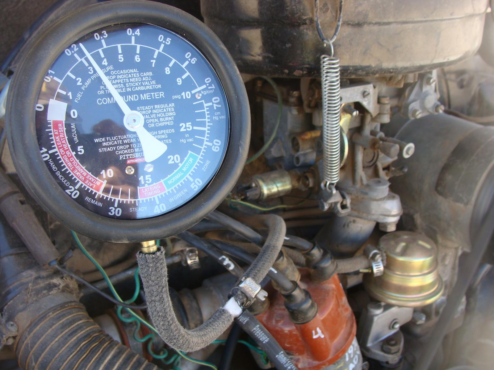

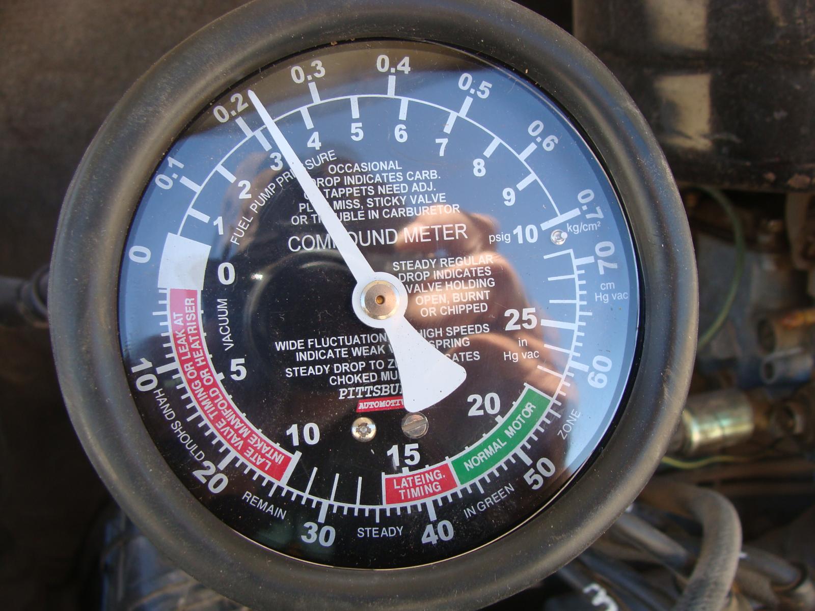

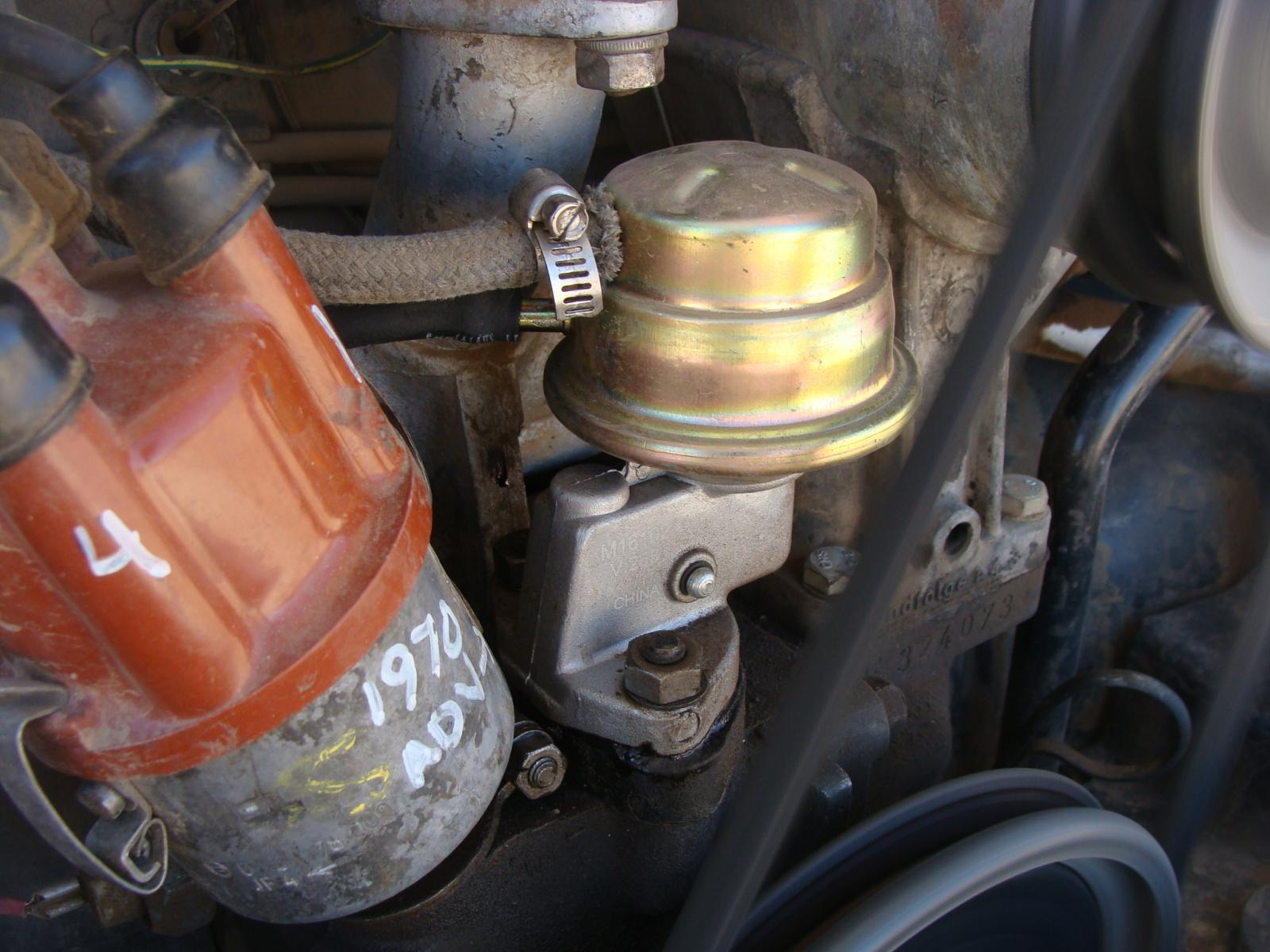

In 2018 I installed Import Direct fuel pump #M16102 from O'Reilly into my 1970 Beetle, and it measured 3.2 psi.
I now notice that this same part number is no longer listed though.
No clamp on fuel pump outlet, to route in the pressure tester.

Cusser: thanks for your fuel-measuring photos. How do you obtain a reading if the fuel inlet port on the pump is not connected? Using the standard gasket for the top of the stand, do you have any guess as to how one gasket affects the psi change?
