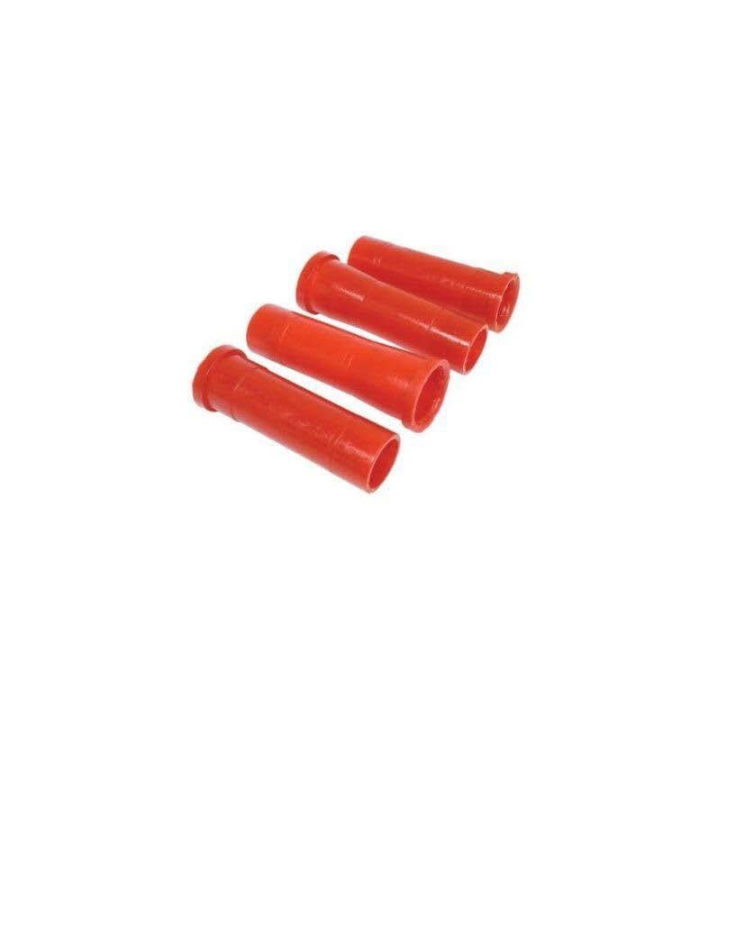

Hey Guys, I have a 1960 ragtop that had a new 4” narrowed beam when I bought it. The car was partially assembled and it seems rather poorly. I ended up getting new narrowed torsion springs but originally reused the poly bushings. The more I research it seems I may need to do more. The beam does not have any zirk fittings as of now.
I have a few questions…
There are no stops internal to the beam, can I use needle bearings instead of the poly bushing/sleeve?
Does it matter where I install zirk fittings on either end? Can they 8-10” in to clear the bushing/sleeve?
I’d rather do it right this time around before I get too far into it.

The zirk needs to be between the inner and outer bushing. Usually bearings will not fit the tube used to make narrowed beams, which is why I prefer to use a German beam to start with, though it is much more work.

My beam was completely hollow/empty with the exception of the piece in the middle that retains the torsion springs and allows you to raise or lower the front end. This is what i have that slides into the beam and then the torsion arms slide into these.
