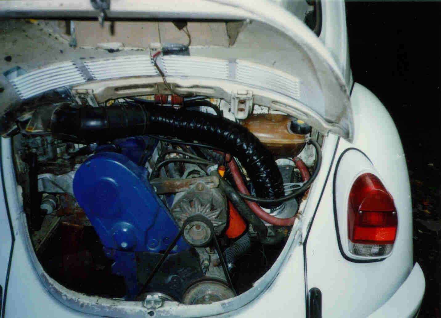

I did a V8 swap into a 1975 914 about 20 yrs ago. Several of the companies selling swap kits for 914/V8 conversions were using rubber hose. The reccomended hose was Gates green stripe. I couldn't find the specific hose so I sourced some hose from McMaster-Carr which was described as for Boat wet exhaust systems. It is very stiff and rugged yet bends to a fairly tight radius. It is wire wound as well. I used 1 1/4"ID both for the 914 conversion, which was strictly for autocross use, and also for a street driven VW Beetle conversion. The 914 hose was on the 914 for 10 years. No issues. It comes in different sizes too.
A Link:
https://www.mcmaster.com/products/coolant-hose/flexible-coolant-hose-6/
The 914/V8
The H2oBug
Hope this helps.
Mike T
