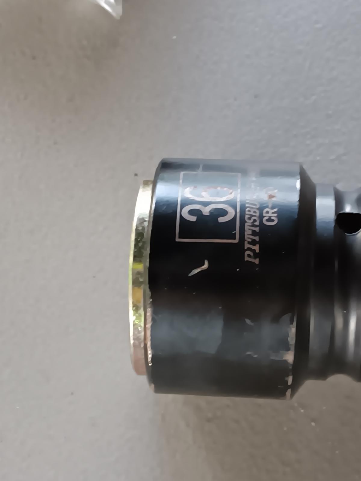

Finally had a chance to upload pictures of the installed wheel nut which seems larger than 36mm and a new nut that fits the 36mm socket perfectly.
Removed the rear drums today and imagine my surprise when I found a spring washer installed between the axle nut and the drum on the driver's side rear but nothing on the passenger's side. Referenced the shop manual and it makes no mention of a spring washer. Threads look good on the rear axle... Any thoughts?

Who knows why a previous owner added this lock washer, but I'd check both the threads on the axle and the threads on the nut that you removed. You may find that it is the nut that has damaged threads, and the previous owner tried to use the lock washer to move the nut out enough to grab a few undamaged threads on the nut.
I had to replace one of my rear axle nuts a few years ago because the threads became damaged (I'm guessing because it worked its way loose, but I don't know how it could with the cotter pin in place). Thankfully the threads on the axle were fine so I was able to torque the new nut without any issues.

Finally got to the point of putting the drums back on and tightening the rear axle nuts. The nut appeared to thread all the way down, but at that point it was so far down the axle that the cotter key wasn't inside the castles on the nut. Using the washer fixed that issue.
