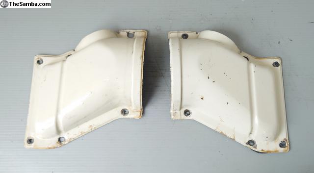

I removed my air ducts from the front of my 1972 Bus, doesn't look like the seals are made for this anymore. So what are you guys using as a replacement?

They are the metal halves on the intake box. They attach to the front of the bus that goes to the doors some people cap them and some run the door ducts to the back of the bus. These are the ones in front of the door and the air tubes also attach to the them on the top.

PostPosted: Fri Nov 01, 2024 4:12 pm    Post subject: Re: Air Duct Seals? Reply with quote
These?: https://www.thesamba.com/vw/classifieds/detail.php?id=2711409

foil is offline
PostPosted: Thu Jun 19, 2025 1:30 am    Post subject: Re: Air Duct Seals? Reply with quote
yes, Busdaddy those are the ones. I tried to buy some marine seals from lowes but that didn't work too well.[/quote]

PostPosted: Thu Jun 19, 2025 7:19 am    Post subject: Re: Air Duct Seals? Reply with quote
make your own from a thin sheet of foam or buy used ones from someone like TheBusco.

PostPosted: Thu Jun 19, 2025 7:29 am    Post subject: Re: Air Duct Seals? Reply with quote
The seals are just thin strips of foam, exactly like common door/window seals sold at any hardware store. You just cut into pieces to fit and stick 'em on.
