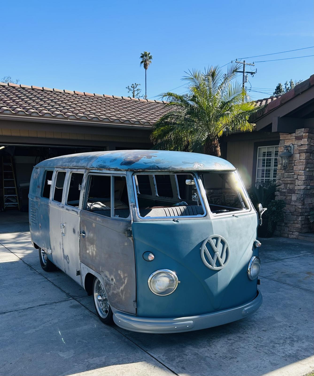

So we installed an Airkewld straight axles tranasaxle and and lowered spindles along with their disc brake conversion.
Pete suggested 185/60-15 tires. The customer said when he has 3 passengers in it the front tires rub at times and when making turns.
Any suggestion on smaller tires?
185/55-15?
175/55-15?
What are you guys using front and rear?
Glenn

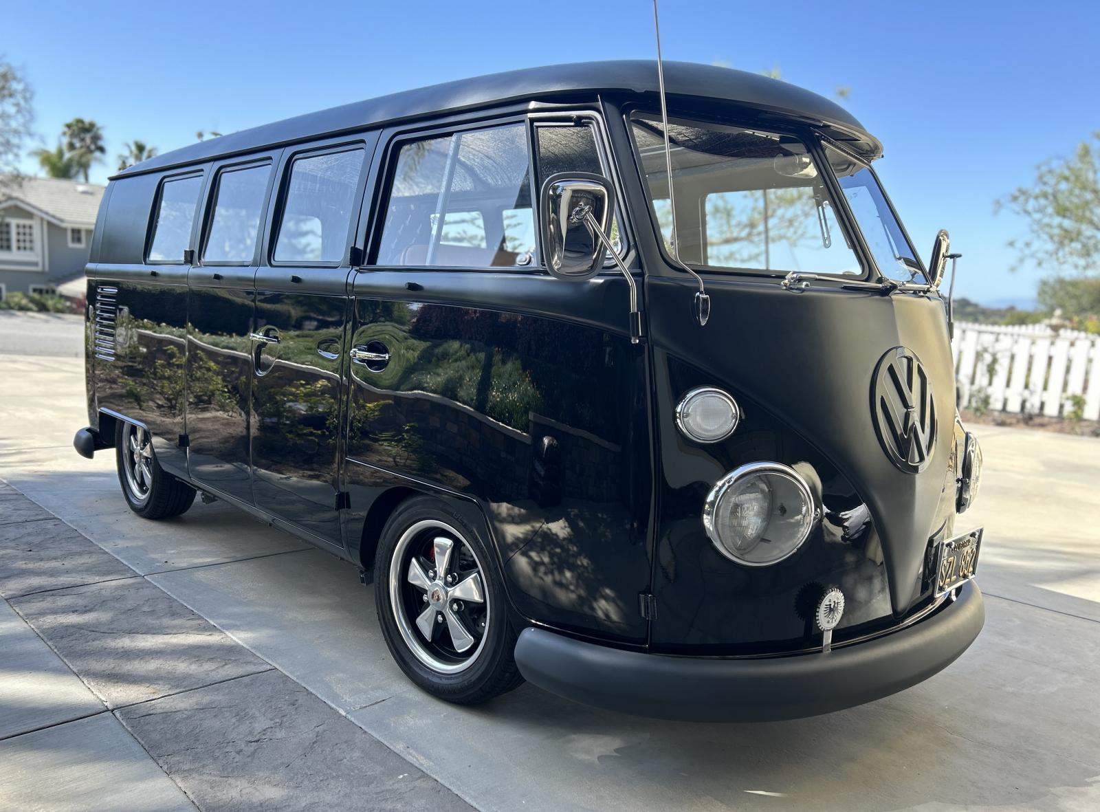

I have the very same straight axle, flipped spindles kit from Airkewld on a stock front beam. While I haven't tried three passengers in front, no rubbing with two front passengers.
Front - 185/60-15
Rear - 205/60-15
Sits level with no +/- rake.

Looks perfect! Fantastic job!
