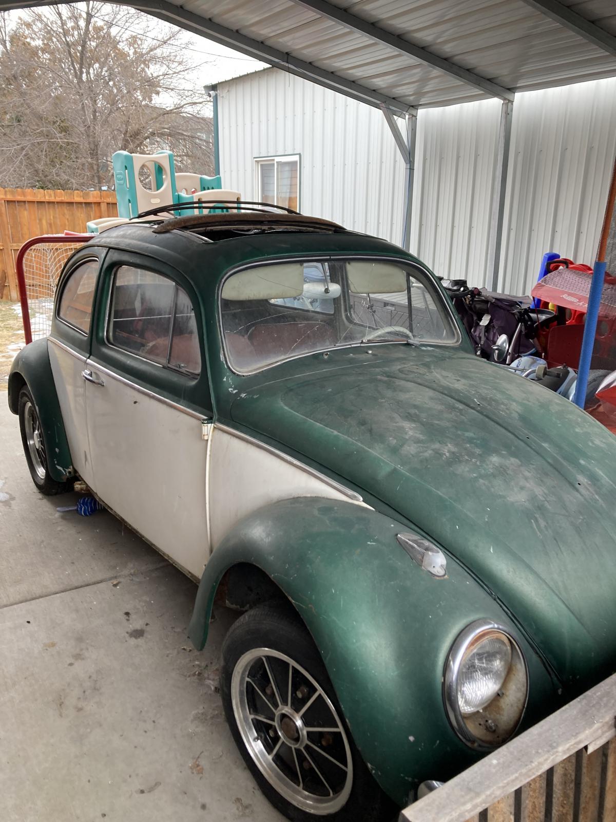

Yo. Figured I'd debut my project here for everyone to laugh at. 63' Ragtop that's been local to my little town here for many decades, sat under a tarp last licensed in 88'. It's just a car that had been known to myself and a few people forever, not exactly even hidden- but just 'not for sale' until a guy I know went and bothered them again last summer.
So guy I know takes it home and it's basically a flip for him, he doesn't even touch it. Since it was local and easy to get and not a *terrible* deal, I drag it home about 3 weeks ago.
First things first I have to get a good look at everything and get it running?
Engine was *stuck*, ...not seized luckily. ATF in the cylinders for a couple days and it loosened up fine.
Odd thing I found that the oil and spark plugs were quite literally brand new. Plug wires were all backwards, maybe that's one reason they parked it?
Swapped a carb onto it and it, sorted some wiring, put a 6 volt starter I had in and fired right up. Engine has no endplay and sounds ok actually.
Took it up around the corner and went through the gears too, trans shifted and stayed in all gears!

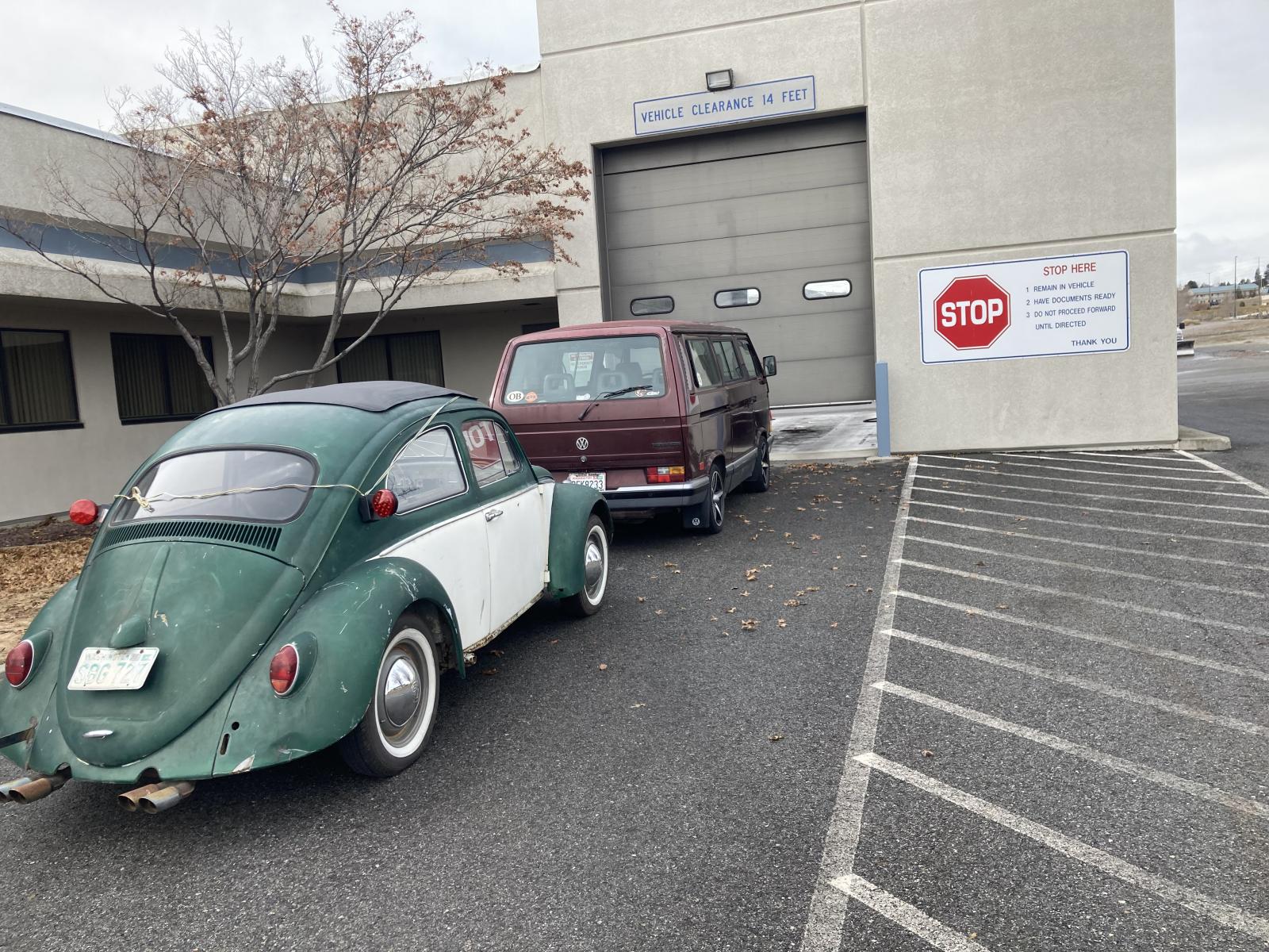

Once I understood how big a mess it was I decided to try and deal with the title, so dragged it out to the State Patrol, got an inspection and hit a wall. Inspector lady was a total wackjob. She screwed up the 'ownership in doubt' and decided it was now an 'abandoned vehicle'.
Dammit. If she's gonna be difficult I'll just make my own title. So, filled out the Vermont Paperwork and sent it off. They cashed my check today, so I think I'm all set for a title. Very Happy

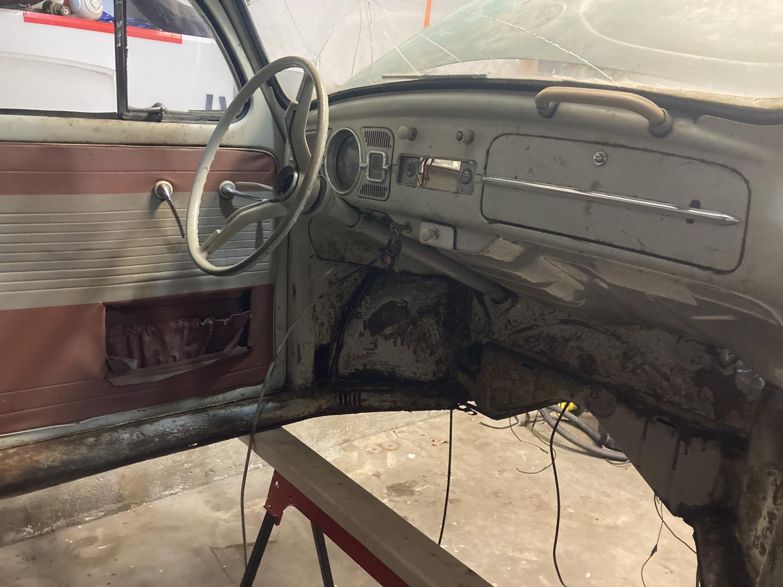

Not as bad as half the cars people resurrect, it's salvageable. 10 Years ago this car would've been a clip. 5 years ago it's a toss up. But these days we have to save what we can.
Plan is to hopefully get the pan *restored* by the end of summer and work on the body next winter.

It's really not a horrible car. Gonna need all the obvious and usual. Heater channels, front bulkhead, a couple inches in one rear 1/4 panel.

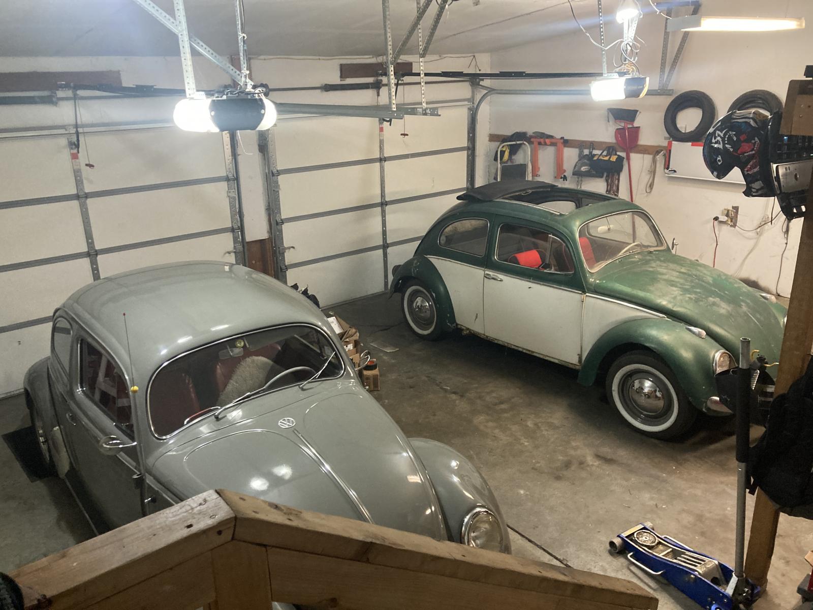

Oh, here's the other car from the garage since someone's going to ask.
54' that I got locally here 3 years ago. It was a good start, but basically a complete painted shell when I got it. Now it's a driver. Salvaged all the original materials and parts I could.

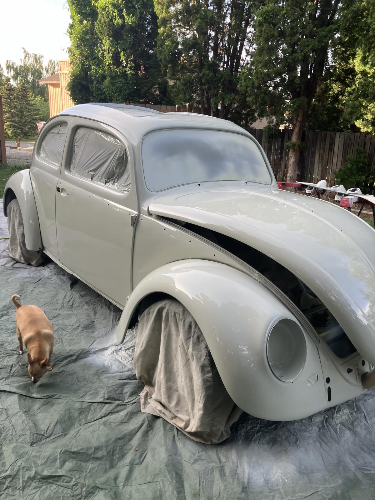

Haven't updated this in a while...but been working away as much as I can.
Won't bore you with a narrative of every hassle..but it's getting there.
Short story:
First car I've ever done myself from the ground up..I mean, sort of. I sort of did a 60' 356 25 years ago when I was a kid. Now that I think about it, that counts I guess.
But on this thing I had to cut most of the bottom 4" off to replace.
YOu get the idea of how I want to finish it I guess. I have a few cool accessories- Pull out Blaupunkt, Motest triple gauge, Kamei parcel tray, HULs recliner for driver seat, Tilt-a seat of passenger. Oddball but proper 60's steering wheel....old empi chrome tail lights housings, LED replacements everywhere I could manage
Engine is a 'whatever' I scrounged 1680cc w/ big valve heads, Andrig fan.
I'm not trying to fool anyone, I did some fairly dodgy repairs on this thing, it was a bit worse than I hoped and I'm not great with body work, but I did manage to keep the filler to a bare minimum.
I painted it out in the backyard..though it's not bad.I did start to get in a bit of a rush though and should have took a break during primer and sanded and re-primed once or twice for best results.
I didn't, and..I suppose it shows in a few spots. I think it is fine overall though- most of the parts on this car are what I could scrounge and salvage, and they're refinsihed with paint I can get at the store easily- for future touch ups.

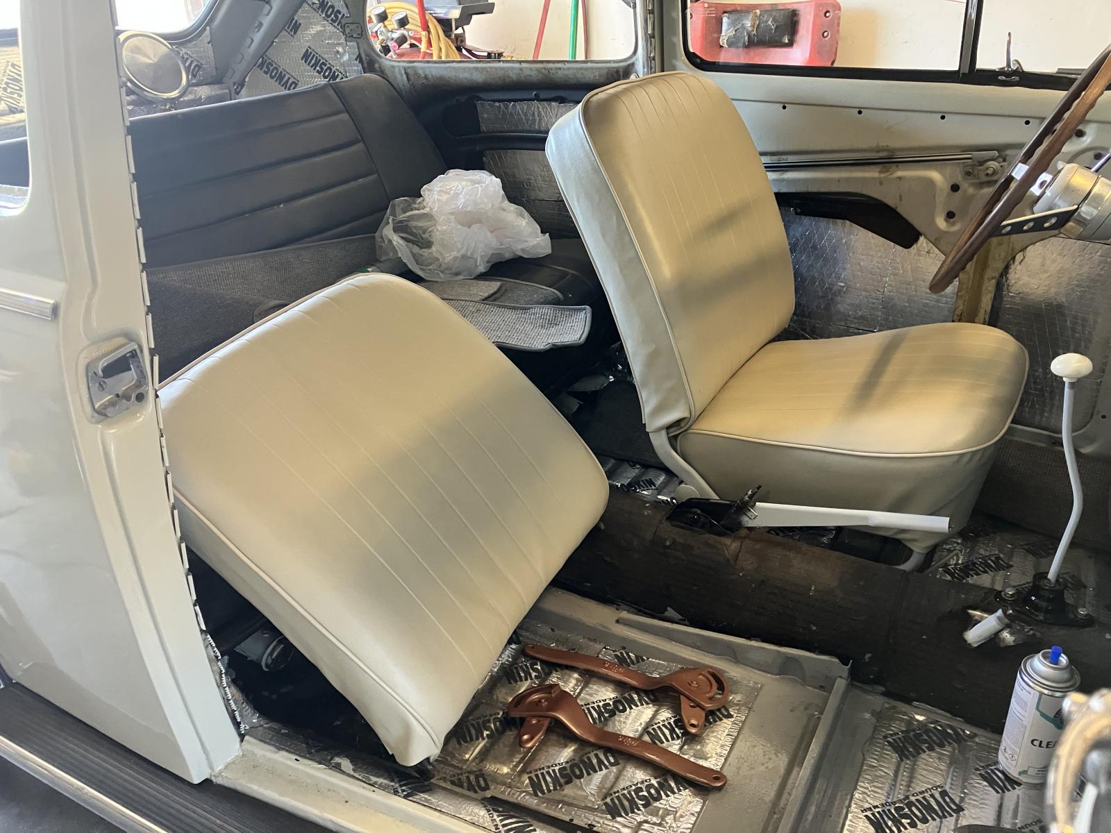

LIttle more progress yesterday...
HULs !
Cool steering wheel...I wonder if its off a boat or something
tilt-a -seat

As much as a like Java green "'63s are supposed to be pearl white".
It would be cool if you could save the original door panels.
I do have the original door panels- they're red/ grey of course. But they're fairly hammered. The way I scrounged for deals I was able to put together a whole TMI interior kit for around $800, and it all matches pretty well.
I planned to salvaging the door panels, but couldn't pass up $200 for brand new TMI panels.
