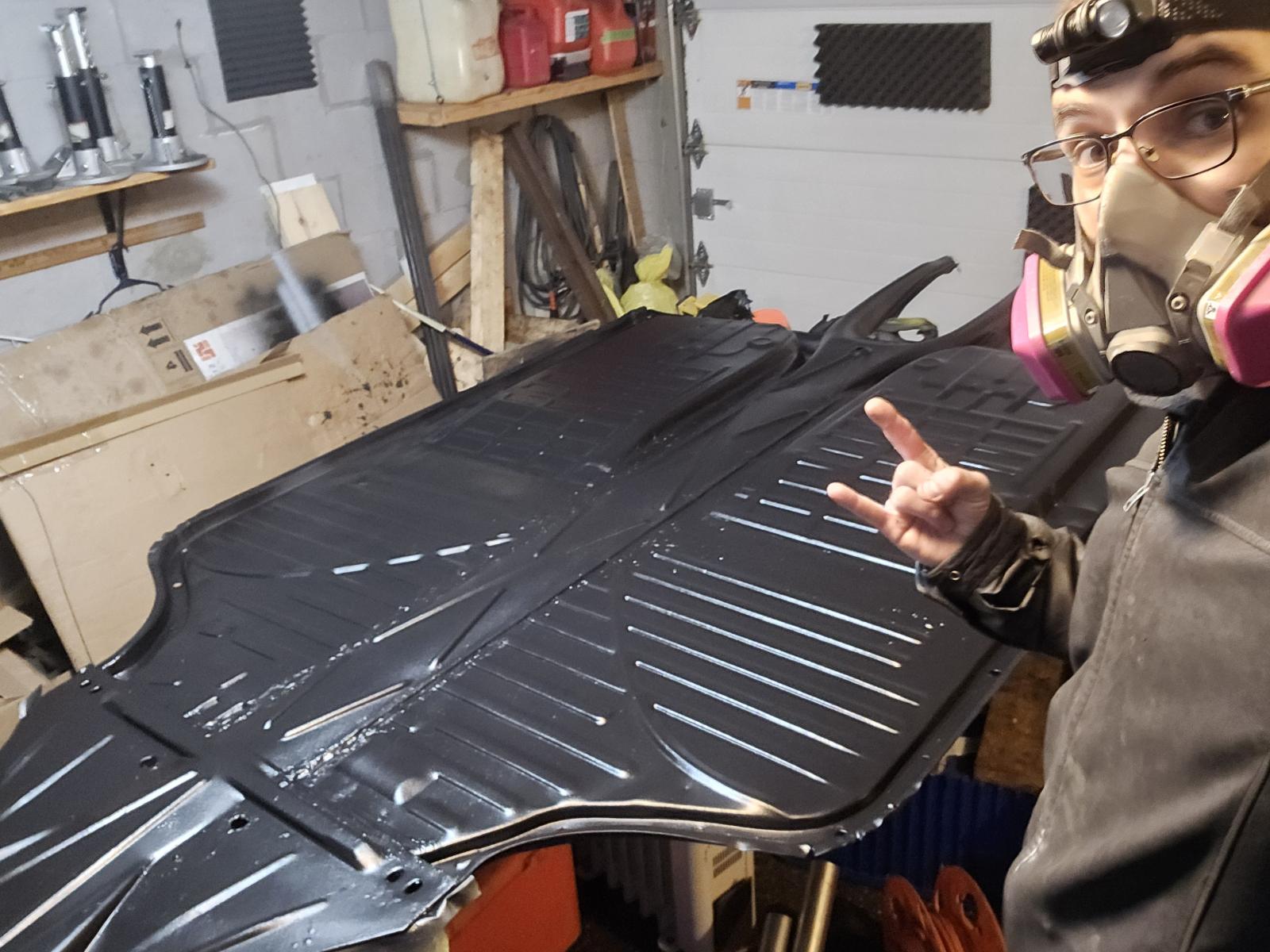

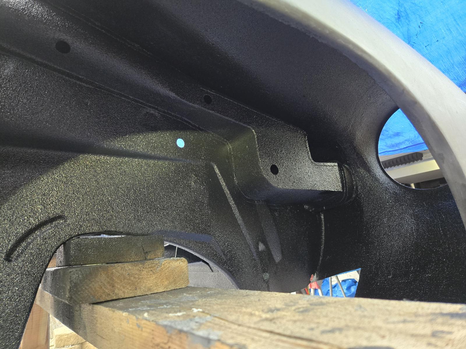

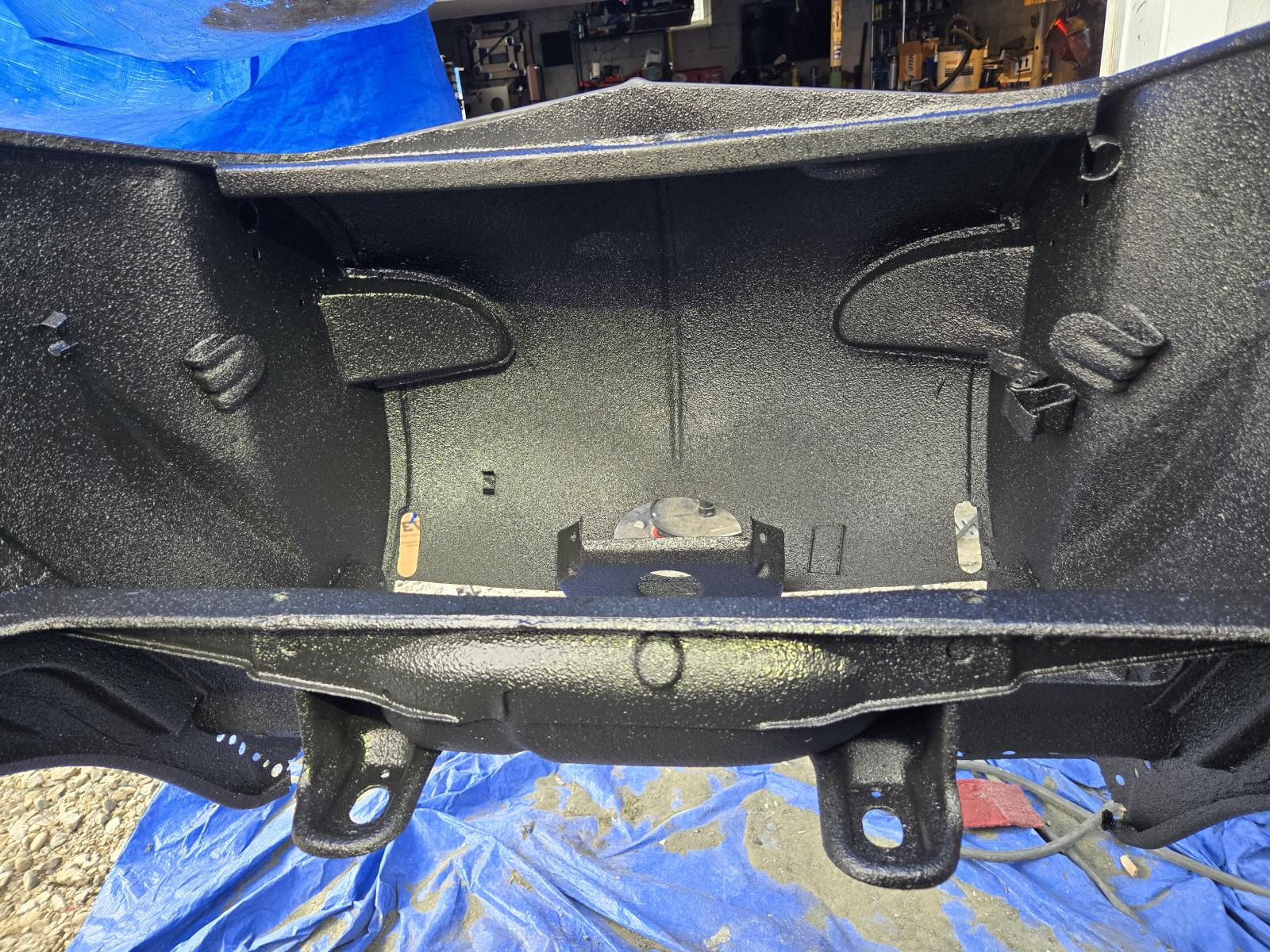

The chassis and floor pans are topcoated top and bottom with Upol Raptor UP0820V. For this I used a cheapy HF HVLP with the tip drilled out to the exact size of "bigger than it was", the paint gun and higher air pressure gets you a smoother texture like epoxy primer. Also when going for a smooth texture I cut it down with 20% Eastwood Universal Urethane Reducer. For the trunk area and fender wells I used a Schutz gun to get the desired classic lumpy texture. This should help with road noise (called NVH in the auto industry these days) and it's tough as hell. It also helped to hide any fugly bumpy areas I couldn't get out during prep work, this is kinda the beauty of using the Schutz gun.
Depending which area, either Upol DTM Epoxy or Eastwood DTM Epoxy Primer /Sealer was used on the bare metal. Then the Raptor 2k as topcoat.
The nose section. The Schutz gun was used here...very satisfying to spray. A word of caution: This stuff gets gummy and tough QUICKLY. Overspray really sucks, somehow by the end of it I always have black specks for the next few weeks on my glasses, my tools, my dog, etc.
The chassis. Many different 2k products used here, but for the pans and tunnel it was Upol Epoxy base and the Raptor Liner topcoat with an HVLP gun. I didn't want the heavy texture here, just the toughness of the urethane bedliner. I'm relying on interior sound deadening mat to help with road noise under the chassis...
