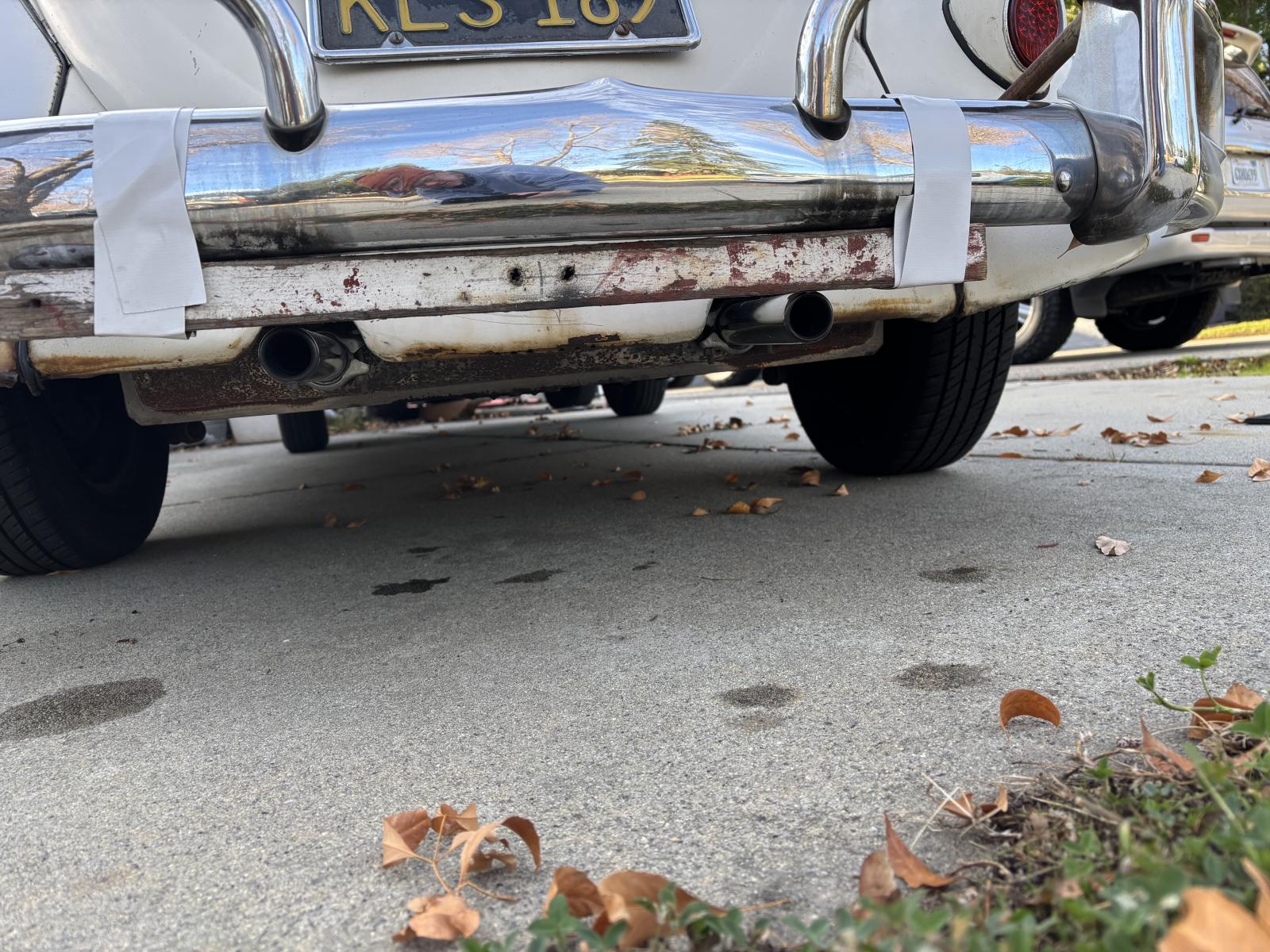

PS If the mount is on its way out, get on it soon and fix, cause when the mount finally totally tears, the Bug will be near undrivable. This cause the motor / tranny will pivot on the bell house mounts, the motor going up and down with acceleration or slowing, and when the motor moves, it moves relative to the throttle cable, so you end up with the engine surging, then going to idle causing the car to buck like a bronco, making driving "interesting" Give it a little gas and she will surge in rpm.
Happened a while ago to a friend of mine, as a temporary fix until he could get the new mount we did this to make it drivable...
the board (a 2x2) was wedged between the bumper and tail pipes, this pushed the tail pipes down about as far as they can go, the nose cone lifted up, this prevented the engine from rocking while driving, the tape around the bumper and wood helped hold the assembly in place. He ran like this for a week or so, the throttle cable had to be adjusted to compensate for the engine down configuration, but at least it was held in place with out the motor shifting up and down as he drove.
So when that mount totally tears away, you will need to rig something up to hold the engine in place until the mount is replaced.
Ha, I love it. That rig job looks just like something I'd do. I like how these VW's can be cobbled to limp along for a time and generally end up unscathed when fixed properly. When I got this VW, the front mount was totally broken in two, but the car was ruined in every other way as well, so I never got to experience driving it with a broken mount.
Anyway, I went ahead and replaced the front trans mount this afternoon. I actually had a new mount sitting ready to go in for over 2 years and have taken the engine out twice in that time. I have no good excuse as to why I didn't do it either of those times. I was able to replace the mount with the engine still in by taking off the rear tin, removing the trans cradle bolts, holding up the engine/trans with a floor jack and using a combination of ratchet straps and prying to move it back enough to get the mount out and in. It was a bit awkward but not too bad. Took a couple hours. The old mount looked like it had a small tear starting on the driver's side. My nosecone stud holes are a bit wallowed out because some idiot (me) drove it with the nuts loose for a while several years ago.
The shifter doesn't move when I let out the clutch anymore and the car is less jerky when shifting and starting off. It also generally feels more solid over bumps and rough patches. The vibration is much less noticeable, probably about 25% of what it was. I can live with that.
