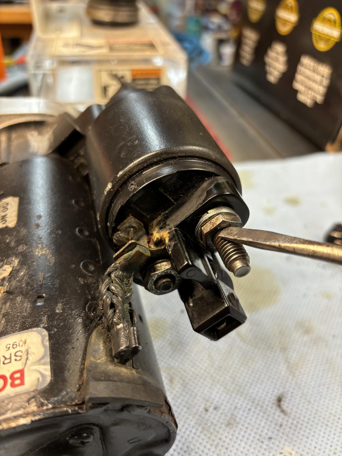

jlrftype7
Joined: July 24, 2018
Posts: 4764
Location: Chicago
jlrftype7 is offline
PostPosted: Thu Jun 26, 2025 5:34 am    Post subject: Re: Starter for 1.9L: 2.2L starter or TDI Reply with quote
syncrodoka wrote:
You need this type of single pin weatherproof connector.
https://vancafe.com/high-torque-starter-plug-harness/
Yep, cause your starter solenoid will now look like THIS one below if you go with the TDI starter or similar unit that doesn't use the old stock open terminals for the solenoid.

?Waldo?
Joined: February 22, 2006
Posts: 10125
Location: Where?
?Waldo? is offline
PostPosted: Thu Jun 26, 2025 5:58 am    Post subject: Re: Starter for 1.9L: 2.2L starter or TDI Reply with quote
'Need' might be overstating it. The stock spade connector will fit without issue. The weatherproof connector is a nice upgrade that helps prevent corrosion.
syncrodoka
Joined: December 27, 2005
Posts: 12408
Location: Santa Cruz, CA
syncrodoka is offline
PostPosted: Thu Jun 26, 2025 11:56 am    Post subject: Re: Starter for 1.9L: 2.2L starter or TDI Reply with quote
The male spade connector on the stock starter is exposed while the tdi or shorter gas version is recessed so seating it fully is harder to see and manipulate. Because of this I have heard of of the stock female connector coming loose and leaving someone stranded.
The correct connector for the starter isn't expensive and there are advantages of using the correct part.
?Waldo?
Posts: 10125
Location: Where?
?Waldo? is offline
PostPosted: Thu Jun 26, 2025 12:49 pm    Post subject: Re: Starter for 1.9L: 2.2L starter or TDI Reply with quote
I think the connector that matches the starter is a great idea. I'd recommend using it. It is not strictly necessary, though, is all I'm saying.
I have a van in my driveway that has had the stock Vanagon spade connector plugged into the TDI starter for the last 12 years without issue and has been one of two primary vehicles for myself and my wife for that entire time. I have had a spare 'correct' connector sitting on a shelf in my garage along with a spare starter for almost as long. I would have used that connector when I initially installed the TDI starter, but didn't have it on hand at the time. Since then, I've always had higher priorities than installing that connector when it has worked perfectly fine as is.

For a WBXer engine of near standard displacement and compression, I think the main advantage of a SR0425N starter over a stock 2.1L is that the SR0425N is factory new versus a rebuild. The rebuilt 2.1L starter on my 83 1/2 is now something like 15 years old and has never given a moment's problem except for a single relubing of the solenoid plunger.
FWIW, I drive through the basin and range several times a year and look for starters, alternators, and such that have the best availability and have not found any Vanagon starter that is available outside or Reno and Las Vegas.
