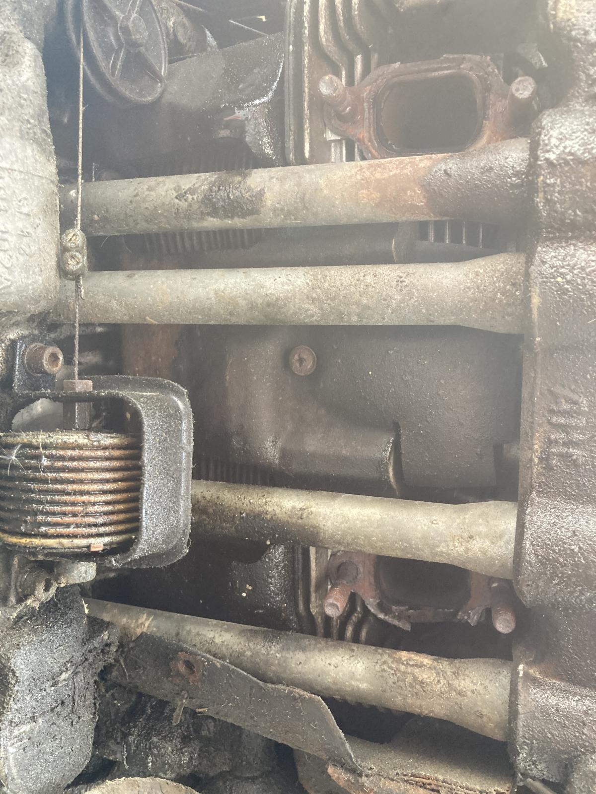

As a note, the left side exhaust pipes have subsequently been fixed and have a new exhaust connector block thingy, and the exhaust connector on the right has a new gasket, so looking better than these older pics.
1978 Beetle, 1978 T2 Panel Van

be aware. there are flaps that hang on rods that go through those holes. the flaps keep the hot air flowing one way.

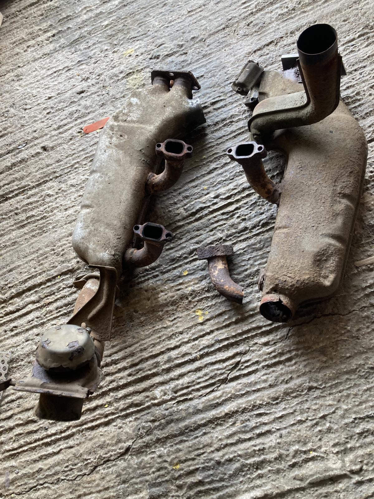

It technically could have been a 20-30 minute job with the back needing jacked, the push rod covers being unscrewed, the heat exchanger cables being unpinned, unbolting the exhaust, and the 8 boots holding the heat exchangers in being taken out. However it took 4 hours as half the tin push rod cover screws sticking. However the 2 exchangers are off. Here is the underneath. Do you reckon they are regular/stock 1978 connections?
Here are the two heat exchangers, both in poor/very poor shape
SGKent Premium Member
Joined: October 30, 2007
Posts: 42384
Location: at the beach
SGKent is offline
PostPosted: Thu Jul 17, 2025 3:59 pm    Post subject: Re: A missing exhaust piece Reply with quote
1979 or later square port
