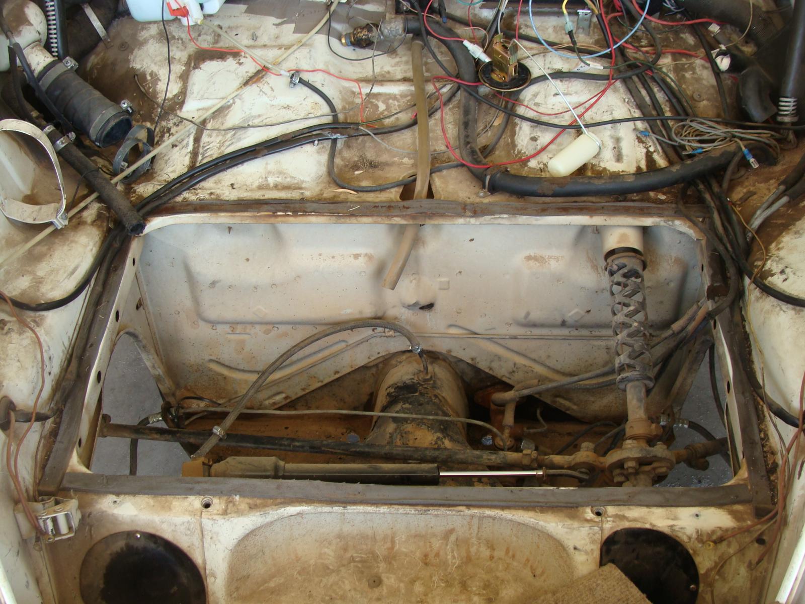

lboos wrote:
Cusser,
When you replaced your tank, how much slack did you leave in the fuel hose to make a loop ?
I'd guess that I used at least a foot more of fuel line than a "straight shot" would've been, I intentionally wanted to avoid any possible kinking. This is the only picture I have, from my 1970 sedan.
