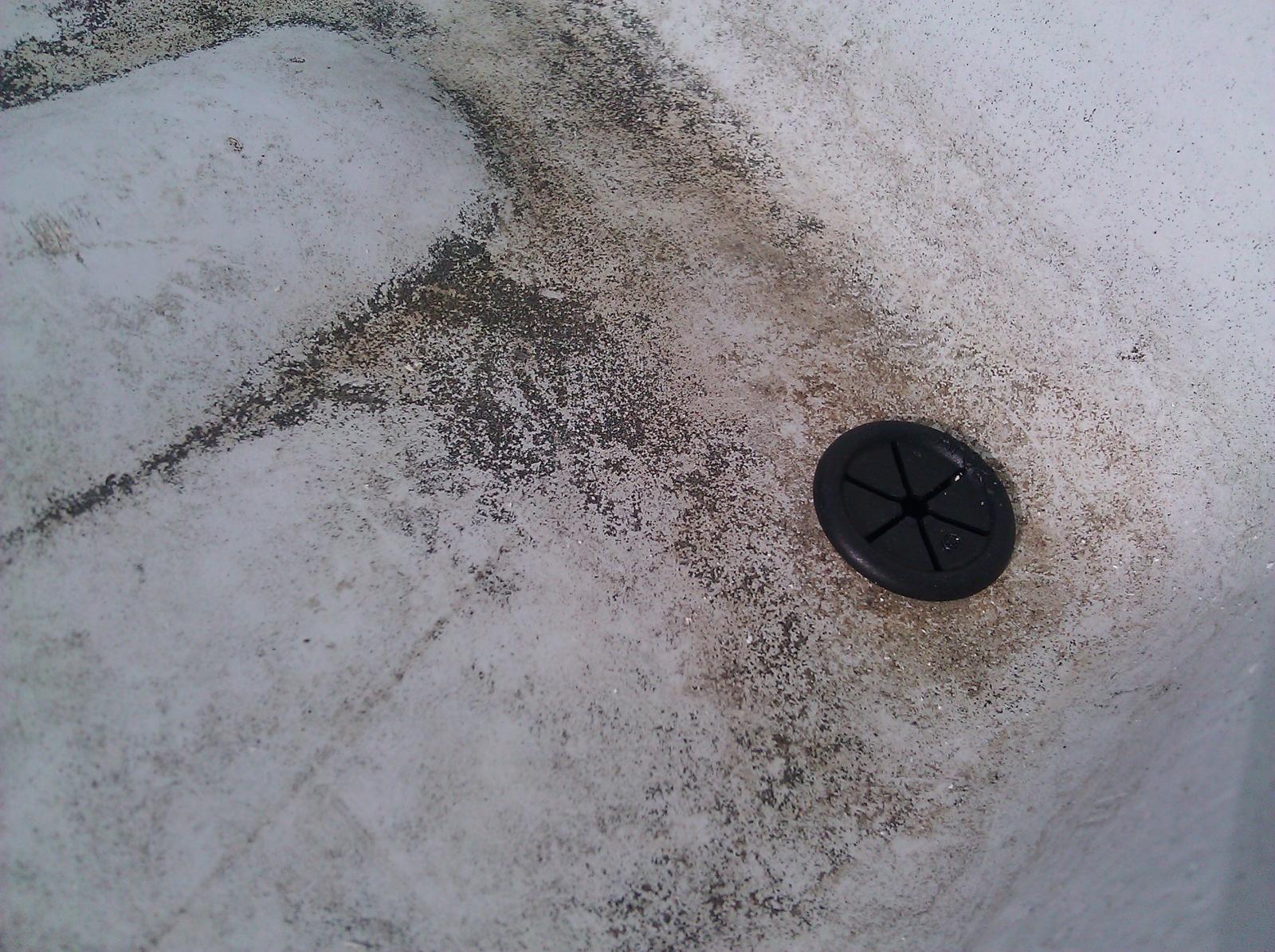

Luggage Rack drain filter / screen
After cleaning out the gunk under the luggage rack I was inspired by these -
http://www.thesamba.com/vw/forum/viewtopic.php?t=600673&highlight=luggage+rack
http://www.thesamba.com/vw/forum/viewtopic.php?t=451036
I wanted to access the outside and remove easily if need be. I did not want to glue or rivet anything in so I found these at the True Value bins. Had to slightly enlarge hole to 5/8". If drilling keep in mind the front/center hole is only about 1/2" below the roof rack.

Excellent, let's see how they hold out to UV rays.
Nice idea.

Thanks! Did consider the UV and am curious too. Luckily the replacement cost is low. The specification pic cut off the price but they're $0.43 each or $2.50 w/tax for all 5

Good idea with the drainage hole fillers. I wonder how easily they'll clog?
Thanks. So far so good.
One of the things I was hoping for was since they are on the top rather than the bottom of the hole I could wipe off what ever was clogging them and what ever was small enough to go through would be small in size. Also, they could be removed easily from the top for cleaning or removal is the OEM holes turned out to be preferable.

Nice! and there you can get them in white. still min hole dia is 5/8.
guess a 20-bus group buy is in order Smile Figured I paid my shipping to the True Value.
Wouldn't be surprised to see these on GoWesty in the future Wink

great idea, in fact I have dozens of those in my radio install box for work so a no cost install for me. Gotta like that as it doesn't happen too often with westy's Very Happy
thanks for sharing

its 2017 and originls still working and holding together just fine

When I had my luggage compartment off, I siliconed some screen t of the bottom the holes. They clogged up horribly and the luggage compartment didn't drain so a lot of dirt and grime stayed in the luggage rack after the water evaporated.
I'm not sure if anything is different in the way I did it, but I would not recommend this "upgrade". But it was easy enough to poke out the screens to put it back to normal. It might work with a different type of screen, more of a mesh than a screen. It just clogs too easily.

My thpughts too, why make the drain less effective, higher risk of clogging?
how about a screen or other cover over the luggage well to exclude clogging debris, or better still a solid water tight cover?
now if debris is a problem of clogging the stock drains, a rather large screen one that stands high, and larger diameter than the drain hole could serve to keep the drain clear for a longer period between periodic cleaning, as the surface area of that filter would be much larger than a tiny drain insert Seams one leaf could block this insert filter, Go for a larger filter if frequent blockages to the stock system are a problem.
good luck, may all your problems drain away

Of course the traditional item for those holes are washing machine hose filters:
Most things that stop the stuff will also clog - but these are easy to pop out and back in.

If you owned a Westy you would know that the drain holes let dirt, small leaves, etc. to collect under the luggage rack where, if left unchecked, will cause rust. It's a bit of a pain the remove the luggage rack to clean so the screens help.
I just use a garden hose to clean the screens I installed on mine whenever I wash the van. We have very fine Tamarack needles around here in the fall and only the fine metal screens from faucets/washing machines work to keep them out. (I just bought the stainless screens only from Ace and epoxied them on) The rest of the year they don't really clog. I guess it's gonna matter where you live and what kind of debris you get.

if you knew about filters, you'd know a larger one is less likely to clog as fast as a small one.

the purpose of this screes solution:
screen is on top so easily manually wiped clear unlike screen on bottom gluing mesh underneath where it created a well for debis to collect in
easily removable of it doesn't suit needs
mesh is not too big or not too small for what neds to get filtered in my climate.
