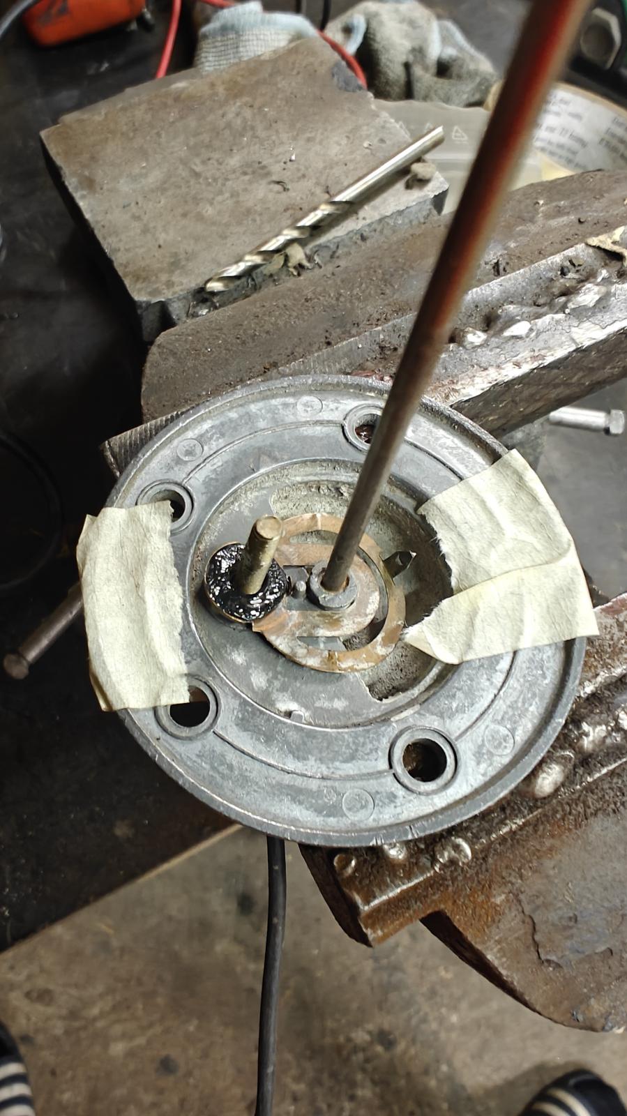

Next on my project was the gas tank/fuel sender.
Did a test on my fuel sender but it was heavily corroded.
So gave it a shot and tried to repair.
Started to take it apart and clean al the components!
Originally it was riveted but i took a copper bolt and gave it a try
Made a gasket so no fuel would leak at the connector.
Then started building it up:
A bakelite washer to avoid contact from positive to ground:
Metal washer on top:
I soldered the cable back (hard to see in the pic)
Put everything back together and give it a test!
Empty tank:
3/4 tank:
I need to order a fuel gauge so i can test it on a gauge itself but i think i did a good job!

I especially commend you for the nichrome wire part.
