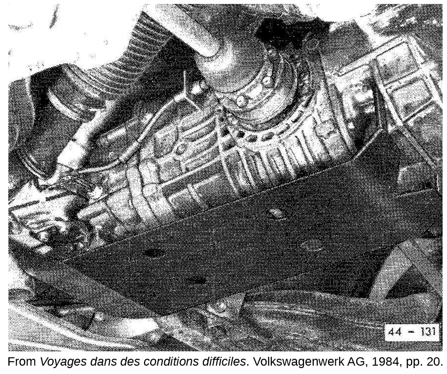

You might find 'Voyages dans des conditions difficiles' (~'Travels in difficult conditions') interesting, as it shows some protective undercarriage designs for transaxles on pages 18 and 20. That said, I'm uncertain which transaxles they are for.
https://web.archive.org/web/20231224035316/https:/...ionnes.pdf

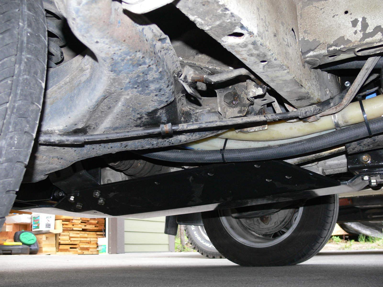

Gowesty has offered engine/trans skid plate in the past, you can see pictures of it in their other skid plate ads.
swissarmychainsaw wrote:
Did syncros have a stock bash plate for the engine? I have the bars that run front to back, with only some cross-over plates under the motor. Non for the trans.
You don't have the stock engine crash bars?
Pic stolen from the gallery

[quote="syncrodoka"]Gowesty has offered engine/trans skid plate in the past, you can see pictures of it in their other skid plate ads.
<Snip>
Yes this is exactly what I have, and that open section is where I fear large rocks will break my trans/motor.
Have you ever seen pics of a broken tranny case on theSamba or anywhere?
I have never seen a pic of a gearbox damaged by rocks.
Engine sumps damaged....yes I've seen that.
That is a valid point. I have had a large stick jam itself up near the shift lever that took some doing to get it dislodged.
I welded plate steel to the stock engine crash bars many years ago and the definitely have taken some impacts. If I was redoing it I might consider putting in rivnuts or timeserts to unbolt the plate vs unbolting the entire skid plate to service.
