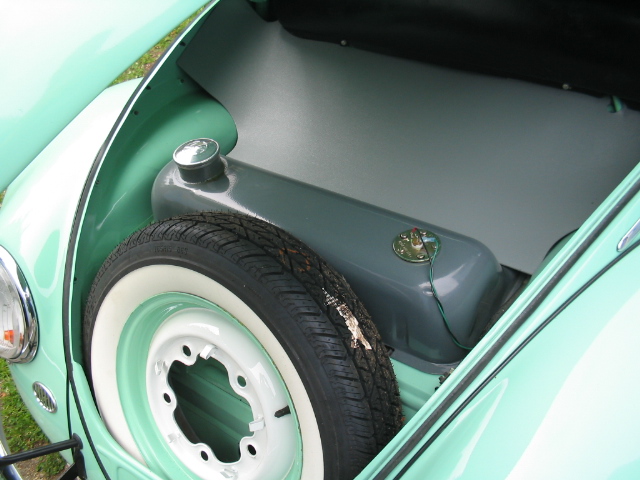

I bought this tank already restored and this was the color. Not sure if its the right color though.

PostPosted: Thu Feb 10, 2005 8:57 pm    Post subject: Reply with quote
As far as I could tell the top picture is my untouched 57 tank painted the original color....the bottom picture is my attempt to match it. It's way too light.
John

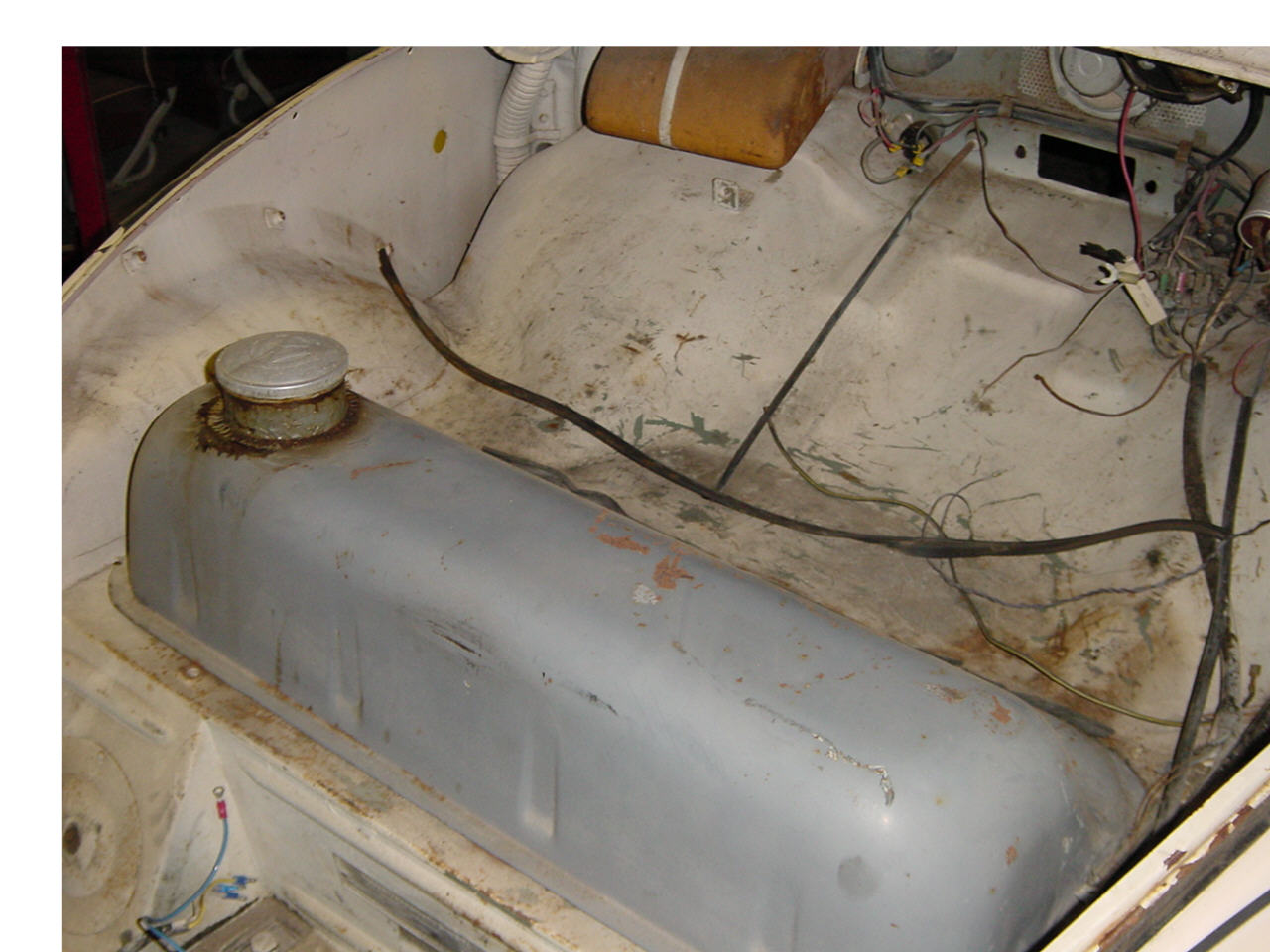

PostPosted: Thu Feb 10, 2005 10:49 pm    Post subject: Reply with quote
Unrestored tank on my 55 vert:
After resto:
Definately a bluish gray.

Hard to tell from the pics, since the OG gray looks similar to the bluish gray. But I had both color matched and they are definately different.

PostPosted: Fri Feb 11, 2005 8:25 pm    Post subject: Reply with quote
On this pic, look at the very right of the tank compared to the body...you can see they are different....
