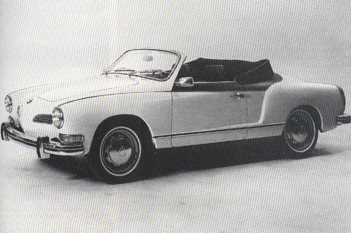

retrowagen
Joined: October 11, 2004
Posts: 1856
retrowagen is offline
PostPosted: Sat Jan 29, 2005 11:05 am    Post subject: Reply with quote
Hi Gang,
Well, I remembered seeing this trim package for the 1973/1974 Cabriolet in some factory photos... Here's a really bad scan of one of them (sorry, my scanner is dying!):
Obviously, this vehicle has other rims than what's pictured on Ed W.'s special Cabriolet. I believe the steering wheel pictured mounted on Ed's car is the same type as used on the concurrent special edition Rallye Beetle, a VDM leather-rimmed three spoke with a really huge hub.
I don't know too much else about this trim package--whether it was dealer or factory installed, for instance--although the factory photo suggests it may have been factory installed, or, to be certain, cooked up by either the VW styling studio in Wolfsburg, or Karmann in Osnabrueck.
There's a second factory photo of this car, shown from the rear three-quarters view, which shows the extra graphics around the cockpit applied to only the driver's half of the car! As if the styling studio was not fully committed to the concept yet.
I have talked at length in the past to a couple German Karmann-Ghia experts (one the author of a book) about this trim package; they knew little or nothing about it too, asking me if there were any of these running around in the US. I had never seen one, but I guess now we know where to find one!
Ed, hang on to that car...

PostPosted: Sat Jan 29, 2005 12:28 pm    Post subject: Reply with quote
Dave,
That's exactly what I have except for the rims. It's interesting on the second picture you mentioned as my car has a seam in the back center of the black trim right below the top. That second picture you have could be showing the process of putting the trim on. Still, if anyone has any additonal info, I'd love to hear from you.
Ed

garyrowland
Joined: April 29, 2004
Posts: 539
Location: crown point, Ind.
garyrowland is offline
PostPosted: Sat Jan 29, 2005 5:56 pm    Post subject: Reply with quote
I don't think a dealer would go to that much trouble, and besides with retrowagen producing factory photos - so much for the dealer option idea? any way you slice it - not to many of them, its a pretty rare bird
