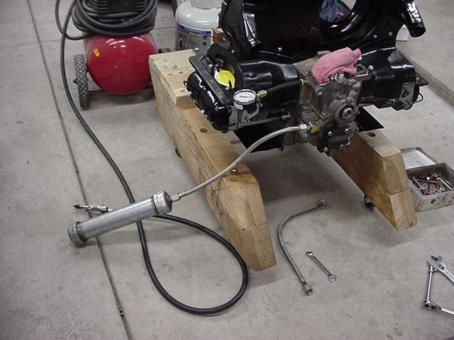

Basically, this is just a length of iron pipe and end-caps, I welded a male AN fitting to the bottom cap and drilled a hole in the top cap.
Hold the the pipe upright and fill with motor oil. Put the top cap on and apply air through the hole in the top cap.
