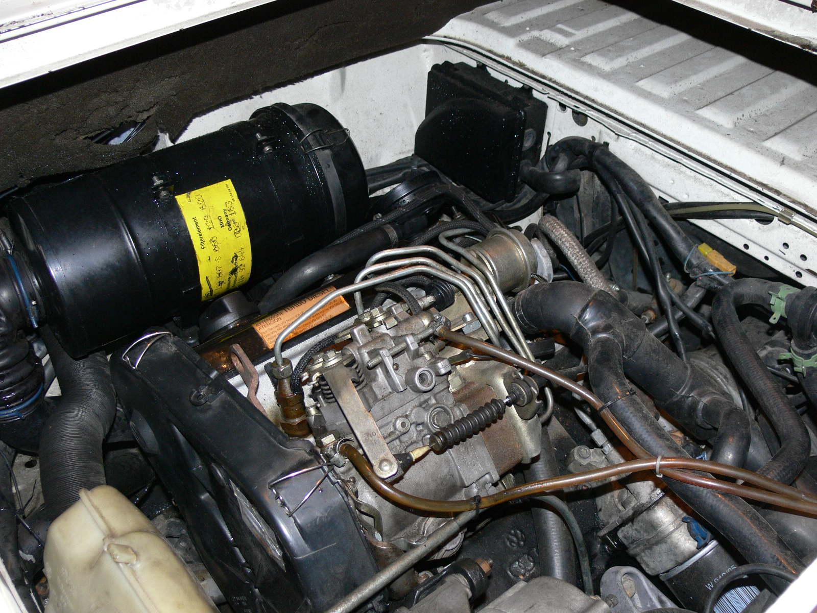

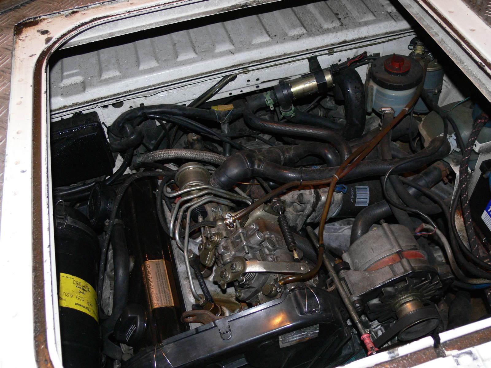

So here's the engine:

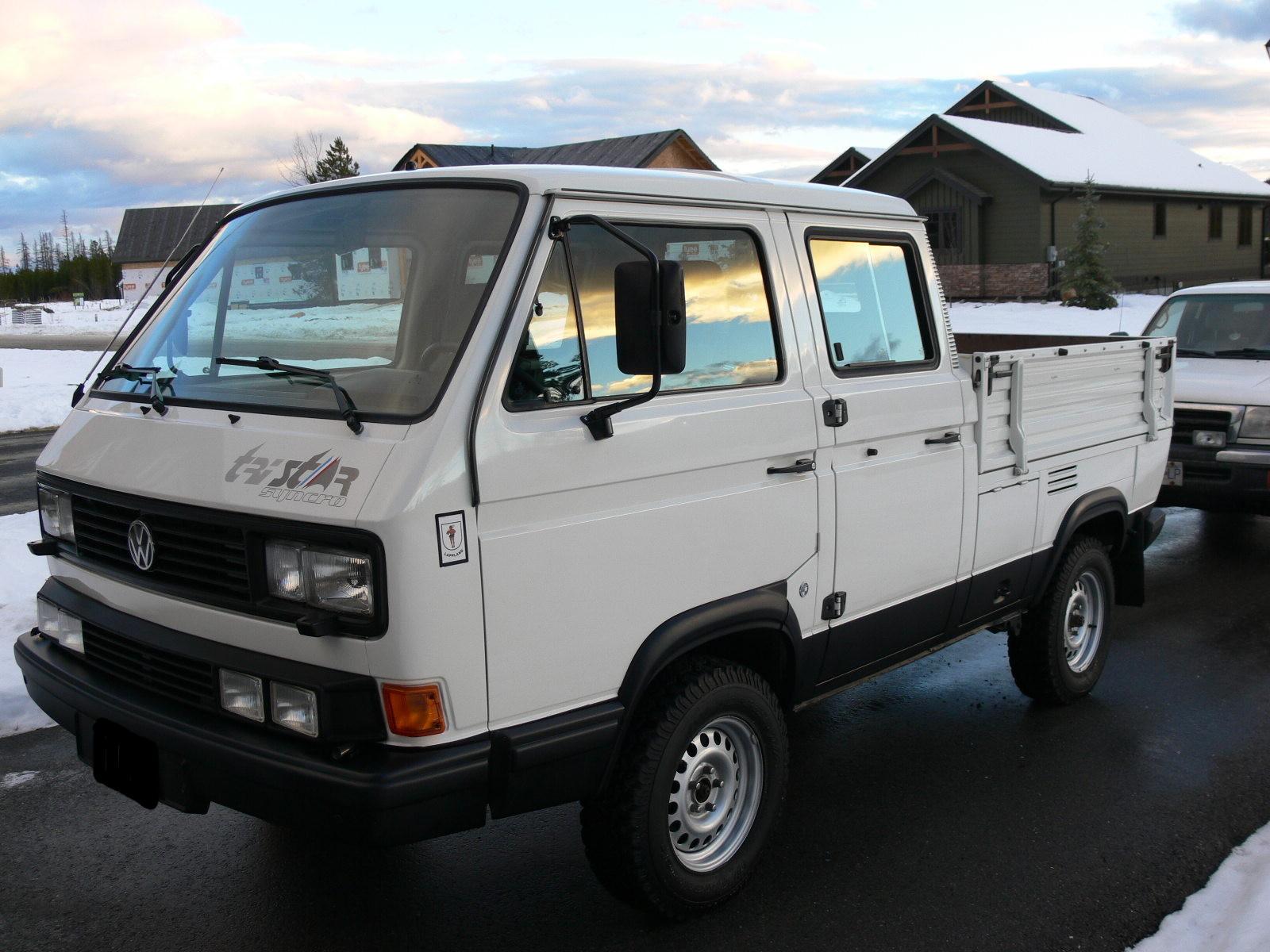

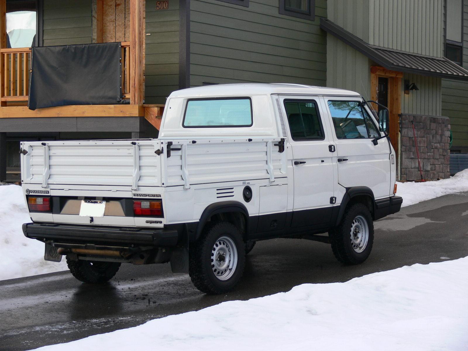

And here is what it's pushing:

Thanks, the body is in excellent condition but I have some real worries about the condition of the engine. It has a brand new AAZ long block but the older 1.6 TD hardware. Has a loud diesel "nailing" The lady who had the engine upgraded spent some serious money only to be constantly spending more money to have problems resolved, quit the truck in frustration. Kind of sad. You really need to be able to work on these older vehicles yourself.
I plan to educate myself about the engine before anymore long drives.

Holy. Crap.
I think we were all expecting a clapped-out '82 Westy or something...
Very loud diesel clatter can be caused by over-advanced pump timing. Mine was painfully loud when I first set it, a few bumps of the pump away from the head got it quieted down nicely.

Totally ! What a nice rig. Once you get that AAZ dialed you will be happy. I prefer the early TDI's but the AAZ can still put out some very nice power. From the looks of the engine bay it looks well done. You did good.

Very nice. The pump is a 1.6TD pump and the alt/belt drive are also from a 1.6. The upside is that the crank nose issue I mentioned before is not really an issue with the v-belt drive. The injection pump is both better and worse than a stock AAZ pump. The upside is it has better boost fuel enrichment, the downside is it pumps less fuel off-boost unless someone opened it up and swapped the camplate. Thosee injection lines are JX specific (stock 1.6TD Vanagon ONLY) and so need to be imported from Europe. They had to be bent to fit as the AAZ block is a 1/2" taller. You are also missing the anti-vibration clamp that goes over the 4 lines (probably removed in the line-bending process and hard to fit afterward) and so the odds are good that one will crack and leave you stranded... Get a spare set of lines to keep in the travelling spares AND install anti-vibration clamps.
