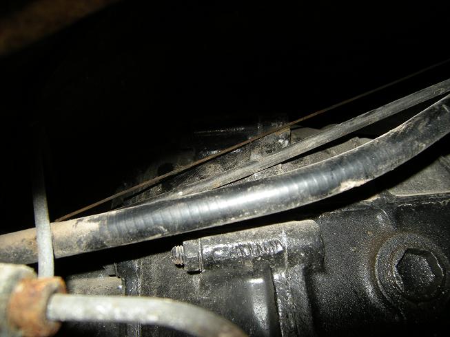

I have a sticky acclerator all the sudden. It happened just after a bunch of rain and in my climate (Southeast Alaska) it never dries out. Hadn't driven it for bit, so I assumed something was binding up due to rust. I got under the bus as advised. Yep, looks like I am missing that wire guide that the cable goes through...AND look at the groove that "rusty" cable is cutting in my transmission! I'll start searching the classifieds etc., or just have to make one. Any other solutions to get that cable out of the way? Please share!
Thanks to everyone else for their insights. I'm going through the various steps before going to the carburator.

I used a small piece of fuel line, sliced it down the side to get the cable in it, rtv'd it to the tranny where the cable was cutting in. Once the rtv was dry I packed the piece of fuel line with grease.
Hoockd on fonicks werkt for mee?

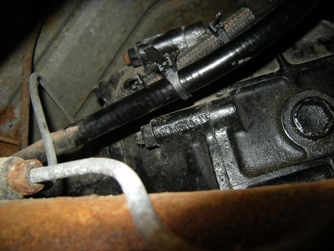

Yes, that is a great solution. I have a bit of hose and some grease.

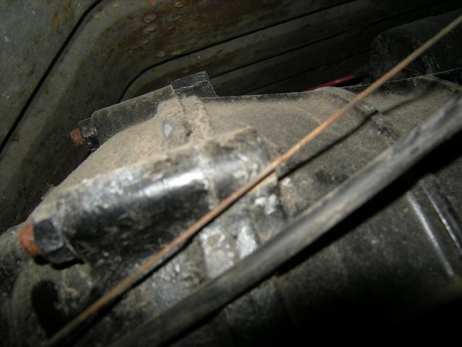

Indeed both my singlecabs are 1960....one has the wire guide while the other does not and is newest to me....however, I know the PO removed the tranny several times and no doubt it was left off at that time....
I also discovered that the cable was sawing it's way out of the metal guide tube soon to attack the fuel line. If I space the cable in it's new rubber gas line guide from the tranny it should center the cable like in the picture.
Folks, please advise me if this set up is OK....accelerator cable in rubber gas line zip tied to the choke cable. This assembly is zip tied to the hand brake cable. This pulls everything away at the tranny and at the fuel line. I just wonder if there will be wear elsewhere with this set up. I like the rtv option, but didn't have any on hand tonight.
I also assumed it was the rubber fuel line as that is a lot easier to slice in half (as mintonman says) than a metal one....
The best option will be to get one of those boden tubes and fit it the whole length.

Just undo the cable from the carb. Pull the cable forward from under the transaxle. Slip the cable into the hose and reconnect the cable to the carb.
With how dry the cable looks, would pull it out up front for a full grease up to help avoid cutting the tube and having sticky cable.
Of course one could easily fab up the early style of cable guide out of a coat hanger. Then your choice if you want to run as stock or go ahead and run the fuel line in it.
The later cable tube was a huge improvement for this area.
Here is a shorter version that could have a piece of steel tube added to be the right length:

On the Dormy I use the "sleeve/cover" from a bicycle's hand brake with a couple of washers at the ends! Works great! Razz
But that should be a temporary fix. The one from CIP1 for $20 sounds like s fair deal for a more correct item. Cool
