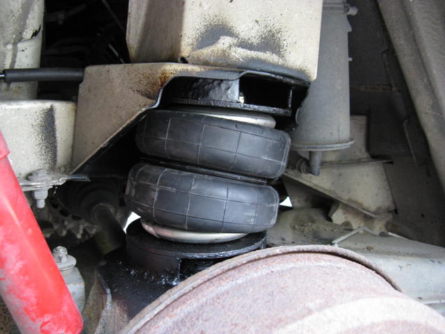

Something like this, you mean? This is my van. I have regular springs in the front - either the shock will need to be moved or you will need special air bags that have a hole in the center.

PostPosted: Tue Oct 21, 2008 8:20 pm    Post subject: Reply with quote
240Gordy wrote:
yes Presslab that is what I am looking for.
How does it ride? Does it cut the noise and thumping at all? Regular springs up front you say?
How much work was it to fit the brackets, etc?
So did you heat your springs (to make it even lower) to get it where only two coils are working? I'm not sure I understand exactly what you meant in the first post.
The air bags are stiffer than the stock springs, however for a lowered van this is needed. You might just be bottoming out your suspension and need a stiffer shock.
My van rides stiffer than a stock van but this is what I wanted. It is not harsh over bumps. I wanted the rear bags so I could raise the van back up when carrying my dirt bike on the back. The spring rate of the air bag is pretty much the same regardless of the static air pressure; adjusting the air pressure adjusts the ride height. If I recall the spring rate of these 276C bags is about 650 lb/in.
It might have reduced the road noise but it was not by a whole lot. I didn't really have any complaints about the noise before or after the air bags. I found some suitable front coil springs and it would be harder to do bags on the front, so I didn't install front air bags.
Installing the rear air bags was not too hard. The circle plates the bags bolt to were purchased and a couple pieces of bar stock were bent and everything welded together. I have two schrader valves to fill the bags up.

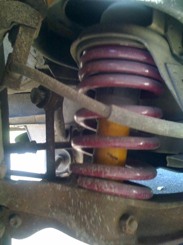

I have 4 H&R springs.
Looks like this, they are the sport model.
after sitting for a couple months only the bottom small coil is active the rest just rest upon each other.
the front,

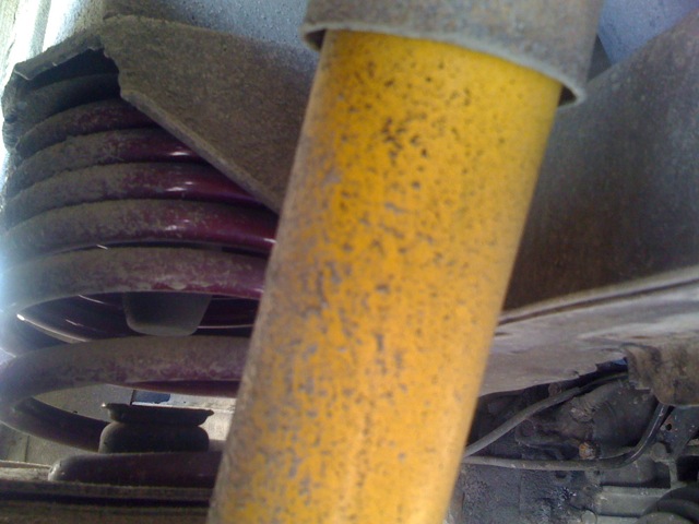

PostPosted: Wed Oct 22, 2008 11:26 am    Post subject: Reply with quote
what a difference a few months and miles makes . . .
now looks like this,
Wow, yes I'm sure you are going into coil bind or bottoming out!
Those springs look defective or poor quality to have sacked out so quickly.
I admit, I have lowered cars by heating up the springs... However they never had any problems. You should get a warranty replacement from H&R or you could try heating up your stock springs if you still have them.

PostPosted: Wed Oct 22, 2008 11:44 am    Post subject: Reply with quote
better view and the problem becomes obvious . . .
the big bump stop ( ? ) surely hits the trailing arm pad in the middle of the spring perch.
guess that's why they call it slammed?

PostPosted: Wed Oct 22, 2008 11:52 am    Post subject: Reply with quote
Slammed, LOL! Shocked Yep that's the bump stop.. I would not really recommend cutting it down, your springs are the real problem.
You could go air bags, but the only two reasons for doing this in my mind are load leveling (like I do) or extreme lowering (like for car shows) and then raising back up so you can drive the thing over bumps. Very Happy

PostPosted: Wed Oct 22, 2008 3:20 pm    Post subject: Reply with quote
Did you cut your bump stops? This is a must when running lowering springs...

PostPosted: Wed Oct 22, 2008 3:33 pm    Post subject: Reply with quote
how much to cut ya figure? we are talking about the thinyg sticking down inside the spring right? at the rear?

PostPosted: Wed Oct 22, 2008 3:34 pm    Post subject: Reply with quote
the guy who put the springs in told me there was no bump stops . . .
