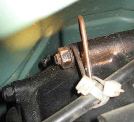

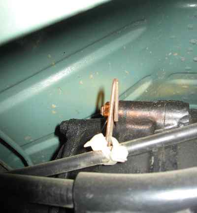

PostPosted: Wed Oct 22, 2008 1:03 pm    Post subject: Re: accelerator cable rubbing against transmission Reply with quote
cdennisg wrote:
...And does anyone have a pic of what the wire mount looked like on the earlier trannies? I did a search, but I am mostly computer dysfunctional.
It was rubbing so I put on the wire clip. Then I added the tube and just left the clip there with tye-wraps which kept the tube from sagging. Normal would be the accelerator wire going through the clip by itself.

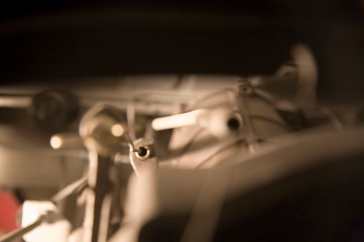

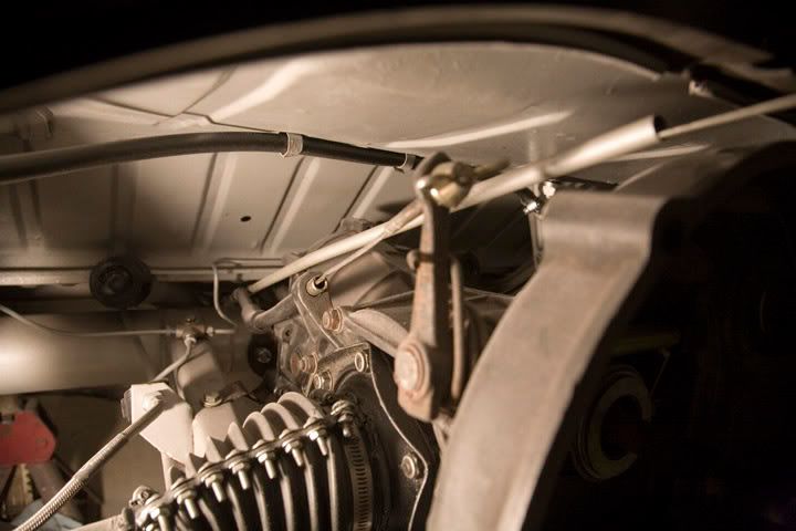

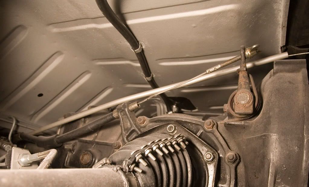

PostPosted: Sun Jun 02, 2013 3:09 pm    Post subject: Reply with quote
Gave a first try at installing my Bowden tube today. it's incredibly tight (and dirty).
